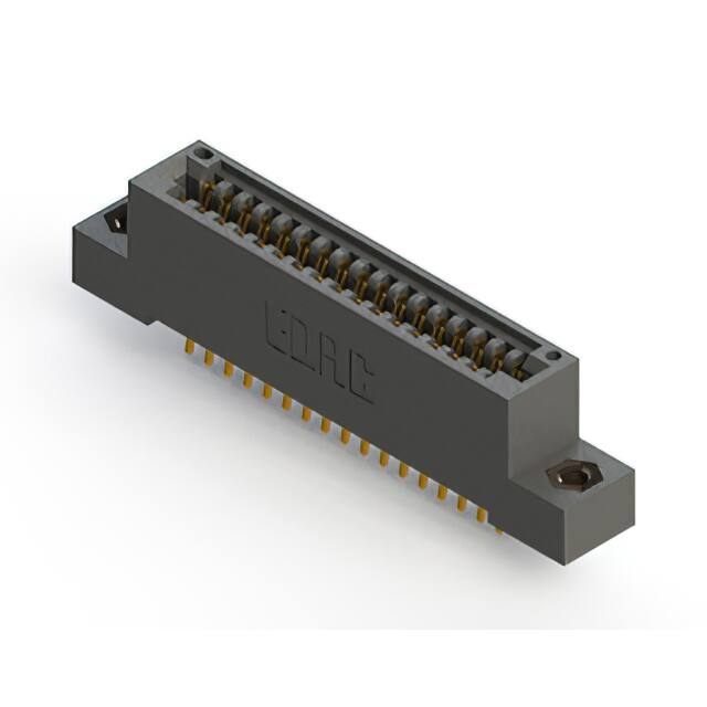

    P=2.54mm
    395-034-556-207
395-034-556-207 数据手册
Contact Dimensions: 556-Extender Board Bend (Code 520 Contacts) See Sheet 2 for Contact Code 555, 556, 558, 559, 560 Dimensions 2x ISSUE NUMBER THIS IS A C.A.D. GENERATED DRAWING DO NOT MAKE MANUAL REVISIONS TO MASTER. ORIGINAL 1 .156 3.96 .330 8.38 CARD SLOT .160 4.06 POINT OF CONTACT 1.800 45.72 1.960 49.78 2.275 57.79 .600 15.24 A SECTION A-A A 2.535 64.39 345/395 SERIES CARD EDGE CONNECTOR PART NUMBER: 395-034-556-207 • • • INSULATOR MATERIAL: THERMOPLASTIC PBT BLACK, UL 94V-0 CONTACT MATERIAL; COPPER TIN ALLOY CONTACT PLATING: GOLD ON THE MATING AREA, TIN PLATING ON THE CONTACT TAILS, NICKEL UNDERPLATE EDAC INC TORONTO, ONTARIO CANADA YOUR CONNECTION TO QUALITY & SERVICE THESE DRAWINGS AND SPECIFICATIONS ARE THE PROPERTY OF EDAC INC.,AND SHALL NOT BE REPRODUCED,OR COPIED OR USED AS THE BASIS FOR THE MANUFACTURE OR SALE OF APPARATUS WITHOUT WRITTEN PERMISSION. ACAD REFERENCE NO. 345-ENG-MASTER DRAWN: R.STA.MONICA DATE:MAY.16/2017 CHECKED: DATE: SCALE: 1:1 DRAWING NUMBER 345-ENG-MASTER SHEET 1 OF 2 ISSUE 1 Contact Description: 559-90 Degree Bend (Code 541 Contacts) .107 2.72 ORIGINAL .157 4 .125(3.18) to .210(5.33) Outside Tails .125(3.18) to .210(5.33) Outside Tails .045(1.14) to .060(1.52) Between Tails .045(1.14) to .060(1.52) Between Tails Contact Code 555 Contact Code 556 .060 .152 3.86 .060 .150 .200 .285 7.24 .635 16.13 1 .082 2.08 .232 5.89 .235 5.97 ISSUE NUMBER THIS IS A C.A.D. GENERATED DRAWING DO NOT MAKE MANUAL REVISIONS TO MASTER. .362 9.19 .125(3.18) to .210(5.33) Outside Tails .635 16.13 .045(1.14) to .060(1.52) Between Tails Contact Code 558 • • • INSULATOR MATERIAL: THERMOPLASTIC POLYESTER, UL 94V-0 DAP MATERIAL AVAILABLE UPON REQUEST CONTACT MATERIAL; COPPER ALLOY CONTACT PLATING: GOLD ON THE MATING AREA, TIN PLATING ON THE CONTACT TAILS, NICKEL UNDERPLATE Contact Code 559 Contact Code 560 345/395 SERIES CARD EDGE CONNECTOR CONTACT CODE 555,556,558,559,560 DIMENSIONS EDAC INC TORONTO, ONTARIO CANADA YOUR CONNECTION TO QUALITY & SERVICE THESE DRAWINGS AND SPECIFICATIONS ARE THE PROPERTY OF EDAC INC.,AND SHALL NOT BE REPRODUCED,OR COPIED OR USED AS THE BASIS FOR THE MANUFACTURE OR SALE OF APPARATUS WITHOUT WRITTEN PERMISSION. ACAD REFERENCE NO. DRAWN: R.STA.MONICA DATE: CHECKED: SCALE: 345-ENG-MASTER DATE:MAY.16/2017 1:1 DRAWING NUMBER 345-ENG-MASTER SHEET 2 OF 2 ISSUE 1
