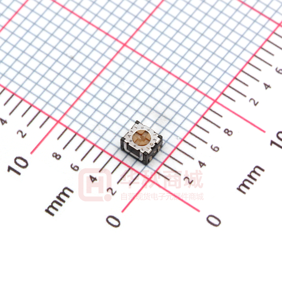

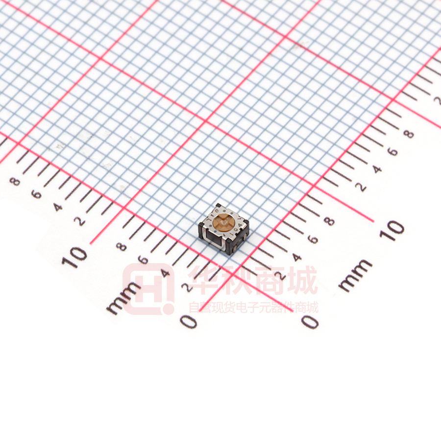

    精密微调电阻 POTENTIONMETER_2.8X2.4MM_SM 100KΩ ±20% 1/10W ±150ppm/℃
