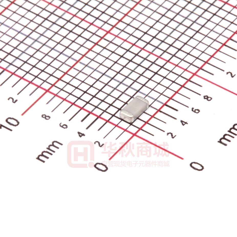

    贴片电容(MLCC) 1206 47pF ±5% 1KV
FV31N470J102EMG 数据手册
信昌電子陶瓷股份有限公司 Prosperity Dielectrics Co., Ltd. No.566-1, Kaoshi Rd., Yangmei, Taoyuan 32668, Taiwan (R.O.C.) Tel : 886-3-4753355 Fax : 886-3-4854959 Messrs. : Date : 一般共用 2018/08/17 APPROVAL SHEET Product Name : High Voltage Multilayer Ceramic Chip Capacitors Part No. : FV Series Description : Size 0805~2225, C0G/X7R, 1000V~4000V PREPARED BY APPROVED BY 信昌電子陶瓷股份有限公司 PROSPERITY DIELECTRICS CO., LTD. 桃園市楊梅區高獅路 566-1 號 Tel : 03-4753355 ext : Contactor : http://www.pdc.com.tw Fax : 03-4854959 Mobile : DCM-003-8.1 Rev 2 信昌電子陶瓷股份有限公司 Prosperity Dielectrics Co., Ltd. No.566-1, Kaoshi Rd., Yangmei, Taoyuan 32668, Taiwan (R.O.C.) Tel : 886-3-4753355 Fax : 886-3-4854959 SPECIFICATION FOR Product Name : High Voltage Multilayer Ceramic Chip Capacitors Part No. : FV Series Description : Size 0805~2225, C0G/X7R, 1000V~4000V SPEC. No. : FV-000-001-11 DATE : 2018/08/17 DRAWN BY CHECEKED BY APPROVED BY Tsu Chen Yvens Chou Joseph Ling DCM-003-8.2 Rev 2 信昌電子陶瓷股份有限公司 Prosperity Dielectrics Co., Ltd. 1. INTRODUCTION PDC FV Series green type capacitors are manufactured by using environmental friendly material without lead or cadmium. These capacitors feature series connection of multi-layer capacitor units in a MLCC to realize high voltage performance. This special design can distribute voltage gradients throughout the entire capacitor, so as to prevent short circuit failure. It is a safety design for LCD back-lighting inverter application. 2. FEATURES 3. APPLICATIONS a. Special interior design offers high voltage rating in a given case size. b. High reliability and stability. c. RoHS & HALOGEM compliant. a. b. c. d. e. f. DC to DC converter. High voltage coupling/DC blocking. Back-lighting inverters. LAN/WLAN interface. Modem. Power supplies. 4. HOW TO ORDER FV PDC Family Table 1 31 X Size 103 K 102 Rated Voltage Table 6 Dielectric Capacitance Tolerance Table 2 Table 3 Table 4 Table 5 E C G Control Packaging Thickness Code Table 7 Table 8 Table 9 Table 1 PDC Family Table 6 Code Description Code Description Code Description Code Description FV High voltage application with ≥1KVdc 102 1000Vdc 302 3000Vdc 502 5000Vdc 152 1500Vdc 402 4000Vdc 602 6000Vdc Table 2 Size 202 2000Vdc Code Description Code Description Code Description 15 0402 (1005) 32 1210 (3225) 52 2211 (5728) 18 0603 (1608) 42 1808 (4520) 55 2220 (5750) 21 0805 (2012) 43 1812 (4532) 56 2225 (5763) 31 1206 (3216) 46 1825 (4563) Rated Voltage Table 7 Packaging Type Code Table 3 Description Code Description Dielectric Material Characteristics B Bulk T Tray package Code Description Code Description Tape and 7” Reel, Embossed Tape C0G X X7R P D G Tape and 7” Reel, Paper Tape N E K L Table 4 Capacitance Rule Code Tape and 10” Reel, Embossed Tape Tape and 13” Reel, Embossed Tape Table 8 Tape and 10” Reel, Paper Tape Tape and 13” Reel, Paper Tape Thickness Description Code Description Code Description Code Description Code Description Code Description R47 0R5 100 0.47pF 0.5pF 100=10x100=10pF 102 104 106 102=10x102=1000pF 104=10x104=100nF 106=10x106=10µF A B C 0.60 ± 0.10 mm 1.25 ± 0.20 mm Q R S 0.50 +0.02/-0.05 mm 0.8+0.15/-0.10 mm I J K D 1.40 ± 0.15 mm L 0.30 ± 0.03 mm T 0.85 ± 0.10 mm 1.60 ± 0.20 mm 0.95 ± 0.10 mm 3.50 ± 0.20 mm U V X 0.50 ± 0.10 mm 2.50 ± 0.30 mm M N O 2.80 ± 0.30 mm P 1.60+0.3/-0.10 mm Z 0.25 ± 0.03 mm Table 5 Tolerance 1.25 ± 0.10 mm 1.15 ± 0.15 mm 0.50 ± 0.20 mm 3.10 ± 0.30 mm 0.80 ± 0.07 mm Code Description Code Description A ±0.05 pF J ±5 % E F G B ±0.10 pF K ±10 % H C ±0.25 pF L 0% ~ +10% D F ±0.50 pF ±1 % M N ±20 % -5% ~ +10% Table 9 Code Description G H ±2 % ±3 % P Q ±0.02 pF ±0.03 pF G Q RoHS compliant Surface Coating (Size 1206~2225) I -10% ~ 0% Z -20% ~ +80% O Gold plating (Size≥0603) Code Description 2.00 ± 0.20 mm 0.50 ± 0.05 mm 0.20 ± 0.02 mm 0.80 ± 0.10 mm Special Control Code Specification No. : FV-000-001-11 ~1~ DCM-003-8.3 Rev 2 信昌電子陶瓷股份有限公司 Prosperity Dielectrics Co., Ltd. 5. EXTERNAL DIMENSIONS Size Inch (mm) 0805(2012) L (mm) 2.10±0.20 W (mm) 1.25±0.20 Code / T (mm) 1206(3216) 3.30±0.30 1.60±0.20 0.60±0.20 1210(3225) 3.30±0.40 2.50±0.30 0.75±0.35 1808(4520) 4.50 +0.50/-0.30 2.00±0.25 1812(4532) 4.50 +0.50/-0.30 3.20±0.40 1825(4563) 4.50 +0.50/-0.30 6.30±0.40 2211(5728) 5.70±0.40 2.80±0.30 0.85±0.35 2220(5750) 5.70±0.40 5.00±0.40 0.85±0.35 2225(5763) 5.70±0.40 6.30±0.40 0.85±0.35 See No.4 Reference Table 8 MB (mm) 0.50±0.20 L T 0.75±0.35 0.75±0.35 W 0.75±0.35 MB MB Fig. 5.1 The outline of MLCC 6. GENERAL ELECTRICAL DATA Dielectric Size Rated voltage (WVDC) Capacitance range Capacitance tolerance Tan δ Capacitance & Tan δ Test condition C0G 0805, 1206, 1210, 1808, 1812, 1825, 2220, 2225 X7R 0805, 1206, 1210, 1808, 1812, 1825, 2211, 2220, 2225 1000V, 1500V, 2000V, 3000V, 4000V 1000V, 1500V, 2000V, 3000V, 4000V 1.5pF ~ 10nF 100pF ~ 220nF Reference to Table 5 Reference to Table 5 Cap. Rang Cap.1000pF Insulation resistance at Ur Operating temperature Capacitance characteristic Termination Q Spec. Q≥400+20C Q≥1000 Test Condition 1.0±0.2Vrms, 1.0MHz±10% 1.0±0.2Vrms, 1.0KHz±10% 1.0±0.2Vrms, 1.0KHz±10%, at 25°C ambient temperature ≥10GΩ or RxC≥500Ω-F, whichever is smaller ≥10GΩ or RxC≥100Ω-F, whichever is smaller -55°C to +125°C ±30ppm/°C ±15% Cu or Ag/Ni/Sn or Au (lead-free termination) Specification No. : FV-000-001-11 ~2~ DCM-003-8.3 Rev 2 信昌電子陶瓷股份有限公司 Prosperity Dielectrics Co., Ltd. 7. CAPACITANCE RANGE 7-1. C0G Dimension Cap.(pF) Code 1.5 1R5 1.8 1R8 2.2 2R2 2.7 2R7 3.3 3R3 3.9 3R9 4.7 4R7 5.0 5R0 5.6 5R6 6.8 6R8 8.2 8R2 10 100 12 120 15 150 18 180 22 220 27 270 33 330 39 390 47 470 56 560 68 680 82 820 100 101 120 121 150 151 180 181 220 221 270 271 330 331 390 391 470 471 560 561 680 681 820 821 1000 102 1200 122 1500 152 1800 182 2200 222 2700 272 3300 332 3900 392 0805 1000V C C C C C C C C C C C C C C C C C C C C C C C C C C C C C C C 1000V X X X X X X X X X X X X X X X X X X X X X X X X C C E E E E E E E E E E 1206 1500V X X X X X X X X X X X X X X X X X M M M C C C C E E E E P P P 2000V X X X X X X X X X X X X X X X X X M M M C C C C E E E E P P P 1000V M M M M M M M M M M M M C C C C E E E E E E E E E E F G G G G G 1210 1500V 2000V M M M M M M M M M C C C C C E E E F F G G G G G G M M M M M M M M M C C C C C E E E F F G G G G G G Specification No. : FV-000-001-11 ~3~ DCM-003-8.3 Rev 2 信昌電子陶瓷股份有限公司 Prosperity Dielectrics Co., Ltd. 7. CAPACITANCE RANGE(Con.) 7-1. C0G Dimension Cap.(pF) Code 1.5 1.8 2.2 2.7 3.3 3.9 4.7 5.0 5.6 6.8 8.2 10 12 15 18 22 27 33 39 47 56 68 82 100 120 150 180 220 270 330 390 470 560 680 820 1000 1200 1500 1800 2200 2700 3300 3900 4700 5600 6800 8200 10000 12000 1R5 1R8 2R2 2R7 3R3 3R9 4R7 5R0 5R6 6R8 8R2 100 120 150 180 220 270 330 390 470 560 680 820 101 121 151 181 221 271 331 391 471 561 681 821 102 122 152 182 222 272 332 392 472 562 682 822 103 123 1808 1812 1825 1000V 1500V 2000V 3000V 1000V 1500V 2000V 3000V 4000V 1000V 1500V 2000V 3000V 4000V C C C C C C C C C C C C C C C C C C C C C C C C C C F F F F F F F F F F F F C C C C C C C C C C C C C C C C C C C C C C C F F F F F F F F F F F C C C C C C C C C C C C C C C C C C C C C C C F F F F F F F F F F F C C C C C C C C C C C C C C C C C C C C C F F F F F F F F C C C C C C C C C C C C C C C C C C C C F F F F F F F E E F F G C C C C C C C C C C C C C C C C C F F F F F F F F E E C C C C C C C C C C C C C C C C C F F F F F F F F E E C C C C C C C C C C C C C C C F F F F F F C C C C C C F F F F F F F F F F F F F F F F F F F F F F F F F F F F F F F F F F F G G F F F F F F F F F F F F F F F F F F F F F F F F F F F F F F F F F F F F F F F F F F F F F F F F F F F F F F F F F F F F F F F F F F F F F F F F F F F F F F F F F F F F F F F F F F F F F F F F F F F F F F F F F F F F F F F F F F F F Specification No. : FV-000-001-11 ~4~ DCM-003-8.3 Rev 2 信昌電子陶瓷股份有限公司 Prosperity Dielectrics Co., Ltd. 7. CAPACITANCE RANGE(Con.) 7-1. C0G Dimension 2220 2225 Cap.(pF) Code 1000V 1500V 2000V 3000V 4000V 1000V 1500V 2000V 3000V 4000V 1.5 1R5 1.8 1R8 2.2 2R2 2.7 2R7 3.3 3R3 3.9 3R9 4.7 4R7 5.0 5R0 5.6 5R6 6.8 6R8 8.2 8R2 10 100 F F F F F F F F F F 12 120 F F F F F F F F F F 15 150 F F F F F F F F F F 18 180 F F F F F F F F F F 22 220 F F F F F F F F F F 27 270 F F F F F F F F F F 33 330 F F F F F F F F F F 39 390 F F F F F F F F F F 47 470 F F F F F F F F F F 56 560 F F F F F F F F F F 68 680 F F F F F F F F F F 82 820 F F F F F F F F F F 100 101 F F F F F F F F F F 120 121 F F F F F F F F 150 151 F F F F F F F F 180 181 F F F F F F F F 220 221 F F F F F F F F 270 271 F F F F F F F F 330 331 F F F F F F F F 390 391 F F F F F F F F 470 471 F F F F F F F F 560 561 F F F F F F F F 680 681 F F F F F F F F 820 821 F F F F F F F F 1000 102 F F F F F F F F 1200 122 F F F F F F F 1500 152 F F F F F F F 1800 182 F F F F F F 2200 222 F F F F F F 2700 272 F F F F F F 3300 332 F F F F F F 3900 392 F F F F F F 4700 472 F F F F F F 5600 562 F F F F 6800 682 F F F F 8200 822 G F G G 10000 103 G G G G 12000 123 Specification No. : FV-000-001-11 ~5~ DCM-003-8.3 Rev 2 信昌電子陶瓷股份有限公司 Prosperity Dielectrics Co., Ltd. 7. CAPACITANCE RANGE(Con.) 7-2. X7R Dimension 0805 1206 1210 1808 Cap.(pF) Code 1000V 1000V 1500V 2000V 2500V 1000V 1500V 2000V 1000V 1500V 2000V 3000V 4000V 100 101 X C C C C C C C 120 121 X C C C C C C C 150 151 X C C C C C C C C C C C F* 180 181 X C C C C C C C C C C C F* 220 221 X C C C C C C E C C C C F* 270 271 X C C C C C C E C C C C F* 330 331 X C C C C C C E C C C F F* 390 391 X C C C C C C E C C C F F* 470 471 X C C C C C C E C C C F F* 560 561 X C C C C C C E C C C F F* 680 681 X C C C C* C C E C C C F F* 820 821 X C C C C* C C E C C C F F* 1000 102 X C C C C* C C E C C C F F* 1200 122 X C E E E C G F C F F F 1500 152 C C E E E C G F C F F F 1800 182 C C E E E C G F C F F F 2200 222 C C E E E C G F C F F F 2700 272 C C E E C G G C F F 3300 332 C C E E C G G C F F 3900 392 C E E E G G C F F 4700 472 C E E E G G C F F 5600 562 E E E G G* F F F 6800 682 E E E G G* F F F 8200 822 E E E G G* F 10000 103 E E E F 12000 123 E E F 15000 153 E E F 18000 183 E E F 22000 223 E E F 27000 273 E F 33000 333 E F 39000 393 F F 47000 473 G F 56000 563 F 68000 683 * Surface coating only. Specification No. : FV-000-001-11 ~6~ DCM-003-8.3 Rev 2 信昌電子陶瓷股份有限公司 Prosperity Dielectrics Co., Ltd. 7. CAPACITANCE RANGE(Con.) 7-2. X7R Dimension Cap.(pF) 1812 1825 Code 1000V 1500V 2000V 3000V 4000V 1000V 1500V 2000V 3000V 4000V 270 271 C C C F F* F* 330 331 C C C F F* F* 390 391 C C C F F* F* 470 471 C C C F F* F* 560 561 C C C F F* F* 680 681 C C C F F* F* 820 821 C C C F F* 1000 102 C C C F F* F F F F F* F* 1200 122 C C C F G* F F F F G* 1500 152 C C C F G* F F F F G* 1800 182 C C C G G* F F F F G* 2200 222 C C C G* F F F F* 2700 272 C C C G* F F F F* 3300 332 C F F G* F F F F* 3900 392 C F F F F F F* 4700 472 C F F F F F F* 5600 562 C G G F F F G* 6800 682 C G G F F F G* 8200 822 C G G F F F G* 10000 103 C G G F F F G* 12000 123 F F G G H* 15000 153 F F G G H* 18000 183 G F G G H* 22000 223 G F G G 27000 273 G F H H 33000 333 G F H H 39000 393 G F H H 47000 473 G F H H 56000 563 G F 68000 683 G F 82000 823 G F 100000 104 G G 120000 124 150000 154 180000 184 220000 224 270000 274 330000 334 * Surface coating only. Specification No. : FV-000-001-11 ~7~ DCM-003-8.3 Rev 2 信昌電子陶瓷股份有限公司 Prosperity Dielectrics Co., Ltd. 7. CAPACITANCE RANGE(Con.) 7-2. X7R Dimension Cap.(pF) 270 330 390 470 560 680 820 1000 1200 1500 1800 2200 2700 3300 3900 4700 5600 6800 8200 10000 12000 15000 18000 22000 27000 33000 39000 47000 56000 68000 82000 100000 120000 150000 180000 220000 270000 330000 390000 2211 2220 Code 3000V 4000V 271 331 391 471 561 681 821 102 122 152 182 222 272 332 392 472 562 682 822 103 123 153 183 223 273 333 393 473 563 683 823 104 124 154 184 224 274 334 394 F F F F F F F F G G G G G G F* F* F* F* F* F* F* F* G* G* G* 1000V F F F F F F F F F F F F F F F F F F F F F F F F G G H H H 1500V F F F F F F F F F F F G G G G H H H H H H H 2000V F F F F F F F F F F F G G G G H H H H H H H 2225 3000V F F F F F* F* F* F* F* F* G* G* G* H* H* H* 4000V F* F* F* F* F* F* F* F* G* G* G* 1000V F F F F F F F F F F F F F F F F F F F F F F F F G H H H H 1500V F F F F F F F F F F F F F G G G G G G G G G G G G 2000V F F F F F F F F F F F F F G G G G G G H H H 3000V F F F F F* F* F* F* F* G* G* G* G* G* G* H* 4000V F* F* F* F* F* F* F* F* G* G* G* * Surface coating only. Specification No. : FV-000-001-11 ~8~ DCM-003-8.3 Rev 2 信昌電子陶瓷股份有限公司 Prosperity Dielectrics Co., Ltd. 8. RELIABILITY TEST CONDITIONS AND REQUIREMENTS No. 1. Item Visual and Dimensions Test Condition Requirements * No remarkable defect. * Dimensions to confirm to individual specification sheet. --- 2. Capacitance Q/D.F. 3. (Dissipation Factor) * Shall not exceed the limits given in the detailed spec. * Class I : C0G Cap.≤1000pF, 1.0±0.2Vrms, 1MHz±10%. Cap.>1000pF, 1.0±0.2Vrms, 1KHz±10%. * Class II : X7R 1.0±0.2Vrms, 1KHz±10%. * With no electrical load. 4. 5. 6. 7. Temperature Coefficient Insulation Resistance T.C. Operating Temp. C0G -55~125°C at 25°C X7R -55~125°C at 25°C Rated Vol.(V) Apply Voltage Test Condition >500 500Vdc 60 sec. * Solder temperature : 235±5°C for (0603~1210). Solderability * Solder temperature : 245±5°C for (1808~2225). * Dipping time : 2±0.5 sec. Dielectric Strength Rated Vol.(V) Condition 630≤V≤3000V 1.2 times of UR 3000
FV31N470J102EMG
1. 物料型号:FV系列,这是一款高压多层陶瓷片式电容器。
2. 器件简介:信昌電子陶瓷股份有限公司生产的PDC FV系列电容器采用环保材料制造,不含铅和镉。这些电容器通过在MLCC中串联多层电容器单元来实现高电压性能。这种特殊设计可以在整个电容器中分布电压梯度,以防止短路故障,是LCD背光逆变器应用的安全设计。
3. 引脚分配:文档中没有提供具体的引脚分配图,但是提到了电容器的尺寸范围从0805到2225。
4. 参数特性: - 尺寸:0805~2225 - 介质:C0G/X7R - 额定电压:1000V~4000V - 特殊内部设计提供了在给定封装尺寸下的高电压等级。 - 高可靠性和稳定性。 - 符合RoHS和Halogen-Free标准。
5. 功能详解:电容器的内部设计允许在MLCC中串联多个电容器单元,以实现高电压性能,同时通过分布电压梯度来防止短路故障。
6. 应用信息: - DC到DC转换器。 - 高压耦合/直流阻断。 - 背光逆变器。 - LAN/WLAN接口。 - 调制解调器。 - 电源。
7. 封装信息:提供了不同尺寸的封装类型,包括但不限于0805、1206、1210、1808、1812、1825、2211、2220和2225。
