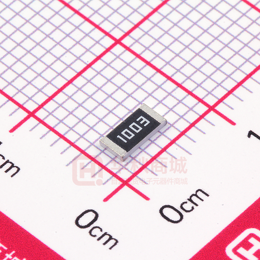

    贴片电阻 2010 100KΩ ±1% 3/4W ±100ppm/℃
FRC2010F1003TS 数据手册
FRC-Series Thick Film Chip Resistor Product Specifications FRC 系列厚膜片式电阻器规格说明书 常规厚膜片式电阻器(Thick Film Chip Resistor ) ■应用(Application) - Entertainment:Stereo,TV tuners,Tape recorder - 娱乐:立体声、电视调谐器、录音机 - Appliance: Air conditioner, Refrigerator - 电器:空调、冰箱 - Computer & relative products : Main board, PDA - 电脑及相关产品:主板、PDA - Communication equipment: Cell phone, Fax machine - 通讯设备:手机、传真机 - Power equipment: Power supply , II Lumination equipment - 电源设备:电源、二级照明设备 - Measuring instrument: Electric meter,Navigation equipment - 测量仪器:电表、导航设备 ■特点(Features) small size and light weight - 体积小、重量轻 - Reliability, high quality - 可靠性,高质量 ■产品料号(Parts Number Explanation) 示例(Example): FRC1206F1001TSD F R C 1206 F 1001 T S D 公司名 产品别 功能别 尺寸 公差 字码 包装别 端电极 特殊码 FOJAN R:Resistor C:Normal 0201 B:±0.1% ±5%:E24 T: 7 inch reel S:Sn N: C:Capacitor P:Hi-Power 0402 C:±0.25% 3-digits+blank Q:10 inch reel C:Cu Normal L:Inductor L:Lowohmic 0603 D:±0.5% 102=1KΩ R:13 inch reel A:Au D:Diode A:Array 0805 F:±1% 1R0=1Ω B:Bulk A:Audion S:Surge 1206 J:±5% ±1%&Below: H:Hi-Precision 1210 P:Jumper E24+E96: V:Hi-Voltage 1218 4-digits Q:Auto-motive 1812 1001=1KΩ R:Anti-sulfur 2010 1R00=1Ω M:Metal 2512 D:LED D: LED Company Type code code FJ-JS-3001-V1.0 / 2021.1.25 Functional Size Tolerance Resistance Packaging Termination Special code code code code code code Case 1 www.fojan.cn FRC-Series Thick Film Chip Resistor Product Specifications FRC 系列厚膜片式电阻器规格说明书 ■本体标识(Marking on the Resistor's Body) 0201 及 0402 因本体太小,本体上无字码标示 For 0201 and 0402 size, no marking on the body due to the small size of the resistor 472=47×102=4.7KΩ 公差±5%的产品,以三字码标示,前两位表示阻值 的有效数字,最后一位表示 10 的乘幂 ±5% tolerance product: the marking is 3 digits, the first 2 digits are significant figures of resistance value and the 3rd one denotes the power number of 10, (10X) 10Ω以下标示:5R6=5.6Ω Below 10Ω: 5R6=5.6Ω ±0.5%, ±1%, ±2%的产品,以四字码标示,前三位 表示阻值的有效数字,最后一位表示 10 的乘幂 ±0.5%, ±1%,±2% tolerance product: the marking is 4 digits, the first 3 digits are significant figures of resistance value and the 4th one denotes the power number of 10, (10X) 4992=499×102=49.9KΩ 0603 ±1% E96 系列的标准阻值,因电阻本体太小, 采用三位代码标示。 Standard E96 series values of 0603 ±1%: due to the small size of the resistor’s body, use 3digits code to indicate the resistance value. 100Ω以下标示: 6R81=6.81Ω Below 100Ω: 6R81=6.81 Ω ■0603±1% E96 系列电阻值代码 Standard E96 Series Resistance Value Code for 0603 代码 阻值 Code Value 01 100 02 102 03 105 04 107 05 110 06 113 07 115 08 118 09 121 10 124 11 127 12 130 13 133 14 137 15 140 16 143 代码 Code 17 18 19 20 21 22 23 24 25 26 27 28 29 30 31 32 FJ-JS-3001-V1.0 / 2021.1.25 阻值 Value 147 150 154 158 162 165 169 174 178 182 187 191 196 200 205 210 代码 Code 33 34 35 36 37 38 39 40 41 42 43 44 45 46 47 48 阻值 Value 215 221 226 232 237 243 249 255 261 267 274 280 287 294 301 309 代码 Code 49 50 51 52 53 54 55 56 57 58 59 60 61 62 63 64 2 阻值 Value 316 324 332 340 348 357 365 374 383 392 402 412 422 432 442 453 代码 Code 65 66 67 68 69 70 71 72 73 74 75 76 77 78 79 80 阻值 Value 464 475 487 499 511 523 536 549 562 576 590 604 619 634 649 665 ±1% Marking 代码 Code 81 82 83 84 85 86 87 88 89 90 91 92 93 94 95 96 阻值 Value 681 698 715 732 750 768 787 806 825 845 866 887 909 931 953 976 www.fojan.cn FRC-Series Thick Film Chip Resistor Product Specifications FRC 系列厚膜片式电阻器规格说明书 ■0603±1%标记的倍增码 Multiplier Code for 0603 代码 Code 指数 Multiplier ±1% Marking Y X A B C D E F 10-2 10-1 100 101 102 103 104 105 阻值标示如下(So the resistance value are marked as the following examples) 10D=124×103=124KΩ 38Y=243×10-2=2.43Ω 0603 ±1%的产品,在标准 E24 系列中,但不属于 E96 系列,标示与 5%的字码相同,但是在中间字码 下加一条线(Standard E24 and not belong to E96 series values of 0603 ±1%, the marking is the same as 5% tolerance but marking as underline) 331=33×101=330Ω ■ 560=56×100=56Ω 尺寸(Dimension): 尺寸 dimension 单位(unit): mm 型别(Type) L W H T1 T2 0201 0.60±0.03 0.30±0.03 0.23±0.03 0.10±0.05 0.15±0.05 0402 1.00±0.05 0.50±0.05 0.35±0.05 0.20±0.10 0.25±0.10 0603 1.60±0.10 0.80±0.10 0.45±0.10 0.25±0.15 0.25±0.15 0805 2.00±0.10 1.25±0.10 0.50±0.10 0.35±0.20 0.35±0.20 1206 3.10±0.10 1.60±0.10 0.55±0.10 0.45±0.20 0.40±0.20 1210 3.10±0.10 2.60±0.15 0.55±0.10 0.45±0.15 0.50±0.20 1218 3.10±0.10 4.60±0.10 0.55±0.10 0.45±0.20 0.40±0.20 1812 4.50±0.20 3.10±0.20 0.55±0.10 0.55±0.20 0.70±0.20 2010 5.00±0.10 2.50±0.15 0.55±0.10 0.45±0.15 0.50±0.20 2512 6.35±0.10 3.10±0.15 0.55±0.10 0.60±0.20 0.50±0.20 FJ-JS-3001-V1.0 / 2021.1.25 3 www.fojan.cn FRC-Series Thick Film Chip Resistor Product Specifications FRC 系列厚膜片式电阻器规格说明书 ■ 功率衰减曲线( Derating Curve) ■ 电阻结构(Construction) NO. 1 2 3 4 5 6 7 8 9 FJ-JS-3001-V1.0 / 2021.1.25 4 结构 construction 主要材料 Major material 陶瓷基板 Ceramic substrate 银电极 Conductive layer 侧电极 Side conductive layer 阻体层 Resistive layer 内保护层 Inner protective layer 外保护层 Outer Protective layer 文字 Marking 镍电极 Ni plating layer 锡电极 Sn plating layer 三氧化二铝 Al2O3 银 Ag 镍铬合金 NiCr 氧化钌+玻璃 RuO2+ glass 玻璃 Glass 环氧树脂 Epoxy 环氧树脂 Epoxy 镍 Ni 锡 Matte Tin www.fojan.cn FRC-Series Thick Film Chip Resistor Product Specifications FRC 系列厚膜片式电阻器规格说明书 ■ 电气特性(Electrical characteristics) 型别 Type 0201 0402 0603 0805 1206 1210 1218 1812 2010 2512 1/20W 1/16W 1/10W 1/8W 1/4W 1/2W 1W 1/2W 3/4W 1W 最大工作电压 Max Working Voltage 25V 50V 75V 150V 200V 200V 200V 200V 200V 200V 最大过负荷电压 Max Overload Voltage 50V 100V 150V 300V 400V 400V 500V 400V 400V 400V 绝缘耐压 Dielectric Withstanding Voltage - 100V 100V 300V 500V 500V 500V 500V 500V 500V 零欧姆阻值 ±1% Resistance Value of Jumper ±1% -
