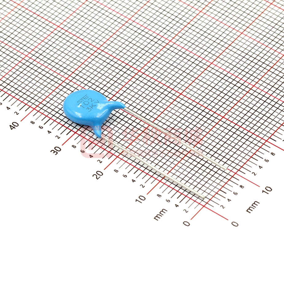

    直插陶瓷电容/独石电容 CAP_D10X3.5MM_TM 1nF ±10% 3KV Y5P
S10B1E102KN0B0S0N0 数据手册
Lead Type Disc High Voltage Ceramic Capacitors-HV Series (500VDC-6.3KVDC) Lead Type Disc High Voltage Ceramic Capacitors-HV Series (500VDC-6.3KVDC) Data Sheet Feature ■Wide capacitance range from 100pF to 100000pF ■Operating Temperature: -25℃~85℃ ■Storage Temperature: 15℃~35℃ ■The high voltage disc ceramic capacitors have feature of withstanding higher voltage Applications ■These capacitors are used in bypass and coupling circuit, and those capacitors with low dissipation factor are particularly suitat be used in cicuits such as line scanning in Tvset Revision: 2018-04-29 1 Email: info@songtian.cn Website: http://www.songtian-ste.com Lead Type Disc High Voltage Ceramic Capacitors-HV Series (500VDC-6.3KVDC) Part Number Code N 07 F 1 B 472 Pitch A:2.5mm B:5.0mm E:7.5mm D:10.0mm Rated Voltage L: 500VDC N: 1KVDC R: 2KVDC S: 3KVDC T: 4KVDC W: 5KVDC A: 6KVDC M N0 B Tolerance C:±0.25pF J±5% :K:±10% M:±20% Foot Type 1:Long straight 2:Outside Crimped 3:Short Straight 4:Inner Crimped 8:Vertical Crimped Temperature Characteristic A:NP0 S:SL B:Y5P E:Y5U F:Y5V S 0 Package B: Bulk T:Tape N 0 Inner Management Environmental Standard 0:RoHS 2:RoHS+Halogen-Free Nominal capacitance 10:100pF 100:101pF 222:2200pF 103:10000pF Core Diameter 04: 4.0mm 05: 5.0mm 16: 16.0mm C0: 5.0mm C4: 5.4mm C6: 5.6mm 0 Lead Length S0~S9:1.0~1.9mm X0~X9:2.0~2.9mm A0~A9:3.0~3.9mm B0~B9:4.0~4.9mm C0~C9:5.0~5.9mm D0~D9:6.0~6.9mm E0~E9:7.0~7.9mm Lead Length F0~F9:8.0~8.9mm G0~G9:9.0~9.9mm H0~H9:10.0~10.9mm J0~J9:11.0~11.9mm K0~K9:12.0~12.9mm L0~L9:13.0~13.9mm M0~M9:14.0~14.9mm Lead Length M0~M9:14.0~14.9mm N0:16~27.0mm(Bulk) Crimped Lead Taped N0:H0=16.5mm P0:H0=17.0mm Q0:H0=19.0mm Straight Lead Q0:20.0mm Specifications Capacitance and Dissipation factor testing condition Dissipation Factor(tanδ) Rated Voltage Withstand Voltage SL/NP0:25℃、1±0.1MHz、1.0Vrms Y5P/Y5U/Y5V:25℃、1±0.1MHz、1.0Vrms SL/NPO:≤0.15% Y5P/Y5U/Y5V:≤2.5% 500VDC、1000VDC、2000VDC、3000VDC、4000VDC、5000VDC、 6000VDC 1.5UR+500V(DC) Insulation Resistance (I.R.) SL/NP0:IR≥10000MΩ;Y5P/Y5U/Y5V:IR≥4000MΩ Temperature Characteristic SL、NP0、Y5P、Y5U、Y5V Revision: 2018-04-29 2 Email: info@songtian.cn Website: http://www.songtian-ste.com Lead Type Disc High Voltage Ceramic Capacitors-HV Series (500VDC-6.3KVDC) Dimensions (mm) Rated Voltage (VDC) 500 1000 2000 Temperature Coefficient Group Y5P (B) Y5U (E) Dimension (mm) Y5V (F) SL NP0 D±1 Lead Size (mm) T±1 F d±0.05 2.0 5.0±0.8 0.5 7.5±0.8 0.6 10.0±0.8 0.7 5.0±0.8 0.5 7.5±0.8 0.6 10.0±0.8 0.6/0.7 5.0±0.8 0.5 7.5±0.8 0.6 Nominal Capacitance(pF) 100-1500 1500-2200 3300-4700 20-150 0.5-22 5.5 / 3300-4700 6800 / / 6.5 2200 5600-6800 6800-10000 / / 7.5 3300 10000 / / / 9.5 4700 / 20000-22000 / / 10.5 10000 / / / / 14.5 / / 47000 / / 17.0 / / 100000 / / 20.0 100-820 / / 20-100 0.5-22 5.5 1000 / / / / 6.0 / 1500-3300 4700-6800 / / 6.5 1500-1800 4700-5600 / / / 7.5 2200-2700 / 10000 / / 8.5 / 6800 15000 / / 9.5 3300 10000 / / / 10.5 4700 / / / / 11.5 / / 20000-22000 / / 13.0 / / 33000 / / 15.0 10000 / 47000 / / 17.5 / / 100000 / / 22.5 100-470 1000 1500-2200 / / 6.0 560-820 / 3300 10-120 0.5-10 7.0 1000 2200 4700 68 / 8.0 1500 4700 6800 / / 10.0 1800-2200 / 10000 / / 11.0 2700 / / / / 12.0 3300 / / / / 13.0 2200 / / / / 14.0 4700 10000 20000-22000 / / 14.5 Revision: 2018-04-29 3 Email: info@songtian.cn 2.5 2.5 2.5/3.0 3.0 Website: http://www.songtian-ste.com Lead Type Disc High Voltage Ceramic Capacitors-HV Series (500VDC-6.3KVDC) Rated Voltage (VDC) 3000 3150 4000 5000 Temperature Coefficient Group Y5P(B) Y5U(E) Dimension (mm) Y5V(F) SL NPO D±1 T±1 3.0/3.5 Lead Size (mm) F d±0.05 7.5±0.8 0.6 Nominal Capacitance(pF) 100-470 680-1000 1500 27-68 3-22 6.0 270-680 / 2200 / / 7.0 / 1500 3300 82 / 8.0 1000 2200 4700 / / 9.0 / 3300 6800-10000 / / 11.0 / 4700 10000 / / 13.0 / 10000 / / / 17.5 / / 20000-22000 / / 20.5 100-470 1000 1500 10-39 / 6.0 680 / 2200 47-68 / 7.0 / 1500 3300 82 / 8.0 1000 2200 4700 / / 9.0 1500 3200 / / / 11.0 2200 4700 / / / 13.0 / / 10000 / / 14.0 10.0 / 10000 / / / 17.5 ±0.8 100-470 680-1000 1500 10-68 3-22 6.0 270-680 / 2200 / / 7.0 / 1500 3300 82 / 8.0 1000 2200 4700 / / 9.0 / 3300 6800-10000 / / 11.0 / 4700 10000 / / 13.0 / 10000 / / / 17.5 / / 20000-22000 / / 20.5 100-220 330-470 1000 10-39 / 6.0 330 560-1000 1500 47-56 / 7.0 470 / 2200 68-82 / 8.0 560-680 1500 / / / 9.0 / 2200 3300 / / 10.0 1000 / 4700 / / 11.0 / 3300 / / / 13.5 / 4700 / / / 16.5 Revision: 2018-04-29 4 Email: info@songtian.cn 3.5 10.0 ±0.8 7.5±0.8 0.6/0.7 0.6 3.5 0.7 3.0/3.5 7.5±0.8 0.6 3.5 10.0 ±0.8 0.6/0.7 3.5/4.5 10.0 4.5 ±0.8 0.6/0.7 Website: http://www.songtian-ste.com Lead Type Disc High Voltage Ceramic Capacitors-HV Series (500VDC-6.3KVDC) Rated Voltage (VDC) 6000 6300 Temperature Coefficient Group Y5P(B) Y5U(E) Dimension (mm) Y5V(F) SL NPO D±1 T±1 3.5/4.5 Lead Size (mm) F d±0.05 Nominal Capacitance(pF) 100-220 330-470 1000 10-39 / 6.0 330 560-1000 1500 47-56 / 7.0 470 / 2200 68-82 / 8.0 560-680 1500 / / / 9.0 / 2200 3300 / / 10.0 1000 / 4700 / / 11.0 / 3300 / / / 13.5 / 4700 / / / 16.5 100-220 1000 / 10-39 / 6.0 330 / / 47-68 / 7.0 470 / 2200 82 / 8.0 10.0 680 / / / / 9.0 ±0.8 1000 2200 3300 / / 10.0 / / 4700 / / 11.0 Revision: 2018-04-29 5 Email: info@songtian.cn 10.0 4.5 ±0.8 0.6/0.7 3.5/4.5 4.5 0.6/0.7 Website: http://www.songtian-ste.com Lead Type Disc High Voltage Ceramic Capacitors-HV Series (500VDC-6.3KVDC) Lead Configuration Lead Style Lead Length L (mm) Drawing Long Straight 16.0 min Coating Lead Length C (mm) ①C≤2.5mm (Product diameter﹤12mm) ②C≤3.0mm (Product diameter≥12mm) ①[2.5≤L<6.0]+/-0.5; ②[6.0≤L≤10]+/-1.0 Short Straight ①C≤2.5mm (Product diameter﹤12mm) ②C≤3.0mm (Product diameter≥12mm) Outside Crimped ①[2.5≤L<6.0]+/-0.5; ②[6.0≤L≤10]+/-1.0 Not exceed the bend point Inner Crimped ①[2.5≤L<6.0]+/-0.5; ②[6.0≤L≤10]+/-1.0 Not exceed the bend point Vertical Crimped ①[2.5≤L<6.0]+/-0.5; ②[6.0≤L≤10]+/-1.0 Not exceed the bend point Revision: 2018-04-29 6 Email: info@songtian.cn Website: http://www.songtian-ste.com Lead Type Disc High Voltage Ceramic Capacitors-HV Series (500VDC-6.3KVDC) Taping And Dimensions (mm) Fig.1 Fig.2 Figure Fig.1 (P=5.0) Symbol P=5.0 P=7.5 P=10.0 Po 12.7±0.3 12.7±0.3 12.7±0.3 P 12.7±1.0 25.4±1.0 25.4±1.0 P1 3.85±0.7 8.95±0.7 7.7±0.7 P2 6.35±1.3 12.7±1.3 12.7±1.3 F 5±0.8 7.5±0.8 10.0±0.8 Δh 0±2.0 0±2.0 0±2.0 W 18.0+1.5/-1.0 18.0 +1.5/-1.0 18.0 +1.5/-1.0 Wo 10.5 Max 10.5 Max 10.5 Max W1 9.0+0.75/-0.5 9.0+0.75/-0.5 9.0+0.75/-0.5 W2 3.0 Max 3.0 Max 3.0 Max Do 4.0±0.2 4.0±0.2 4.0±0.2 H 20+1.5/-1.0 20+1.5/-1.0 20+1.5/-1.0 16.5&17.0&19.0 16.5&17.0&19.0 16.5&17.0&19.0 Ho +1.5/-1.0 +1.5/-1.0 +1.5/-1.0 Straight Lead Crimped Lead Straight Lead Crimped Lead Straight Lead Crimped Lead 11.0 Max 9.0 Max 11.0 Max 9.0 Max 11.0 Max 9.0 Max L Fig.2 (P=7.5 & 10) Revision: 2018-04-29 t1 0.5±0.2 0.5±0.2 0.5±0.2 t2 1.7 Max 1.7 Max 1.7 Max 7 Email: info@songtian.cn Website: http://www.songtian-ste.com
S10B1E102KN0B0S0N0
物料型号:松田STE系列高压陶瓷电容器,型号编码规则包括容值、电压等级、公差等信息。
器件简介:这些电容器能承受较高的电压,适用于旁路和耦合电路,尤其是低耗散因数的电容器,适合用于电视扫描线等电路。
引脚分配引脚分配包括长直引脚、短直引脚、外卷曲引脚、内卷曲引脚和垂直卷曲引脚,具体长度和类型根据产品直径和需求有所不同。
参数特性:包括电容范围(100pF至100000pF)、工作温度(-25℃至85℃)、存储温度(15℃至35℃)、额定电压(500VDC至6300VDC)、耐压电压、绝缘电阻和温度特性等。
功能详解:电容器的功能包括在电路中提供稳定电压、滤除噪声和信号耦合等。
应用信息:适用于电视扫描线电路、电源滤波、脉冲电路等。
封装信息:提供了详细的尺寸信息,包括直径、高度、引脚长度和卷曲类型等。
