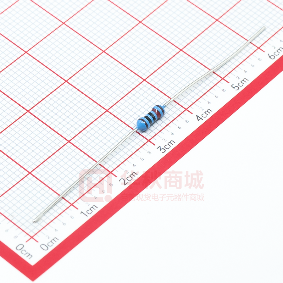

    插件,D2.4xL6.3mm
    插件电阻 120Ω ±1% 500mW ±50ppm/℃
