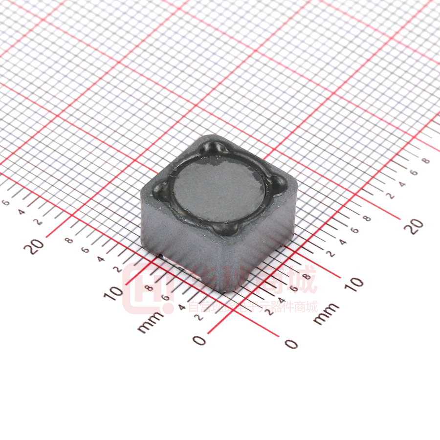

    SMD,12x12mm
    功率电感 68µH ±20% 140mΩ IND_12X12MM_SM
SLH1207S680MTT 数据手册
SLH Series Shielded High Current SMD Power Inductor ◆ Features Pb 1.Magnetic Shielded surface mount inductor with high current rating. 2.Low resistance to keep power loss minimum. 3.The products contain no lead and also support lead-free soldering. ◆ Applications Excellent for power line DC-DC conversion applications used in hard disk, notebook computers and other electronic equipment. ◆ Lead Free Part Numbering SLH 1204 (1) (2) (1) (2) (3) (4) (5) (6) (7) S (3) 100 M (4) (5) T T (6) (7) Series Type Dimension A X C Material Code Inductance 2R2=2.2μH : : ; 100=10μH;101=100μH Inductance Tolerance:M=±20%, Y=±30% Company Code Packaging : packed in embossed carrier tape ◆ Dimensions Series A(mm) B(mm) C(mm) D(mm) E(mm) SLH0703S SLH0704S SLH1204S SLH1205S SLH1207S 7.3±0.3 7.3±0.3 12.0±0.3 12.0±0.3 12.0±0.3 7.3±0.3 7.3±0.3 12.0±0.3 12.0±0.3 12.0±0.3 3.5 Max. 4.5 Max. 5.0 Max. 6.0 Max. 8.0 Max. 1.8±0.2 1.8±0.2 5.0±0.2 5.0±0.2 5.0±0.2 5.0±0.2 5.0±0.2 7.6±0.2 7.6±0.2 7.6±0.2 Rev.02 Page 1 of 7 www.sunltech.com SLH Series ◆ Specification Inductance (µH) Test Frequency (Hz) DCR (mΩ) max. IDC (A) max. SLH0703SR47MTT 0.47±20% 1KHz/1V 17 10.50 SLH0703S1R0MTT 1.0±20% 1KHz/1V 17 7.00 SLH0703S1R5MTT 1.5±20% 1KHz/1V 17 6.00 SLH0703S2R2MTT 2.2±20% 1KHz/1V 25 4.50 SLH0703S3R3MTT 3.3±20% 1KHz/1V 25 4.20 SLH0703S4R7MTT 4.7±20% 1KHz/1V 58 3.65 SLH0703S6R8MTT 6.8±20% 1KHz/1V 58 3.00 SLH0703S100MTT 10±20% 1KHz/1V 69 2.30 SLH0703S120MTT 12±20% 1KHz/1V 83 2.20 SLH0703S150MTT 15±20% 1KHz/1V 108 2.00 SLH0703S180MTT 18±20% 1KHz/1V 125 1.80 SLH0703S220MTT 22±20% 1KHz/1V 158 1.50 SLH0703S330MTT 33±20% 1KHz/1V 232 1.20 SLH0703S390MTT 39±20% 1KHz/1V 282 0.90 SLH0703S400MTT 40±20% 1KHz/1V 291 0.90 SLH0703S470MTT 47±20% 1KHz/1V 374 0.80 SLH0703S560MTT 56±20% 1KHz/1V 415 0.70 SLH0703S680MTT 68±20% 1KHz/1V 432 0.61 SLH0703S820MTT 82±20% 1KHz/1V 573 0.55 SLH0703S101MTT 100±20% 1KHz/1V 656 0.50 SLH0703S151MTT 150±20% 1KHz/1V 830 0.46 SLH0703S181MTT 180±20% 1KHz/1V 913 0.39 SLH0703S221MTT 220±20% 1KHz/1V 1370 0.38 SLH0703S271MTT 270±20% 1KHz/1V 1917 0.36 SLH0703S331MTT 330±20% 1KHz/1V 2175 0.35 SLH0703S471MTT 470±20% 1KHz/1V 3469 0.32 SLH0703S681MTT 680±20% 1KHz/1V 4756 0.30 SLH0703S821MTT 820±20% 1KHz/1V 5810 0.27 SLH0703S102MTT 1000±20% 1KHz/1V 8018 0.23 Part Number SLH0703 Series Rev.02 Page 2 of 7 www.sunltech.com SLH Series ◆ Specification Inductance (µH) Test Frequency (Hz) DCR (mΩ) max. IDC (A) max. SLH0704S1R0MTT 1.0±20% 1KHz/1V 12 9.00 SLH0704S1R2MTT 1.2±20% 1KHz/1V 21 8.00 SLH0704S1R5MTT 1.5±20% 1KHz/1V 25 8.00 SLH0704S1R8MTT 1.8±20% 1KHz/1V 27 7.00 SLH0704S2R2MTT 2.2±20% 1KHz/1V 29 6.20 SLH0704S2R7MTT 2.7±20% 1KHz/1V 33 5.50 SLH0704S3R3MTT 3.3±20% 1KHz/1V 37 4.70 SLH0704S4R7MTT 4.7±20% 1KHz/1V 39 3.50 SLH0704S6R2MTT 6.2±20% 1KHz/1V 42 3.40 SLH0704S6R8MTT 6.8±20% 1KHz/1V 42 3.40 SLH0704S7R0MTT 7.0±20% 1KHz/1V 43 3.30 SLH0704S7R7MTT 7.7±20% 1KHz/1V 44 3.10 SLH0704S100MTT 10±20% 1KHz/1V 46 3.00 SLH0704S150MTT 15±20% 1KHz/1V 67 2.50 SLH0704S180MTT 18±20% 1KHz/1V 83 2.00 SLH0704S220MTT 22±20% 1KHz/1V 91 1.95 SLH0704S270MTT 27±20% 1KHz/1V 106 1.50 SLH0704S330MTT 33±20% 1KHz/1V 208 1.20 SLH0704S390MTT 39±20% 1KHz/1V 249 1.10 SLH0704S470MTT 47±20% 1KHz/1V 266 1.00 SLH0704S560MTT 56±20% 1KHz/1V 291 1.00 SLH0704S680MTT 68±20% 1KHz/1V 315 0.90 SLH0704S101MTT 100±20% 1KHz/1V 506 0.85 SLH0704S121MTT 120±20% 1KHz/1V 540 0.85 SLH0704S151MTT 150±20% 1KHz/1V 730 0.75 SLH0704S171MTT 170±20% 1KHz/1V 1079 0.74 SLH0704S181MTT 180±20% 1KHz/1V 1121 0.70 SLH0704S221MTT 220±20% 1KHz/1V 1162 0.62 SLH0704S271MTT 270±20% 1KHz/1V 1245 0.55 SLH0704S331MTT 330±20% 1KHz/1V 1245 0.50 SLH0704S391MTT 390±20% 1KHz/1V 1494 0.48 SLH0704S471MTT 470±20% 1KHz/1V 2158 0.40 Part Number SLH0704 Series Rev.02 Page 3 of 7 www.sunltech.com SLH Series ◆ Specification Inductance (µH) Test Frequency (Hz) DCR (mΩ) max. IDC (A) max. SLH1204S3R9YTT 3.9±30% 1V/100K 15 6.50 SLH1204S4R7YTT 4.7±30% 1V/100K 18 5.70 SLH1204S6R8YTT 6.8±30% 1V/100K 23 4.90 SLH1204S8R2YTT 8.2±30% 1V/100K 26 4.60 SLH1204S100MTT 10±20% 1V/100K 28 4.50 SLH1204S120MTT 12±20% 1V/100K 38 4.10 SLH1204S150MTT 15±20% 1V/100K 50 3.20 SLH1204S180MTT 18±20% 1V/100K 57 3.10 SLH1204S220MTT 22±20% 1V/100K 66 2.90 SLH1204S270MTT 27±20% 1V/100K 80 2.80 SLH1204S330MTT 33±20% 1V/100K 97 2.70 SLH1204S390MTT 39±20% 1V/100K 132 2.10 SLH1204S470MTT 47±20% 1V/100K 160 1.90 SLH1204S560MTT 56±20% 1V/100K 190 1.80 SLH1204S680MTT 68±20% 1V/100K 220 1.50 SLH1204S820MTT 82±20% 1V/100K 260 1.30 SLH1204S101MTT 100±20% 1V/100K 308 1.20 SLH1204S121MTT 120±20% 1V/100K 380 1.10 SLH1204S151MTT 150±20% 1V/100K 530 0.95 SLH1204S181MTT 180±20% 1V/100K 620 0.85 SLH1204S221MTT 220±20% 1V/100K 700 0.80 SLH1204S271MTT 270±20% 1V/100K 870 0.60 SLH1204S331MTT 330±20% 1V/100K 990 0.50 Part Number SLH1204 Series Rev.02 Page 4 of 7 www.sunltech.com SLH Series ◆ Specification Inductance (µH) Test Frequency (Hz) DCR (mΩ) max. IDC (A) max. SLH1205S1R3YTT 1.3±30% 1V/7.96M 12 8.00 SLH1205S2R1YTT 2.1±30% 1V/7.96M 14 7.00 SLH1205S3R1YTT 3.1±30% 1V/7.96M 17 6.00 SLH1205S4R4YTT 4.4±30% 1V/7.96M 2 5.00 SLH1205S5R8YTT 5.8±30% 1V/7.96M 21 4.40 SLH1205S7R5YTT 7.5±30% 1V/7.96M 24 4.20 SLH1205S100MTT 10±20% 1V/1K 25 4.00 SLH1205S120MTT 12±20% 1V/1K 27 3.50 SLH1205S150MTT 15±20% 1V/1K 30 3.30 SLH1205S180MTT 18±20% 1V/1K 34 3.00 SLH1205S220MTT 22±20% 1V/1K 36 2.80 SLH1205S270MTT 27±20% 1V/1K 51 2.30 SLH1205S330MTT 33±20% 1V/1K 57 2.10 SLH1205S390MTT 39±20% 1V/1K 68 2.00 SLH1205S470MTT 47±20% 1V/1K 75 1.80 SLH1205S560MTT 56±20% 1V/1K 110 1.70 SLH1205S680MTT 68±20% 1V/1K 120 1.50 SLH1205S820MTT 82±20% 1V/1K 140 1.40 SLH1205S101MTT 100±20% 1V/1K 160 1.30 SLH1205S121MTT 120±20% 1V/1K 170 1.10 SLH1205S151MTT 150±20% 1V/1K 230 1.00 SLH1205S181MTT 180±20% 1V/1K 290 0.90 SLH1205S221MTT 220±20% 1V/1K 400 0.80 SLH1205S271MTT 270±20% 1V/1K 460 0.75 SLH1205S331MTT 330±20% 1V/1K 510 0.68 SLH1205S391MTT 390±20% 1V/1K 690 0.65 SLH1205S471MTT 470±20% 1V/1K 770 0.58 SLH1205S561MTT 560±20% 1V/1K 860 0.54 SLH1205S681MTT 680±20% 1V/1K 1200 0.48 SLH1205S821MTT 820±20% 1V/1K 1340 0.43 SLH1205S102MTT 1000±20% 1V/1K 1530 0.4 Part Number SLH1205 Series Rev.02 Page 5 of 7 www.sunltech.com SLH Series ◆ Specification Inductance (µH) Test Frequency (Hz) DCR (mΩ) max. IDC (A) max. SLH1207S1R2YTT 1.2±30% 1V/100K 7.0 9.80 SLH1207S2R4YTT 2.4±30% 1V/100K 11.5 8.00 SLH1207S3R5YTT 3.5±30% 1V/100K 13.5 7.50 SLH1207S3R9YTT 3.9±30% 1V/100K 14.5 7.00 SLH1207S4R7YTT 4.7±30% 1V/100K 15.8 6.80 SLH1207S6R1YTT 6.1±30% 1V/100K 17.6 6.60 SLH1207S7R6YTT 7.6±30% 1V/100K 20.0 5.90 SLH1207S100MTT 10±20% 1V/1K 21.6 5.40 SLH1207S120MTT 12±20% 1V/1K 24.3 4.90 SLH1207S150MTT 15±20% 1V/1K 27.0 4.50 SLH1207S180MTT 18±20% 1V/1K 39.2 3.90 SLH1207S220MTT 22±20% 1V/1K 43.2 3.60 SLH1207S270MTT 27±20% 1V/1K 45.9 3.40 SLH1207S330MTT 33±20% 1V/1K 64.8 3.00 SLH1207S390MTT 39±20% 1V/1K 72.9 2.75 SLH1207S470MTT 47±20% 1V/1K 100 2.50 SLH1207S560MTT 56±20% 1V/1K 110 2.35 SLH1207S680MTT 68±20% 1V/1K 140 2.10 SLH1207S820MTT 82±20% 1V/1K 160 1.95 SLH1207S101MTT 100±20% 1V/1K 220 1.70 SLH1207S121MTT 120±20% 1V/1K 250 1.60 SLH1207S151MTT 150±20% 1V/1K 280 1.42 SLH1207S181MTT 180±20% 1V/1K 350 1.30 SLH1207S221MTT 220±20% 1V/1K 390 1.16 SLH1207S271MTT 270±20% 1V/1K 560 1.06 SLH1207S331MTT 330±20% 1V/1K 640 0.95 SLH1207S391MTT 390±20% 1V/1K 700 0.88 SLH1207S471MTT 470±20% 1V/1K 980 0.79 SLH1207S561MTT 560±20% 1V/1K 1070 0.73 SLH1207S681MTT 680±20% 1V/1K 1460 0.67 SLH1207S821MTT 820±20% 1V/1K 1640 0.60 SLH1207S102MTT 1000±20% 1V/1K 1820 0.55 Part Number SLH1207 Series Rev.02 Page 6 of 7 www.sunltech.com SLH Series ◆ Note 1. Inductance measured by LCR Meter HP 4284A or equivalent. 2. DCR measured by Milliohm meter HP 4338B or equivalent. 3. Rated current is measured by LCR-meter 3260B (WK) & DC Bias 3265B(WK). 4. Maximum allowable DC current is that which causes a 25% inductance reduction from the initial value, or coil temperature to rise by 40 Rev.02 ℃, whichever is smaller. (Reference ambient temperature 25℃). Page 7 of 7 www.sunltech.com
