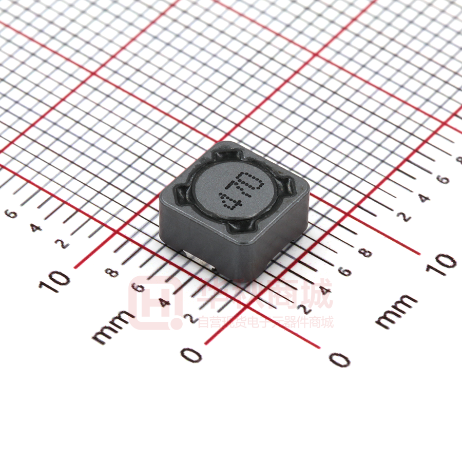

SLH Series
Shielded High Current SMD Power Inductor
◆ Features
Pb
1.Magnetic Shielded surface mount inductor with
high current rating.
2.Low resistance to keep power loss minimum.
3.The products contain no lead and also support
lead-free soldering.
◆ Applications
Excellent for power line DC-DC conversion
applications used in hard disk, notebook computers
and other electronic equipment.
