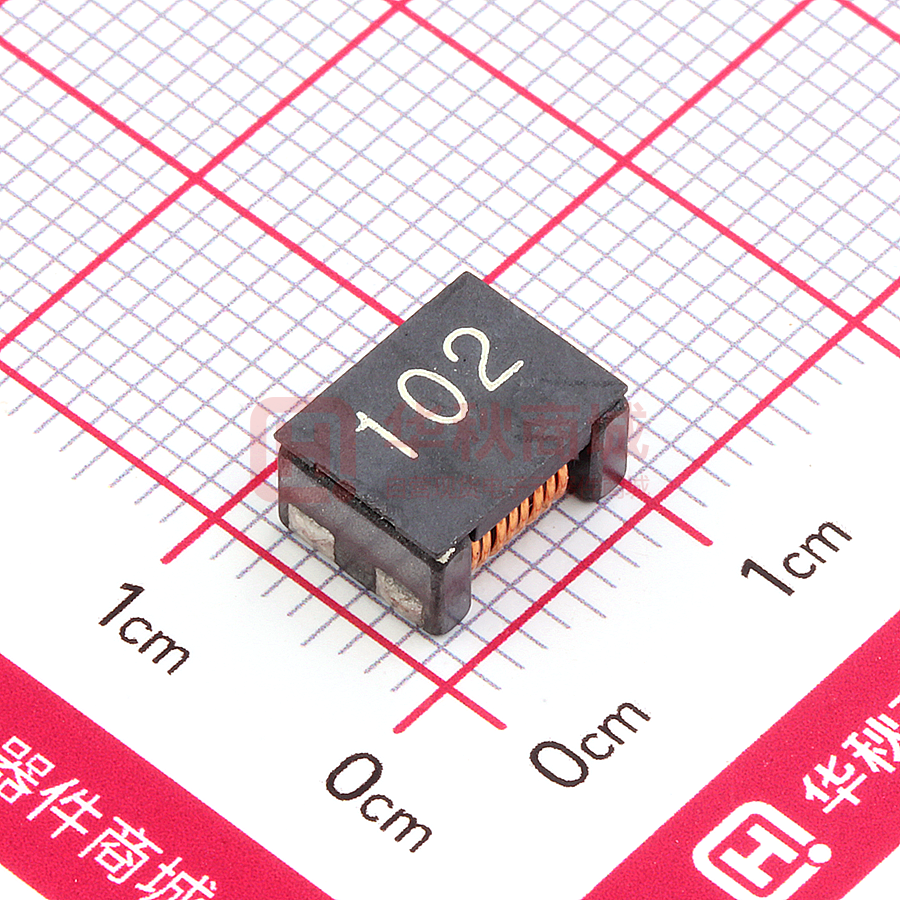

    CHOKE_9X7MM_SM
    共模电感 OriginalμH 4A 13Ω 1KΩ CHOKE_9X7MM_SM
SMW9070S102NTT 数据手册
SMW9070S /DIMENSION( UNIT :mm) A 9.0±0.5 A1 9.5±0.5 B 7.0±0.5 C 4.8Max D 5.7Typ E 1.5±0.2 F 2.0±0.2 G 1.7±0.2 Mark /CIRCUIT DIAGRAM ELECTRICAL CHARACTERISTIC Ω P/N Z( ) @100MHz Min Typ RDC (mΩ) Max Rated Current (A) Max IR (MΩ) Min Rated Voltage (V) Max SMW9070S301RTT 225 300 6 6.0 10 50 301 SMW9070S501PTT 450 600 8 5.0 10 50 501 SMW9070S701PTT 500 700 10 5.0 10 50 701 SMW9070S102NTT 750 1000 13 4.0 10 50 102 SMW9070S222KTT 1700 2200 60 2.5 10 50 222 測試儀器 Z(Ω):HP4395A RDC(Ω):CH502BC Rated Current(A):CH1062A+CH1320 IR(MΩ):CH19073 Rated Voltage(V):CH9052 Rev.01 注意事項 1.平贴度为 0.10mmMax. 2.特性测试方法 Page 1 of 4 www. sunltech.com SMW9070S MATERIAL LIST NO. ITEM DESCRIPTION SUPPLIER 1 CORE FERRITE SINCORES OR EQ 2 WIRE 2UEW P180 ELEKTRISOLA OR EQ 3 膠帶 DM 胶带 HENGRENXIN OR EQ 4 SOLDER Sn Cu SHENMAO OR EQ 5 EPOXY ME-5890 PENGNO OR EQ 6 INK 黑色 BON MARK TAPING SPECFICATIONS 起始字需对准定位孔,印字仅供參考 Transparent carrier and cover tape/透明载带和覆盖带 Adhesive strength of cover tape is 20 to 120 gf The conduction band direction ° 80 165~1 Rev.01 Page 2 of 4 www. sunltech.com SMW9070S RELIABILITY TESTING ℃ ( Contain Heating coil ) Operating Temperature - 30 to + 100 Appearance Inspection No external defects by visual inspection Terminal Strength After soldering , between copper plaet and terminals of coils , push in two directions of X , Y with standing 10N(1.02kg) for10+/-2 sec. Terminal should not peel off. ( Refer to figure at right ) Heat endurance of reflow Refer to figure soldering Insulating resistance Over 100 MΩ at 100V D.C . between wire and core . Dielectric Strength Apply at 0.5KV 3mA for 1 minute between wire and core . Temperature characteristics Inductance coefficient ( 0~2,000 ) × 10 / Humidity characteristics Inductance deviation within ± 10% , after 96 hours in 90~95% relative humidity at 40 ± 2 ℃( - 30 ~ + 100 ℃ ) ℃ and 1 hours drying under normal condition . A test is made under the above mentioned condition , and it is kept for 2 hours in the normal IR Reflow profile Temperature ℃ 300 250 Soldering 255 ℃ 200 150 preheating Natural cooling 100 50 Time 1 to 4 min 10 sec more than 2 min Temperature and humidity . After that , no mechanical and electrical defect should be found . Rev.01 Page 3 of 4 www. sunltech.com SMW9070S 七.包装方式/PACKING LIST 1、轮盘规格:13'(直径 330mm) 数量:700PCS/盘 Label 作业说明:A.摆料方向为字首朝导带孔. B.载带尾部用美纹胶纸固定. 2、数量:700PCS/袋. 作业说明:编带检查好的产品装进 PE 中. 3、数量:1400PCS/盒 作业说明:标签朝上装入内盒里面,将内盒盖扣好. ITEM NO. Q'TY: PCS N.W: PCS G.W: PCS Rev.01 4、数量:7000PCS/箱. 作业说明:A.先将内、外箱底部封好,内箱装进外箱里面. B.将内盒装进内、外箱里面,并用透明胶带封好外箱顶部. C.在外箱位置贴一张外箱标签. D.当尾数箱不足一整箱时需用内盒或填充物装满. Page 4 of 4 www. sunltech.com
