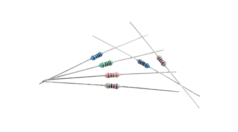

    金属膜电阻 AXIAL_D5X15.5MM_TM 3.3Ω ±1% 3W
MFR3WSFTF73-3R3 数据手册
DATA A SHEET METAL FILM RESISTORS General Purpose MFR Series ±0.5%, ±1%, ±2%, ±5% 1/6W to 3W Product specification – September 28, 2021 V.1 RoHS compliant & Halogen Free Through Hole Resistors Metal Film Resistors Product Specification ORDERING INFORMATION Part number of the general purpose metal film resistor are identified by the series, power rating, tolerance, packing,, temperature coefficient, forming and resistance value. PART NUMBER APPLICATIONS Ÿ All general purpose applications Ÿ Power applications MFR 200 F T F 73- 100R (1) (2) (3) (4) (5) (6) (7) (1) SERIES MFR S Series (2) POWER RATING -12 12 = 1/6W -50 = 1/2W 200 = 2W 25S = 1/4W 100 = 1W 3WS = 3W Ÿ AEC-Q200 qualified -25 25 = 1/4W 2WS = 2W 1WS = 1W Ÿ Wide resistance range 50S = 1/2W F = ±1% G = ±2% ± T = Box Pack B = Bulk EATURES Ÿ PPAP ready (MFR-25/MFR50S/MFR-50) (3) TOLERANCE Ÿ High stability D = ±0.5% Ÿ RoHS compliant & halogen-free J = ±5% (4) PACKAGING R = Reel Pack (5) TEMPERATURE COEFFICIENT OF RESISTANCE E E=±50ppm/°C F=±100ppm/°C - = Based on spec (6) FORMING 26 26- = 26mm FFK = F-form form Kink 52 52- = 52.4mm FKK = FKK Type 73 73- = 73mm MT = MT Type Forming M=M M-Type Forming MB = M-form W/fla FT = FT Type Forming F = F Type AV = AVIsert PN = PANAsert FK = FK Type 52A=52.4mm 52A=52.4mm, ψd 0.4±0.02mm 52B=52.4mm 52B=52.4mm, ψd 0.45±0.02mm 52C=52.4mm 52C=52.4mm, ψd 0.5±0.02mm 52G=52.4mm 52G=52.4mm, ψd ≥ 0.6mm 52H=52.4mm , non-painting on soldering spots (7)) RESISTANCE VALUE E24 & E96 & E192 Series Example: 100 100R = 100Ω, 10K = 10,000Ω, 1M = 1,000,000Ω www.yageo.com Sep. 28, 2021 V.0 2 16 MFR Through Hole Resistors Product Specification Metal Film Resistors MFR DIMENSIONS Unit: mm Normal Miniature L ψD H ψd MFR-12 MFR25S 3.4 ± 0.3 1.9 ± 0.2 28 ± 2.0 0.45 ± 0.05 MFR-25 MFR50S 6.3 ± 0.5 2.4 ± 0.2 28 ± 2.0 0.55 ± 0.05 MFR-50 MFR1WS 9.0 ± 0.5 3.3 ± 0.3 26 ± 2.0 0.55 ± 0.05 MFR100 MFR2WS 11.5 ± 1.0 4.5 ± 0.5 35 ± 2.0 0.8 ± 0.05 MFR200 MFR3WS 15.5 ± 1.0 5.0 ± 0.5 33 ± 2.0 0.8 ± 0.05 DERATING CURVE Rated Power (%) 100 80 60 40 20 20 40 70 100 155 Ambient Temperature (°C) ELECTRICAL CHARACTERISTICS CHARACTERISTICS MFR-12 MFR25S MFR-25 MFR50S MFR-50 MFR1WS MFR100 MFR2WS MFR3WS Power Rating at 70 °C 1/6W 1/4W 1/4W 1/2W 1/2W 1W 1W 2W 3W Maximum Working Voltage 200V 200V 250V 300V 350V 400V 500V 500V 500V Maximum Overload Voltage 400V 400V 500V 600V 700V 800V 1000V 1000V 1000V Voltage Proof on Insulation 300V 400V 500V 500V 500V 700V 1000V 1000V 1000V Resistance Range 1Ω ~ 4M7Ω for E24 & E96 series value Operating Temp. Range - 55°C to +155°C Temperature Coefficient ±50ppm/°C , ±100ppm/°C Note: For resistance value out of above range is by request. www.yageo.com Sep. 28, 2021 V.0 3 16 Through Hole Resistors Metal Film Resistors Product Specification MFR TEST AND REQUIRMENTS TEST TEST METHOD Short Time Overload IEC 60115-1 4.13 PROCEDURE APPRAISE 2.5 times RCWV for 5 sec.(Not more than ±0.25%+0.05Ω maximum overload voltage) Voltage Proof on IEC 60115-1 4.7 Insulation In V-Block for 60 sec. test voltage as No Breakdown above table Temperature Coefficient IEC 60115-1 4.8 Between -55°C to +155°C By Type Insulation Resistance IEC 60115-1 4.6 In V-Block for 60 sec. >10,000MΩ Solderability IEC 60115-1 4.17 245±5°C for 3±0.5 Sec. 95% Min. coverage Solvent Resistance of IEC 60115-1 4.30 IPA for 5±0.5 Min. with ultrasonic No deterioration of Marking coatings and markings Robustness of IEC 60115-1 4.16 Terminations Periodic-pulse Overload Direct load for 10 Sec. in the direction of ≥2.5Kg(24.5N) the terminal leads IEC 60115-1 4.39 4 times RCWV 10,000 cycles (1 Sec. on, ±1.0%+0.05Ω 25 Sec.off) Damp Heat Steady State IEC 60115-1 4.24 40±2°C,90-95% RH for 56 days, loaded ±1.5%+0.05Ω with 0.1 times RCWV Endurance at 70°C IEC 60115-1 4.25 70±2°C at RCWV(or Umax., whichever ±1.5%+0.05Ω less) for 1,000 Hr.(1.5 Hr.on,0.5 Hr. off) Temperature Cycling IEC 60115-1 4.19 è -55°C è Room Temp. è ±0.75%+0.05Ω +155°C Room Temp.(5 cycles) Resistance to Soldering IEC 60115-1 4.18 Heat 260±3°C for 10±1 Sec., immersed to a ±0.25%+0.05Ω point 3±0.5mm from the body Note: RCWV (Rated Continuous Working Voltage ): The DC or AC (rms) continuous working voltage corresponding to the rated power is determined by the following formula: V=√(P X R) or max. working voltage whichever is less Where V=Continuous rated DC or AC (rms) working voltage (V) P=Rated power (W) R=Resistance value (Ω) www.yageo.com Sep. 28, 2021 V.0 4 16 Through Hole Resistors Metal Film Resistors Product Specification MFR PULSE DIAGRAMS MFR25S Series: Pmax.: Maximum permissible peak pulse power ti: Pulse duration tp: Pulse repetition time MFR50S Series: Pmax.: Maximum permissible peak pulse power ti: Pulse duration tp: Pulse repetition time www.yageo.com Sep. 28, 2021 V.0 5 16 Through Hole Resistors Metal Film Resistors Product Specification MFR AXIAL / REEL TAPE SPECIFICATION Unit: mm Normal Miniature a MFR-12 MFR25S 6 ± 0.5 MFR-25 MFR50S 6 ± 0.5 MFR-50 MFR1WS 6 ± 0.5 MFR100 MFR2WS 6 ± 0.5 MFR200 MFR3WS 6 ± 0.5 A B1-B2 (Max.) 52.4 ± 1.5 1.2 26.0 ± 1.5 1.0 52.4 ± 1.5 1.2 26.0 ± 1.5 1.0 52.4 ± 1.5 1.2 73.0 ± 1.5 1.5 52.4 ± 1.5 1.2 73.0 ± 1.5 1.5 52.4 ± 1.5 1.2 S (spacing) T (max. deviation of spacing) 5 5 5 1 mm per 10 spacing, 0.5 mm per 5 spacing 5 10 www.yageo.com Sep. 28, 2021 V.0 6 16 Through Hole Resistors Metal Film Resistors Product Specification MFR TAPE ON REEL PACKING TYPE Unit: mm/piece Normal Miniature Across Flange(A) B Quantity Per Reel MFR-12 MFR25S 66.5 75.5 5,000 MFR-25 MFR50S 66.5 75.5 5,000 MFR-50 MFR1WS 66.5 75.5 2,500 MFR100 MFR2WS 87 96 2,000 MFR200 MFR3WS 87 96 1,000 www.yageo.com Sep. 28, 2021 V.0 7 16 Through Hole Resistors Metal Film Resistors Product Specification MFR TAPE ON BOX PACKING TYPE DIMENSIONS Unit: mm/piece Normal Miniature A B C Quantity Per Box MFR-12 MFR25S 48 102 255 5,000 MFR-12 MFR25S 81 70 260 5,000 MFR-25 MFR50S 48 102 255 5,000 MFR-25 MFR50S 81 104 260 5,000 MFR-50 MFR1WS 73 45 258 1,000 MFR100 MFR2WS 81 91 260 1,000 MFR100 MFR2WS 103 78 260 1,000 MFR200 MFR3WS 81 91 260 1,000 MFR200 MFR3WS 103 94 260 1,000 BULK PACKING Normal Miniature Piece/Per Inner Box Bag/Per Inner Box Piece Per Bag MFR-12 MFR25S 10,000 10 1,000 MFR-25 MFR50S 10,000 10 1,000 MFR-50 MFR1WS 5,000 5 1,000 MFR100 MFR2WS 2,000 4 500 MFR200 MFR3WS 1,000 2 500 www.yageo.com Sep. 28, 2021 V.0 8 16 Through Hole Resistors Metal Film Resistors Product Specification MFR FORMING M TYPE TYPE DIMENSIONS Unit: mm Normal Miniature L ψD ψd MFR-12 MFR25S 3.4± 0.3 1.9 ± 0.2 0.45 ± 0.05 6.0 ± 1 10.0 ±1 MFR-25 MFR50S 6.3 ± 0.5 2.4 ± 0.2 0.55 ± 0.05 10.0 ± 1 10.0 ± 1 MFR-50 MFR1WS 9.0 ± 0.5 3.3± 0.3 0.55 ± 0.05 12.5 ± 1 10.0 ± 1 MFR100 MFR2WS 11.5 ± 1.0 4.5 ± 0.5 0.8 ± 0.05 15.0 ± 1 12.5 ± 1 MFR200 MFR3WS 15.5 ± 1.0 5.0 ± 0.5 0.8 ± 0.05 20.0 ± 1 15.0 ± 1 P H MB TYPE www.yageo.com Sep. 28, 2021 V.0 9 16 Through Hole Resistors Metal Film Resistors Product Specification 16 MFR MB TYPE TYPE DIMENSIONS Unit: mm Normal Miniature L ψD ψd P H1 H2 t MFR-25 MFR50S 6.3 ± 0.5 2.4 ± 0.2 0.55 ± 0.05 10.0 ± 1 6.0 ± 1 5.0 ± 1 1.2 ± 0.2 MFR-50 - 9.0 ± 0.5 3.3± 0.3 0.55 ± 0.05 12.5 ± 1 6.0 ± 1 5.0 ± 1 1.2 ± 0.2 - MFR1WS 9.0 ± 0.5 3.3± 0.3 0.8 ± 0.05 12.5 ± 1 6.0 ± 1 5.0 ± 1 1.4 ± 0.2 MFR100 MFR2WS 11.5 ± 1.0 4.5 ± 0.5 0.8 ± 0.05 15.0 ± 1 6.0 ± 1 5.0 ± 1 1.4 ± 0.2 MFR200 MFR3WS 15.5 ± 1.0 5.0 ± 0.5 0.8 ± 0.05 20.0 ± 1 10.0 ± 1 5.0 ± 1 1.4 ± 0.2 www.yageo.com Sep. 28, 2021 V.0 10 Through Hole Resistors Product Specification Metal Film Resistors 11 16 MFR MHA TYPE DIMENSIONS TYPE Normal Miniature MFR-50 MFR1WS Unit: mm L ψD ψd B H0 HI P P0 9.0±0.5 3.3±0.3 0.55±0.05 17.5Max 19.0±1.0 4.0±1.0 30.0±1.0 15.0±0.3 P1 P2 F W W0 W1 ΨD0 7.5±1.0 3.75±0.5 7.5±0.5 18.0±0.5 5.0Min 9.0±0.5 4.0±0.2 MHB TYPE TYPE Normal DIMENSIONS Miniature L 15.5±1.0 MFR200 MFR3WS P 30.0±1.0 Unit: mm ψD ψd B 5.0±0.5 0.8±0.05 P0 15.0±0.3 H H0 HI H2 H3 21.0Max. 30Max. 18.0±1.0 5.5(Ref.) 8.0±1.5 16Max. PI P2 F W W0 W1 ΨD0 7.5±1.0 3.75±0.8 7.5±0.5 18.0±0.5 5.0Min. 9.0±0.5 4.0±0.3 www.yageo.com Sep. 28, 2021 V.0 Through Hole Resistors Product Specification Metal Film Resistors 16 MFR MHC TYPE DIMENSIONS TYPE Normal MFR200 Miniature MFR3WS Unit: mm L ψD ψd B H HI P P0 15.5±1.0 5.0±0.5 0.8±0.05 21.0Max. 19.0±1.0 5.25±1.0 30.0±1.0 15.0±0.3 F W W0 W1 ΨD0 10.0±0.5 18.0±0.5 5.0Min. 9.0±0.5 4.0±0.2 F TYPE FK TYPE TYPE FFK TYPE FKK TYPE DIMENSIONS H E P h 6.3 ± 0.5 2.4 ± 0.2 0.55 ± 0.05 6±1 - - 5.5±0.5 13.5±0.5 3.5 - MFR1WS 9.0±0.5 3.3±0.3 0. 0.55±0.05 6±1 8±1 22 5±1 18.5 Max. 3.5 3.5±1 MFR100 MFR2WS 11.5±1 4.5±0.5 0.8±0.05 6±1 8±1 24 5±1 20 Max. 3.5 3.5±1 MFR200 MFR3WS 15.5±1 5.0±0.5 0.8±0.05 8±1 8±1 28 5± 1 25 Max. 3.5 3.5±1 Miniature L MFR-25 MFR50S MFR-50 ψD Unit: mm ψd Normal Max. hl HI Max. e www.yageo.com Sep. 28, 2021 V.0 12 Through Hole Resistors Metal Film Resistors Product Specification 16 MFR FT TYPE (Taping Pack) MT TYPE (Taping Pack) Rated Watts : 1/6W,1/4WS TYPE DIMENSIONS Unit: mm Normal Miniature H1 Max. H2 Max. H3 Max. MFR-25 MFR50S 10 18.5 8.5 MFR-50 MFR1WS 13 21.5 8.5 MFR100 MFR2WS 16 24.5 8.5 PN TYPE (Taping Pack) TYPE AV TYPE (Taping Pack) DIMENSIONS Unit: mm TYPE DIMENSIONS Unit: mm Normal Miniature H1 Max. H2 Max. H3 Max. Normal Miniature H1 Max. H2 Max. H3 Max. MFR-25 MFR50S 13 21.5 8.5 MFR-25 MFR50S 11.5 20 8.5 MFR-50 MFR1WS 17 25.5 8.5 MFR-50 MFR1WS 14.5 23 8.5 MFR100 MFR2WS 19 27.5 8.5 MFR100 MFR2WS 17.5 26 8.5 www.yageo.com Sep. 28, 2021 V.0 13 Through Hole Resistors Product Specification Metal Film Resistors 16 MFR MARKING 4-BAND-CODE ±2%, ±5% COLOR BLACK BROWN RED ORANGE YELLOW GREEN BLUE VIOLET GREY WHITE GOLD SILVER 1st BAND 0 1 2 3 4 5 6 7 8 9 2nd BAND 0 1 2 3 4 5 6 7 8 9 3rd BAND 0 1 2 3 4 5 6 7 8 9 MULTIPLIER 1Ω 10Ω 100Ω 1KΩ 10KΩ 100K 1MΩ 10MΩ 0.001Ω 0.0001Ω 0.1Ω 0.01Ω TOLERANCE ± 1% ( F ) ± 2% ( G ) ± 0.5 % ( D ) ±5%(J) ±0.5%, ±1% 5-BAND-CODE www.yageo.com Sep. 28, 2021 V.0 14 Through Hole Resistors Metal Film Resistors Product Specification 16 MFR REVISION HISTORY REVISION DATE CHANGE NOTIFICATION DESCRIPTION Version 0 Aug.2, 2021 - - First issue of this specification Version 1 Sep.28, 2021 Add F TYPE for -25&50S power www.yageo.com Sep. 28, 2021 V.0 15 Through Hole Resistors Metal Film Resistors Product Specification 16 MFR “ Yageo reserves all the rights for revising the content of this datasheet without further notification, as long as the products itse lf are unchanged. Any product change will be announced by PCN.” LEGAL DISCLAIMER Yageo, its distributors and agents (collectively, “Yageo”), hereby disclaims any and all liabilities for any errors, inaccuracies or incompleteness contained in any product related information, including but not limited to product specifications, datasheets, pictures and/or graphics. Yageo may make changes, modifications and/or improvements to product related information at any time and without notice. Yageo makes no representation, warranty, and/or guarantee about the fitness of its products for any particular purpose or the continuing production of any of its products. To the maximum extent permitted by law, Yageo disclaims (i) any and all liability arising out of the application or use of any Yageo product, (ii) any and all liability, including without limitation special, consequential or incidental damages, and (iii) any and all implied warranties, including warranties of fitness for a particular purpose, non-infringement and merchantability. Yageo statements regarding the suitability of products for certain types of applications are based on Yageo’s knowledge of typical operating conditions for such types of applications in a generic nature. Such statements are neither binding statements of Yageo nor intended to constitute any warranty concerning the suitability for a specific customer application or use. They are intended for use only by customers with requisite knowledge and experience for determining whether Yageo products are the correct products for their application or use. In addition, unpredicatable and isolated cases of product failure may still occur, therefore, customer application or use of Yageo products which requires higher degree of reliability or safety, shall employ additional protective safeguard measures to ensure that product failure would not result in personal injury or property damage. Yageo products are not designed for application or use in medical, life-saving, or life-sustaining devices or for any other application or use in which the failure of Yageo products could result in personal injury or death. Customers using or selling Yageo products not expressly indicated for above-mentioned purposes shall do so at their own risk and agree to fully indemnify Yageo and hold Yageo harmless. Information provided here is intended to indicate product specifications only. Yageo reserves all the rights for revising this content without further notification, as long as products are unchanged. Any product change will be announced by PCN. www.yageo.com Sep. 28, 2021 V.0 16
MFR3WSFTF73-3R3
物料型号:YAGEO MFR系列
器件简介:MFR系列是YAGEO的通孔电阻器,属于金属膜电阻器,适用于一般通用应用和功率应用。
引脚分配:文档中未明确指出具体的引脚分配,但通常通孔电阻器有2个引脚。
参数特性: - 公差:±0.5%, ±1%, ±2%, ±5% - 功率范围:1/6W至3W - 温度系数:±50ppm/°C, ±100ppm/°C - 工作温度范围:-55°C至+155°C - 最大工作电压和过载电压:根据型号不同而有所变化 - 电阻值范围:1Ω至4M7Ω,对于E24和E96系列值
功能详解: - AEC-Q200认证,宽电阻范围,PPAP准备就绪(MFR-25/MFR50S/MFR-50) - 高稳定性,符合RoHS标准且无卤素
应用信息:适用于所有通用目的的应用和功率应用。
封装信息: - 尺寸:提供多种尺寸,包括MFR-12, MFR25S, MFR-25, MFR50S, MFR-50, MFR1WS, MFR100, MFR2WS, MFR3WS等 - 包装:轴向/卷带规格和箱装规格,具体数量每卷/每箱根据型号不同而有所变化
