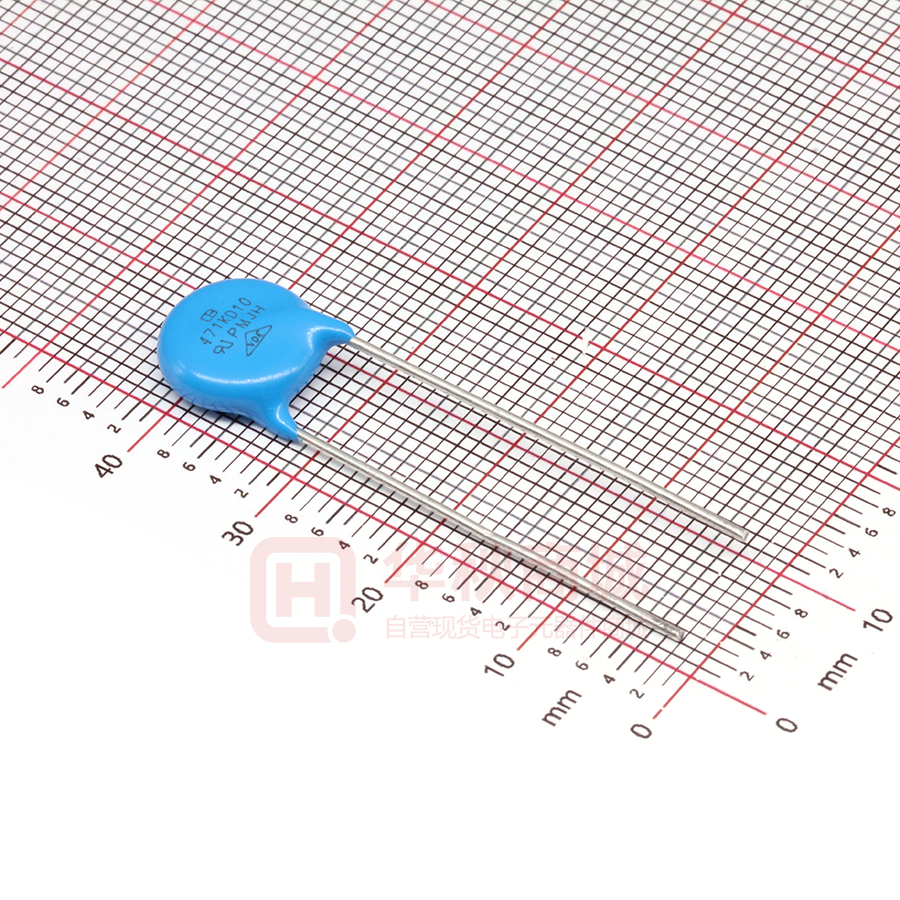

10Φ SERIES Metal Oxide Varistors (MOV) Data Sheet Features ■ Wide operating voltage (V1mA) range from 18V to 1100V ■ Fast responding to transient over-voltage ■ Large absorbing transient energy capability ■ Low clamping ratio and no follow-on current ■ Meets MSL level 1, per J-STD-020 ■ Operating Temperature:-40℃ ~ +105℃ ■ Storage Temperature:-40℃ ~ +125℃ ■ Safety certification:UL、CSA、VDE Applications ■ Transistor, diode, IC, thyristor or triac semiconductor protection ■ Surge protection in consumer electronics ■ Surge protection in industrial electronics ■ Surge protection in electronic home appliances, gas and petroleum appliances ■ Relay and electromagnetic valve surge absorption Part Number Code 4 7 1 K D 1 0 J O TR Packing No suffix: Bulk TB: Tape & Box & P0=12.7mm TR: Tape & Reel & P0=12.7mm EB: Tape & Box & P0=15.0mm ER: Tape & Reel & P0=15.0mm Tolerance K: ±10% Type D: Disk Varistor Voltage 180: 18V 101: 100V 102: 1000V Revision: MOV-10Φ SERIES-001(A5) Surge Series No suffix: Standard type J: High Surge type Lead Shape No suffix: Straight leads O: Outside crimped leads F: Y Kinked leads Element Diameter 10 2 / 15 http://brightking.yageo.com 10Φ SERIES Dimensions D D T D H1 H1 H T K≤3.0 L1 L1 F L d1 d K≤3.0 d e d F O Type F Type Table 1 Table 2 Unit: mm Unit: mm Symbol Dimension Model T e Model T e H 10.5~16.0 180K 2.0~4.6 1.5 301K 2.7~5.5 2.5 H1 13.0~17.5 220K 2.1~4.7 1.6 331K 2.7~5.8 2.5 L(min.) 20.0 270K 2.1~4.8 1.8 361K 2.9~6.0 2.7 L1(min.) 15.0 330K 2.2~5.0 1.7 391K 3.0~6.2 2.8 D 10.0~12.5 390K 2.1~5.3 1.8 431K 3.2~6.5 3.0 F(±0.8) 7.5 470K 2.2~5.4 1.9 471K 3.3~6.7 3.2 T Table 2 560K 2.3~5.5 2.1 511K 3.4~6.8 3.4 e(±0.8) Table 2 680K 2.4~5.6 2.4 561K 3.6~7.0 3.6 d(±0.05) 0.8 820K 2.1~4.7 1.8 621K 3.8~7.3 3.9 d1(±0.4) 1.4 101K 2.4~4.9 2.0 681K 4.0~7.6 4.2 121K 2.4~5.1 2.2 751K 4.3~8.0 4.3 151K 2.2~5.4 1.8 781K 4.4~8.1 4.4 181K 2.3~4.8 1.9 821K 4.6~8.3 4.6 201K 2.4~5.0 2.0 911K 4.8~8.8 5.0 221K 2.5~5.1 2.1 102K 5.4~9.3 5.0 241K 2.6~5.2 2.2 112K 5.8~9.9 5.4 271K 2.6~5.4 2.4 Revision: MOV-10Φ SERIES-001(A5) 3 / 15 http://brightking.yageo.com 10Φ SERIES Electrical Characteristics Part Number Maximum Allowable Voltage Varistor Voltage Maximum Clamping Voltage Withstanding Surge Current Maximum Energy (10/1000μs) Rated Power Typical Capacitance (Reference) Standard High Surge VAC(V) VDC(V) V1mA(V) IP(A) VC(V) I (A) Standard I (A) High Surge (J) Standard (J) High Surge (W) @1KHz (pf) 180KD10 180KD10J 11 14 18(15~21.6) 5 36 500 1000 2.1 3.0 0.05 5600 220KD10 220KD10J 14 18 22(19.5~26) 5 43 500 1000 2.5 5.0 0.05 4500 270KD10 270KD10J 17 22 27(25~31) 5 53 500 1000 3.0 6.0 0.05 3700 330KD10 330KD10J 20 26 33(29.5~36.5) 5 65 500 1000 4.0 7.0 0.05 3000 390KD10 390KD10J 25 31 39(35~43) 5 77 500 1000 4.6 9.0 0.05 2400 470KD10 470KD10J 30 38 47(42~52) 5 93 500 1000 5.5 11.0 0.05 2100 560KD10 560KD10J 35 45 56(50~62) 5 110 500 1000 7.0 13.0 0.05 1800 680KD10 680KD10J 40 56 68(61~75) 5 135 500 1000 8.2 15.0 0.05 1500 820KD10 820KD10J 50 65 82(74~90) 25 135 2500 3500 12.0 17.0 0.4 1200 101KD10 101KD10J 60 85 100(90~110) 25 165 2500 3500 15.0 18.0 0.4 1000 121KD10 121KD10J 75 100 120(108~132) 25 200 2500 3500 18.0 21.0 0.4 830 151KD10 151KD10J 95 125 150(135~165) 25 250 2500 3500 22.0 25.0 0.4 670 181KD10 181KD10J 115 150 180(162~198) 25 300 2500 3500 27.0 30.0 0.4 560 201KD10 201KD10J 130 170 200(180~220) 25 340 2500 3500 30.0 35.0 0.4 500 221KD10 221KD10J 140 180 220(198~242) 25 360 2500 3500 32.0 39.0 0.4 450 241KD10 241KD10J 150 200 240(216~264) 25 395 2500 3500 35.0 42.0 0.4 420 271KD10 271KD10J 175 225 270(243~297) 25 455 2500 3500 37.0 49.0 0.4 370 301KD10 301KD10J 190 250 300(270~330) 25 500 2500 3500 40.0 54.0 0.4 330 331KD10 331KD10J 210 275 330(297~363) 25 550 2500 3500 43.0 58.0 0.4 300 361KD10 361KD10J 230 300 360(324~396) 25 595 2500 3500 47.0 65.0 0.4 280 391KD10 391KD10J 250 320 390(351~429) 25 650 2500 3500 60.0 70.0 0.4 260 431KD10 431KD10J 275 350 430(387~473) 25 710 2500 3500 65.0 80.0 0.4 230 471KD10 471KD10J 300 385 470(423~517) 25 775 2500 3500 67.0 85.0 0.4 210 511KD10 511KD10J 320 415 510(459~561) 25 845 2500 3500 69.0 90.0 0.4 200 561KD10 561KD10J 350 460 560(504~616) 25 925 2500 3500 70.0 92.0 0.4 180 621KD10 621KD10J 385 505 620(558~682) 25 1025 2500 3500 72.0 95.0 0.4 160 681KD10 681KD10J 420 560 680(612~748) 25 1120 2500 3500 75.0 98.0 0.4 150 751KD10 751KD10J 460 615 750(675~825) 25 1240 2500 3500 77.0 100.0 0.4 130 781KD10 781KD10J 485 640 780(702~858) 25 1290 2500 3500 80.0 105.0 0.4 125 821KD10 821KD10J 510 670 820(738~902) 25 1355 2500 3500 85.0 110.0 0.4 120 911KD10 911KD10J 550 745 910(819~1001) 25 1500 2500 3500 93.0 130.0 0.4 110 102KD10 102KD10J 625 825 1000(900~1100) 25 1650 2500 3500 102.0 140.0 0.4 100 112KD10 112KD10J 680 895 1100(990~1210) 25 1815 2500 3500 115.0 155.0 0.4 90 Notes: 1. The tolerance of varistor voltage between 18V and 27V is more than 10%. 2. Leakage Current (@83% of V1mA):IR≤50μA (180K~680K) ; IR≤25μA (820K~112K) Revision: MOV-10Φ SERIES-001(A5) 4 / 15 http://brightking.yageo.com 10Φ SERIES Maximum Surge Current Derating Curve 820KD10 to 112KD10 180KD10 to 680KD10 10000 10000 1000 1000 10 Max. Surge Current (A) Max. Surge Current (A) 1 100 1 2 2 102 103 104 105 106 10 10 100 102 1034 10 105 106 10 1 1 0.1 10 100 1000 0.1 10 10000 100 1000 Td (μs) Td (μs) 180KD10J to 680KD10J 820KD10J to 112KD10J 10000 10000 10000 1 2 1000 1 2 100 10 Max. Surge Current (A) Max. Surge Current (A) 1000 10 102 103 1045 10 106 102 103 1045 106 10 10 1 1 0.1 10 100 10 100 1000 0.1 10 10000 1000 10000 Td (μs) Td (μs) Revision: MOV-10Φ SERIES-001(A5) 100 5 / 15 http://brightking.yageo.com 10Φ SERIES Maximum Leakage Current and Maximum Clamping Voltage Curve Revision: MOV-10Φ SERIES-001(A5) 6 / 15 http://brightking.yageo.com 10Φ SERIES Maximum Leakage Current and Maximum Clamping Voltage Curve Revision: MOV-10Φ SERIES-001(A5) 7 / 15 http://brightking.yageo.com 10Φ SERIES Maximum Leakage Current and Maximum Clamping Voltage Curve Revision: MOV-10Φ SERIES-001(A5) 8 / 15 http://brightking.yageo.com 10Φ SERIES Reliability Items Standard Test conditions / Methods Specifications Gradually applying the force specified and keeping the unit fixed for 10±1 sec. Tensile Strength of Terminals Bending Strength of Terminals IEC60068-2-21 Terminal diameter (mm) 0.5<d≤0.8 0.8<d≤1.25 1.25<d Force (kg) No visible damage 1.0 2.0 4.0 |ΔV1mA/V1mA |≤5% Hold specimen and apply the force specified below to each lead. Bend the specimen to 90°, then return to the original position. Repeat the procedure in the opposite direction. Terminal diameter (mm) 0.5<d≤0.8 0.8<d≤1.25 1.25<d IEC60068-2-21 Force (kg) 0.5 1.0 2.0 Vibration IEC60068-2-6 Frequency range: 10~55 Hz 2 Amplitude: 0.75mm or 98m/s Direction: 3 mutually perpendicular directions, 2hrs each. Solderability IEC60068-2-20 Solder Temp: 245±5℃ Dipping Time: 2±0.5 sec Resistance to Soldering Heat High Temperature Storage Low Temperature Storage Damp Heat, Steady State High Temperature Load No visible damage |ΔV1mA/V1mA |≤5% No visible damage |ΔV1mA/V1mA |≤5% Solder Temp: 260±5℃ Dipping Time: 10±1 sec Ambient Temp: 125±2℃ Duration: 1000±24hrs At least 95% of terminal electrode is covered by new solder No visible damage |ΔV1mA/V1mA |≤5% No visible damage |ΔV1mA/V1mA |≤5% Ambient Temp: -40±2℃ No visible damage Duration: 1000±24hrs |ΔV1mA/V1mA |≤5% IEC60068-2-78 The test is divided into two groups . a. 40±2℃ , 90~95% RH for 1344±24hrs b. 40±2℃ , 90~95% RH,at 10%VDC ,1344±24 hrs No visible damage |ΔV1mA/V1mA|≤10% Insulation Resistance≧100MΩ MIL-STD-202 Ambient Temp: 105±2℃ Method 108 Load: Max. Allowable Voltage In AC. IEC60068-2-20 IEC60068-2-2 IEC60068-2-1 Duration: 1000±24hrs |ΔV1mA/V1mA|≤10% The conditions shown below shall be repeated 5 cycles Temperature Cycle IEC60068-2-14 Temperature (℃) Period (minutes) 1 -40±3 30±3 No visible damage 2 Room temperature 5±3 |ΔV1mA/V1mA |≤5% 3 125±3 30±3 4 Room temperature 5±3 8/20µS waveform,10 surge currents, unipolar, interval 8/20uS IEC61051-1 Surge Life 30secs,amplitude corresponding to max. surge current derating curves for 20µS. 10/1000µS waveform,10 surge currents, unipolar, interval 10/1000µS IEC61051-1 Surge Life Voltage Proof Step 2mins,amplitude corresponding to max. surge current No visible damage △Vb(1mA)≦±10% No visible damage |ΔV1mA/V1mA |≤10% derating curves for 1000µS. IEC61051-1 Revision: MOV-10Φ SERIES-001(A5) Metal balls method, 2500Vac 1 min. 9 / 15 No visible damage http://brightking.yageo.com 10Φ SERIES Soldering Recommendation Lead-free Wave Soldering Recommendation 300 Maximum Wave 265℃ Preheating Soldering Cooling Temperature (℃) 250 200 150 100 50 0 0 0.5 1 1.5 2 2.5 3 3.5 4 Time (minutes) Item Conditions Peak Temperature 265℃ Dipping Time 10 seconds (max.) Soldering 1 time Recommendation Reworking Conditions with Soldering Iron Item Conditions Temperature of Soldering Iron-tip 360℃ (max.) Soldering Time 3 seconds (max.) Distance from Varistor 2mm (min.) Marking Code ① Brightking Logo ② Varistor Voltage ① ③ UL Accreditation Logo XXXKDXXX ② ③ ④ XXX Y VDE Revision: MOV-10Φ SERIES-001(A5) ⑤ ⑥ ⑦ ④ VDE Accreditation Logo ⑤“J”is High Surge Code, no“J”is Standard Surge ⑥ Disk Size ⑦ Internal control code 10 / 15 http://brightking.yageo.com 10Φ SERIES Taping Dimensions P2 P h B W0 W H0 W2 D0 I P1 F P0 W1 t P2 h B P W0 W H0 W2 D0 I P1 F P0 W1 t Revision: MOV-10Φ SERIES-001(A5) 11 / 15 Symbol Dimension (mm) P 25.4±1.0 P0 12.7±1.0 P1 8.95±0.7 P2 12.7±1.3 F 7.5±0.8 h 0±2 W 18.0±1.0 W0 12.0±1.0 W1 9.0±0.5 W2 3.0max H0 16.0±1.0 I 2.0max D0 4.0±0.2 t 0.6±0.3 B 36max Symbol Dimension (mm) P 15.0±1.0 P0 15.0±1.0 P1 3.85±0.7 P2 7.5±1.3 F 7.5±0.8 h 0±2 W 18.0±1.0 W0 12.0±1.0 W1 9.0±0.5 W2 3.0max H0 16.0±1.0 I 2.0max D0 4.0±0.2 t 0.6±0.3 B 36max http://brightking.yageo.com 10Φ SERIES Taping Dimensions P2 h P B W0 W H0 W2 D0 I F P1 P0 W1 t P2 h B P W0 W H0 W2 D0 I F P1 P0 W1 t Revision: MOV-10Φ SERIES-001(A5) 12 / 15 Symbol Dimension (mm) P 25.4±1.0 P0 12.7±1.0 P1 8.95±0.7 P2 12.7±1.3 F 7.5±0.8 h 0±2 W 18.0±1.0 W0 12.0±1.0 W1 9.0±0.5 W2 3.0max H0 16.0±1.0 I 2.0max D0 4.0±0.2 t 0.6±0.3 B 36max Symbol Dimension (mm) P 15.0±1.0 P0 15.0±1.0 P1 3.85±0.7 P2 7.5±1.3 F 7.5±0.8 h 0±2 W 18.0±1.0 W0 12.0±1.0 W1 9.0±0.5 W2 3.0max H0 16.0±1.0 I 2.0max D0 4.0±0.2 t 0.6±0.3 B 36max http://brightking.yageo.com 10Φ SERIES Taping Dimensions P h B P2 W0 W H2 W2 D0 I F P1 P0 W1 t P2 h B P W0 W H2 W2 D0 I P1 F P0 W1 t Revision: MOV-10Φ SERIES-001(A5) 13 / 15 Symbol Dimension (mm) P 25.4±1.0 P0 12.7±1.0 P1 8.95±0.7 P2 12.7±1.3 F 7.5±0.8 h 0±2 W 18.0±1.0 W0 12.0±1.0 W1 9.0±0.5 W2 3.0max H2 20.0±2.0 I 2.0max D0 4.0±0.2 t 0.6±0.3 B 36max Symbol Dimension (mm) P 15.0±1.0 P0 15.0±1.0 P1 3.85±0.7 P2 7.5±1.3 F 7.5±0.8 h 0±2 W 18.0±1.0 W0 12.0±1.0 W1 9.0±0.5 W2 3.0max H2 20.0±2.0 I 2.0max D0 4.0±0.2 t 0.6±0.3 B 36max http://brightking.yageo.com 10Φ SERIES Quantity Packaging Dimensions (Unit: mm) Quantity In bulk for Terminals Untrimmed Products 500pcs/bag 4bags/box (180K~621K) 5M ax . 400pcs/bag 4bags/box (681K~112K) 300pcs/bag 4bags/box 16 130 Max. 250 Max. (122K~182K) 500pcs/bag 4bags/box (180K~621K) In bulk for Terminals Trimmed Products 5M ax . 400pcs/bag 4bags/box (681K~112K) 16 66 Max. 252 Max. 300pcs/bag 4bags/box (122K~182K) Packaging Dimensions (Unit: mm) Quantity Tape & Box & P0=12.7mm 750pcs/box (180K~241K) 0M ax . 600pcs/box (271K~391K) 500pcs/box (431K~621K) 25 60 Max. 340 Max. 300pcs/box (681K~112K) Tape & Reel & P0=12.7mm 5M ax . 1000pcs/reel (180K~391K) 36 60 Max. 750pcs/reel (431K~621K) 365 Max. 500pcs/reel (681K~112K) 55 Max. 30±1 Φ365 Max. Revision: MOV-10Φ SERIES-001(A5) 14 / 15 http://brightking.yageo.com 10Φ SERIES Quantity Packaging Dimensions (Unit: mm) Quantity Tape & Box & P0=15.0mm 1000pcs/box (180K~391K) 0M ax . 750pcs/box (431K~621K) 25 60 Max. 600pcs/box 340 Max. (681K~751K) 500pcs/box (781K~112K) Tape & Reel & P0=15.0mm 5M ax . 1000pcs/reel (180K~391K) 36 60 Max. 750pcs/reel (431K~751K) 365 Max. 55 Max. 500pcs/reel (781K~112K) 30±1 Φ365 Max. Storage Condition of Products (I) Storage Conditions : 1.Storage Temperature : -10℃ ~ +40℃ 2.Relative Humidity : ≦80%RH 3.Keep away from corrosive atmosphere and sunlight. (II) Period of Storage : 1 year Revision: MOV-10Φ SERIES-001(A5) 15 / 15 http://brightking.yageo.com
