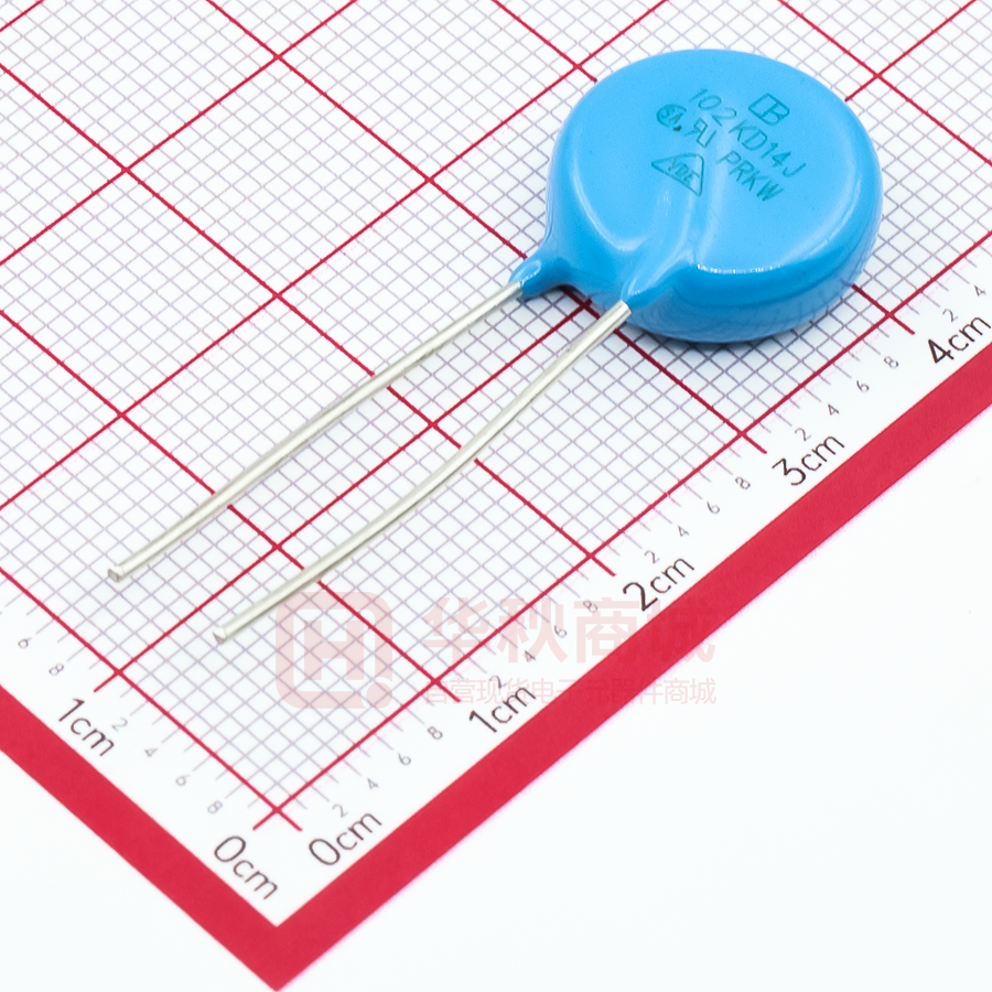

    压敏电阻 VAR=900~1100V VC=1650V
102KD14J 数据手册
14Φ SERIES Metal Oxide Varistors (MOV) Data Sheet Features ■ Wide operating voltage (V1mA) range from 18V to 1800V ■ Fast responding to transient over-voltage ■ Large absorbing transient energy capability ■ Low clamping ratio and no follow-on current ■ Meets MSL level 1, per J-STD-020 ■ Operating Temperature:-40℃ ~ +105℃ ■ Storage Temperature:-40℃ ~ +125℃ ■ Safety certification:UL、CSA、VDE Applications ■ Transistor, diode, IC, thyristor or triac semiconductor protection ■ Surge protection in consumer electronics ■ Surge protection in industrial electronics ■ Surge protection in electronic home appliances, gas and petroleum appliances ■ Relay and electromagnetic valve surge absorption Part Number Code 4 7 1 K D 1 4 J O TR Packing No suffix: Bulk TB: Tape & Box & P0=12.7mm TR: Tape & Reel & P0=12.7mm EB: Tape & Box & P0=15.0mm ER: Tape & Reel & P0=15.0mm Tolerance K: ±10% Type D: Disk Varistor Voltage 180: 18V 101: 100V 102: 1000V Revision: MOV-14Φ SERIES-001(A7) Surge Series No suffix: Standard type J: High Surge type Lead Shape No suffix: Straight leads O: Outside crimped leads F: Y Kinked leads Element Diameter 14 2 / 16 http://brightking.yageo.com 14Φ SERIES Dimensions D D T D H1 H1 H T K≤3.0 L1 L1 F L d1 d K≤3.0 d e d F O Type F Type Notes: Varistor voltage≥1200V, structure diagram is F type. Table 1 Table 2 Unit: mm Unit: mm Symbol Dimension Model T e Model T e H 14.5~20.0 180K 2.0~3.9 1.5 361K 2.9~5.2 2.7 H1 17.0~21.0 220K 2.1~4.0 1.6 391K 3.0~5.4 2.8 L(min.) 20.0 270K 2.1~4.1 1.8 431K 3.2~5.6 3.0 L1(min.) 15.0 330K 2.2~4.3 1.7 471K 3.3~5.8 3.2 D 14.0~16.5 390K 2.1~4.1 1.8 511K 3.4~6.1 3.4 F(±0.8) 7.5 470K 2.2~4.3 1.9 561K 3.6~6.4 3.6 T Table 2 560K 2.3~4.6 2.1 621K 3.8~6.8 3.9 e(±0.8) Table 2 680K 2.4~4.8 2.4 681K 4.0~7.1 4.2 d(±0.05) 0.8 820K 2.1~4.1 1.8 751K 4.3~7.2 4.3 d1(±0.4) 1.4 101K 2.4~4.2 2.0 781K 4.4~7.3 4.4 121K 2.4~4.4 2.2 821K 4.6~7.5 4.6 151K 2.2~4.1 1.8 911K 4.8~7.5 5.0 181K 2.3~4.2 1.9 102K 5.4~8.0 5.0 201K 2.4~4.3 2.0 112K 5.8~8.5 5.4 221K 2.5~4.4 2.1 122K 5.9~9.0 5.8 241K 2.6~4.5 2.2 142K 6.9~10.5 6.6 271K 2.6~4.6 2.4 162K 7.4~11.0 7.4 301K 2.7~4.6 2.5 182K 7.6~12.0 8.2 331K 2.7~5.0 2.5 Revision: MOV-14Φ SERIES-001(A7) 3 / 16 http://brightking.yageo.com 14Φ SERIES Electrical Characteristics Maximum Allowable Voltage Part Number Varistor Voltage Maximum Clamping Voltage Withstanding Surge Current Maximum Energy (10/1000μs) Rated Power Typical Capacitance (Reference) Standard High Surge VAC(V) VDC(V) V1mA(V) IP(A) VC(V) I (A) Standard I (A) High Surge (J) Standard (J) High Surge (W) @1KHz (pf) 180KD14 180KD14J 11 14 18(15~21.6) 10 36 1000 2000 4.0 7.0 0.1 11100 220KD14 220KD14J 14 18 22(19.5~26) 10 43 1000 2000 5.0 8.0 0.1 9100 270KD14 270KD14J 17 22 27(24~31) 10 53 1000 2000 6.0 10.0 0.1 7400 330KD14 330KD14J 20 26 33(29.5~36.5) 10 65 1000 2000 7.5 12.0 0.1 6100 390KD14 390KD14J 25 31 39(35~43) 10 77 1000 2000 8.6 13.0 0.1 5100 470KD14 470KD14J 30 38 47(42~52) 10 93 1000 2000 10.0 17.0 0.1 4300 560KD14 560KD14J 35 45 56(50~62) 10 110 1000 2000 11.0 20.0 0.1 3600 680KD14 680KD14J 40 56 68(61~75) 10 135 1000 2000 14.0 24.0 0.1 2900 820KD14 820KD14J 50 65 82(74~90) 50 135 4500 6000 22.0 27.0 0.6 2400 101KD14 101KD14J 60 85 100(90~110) 50 165 4500 6000 28.0 33.0 0.6 2000 121KD14 121KD14J 75 100 120(108~132) 50 200 4500 6000 32.0 40.0 0.6 1700 151KD14 151KD14J 95 125 150(135~165) 50 250 4500 6000 40.0 53.0 0.6 1300 181KD14 181KD14J 115 150 180(162~198) 50 300 4500 6000 50.0 60.0 0.6 1100 201KD14 201KD14J 130 170 200(180~220) 50 340 4500 6000 57.0 70.0 0.6 1000 221KD14 221KD14J 140 180 220(198~242) 50 360 4500 6000 60.0 78.0 0.6 900 241KD14 241KD14J 150 200 240(216~264) 50 395 4500 6000 63.0 84.0 0.6 830 271KD14 271KD14J 175 225 270(243~297) 50 455 4500 6000 70.0 99.0 0.6 740 301KD14 301KD14J 190 250 300(270~330) 50 500 4500 6000 77.0 108 0.6 670 331KD14 331KD14J 210 275 330(297~363) 50 550 4500 6000 85.0 115 0.6 610 361KD14 361KD14J 230 300 360(324~396) 50 595 4500 6000 93.0 130 0.6 560 391KD14 391KD14J 250 320 390(351~429) 50 650 4500 6000 100 140 0.6 510 431KD14 431KD14J 275 350 430(387~473) 50 710 4500 6000 115 155 0.6 460 471KD14 471KD14J 300 385 470(423~517) 50 775 4500 6000 118 175 0.6 430 511KD14 511KD14J 320 415 510(459~561) 50 845 4500 6000 121 180 0.6 390 561KD14 561KD14J 350 460 560(504~616) 50 925 4500 6000 125 185 0.6 360 621KD14 621KD14J 385 505 620(558~682) 50 1025 4500 6000 128 190 0.6 320 681KD14 681KD14J 420 560 680(612~748) 50 1120 4500 6000 130 200 0.6 290 751KD14 751KD14J 460 615 750(675~825) 50 1240 4500 6000 143 210 0.6 270 781KD14 781KD14J 485 640 780(702~858) 50 1290 4500 6000 148 220 0.6 260 821KD14 821KD14J 510 670 820(738~902) 50 1355 4500 6000 157 235 0.6 240 911KD14 911KD14J 550 745 910(819~1001) 50 1500 4500 6000 175 255 0.6 220 102KD14 102KD14J 625 825 1000(900~1100) 50 1650 4500 6000 190 280 0.6 200 112KD14 112KD14J 680 895 1100(990~1210) 50 1815 4500 6000 213 310 0.6 180 122KD14 122KD14J 750 990 1200(1080~1320) 50 1980 4500 6000 232 324 0.6 160 142KD14 / 880 1140 1400(1260~1540) 50 2310 4500 / 238 / 0.6 150 Revision: MOV-14Φ SERIES-001(A7) 4 / 16 http://brightking.yageo.com 14Φ SERIES Maximum Allowable Voltage Part Number Maximum Clamping Voltage Varistor Voltage Withstanding Surge Current Maximum Energy (10/1000μs) Rated Power Typical Capacitance (Reference) Standard High Surge VAC(V) VDC(V) V1mA(V) IP(A) VC(V) I (A) Standard I (A) High Surge (J) Standard (J) High Surge (W) @1KHz (pf) 162KD14 / 1000 1280 1600(1440~1760) 50 2640 4500 / 243 / 0.6 140 182KD14 / 1100 1465 1800(1620~1980) 50 2970 4500 / 250 / 0.6 130 Notes: 1. The tolerance of varistor voltage between 18V and 27V is more than 10%; 2. Varistor voltage≥1200V, structure diagram is F type; 3. Leakage Current (@83% of V1mA):IR≤50μA (180K~680K) ; IR≤25μA (820K~182K). Maximum Surge Current Derating Curve 820KD14 to 182KD14 180KD14 to 680KD14 10000 10000 1000 1 100 2 10 1023 104 10 105 106 1000 Max. Surge Current (A) Max. Surge Current (A) 1 2 10 100 10 102 103 104 105 106 10 1 1 0.1 10 100 1000 0.1 10 10000 100 Td (μs) 10000 10000 1 2 1 1000 2 10 102 103 104 105 106 Max. Surge Current (A) Max. Surge Current (A) 100 10 1 0.1 10 10000 820KD14J to 122KD14J 180KD14J to 680KD14J 1000 1000 Td (μs) 100 10 102 103 104 105 106 10 1 100 1000 0.1 10 10000 Td (μs) Revision: MOV-14Φ SERIES-001(A7) 100 1000 10000 Td (μs) 5 / 16 http://brightking.yageo.com 14Φ SERIES Maximum Leakage Current and Maximum Clamping Voltage Curve Revision: MOV-14Φ SERIES-001(A7) 6 / 16 http://brightking.yageo.com 14Φ SERIES Maximum Leakage Current and Maximum Clamping Voltage Curve Revision: MOV-14Φ SERIES-001(A7) 7 / 16 http://brightking.yageo.com 14Φ SERIES Maximum Leakage Current and Maximum Clamping Voltage Curve Revision: MOV-14Φ SERIES-001(A7) 8 / 16 http://brightking.yageo.com 14Φ SERIES Reliability Items Standard Test conditions / Methods Specifications Gradually applying the force specified and keeping the unit fixed for 10±1 sec. Tensile Strength of Terminals Bending Strength of Terminals IEC60068-2-21 Terminal diameter (mm) 0.5<d≤0.8 0.8<d≤1.25 1.25<d Force (kg) No visible damage 1.0 2.0 4.0 |ΔV1mA/V1mA |≤5% Hold specimen and apply the force specified below to each lead. Bend the specimen to 90°, then return to the original position. Repeat the procedure in the opposite direction. Terminal diameter (mm) 0.5<d≤0.8 0.8<d≤1.25 1.25<d IEC60068-2-21 Force (kg) 0.5 1.0 2.0 Vibration IEC60068-2-6 Frequency range: 10~55 Hz 2 Amplitude: 0.75mm or 98m/s Direction: 3 mutually perpendicular directions, 2hrs each. Solderability IEC60068-2-20 Solder Temp: 245±5℃ Dipping Time: 2±0.5 sec Resistance to Soldering Heat High Temperature Storage Low Temperature Storage Damp Heat, Steady State High Temperature Load No visible damage |ΔV1mA/V1mA |≤5% No visible damage |ΔV1mA/V1mA |≤5% Solder Temp: 260±5℃ Dipping Time: 10±1 sec Ambient Temp: 125±2℃ Duration: 1000±24hrs At least 95% of terminal electrode is covered by new solder No visible damage |ΔV1mA/V1mA |≤5% No visible damage |ΔV1mA/V1mA |≤5% Ambient Temp: -40±2℃ No visible damage Duration: 1000±24hrs |ΔV1mA/V1mA |≤5% IEC60068-2-78 The test is divided into two groups . a. 40±2℃ , 90~95% RH for 1344±24hrs b. 40±2℃ , 90~95% RH,at 10%VDC ,1344±24 hrs No visible damage |ΔV1mA/V1mA|≤10% Insulation Resistance≧100MΩ MIL-STD-202 Ambient Temp: 105±2℃ Method 108 Load: Max. Allowable Voltage In AC. IEC60068-2-20 IEC60068-2-2 IEC60068-2-1 Duration: 1000±24hrs |ΔV1mA/V1mA|≤10% The conditions shown below shall be repeated 5 cycles Temperature Cycle IEC60068-2-14 Temperature (℃) Period (minutes) 1 -40±3 30±3 No visible damage 2 Room temperature 5±3 |ΔV1mA/V1mA |≤5% 3 125±3 30±3 4 Room temperature 5±3 8/20µS waveform,10 surge currents, unipolar, interval 8/20uS IEC61051-1 Surge Life 30secs,amplitude corresponding to max. surge current derating curves for 20µS. 10/1000µS waveform,10 surge currents, unipolar, interval 10/1000µS IEC61051-1 Surge Life Voltage Proof Step 2mins,amplitude corresponding to max. surge current No visible damage △Vb(1mA)≦±10% No visible damage |ΔV1mA/V1mA |≤10% derating curves for 1000µS. IEC61051-1 Revision: MOV-14Φ SERIES-001(A7) Metal balls method, 2500Vac 1 min. 9 / 16 No visible damage http://brightking.yageo.com 14Φ SERIES Soldering Recommendation Lead-free Wave Soldering Recommendation 300 Maximum Wave 265℃ Preheating Soldering Cooling Temperature (℃) 250 200 150 100 50 0 0 0.5 1 1.5 2 2.5 3 3.5 4 Time (minutes) Item Conditions Peak Temperature 265℃ Dipping Time 10 seconds (max.) Soldering 1 time Recommendation Reworking Conditions with Soldering Iron Item Conditions Temperature of Soldering Iron-tip 360℃ (max.) Soldering Time 3 seconds (max.) Distance from Varistor 2mm (min.) Marking Code ① XXXKDXXX ② ③ ④ ⑤ XXX Y VDE ① Brightking Logo ② Varistor Voltage ③ CSA Accreditation Logo ⑥ ⑦ ④ UL Accreditation Logo ⑤ VDE Accreditation Logo ⑧ ⑥“J”is High Surge Code, no“J”is Standard Surge ⑦ Disk Size ⑧ Internal control code Revision: MOV-14Φ SERIES-001(A7) 10 / 16 http://brightking.yageo.com 14Φ SERIES Taping Dimensions P2 P h B W0 W H0 W2 D0 I P1 F W1 P0 t h P2 B P W0 W H0 W2 D0 I P1 P0 F W1 t Revision: MOV-14Φ SERIES-001(A7) 11 / 16 Symbol Dimension (mm) P 25.4±1.0 P0 12.7±1.0 P1 8.95±0.7 P2 12.7±1.3 F 7.5±0.8 h 0±4 W 18.0±1.0 W0 12.0±1.0 W1 9.0±0.5 W2 3.0max H0 16.0±1.0 I 2.0max D0 4.0±0.2 t 0.6±0.3 B 40max Symbol Dimension (mm) P 30.0±1.0 P0 15.0±1.0 P1 3.85±0.7 P2 7.5±1.3 F 7.5±0.8 h 0±4 W 18.0±1.0 W0 12.0±1.0 W1 9.0±0.5 W2 3.0max H0 16.0±1.0 I 2.0max D0 4.0±0.2 t 0.6±0.3 B 40max http://brightking.yageo.com 14Φ SERIES Taping Dimensions P2 h P B W0 W H0 W2 D0 I F P1 W1 P0 t h P2 B P W0 W H0 W2 D0 I P1 F P0 W1 t Revision: MOV-14Φ SERIES-001(A7) 12 / 16 Symbol Dimension (mm) P 25.4±1.0 P0 12.7±1.0 P1 8.95±0.7 P2 12.7±1.3 F 7.5±0.8 h 0±4 W 18.0±1.0 W0 12.0±1.0 W1 9.0±0.5 W2 3.0max H0 16.0±1.0 I 2.0max D0 4.0±0.2 t 0.6±0.3 B 40max Symbol Dimension (mm) P 30.0±1.0 P0 15.0±1.0 P1 3.85±0.7 P2 7.5±1.3 F 7.5±0.8 h 0±4 W 18.0±1.0 W0 12.0±1.0 W1 9.0±0.5 W2 3.0max H0 16.0±1.0 I 2.0max D0 4.0±0.2 t 0.6±0.3 B 40max http://brightking.yageo.com 14Φ SERIES Taping Dimensions P h B P2 W0 W H2 W2 D0 I F P1 W1 P0 t h P2 B P W0 W H2 W2 D0 I P1 F P0 W1 t Revision: MOV-14Φ SERIES-001(A7) 13 / 16 Symbol Dimension (mm) P 25.4±1.0 P0 12.7±1.0 P1 8.95±0.7 P2 12.7±1.3 F 7.5±0.8 h 0±4 W 18.0±1.0 W0 12.0±1.0 W1 9.0±0.5 W2 3.0max H2 20.0±2.0 I 2.0max D0 4.0±0.2 t 0.6±0.3 B 40max Symbol Dimension (mm) P 30.0±1.0 P0 15.0±1.0 P1 3.85±0.7 P2 7.5±1.3 F 7.5±0.8 h 0±4 W 18.0±1.0 W0 12.0±1.0 W1 9.0±0.5 W2 3.0max H2 20.0±2.0 I 2.0max D0 4.0±0.2 t 0.6±0.3 B 40max http://brightking.yageo.com 14Φ SERIES Quantity Packaging Dimensions (Unit: mm) Quantity In bulk for Terminals Untrimmed Products 400pcs/bag 4bags/box (180K~331K) 300pcs/bag 4bags/box (361K~621K) 5M ax . 250pcs/bag 4bags/box (681K~112K) 16 130 Max. 250 Max. 150pcs/bag 4bags/box (122K~182K) In bulk for Terminals Trimmed Products 400pcs/bag 4bags/box (180K~331K) 5M ax . 300pcs/bag 4bags/box (361K~621K) 16 66 Max. 252 Max. 250pcs/bag 4bags/box (681K~112K) 150pcs/bag 4bags/box (122K~182K) Packaging Dimensions (Unit: mm) Quantity Tape & Box & P0=12.7mm 750pcs/ box (180K~241K) 0M ax . 600pcs/ box (271K~331K) 25 60 Max. 500pcs/ box (361K~621K) 340 Max. 400pcs/ box (681K~751K) 350pcs/ box (781K~112K) Revision: MOV-14Φ SERIES-001(A7) 14 / 16 http://brightking.yageo.com 14Φ SERIES Quantity Packaging Dimensions (Unit: mm) Quantity Tape & Reel & P0=12.7mm 1000pcs/reel (180K~331K) 5M ax . 750pcs/reel (361K~621K) 36 60 Max. 500pcs/reel 365 Max. (681K~751K) 55 Max. 400pcs/reel (781K~112K) 30±1 Φ365 Max. Packaging Dimensions (Unit: mm) Quantity Tape & Box & P0=15.0mm 500pcs/ box (180K~331K) 0M ax . 400pcs/ box (361K~751K) 25 60 Max. 340 Max. 300pcs/ box (781K~112K) Tape & Reel & P0=15.0mm 750pcs/reel 5M ax . (180K~331K) 36 60 Max. 600pcs/reel (361K~751K) 365 Max. 55 Max. 500pcs/reel (781K~112K) 30±1 Φ365 Max. Revision: MOV-14Φ SERIES-001(A7) 15 / 16 http://brightking.yageo.com 14Φ SERIES Storage Condition of Products (I) Storage Conditions : 1.Storage Temperature : -10℃ ~ +40℃ 2.Relative Humidity : ≦80%RH 3.Keep away from corrosive atmosphere and sunlight. (II) Period of Storage : 1 year Revision: MOV-14Φ SERIES-001(A7) 16 / 16 http://brightking.yageo.com
