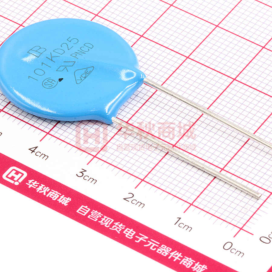

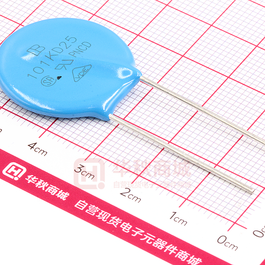

101KD25
101KD25
    BRIGHTKING(君耀)
    VAR_D28X4.6MM_TM
    压敏电阻 VAR=90~110V VC=165V
101KD25 数据手册
25Φ SERIES Metal Oxide Varistor (MOV) Data Sheet Features ■ ■ ■ ■ ■ Wide operating voltage (V1mA) range from 18V to 1800V Fast responding to transient over-voltage Large absorbing transient energy capability Low clamping ratio and no follow-on current Meets MSL level 1, per J-STD-020 ■ Operating Temperature:-40℃ ~ +105℃ ■ Storage Temperature:-40℃ ~ +125℃ ■ Safety certification:UL、CSA、VDE Applications ■ Transistor, diode, IC, thyristor or triac semiconductor protection ■ Surge protection in consumer electronics ■ Surge protection in industrial electronics ■ Surge protection in electronic home appliances, gas and petroleum appliances ■ Relay and electromagnetic valve surge absorption Part number code 4 7 1 K D 2 5 P12.5 Tolerance K: ±10% Varistor Voltage 180: 18V 101: 100V 102: 1000V Revision: MOV-25Φ SERIES-001(A6) Type D: Disk Element Diameter 25 2/9 Pitch No suffix: 10mm P12.5: 12.5mm http://brightking.yageo.com 25Φ SERIES Dimensions T H D L K≤3.0 F e d Table 1 Table 2 Unit: mm Unit: mm Symbol Dimension Model T e Model T e H 27.0~31.5 180K 2.5~4.8 1.7 361K 3.4~5.9 2.9 L(min.) 20.0 220K 2.6~4.9 1.8 391K 3.5~6.1 3.0 D 25.0~28.0 270K 2.6~5.0 2.0 431K 3.7~6.4 3.2 F(±1.0) 10.0/12.5 330K 2.7~5.2 1.9 471K 3.8~6.7 3.4 T Table 2 390K 2.6~5.5 2.0 511K 3.9~7.0 3.6 e(±0.8) Table 2 470K 2.7~5.1 2.1 561K 4.1~7.3 3.8 d(±0.1) 1.0 560K 2.8~5.4 2.3 621K 4.3~7.6 4.1 680K 2.9~5.7 2.6 681K 4.5~7.8 4.4 820K 2.6~4.5 2.0 751K 4.8~8.0 4.5 101K 2.9~4.6 2.2 781K 4.9~8.1 4.6 121K 2.9~4.8 2.4 821K 5.1~8.4 4.8 151K 2.7~4.9 2.0 911K 5.3~8.9 5.2 181K 2.8~5.2 2.1 102K 5.9~9.5 5.2 201K 2.9~5.2 2.2 112K 6.3~10.1 5.6 221K 3.0~5.3 2.3 122K 6.4~10.7 6.0 241K 3.1~5.8 2.4 142K 7.4~12.6 6.8 271K 3.1~5.3 2.6 162K 7.9~13.2 7.6 301K 3.2~5.5 2.7 182K 8.1~14.5 8.4 331K 3.2~5.7 2.7 Revision: MOV-25Φ SERIES-001(A6) 3/9 http://brightking.yageo.com 25Φ SERIES Electrical characteristics Part Number Maximum Allowable Voltage Varistor Voltage Maximum Clamping Voltage Withstanding Surge Current Maximum Energy (10/1000μs) Rated Power Typical Capacitance (Reference) VAC(V) VDC(V) V1mA(V) IP(A) VC(V) I (A) (J) (W) @1KHz (pf) 180KD25 11 14 18(15~21.6) 30 36 4500 20 0.25 45000 220KD25 14 18 22(19.5~26) 30 43 4500 25 0.25 29000 270KD25 17 22 27(24~31) 30 53 4500 30 0.25 26500 330KD25 20 26 33(29.5~36.5) 30 65 4500 35 0.25 18000 390KD25 25 31 39(35~43) 30 77 4500 40 0.25 13500 470KD25 30 38 47(42~52) 30 93 4500 50 0.25 11500 560KD25 35 45 56(50~62) 30 110 4500 60 0.25 10500 680KD25 40 56 68(61~75) 30 135 4500 70 0.25 9050 820KD25 50 65 82(74~90) 150 135 15000 80 1.2 7700 101KD25 60 85 100(90~110) 150 165 15000 100 1.2 6300 121KD25 75 100 120(108~132) 150 200 15000 120 1.2 5200 151KD25 95 125 150(135~165) 150 250 15000 160 1.2 4300 181KD25 115 150 180(162~198) 150 300 15000 175 1.2 3500 201KD25 130 170 200(180~220) 150 340 15000 190 1.2 3200 221KD25 140 180 220(198~242) 150 360 15000 200 1.2 2900 241KD25 150 200 240(216~264) 150 395 15000 220 1.2 2650 271KD25 175 225 270(243~297) 150 455 15000 255 1.2 2400 301KD25 190 250 300(270~330) 150 500 15000 275 1.2 2100 331KD25 210 275 330(297~363) 150 550 15000 300 1.2 1900 361KD25 230 300 360(324~396) 150 595 15000 330 1.2 1750 391KD25 250 320 390(351~429) 150 650 15000 360 1.2 1600 431KD25 275 350 430(387~473) 150 710 15000 380 1.2 1500 471KD25 300 385 470(423~517) 150 775 15000 400 1.2 1400 511KD25 320 415 510(459~561) 150 845 15000 420 1.2 1250 561KD25 350 460 560(504~616) 150 925 15000 440 1.2 1150 621KD25 385 505 620(558~682) 150 1025 15000 450 1.2 1050 681KD25 420 560 680(612~748) 150 1120 15000 460 1.2 950 751KD25 460 615 750(675~825) 150 1240 15000 510 1.2 850 781KD25 485 640 780(702~858) 150 1290 15000 530 1.2 850 821KD25 510 670 820(738~902) 150 1355 15000 570 1.2 800 911KD25 550 745 910(819~1001) 150 1500 15000 620 1.2 700 102KD25 625 825 1000(900~1100) 150 1650 15000 685 1.2 650 112KD25 680 895 1100(990~1210) 150 1815 15000 720 1.2 600 122KD25 750 990 1200(1080~1320) 150 1980 15000 792 1.2 550 142KD25 880 1140 1400(1260~1540) 150 2310 15000 850 1.2 500 Revision: MOV-25Φ SERIES-001(A6) 4/9 http://brightking.yageo.com 25Φ SERIES Maximum Allowable Voltage Part Number Maximum Clamping Voltage Varistor Voltage Withstanding Surge Current Maximum Energy (10/1000μs) Rated Power Typical Capacitance (Reference) VAC(V) VDC(V) V1mA(V) IP(A) VC(V) I (A) (J) (W) @1KHz (pf) 162KD25 1000 1280 1600(1440~1760) 150 2640 15000 970 1.2 450 182KD25 1100 1465 1800(1620~1980) 150 2970 15000 1092 1.2 400 Notes: 1. The tolerance of varistor voltage between 18V and 27V is more than 10%. 2. Leakage Current (@83% of V1mA):IR≤50μA (180K~680K) ; IR≤40μA (820K~182K) Maximum Surge Current Derating Curve 180KD25 to 680KD25 10000 1 2 Max. Surge Current (A) 1000 100 10 102 103 104 105 106 10 1 0.1 10 100 1000 10000 Td (μs) 820KD25 to 182KD25 100000 Max. Surge Current (A) 10000 1 2 10 102 1000 103 104 105 100 106 10 1 10 100 1000 10000 Td (μs) Revision: MOV-25Φ SERIES-001(A6) 5/9 http://brightking.yageo.com 25Φ SERIES Maximum Leakage Current and Maximum Clamping Voltage Curve Revision: MOV-25Φ SERIES-001(A6) 6/9 http://brightking.yageo.com 25Φ SERIES Reliability Items Standard Test conditions / Methods Specifications Gradually applying the force specified and keeping the unit fixed for 10±1 sec. Tensile Strength of Terminals Bending Strength of Terminals IEC60068-2-21 Terminal diameter (mm) 0.5<d≤0.8 0.8<d≤1.25 1.25<d Force (kg) No visible damage 1.0 2.0 4.0 |ΔV1mA/V1mA |≤5% Hold specimen and apply the force specified below to each lead. Bend the specimen to 90°, then return to the original position. Repeat the procedure in the opposite direction. Terminal diameter (mm) 0.5<d≤0.8 0.8<d≤1.25 1.25<d IEC60068-2-21 Force (kg) 0.5 1.0 2.0 Vibration IEC60068-2-6 Frequency range: 10~55 Hz 2 Amplitude: 0.75mm or 98m/s Direction: 3 mutually perpendicular directions, 2hrs each. Solderability IEC60068-2-20 Solder Temp: 245±5℃ Dipping Time: 2±0.5 sec Resistance to Soldering Heat High Temperature Storage Low Temperature Storage Damp Heat, Steady State High Temperature Load No visible damage |ΔV1mA/V1mA |≤5% No visible damage |ΔV1mA/V1mA |≤5% Solder Temp: 260±5℃ Dipping Time: 10±1 sec Ambient Temp: 125±2℃ Duration: 1000±24hrs At least 95% of terminal electrode is covered by new solder No visible damage |ΔV1mA/V1mA |≤5% No visible damage |ΔV1mA/V1mA |≤5% Ambient Temp: -40±2℃ No visible damage Duration: 1000±24hrs |ΔV1mA/V1mA |≤5% IEC60068-2-78 The test is divided into two groups . a. 40±2℃ , 90~95% RH for 1344±24hrs b. 40±2℃ , 90~95% RH,at 10%VDC ,1344±24 hrs No visible damage |ΔV1mA/V1mA|≤10% Insulation Resistance≧100MΩ MIL-STD-202 Ambient Temp: 105±2℃ Method 108 Load: Max. Allowable Voltage In AC. IEC60068-2-20 IEC60068-2-2 IEC60068-2-1 Duration: 1000±24hrs |ΔV1mA/V1mA|≤10% The conditions shown below shall be repeated 5 cycles Temperature Cycle IEC60068-2-14 Temperature (℃) Period (minutes) 1 -40±3 30±3 No visible damage 2 Room temperature 5±3 |ΔV1mA/V1mA |≤5% 3 125±3 30±3 4 Room temperature 5±3 8/20µS waveform,10 surge currents, unipolar, interval 8/20uS IEC61051-1 Surge Life 30secs,amplitude corresponding to max. surge current derating curves for 20µS. 10/1000µS waveform,10 surge currents, unipolar, interval 10/1000µS IEC61051-1 Surge Life Voltage Proof Step 2mins,amplitude corresponding to max. surge current No visible damage △Vb(1mA)≦±10% No visible damage |ΔV1mA/V1mA |≤10% derating curves for 1000µS. IEC61051-1 Revision: MOV-25Φ SERIES-001(A6) Metal balls method, 2500Vac 1 min. 7/9 No visible damage http://brightking.yageo.com 25Φ SERIES Soldering Recommendation Lead-free Wave Soldering Recommendation 300 Preheating Maximum Wave 265℃ Soldering Cooling Temperature (℃) 250 200 150 100 50 0 0 0.5 1 1.5 2 2.5 3 3.5 4 Time (minutes) Item Conditions Peak Temperature 265℃ Dipping Time 10 seconds (max.) Soldering 1 time Recommendation Reworking Conditions with Soldering Iron Item Conditions Temperature of Soldering Iron-tip 360℃ (max.) Soldering Time 3 seconds (max.) Distance from Varistor 2mm (min.) Marking code ① XXXKDXXX ② ③ ④ ⑤ XXX Y VDE ① Brightking Logo ② Varistor Voltage ③ CSA Accreditation Logo ⑥ ⑦ ④ UL Accreditation Logo ⑤ VDE Accreditation Logo ⑧ ⑥“J”is High Surge Code, no“J”is Standard Surge ⑦ Disk Size ⑧ Internal control code Revision: MOV-25Φ SERIES-001(A6) 8/9 http://brightking.yageo.com 25Φ SERIES Quantity Packaging Dimensions (Unit: mm) Quantity In bulk for Terminals Untrimmed Products 5M ax . 100pcs/bag 4bags/box (180K~621K) 50pcs/bag 4bags/box 16 130 Max. 250 Max. (681K~182K) In bulk for Terminals Trimmed Products 0M ax . 100pcs/bag 4bags/box (180K~621K) 50pcs/bag 4bags/box 16 66 Max. 252 Max. (681K~182K) Storage Condition of Products (I) Storage Conditions : 1.Storage Temperature : -10℃ ~ +40℃ 2.Relative Humidity : ≦80%RH 3.Keep away from corrosive atmosphere and sunlight. (II) Period of Storage : 1 year Revision: MOV-25Φ SERIES-001(A6) 9/9 http://brightking.yageo.com
