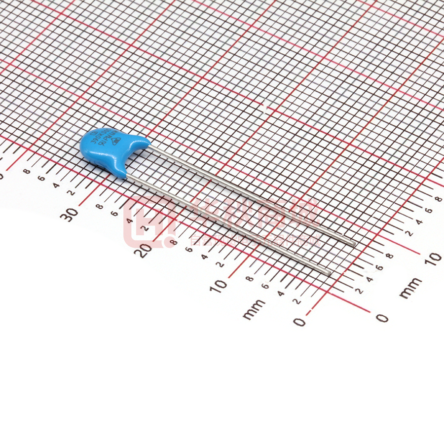

5Φ SERIES
Metal Oxide Varistors (MOV) Data Sheet
Features
Wide operating voltage (V1mA) range from 18V to 750V
Fast responding to transient over-voltage
Large absorbing transient energy capability
Low clamping ratio and no follow-on current
Meets MSL level 1, per J-STD-020
■ Operating Temperature:-40℃ ~ +105℃
■ Storage Temperature:-40℃ ~ +125℃
■ Safety certification:UL、CSA、VDE
Applications
■ Transistor, diode, IC, thyristor or triac semiconductor protection
■ Surge protection in consumer electronics
■ Surge protection in industrial electronics
■ Surge protection in electronic home appliances, gas and petroleum appliances
■ Relay and electromagnetic valve surge absorption
