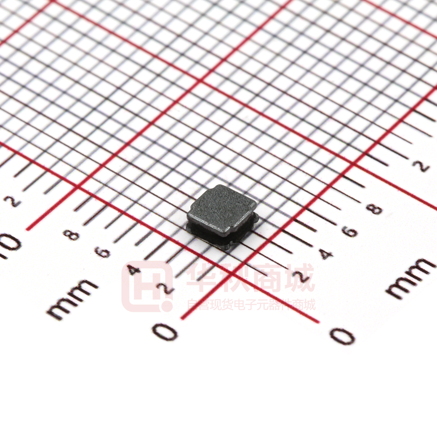

CSME0315D-4R7M-LRH
CSME0315D-4R7M-LRH
    PSA(信昌电陶)
    SMD,3x3mm
    功率电感 4.7µH ±20% 120mΩ IND_3X3MM_SM
CSME0315D-4R7M-LRH 数据手册
SPECIFICATION FOR APPROVAL ※This is a RoHS and REACH compliant product whose related documents are available on request. ※Graphic is only for dimensionally application. 1. PART NUMBER IDENTIFICATION CSME 0315 D - □□□ □ - LRH RoHS+H.F. TOLERANCE INDUCTANCE TERMINAL TYPE DIMENSION PRODUCT CODE 2. MECHANICAL DIMENSION UNIT : mm DIM. TOL. M1 3.0 ±0.2 M2 3.0 ±0.2 M3 1.5 MAX. M4 2.7 ±0.2 M5 0.75 ±0.2 M6 1.5 ±0.2 3. STRUCTURE 4. MATERIAL LIST NO Rev.B PARTS MATERIAL 1 DRUM CORE Ni-Zn FERRITE CORE 2 WIRE POLYURETHANE ENAMELED COPPER WIRE 3 ADHESIVE EPOXY RESIN MAGNETIC POWDER 4 PLATING ELECTRODES PLATING: Ag 10-20 um Ni 1-3 um Sn 3-7 um 5 OUTER ELECTRODES TOP SURFACE SOLDER COATING Sn99%、 Ag0.3%、Cu0.7% P3 Prosperity Dielectrics Co., Ltd. SPECIFICATION FOR APPROVAL 5. ELECTRICAL CHARACTERISTICS Part Number. Inductance (uH) DCR (mΩ) ±30% Isat (A) MAX. Irise (A) MAX. CSME0315D-1R0N-LRH 1.0 30 2.10 2.10 CSME0315D-1R5N-LRH 1.5 38 1.80 1.82 CSME0315D-2R2M-LRH 2.2 58 1.48 1.50 CSME0315D-3R3M-LRH 3.3 78 1.21 1.23 CSME0315D-4R7M-LRH 4.7 120 1.02 1.04 CSME0315D-6R8M-LRH 6.8 160 0.87 0.88 CSME0315D-100M-LRH 10 220 0.70 0.71 CSME0315D-220M-LRH 22 520 0.47 0.47 □TOLERANCE:M:±20%、N:±30% ※ INDUCTANCE:@100KHz,0.25V ※ TEST MACHINE: HIOKI3532-50 OR EQUIVALENT ※ DC RESISTANCE: HIOKI 3540 OR EQUIVALENT ※ ISAT / IRISE: HP4284+42841A OR EQUIVALENT ※ OPERATING TEMPERATURE: -40℃ ~ +125℃. ※ INDUCTANCE DROPS NO MORE THAN 30% OF INITIAL VALUE AT ISAT. ※ TEMPERATURE RISES:△ t< 40℃ AT IRMS. ※ MSL:LEVEL 1. Rev.B P4 Prosperity Dielectrics Co., Ltd. SPECIFICATION FOR APPROVAL 6. RELIABILITY PERFORMANCE 6-1.Storage Temperature range:-40℃~ +105℃ 6-2.Operating temperature range:-40℃ ~ +125℃ (Including coil’s self temperature rise) 6-3.External appearance:No external defects can be found in the visual inspection. 6-4.Electrode strength:No electrode detachment should be found when the device is pushed in two directions of X and Y with the force of 10.0N for 60±2 seconds after soldering between copper plate and the electrodes. (Refer to figure at right) 6-5.Vibration test:Inductance deviation is within ±10.0% after 1 hour sweeping vibration in each three directions, namely, forward and backward, up and down,right and left. The frequency is 10~55~10Hz and the amplitude of 1 minute cycle is 1.5mm PP. 6-6.Humidity test:Inductance deviation is within ±5.0% after 96±4 hours test under the condition of relative humidity of 90~95% and temperature of 60±2℃,and 1 hour storage under room ambient conditions after the device is wiped with dry cloth. Rev.B P5 Prosperity Dielectrics Co., Ltd. SPECIFICATION FOR APPROVAL 7. TYPICAL RoHS REFLOW PROFILE *Temperature on surface of circuit board The products may be exposed to reflow soldering process of above profile up to two times. Rev.B P6 Prosperity Dielectrics Co., Ltd. SPECIFICATION FOR APPROVAL 8. PACKAGING 8-1 OUTER PACKING 2 KPCS/REEL;20 KPCS/INNER BOX;80 KPCS/OUTER BOX 8-2 CARRIER TAPE DIMENSIONS UNIT : mm ITEM W P F E D0 P0 P2 T A0 B0 K0 DIM 8.00 4.00 3.50 1.75 1.50 4.00 2.00 0.25 3.3 3.3 1.9 TOLE ±0.3 ±0.1 ±0.05 ±0.1 +0.1 ±0.1 ±0.05 ±0.05 ±0.05 ±0.05 ±0.05 8-3 CARRIER REEL DIMENSIONS UNIT : mm Rev.B Type A B C G N T 8mm 178 20±0.8 13±0.4 9 60 10.8 P7 Prosperity Dielectrics Co., Ltd.
