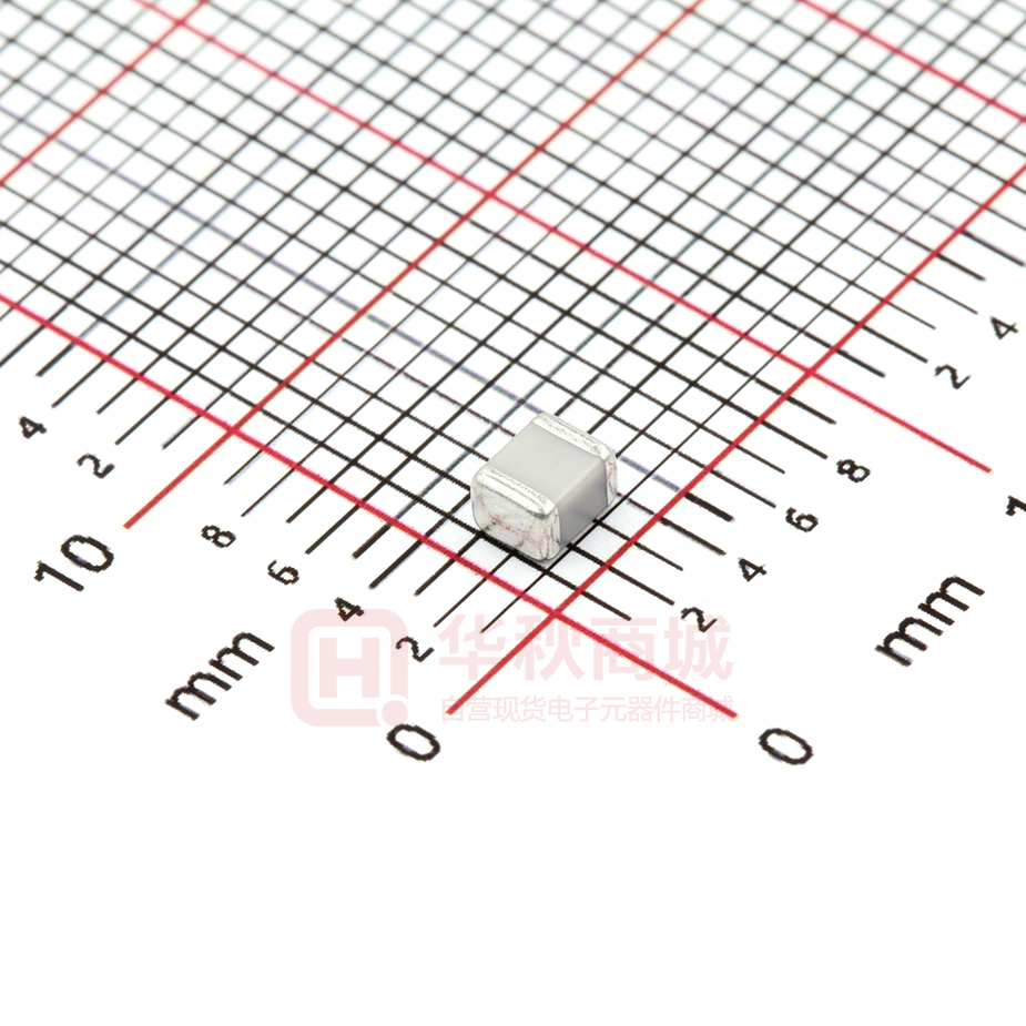

    贴片电容(MLCC) 1210 10nF ±5% 630V C0G(NP0)
