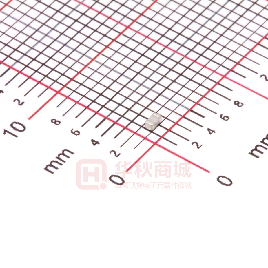

    贴片电容(MLCC) 0603 100pF ±5% 100V C0G(NP0)
FM18N101J101PSG 数据手册
