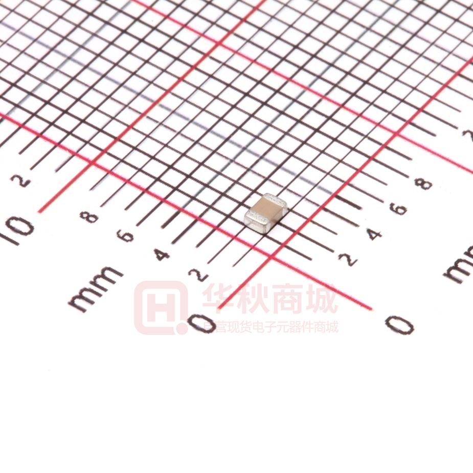

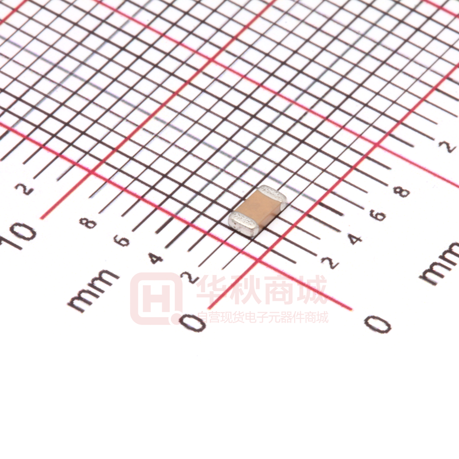

    贴片电容(MLCC) 0805 10nF ±10% 100V X7R
FM21X103K101PXG 数据手册
信昌電子陶瓷股份有限公司 Prosperity Dielectrics Co., Ltd. No.566-1, Kaoshi Rd., Yangmei, Taoyuan 32668, Taiwan (R.O.C.) Tel : 886-3-4753355 Fax : 886-3-4854959 Messrs. : Date : 一般共用 2020/11/02 APPROVAL SHEET Product Name : Medium Voltage Multilayer Ceramic Chip Capacitors Part No. : FM Series Description : Size 0402~2225, C0G/X7R/Y5V, 100Vdc~630Vdc PREPARED BY APPROVED BY 信昌電子陶瓷股份有限公司 PROSPERITY DIELECTRICS CO., LTD. 桃園市楊梅區高獅路 566-1 號 Tel : 03-4753355 ext : Contactor : http://www.pdc.com.tw Fax : 03-4854959 Mobile : DCM-003-8.1 Rev 2 信昌電子陶瓷股份有限公司 Prosperity Dielectrics Co., Ltd. No.566-1, Kaoshi Rd., Yangmei, Taoyuan 32668, Taiwan (R.O.C.) Tel : 886-3-4753355 Fax : 886-3-4854959 SPECIFICATION FOR Product Name : Medium Voltage Multilayer Ceramic Chip Capacitors Part No. : FM Series Description : Size 0402~2225, C0G/X7R/Y5V, 100Vdc~630Vdc SPEC. No. : FM-000-001-19 DATE : 2020/11/02 DRAWN BY CHECEKED BY APPROVED BY Jane Hsiao Yvens Chou Joseph Ling DCM-003-8.2 Rev 2 信昌電子陶瓷股份有限公司 Prosperity Dielectrics Co., Ltd. 1. INTRODUCTION FM Series green type capacitors are manufactured by using green materials without lead and cadmium. These capacitors feature series connection of multi-layer capacitor units in a MLCC to realize high voltage performance. Reliable performances are built-in through exact formulation of dielectric powders, preparation of conductive paste, advanced automatic manufacturing, and strict quality control to assure excellent control in dielectric thickness, electrode integrity, and electrode-to-termination continuity. 2. FEATURES 3. APPLICATIONS a. Medium voltage in a given case size. b. High reliability and stability. c. RoHS & HALOGEN compliant. a. b. c. d. DC to DC converter. High voltage coupling/DC blocking. Back-lighting inverters. Snubbers in high frequency power converters. 4. HOW TO ORDER FM PDC Family Table 1 31 X Size 471 K 251 Rated Voltage Table 6 Dielectric Capacitance Tolerance Table 2 Table 3 Table 4 Table 5 P X G Control Code Table 9 Packaging Thickness Table 7 Table 6 Table 8 Table 1 PDC Family Code Description Code Description Code Description Code Description FM 100V≤Rated Voltage≤630V series 101 100Vdc 251 250Vdc 501 500Vdc 201 200Vdc 401 400Vdc 631 630Vdc Table 2 Size Code Description Code Description Code Description 15 0402 (1005) 32 1210 (3225) 52 2211 (5728) 18 21 0603 (1608) 0805 (2012) 42 43 1808 (4520) 1812 (4532) 55 56 2220 (5750) 2225 (5763) 31 1206 (3216) 46 1825 (4563) Table 3 Table 7 Dielectric Material Characteristics Code Description Code Description N F C0G Y5V X X7R Table 4 Rated Voltage Capacitance Rule Code Packaging Type Code Description Code Description B Bulk T Tray package E K L Tape and 7” Reel, Embossed Tape Tape and 10” Reel, Embossed Tape P D G Tape and 10” Reel, Paper Tape Tape and 13” Reel, Embossed Tape Table 8 Tape and 7” Reel, Paper Tape Tape and 13” Reel, Paper Tape Thickness Description Code Description Code Description Code Description Code Description Code Description R47 0.47pF 102 102=10x102=1000pF A 0.60 ± 0.10 mm I 1.25 ± 0.20 mm Q 0.50 +0.02/-0.05 mm 0R5 100 0.5pF 100=10x100=10pF 104 106 104=10x104=100nF 106=10x106=10µF B C 0.8 + 0.15/-0.10 mm J K 1.15 ± 0.15 mm 0.50 ± 0.20 mm R S 3.10 ± 0.30 mm 1.25 ± 0.10 mm D 1.40 ± 0.15 mm L 0.30 ± 0.03 mm T 0.85 ± 0.10 mm E 1.60 ± 0.20 mm M 0.95 ± 0.10 mm U 0.50 ± 0.10 mm F G 2.00 ± 0.20 mm 0.50 ± 0.05 mm 3.50 ± 0.20 mm V X 0.20 ± 0.02 mm 2.50 ± 0.30 mm N O H 2.80 ± 0.30 mm P 1.60 +0.3/-0.10 mm Z 0.25 ± 0.03 mm Table 5 Tolerance Code Description Code Description Code Description A ±0.05 pF J ±5 % X +10%~+20% B ±0.10 pF K ±10 % C ±0.25 pF L 0% ~ +10% D F ±0.50 pF ±1 % M N ±20 % -5% ~ +10% Table 9 Code Description G H ±2 % ±3 % P Q ±0.02 pF ±0.03 pF G Q RoHS Compliant Surface Coating (Size 1206~2225) I -10% ~ 0% Z -20% ~ +80% 0.80 ± 0.07 mm 0.80 ± 0.10 mm Special Control Code Specification No. : FM-000-001-19 ~1~ DCM-003-8.3 Rev 2 信昌電子陶瓷股份有限公司 Prosperity Dielectrics Co., Ltd. 5. EXTERNAL DIMENSIONS Size Inch (mm) L (mm) W (mm) 0402(1005) 1.00±0.10 0.50±0.10 0603(1608) 0805(2012) 1.60±0.15 2.00±0.20 3.20±0.20 0.80±0.15 1.25±0.20 1.60±0.20 3.20 +0.30/-0.10# 1.60 +0.30/-0.10# 3.20±0.30 4.50±0.40 4.50±0.40 4.50±0.40 5.70±0.40 5.70±0.40 2.50±0.30 2.00±0.25 3.20±0.30 6.30±0.40 5.00±0.40 6.30±0.40 1206(3216) 1210(3225) 1808(4520) 1812(4532) 1825(4563) 2220(5750) 2225(5763) Code / T (mm) MB (mm) 0.25 +0.05/-0.10 0.40±0.15 0.50±0.20 See No.4 Reference Table 8 L T 0.60±0.20 W 0.75±0.35 0.75±0.35 0.75±0.35 0.75±0.35 0.85±0.35 0.85±0.35 MB MB Fig. 5.1 The outline of MLCC “#”For 1206 size P thickness products. 6. GENERAL ELECTRICAL DATA Dielectric Size Rated voltage (WVDC) Capacitance range Capacitance tolerance Tan δ C0G X7R Y5V 0402, 0603, 0805, 1206, 1210, 1808, 1812, 1825, 2220, 2225 0402, 0603, 0805, 1206, 1210, 1808, 1812, 1825, 2220, 2225 0805, 1206, 1210, 1812 100V, 200V, 250V, 500V, 630V 100V, 200V, 250V, 500V, 630V 100V, 200V, 250V 0.5pF ~ 100nF 100pF ~ 820nF 10nF to 680nF Reference to Table5 Reference to Table5 Reference to Table5 ≤2.5% ~ ≤10.0% ≤5.0% Cap. Rang Q Spec. Cap.1000pF 1.0±0.2Vrms, 1.0KHz±10% temperature Insulation resistance at Ur Operating temperature Capacitance characteristic Termination ≥10GΩ or RxC≥500Ω-F, whichever is smaller ≥10GΩ or RxC≥100Ω-F, whichever is smaller -55 to +125°C ±30ppm/°C -25 to +85°C ±15% +30/-80% Cu or Ag/Ni/Sn or Au (lead-free termination) Specification No. : FM-000-001-19 ~2~ DCM-003-8.3 Rev 2 信昌電子陶瓷股份有限公司 Prosperity Dielectrics Co., Ltd. 7. CAPACITANCE RANGE 7-1. C0G Dimension Cap(pF) code 0.5 0R5 1.0 1R0 1.2 1R2 1.5 1R5 1.8 1R8 2.2 2R2 2.7 2R7 3.3 3R3 3.9 3R9 4.7 4R7 5.6 5R6 6.8 6R8 8.2 8R2 10 100 12 120 15 150 18 180 22 220 27 270 33 330 39 390 47 470 56 560 68 680 82 820 100 101 120 121 150 151 180 181 220 221 270 271 330 331 390 391 470 471 560 561 680 681 820 821 1000 102 1200 122 1500 152 1800 182 2200 222 2700 272 3300 332 3900 392 4700 472 5600 562 6800 682 8200 822 10000 103 12000 123 15000 153 18000 183 22000 223 27000 273 33000 333 100V N N N N N N N N N N N N N N N N N N N N N N N N N N N N N N 0402 200V N N N N N N N N N N N N N N N N N N N N N N N N N N 250V N N N N N N N N N N N N N N N N N N N N N N N 100V S S S S S S S S S S S S S S S S S S S S S S S S S S S S S S S S S S S S S S B B 0603 200V S S S S S S S S S S S S S S S S S S S S S S S S S S S S S S B B B B B 250V S S S S S S S S S S S S S S S S S S S S S S S S S S S S S S B B B B B 100V A A A A A A A A A A A A A A A A A A A A A A A A A A A A A A A A X X X X X X X X X X C C C C C C 200V A A A A A A A A A A A A A A A A A A A A A A A A A A A X X C C C C C C C C C C C C C C 0805 250V A A A A A A A A A A A A A A A A A A A A A A A A A X X X C C C C C C C C C C C C C C C 500V A A A A A A A A A A A A A A A A A A A A A A A A X X C C C C C C C I I I I I 630V A A A A A A A A A A A A A A A A A A A A A A A A X X C C C C C C C I I I I I 100V X X X X X X X X X X X X X X X X X X X X X X X X X X X X X X X X X X X X X X X M M C C C E E E E P P P P 200V 1206 250V X X X X X X X X X X X X X X X X X X X X X X X X X X X X X X M M M M M M C C C C C E E E E E E X X X X X X X X X X X X X X X X X X X X X X X X X X X M M M M C C E E E E E E E E E E E E E E 500V X X X X X X X X X X X X X X X X X X X X X X X X X X X X M M M M C C E E E E E E E E E E E E Specification No. : FM-000-001-19 630V X X X X X X X X X X X X X X X X X X X X X X X X X X X M M M M C C E E E E E E E E E E ~3~ DCM-003-8.3 Rev 2 信昌電子陶瓷股份有限公司 Prosperity Dielectrics Co., Ltd. 7. CAPACITANCE RANGE 7-1. C0G Dimension Cap(pF) code 2.2 2R2 2.7 2R7 3.3 3R3 3.9 3R9 4.7 4R7 5.6 5R6 6.8 6R8 8.2 8R2 10 100 12 120 15 150 18 180 22 220 27 270 33 330 39 390 47 470 56 560 68 680 82 820 100 101 120 121 150 151 180 181 220 221 270 271 330 331 390 391 470 471 560 561 680 681 820 821 1000 102 1200 122 1500 152 1800 182 2200 222 2700 272 3300 332 3900 392 4700 472 5600 562 6800 682 8200 822 10000 103 12000 123 15000 153 18000 183 22000 223 27000 273 33000 333 39000 393 47000 473 56000 563 68000 683 82000 823 100000 104 100V 200V 1210 250V M M M M M M M M M M M M M M M M M M M M M M M M M M M M M M M M M C C C E E F F/G F/G F F F F M M M M M M M M M M M M M M M M M M M M M M M M C C C C C C C C E E E E F C/E/F C/E/F E/F/G E/F/G F G M M M M M M M M M M M M M M M M M M M M M M M M C C C C C C C C E E E E F C/E/F C/E/F E/F E/F F G 500V 630V M M M M M M M M M M M M M M M M M M M M M M M M C C C C C C C C C C E E F M M M M M M M M M M M M M M M M M M M M M M M M C C C C C C C C C C E E F 100V C C C C C C C C C C C C C C C C C C C C C C C C C C C C C C C C C C C C C C C C C C C E E 200V C C C C C C C C C C C C C C C C C C C C C C C C C C C C C C C C C C C C C C C C C E E F F 1808 250V C C C C C C C C C C C C C C C C C C C C C C C C C C C C C C C C C C C C C C C C C E E F F 500V C C C C C C C C C C C C C C C C C C C C C C C C C F F F F F F F F F F F F F F 630V C C C C C C C C C C C C C C C C C C C C C C C C C F F F F F F F F F F F F F F 100V 200V 1812 250V C C C C C C C C C C C C C C C C C C C C C C C C C C C C C C C C C C C C C C C E E F F G G G G G G C C C C C C C C C C C C C C C C C C C C C C C C C C C C C C C C C C C C C E E F F G C C C C C C C C C C C C C C C C C C C C C C C C C C C C C C C C C C C C C E E F F G 500V 630V C C C C C C C C C C C C C C C C C C C C C C C C C C C C C C C C C C C C C E E F F C C C C C C C C C C C C C C C C C C C C C C C C C C C C C C C C C C C C C E E F F Specification No. : FM-000-001-19 ~4~ DCM-003-8.3 Rev 2 信昌電子陶瓷股份有限公司 Prosperity Dielectrics Co., Ltd. 7. CAPACITANCE RANGE 7-1. C0G Dimension Cap(pF) code 100V 200V 1825 250V 500V 630V 100V 200V 2220 250V 500V 630V 100V 200V 2225 250V 500V 630V 10 12 15 18 22 27 100 120 150 180 220 270 F F F F F F F F F F F F F F F F F F F F F F F F F F F F F F F F F F F F F F F F F F F F F F F F F F F F F F F F F F F F F F F F F F F F F F F F F F F F F F F F F F F F F F F F F F 33 39 47 56 68 82 330 390 470 560 680 820 F F F F F F F F F F F F F F F F F F F F F F F F F F F F F F F F F F F F F F F F F F F F F F F F F F F F F F F F F F F F F F F F F F F F F F F F F F F F F F F F F F F F F F F F F F 100 120 150 180 220 270 101 121 151 181 221 271 F F F F F F F F F F F F F F F F F F F F F F F F F F F F F F F F F F F F F F F F F F F F F F F F F F F F F F F F F F F F F F F F F F F F F F F F F F F F F F F F F F F F F F F F F F 330 390 470 560 680 820 331 391 471 561 681 821 F F F F F F F F F F F F F F F F F F F F F F F F F F F F F F F F F F F F F F F F F F F F F F F F F F F F F F F F F F F F F F F F F F F F F F F F F F F F F F F F F F F F F F F F F F 1000 1200 1500 1800 2200 2700 102 122 152 182 222 272 F F F F F F F F F F F F F F F F F F F F F F F F F F F F F F F F F F F F F F F F F F F F F F F F F F F F F F F F F F F F F F F F F F F F F F F F F F F F F F F F F F F F F F F F F F 3300 3900 4700 5600 6800 8200 332 392 472 562 682 822 F F F F F F F F F F F F F F F F F F F F F F F F F F F F F F F F F F F F F F F F F F F F F F F F F F F F F F F F F F F F F F F F F F F F F F F F F F F F F F F F F F F F F F F F F F 10000 12000 15000 18000 22000 27000 103 123 153 183 223 273 F F F F F F F F F F F F F F F F F F F F F F F F F F F F F F F F F F F F F F F F F F F F F F F F F F F F F F F F F F F F F F F F F F F F F F F F F F F F F F F F F F F F F F F F 33000 39000 47000 56000 68000 82000 333 393 473 563 683 823 F F F F F G F F F G G F F F G G F F F F F F F G F F G G G F F G G G F G G F F F F F F F F F G G G F F F G G G F F F G H R F F F G H 100000 120000 150000 180000 220000 104 124 154 184 224 G G G G G Specification No. : FM-000-001-19 ~5~ DCM-003-8.3 Rev 2 信昌電子陶瓷股份有限公司 Prosperity Dielectrics Co., Ltd. 7. CAPACITANCE RANGE 7-2. X7R Dimension 0402 0603 0805 1206 Cap(pF) code 100V 100V 200V 250V 100V 200V 250V 500V 630V 100V 200V 250V 500V 630V 100 101 N S B B X X X X X X C C C C 120 121 N S B B X X X X X X C C C C 150 151 N S B B X X X X X X C C C C 180 181 N S B B X X X X X X C C C C 220 221 N S B B X X X X X X C C C C 270 271 N S B B X X X X X X C C C C 330 331 N S B B X X X X X X C C C C 390 391 N S B B X X X X X X C C C C 470 471 N S B B X X X X X X C C C C 560 561 N S B B X X X X X X C C C C 680 681 N S B B X X X X X X C C C C 820 821 N S B B X X X X X X C C C C 1000 102 N S B B X X X X X X C C C C 1200 122 N S B B X X X X X X C C C C 1500 152 N S B B X X X X X X C C C C 1800 182 N S B B X X X X X X C C C C 2200 222 N S B B X X X X X X C C C C 2700 272 N S B B X X X X X X C C C C 3300 332 N S B B X X X X X X C C C C 3900 392 N S B B X X X X X X C C C C 4700 472 N S B B X X X C C X C C C C 5600 562 S B B X X X C C X C C C C 6800 682 S B B X X X C C X C C C C 8200 822 S B B X X X C C X C C C C 10000 103 S B B X C C C C X C C C C 12000 123 B X C C C C X C C C C 15000 153 B X C C C C X C C C C 18000 183 B X C C C C X C C C C 22000 223 B X C C C C X C C E E 27000 273 B C C C C C X C C E E 33000 333 B C C C C X E E E E 39000 393 B C C C X E E E E 47000 473 B C C C X E E E E 56000 563 B C C C X E E E E 68000 683 B C C C X E E 82000 823 B C C C E E 100000 104 B C C C E E 120000 124 I C E E 150000 154 I E E E 180000 184 I E E E 220000 224 I E E E 270000 274 I E 330000 334 I E 390000 394 I E 470000 474 I E 560000 564 P 680000 684 P 820000 824 P Specification No. : FM-000-001-19 ~6~ DCM-003-8.3 Rev 2 信昌電子陶瓷股份有限公司 Prosperity Dielectrics Co., Ltd. 7. CAPACITANCE RANGE 7-2. X7R Dimension Cap(pF) code 100 101 120 121 150 151 180 181 220 221 270 271 330 331 390 391 470 471 560 561 680 681 820 821 1000 102 1200 122 1500 152 1800 182 2200 222 2700 272 3300 332 3900 392 4700 472 5600 562 6800 682 8200 822 10000 103 12000 123 15000 153 18000 183 22000 223 27000 273 33000 333 39000 393 47000 473 56000 563 68000 683 82000 823 100000 104 120000 124 150000 154 180000 184 220000 224 270000 274 330000 334 390000 394 470000 474 560000 564 680000 684 820000 824 100V M M M M M M M M M M M M M M M M M M M M M M M M M M M M M M M M M M C C C E E G G G G G 200V M M M M M M M M M M M M M M M M M M M M M M M M M M M M C C E E E E G G G G G G G G G 1210 250V M M M M M M M M M M M M M M M M M M M M M M M M M M M M C E E E E E G G G G G G G G G 500V C C C C C C C C C C C C C C C C C C C C C C C C C E E E E E F F F 630V C C C C C C C C C C C C C C C C C C C C C C C C C E E E E E F F F 1808 500V 630V C C C C C C C C C C C C C C C C C C C F F F F F F F F F F F F F F F C C C C C C C C C C C C C C C C C C C F F F F F F F F F F F F F F F 100V 200V 1812 250V C C C C C C C C C C C C C C C C C C C C C C C C C C C C C C C C C C C C C C C F F F F C C C C C C C C C C C C C C C C C C C C C C C C C C C C C C C C C F F F F F F F G G G C C C C C C C C C C C C C C C C C C C C C C C C C C C C C C C C C F F F F F F F G G G 500V 630V C C C C C C C C C C C C C C C C C C C C C C C C C C C C F F F F G G G G G G G G C C C C C C C C C C C C C C C C C C C C C C C C C C C C F F F F G G G G Specification No. : FM-000-001-19 ~7~ DCM-003-8.3 Rev 2 信昌電子陶瓷股份有限公司 Prosperity Dielectrics Co., Ltd. 7. CAPACITANCE RANGE 7-2. X7R Dimension 1825 2220 2225 Cap(pF) code 100V 200V 250V 500V 630V 100V 200V 250V 500V 630V 100V 200V 250V 500V 630V 1000 102 F F F F F F F F F F F F F F F 1200 122 F F F F F F F F F F F F F F F 1500 152 F F F F F F F F F F F F F F F 1800 182 F F F F F F F F F F F F F F F 2200 222 F F F F F F F F F F F F F F F 2700 272 F F F F F F F F F F F F F F F 3300 332 F F F F F F F F F F F F F F F 3900 392 F F F F F F F F F F F F F F F 4700 472 F F F F F F F F F F F F F F F 5600 562 F F F F F F F F F F F F F F F 6800 682 F F F F F F F F F F F F F F F 8200 822 F F F F F F F F F F F F F F F 10000 103 F F F F F F F F F F F F F F F 12000 123 F F F F F F F F F F F F F F F 15000 153 F F F F F F F F F F F F F F F 18000 183 F F F F F F F F F F F F F F F 22000 223 F F F F F F F F F F F F F F F 27000 273 F F F F F F F F F F F F F F F 33000 333 F F F F F F F F F F F F F F F 39000 393 F F F F F F F F F F F F F F F 47000 473 F F F F F F F F F F F F F F F 56000 563 F F F F F F F F F F F F F F F 68000 683 F F F F F F F F F F F F F F F 82000 823 F F F F F F F F F F F F F F F 100000 104 F F F F F F F F F F F F F F F 120000 124 F F F F F F F F F F F F F F F 150000 154 F F F F F F F F F F F F F F F 180000 184 F F F F F F F F F F F F F F F 220000 224 F F F F F F F F F F F F F F F 270000 274 F F F F F F F F F F F F F F F 330000 334 F F F F F F F F F F F F F F F 390000 394 F F F F F F F F F F F F F F F 470000 474 F F F F F F F F F F F F F F F 560000 564 F F F G G F F F F F F F F 680000 684 F F F F F F F F F 820000 824 F F F F F F F F F Specification No. : FM-000-001-19 ~8~ DCM-003-8.3 Rev 2 信昌電子陶瓷股份有限公司 Prosperity Dielectrics Co., Ltd. 7. CAPACITANCE RANGE 7-3. Y5V Dimension 0805 1206 1210 1812 Cap(μF) code 100V 200V 250V 100V 200V 250V 100V 200V 250V 100V 200V 250V 0.010 103 B B B B B B C C C D D D 0.015 153 B B B B B B C C C D D D 0.022 223 B B B B B B C C C D D D 0.033 333 B B B B B B C C C D D D 0.047 473 B B B B B B C C C D D D 0.068 683 B B B B B B C C C D D D 0.10 104 B B B B C C C D D D 0.15 154 C C C C C C D D D 0.22 224 C C D D D 0.33 334 C D D D 0.47 474 D D D 0.68 684 D D D Specification No. : FM-000-001-19 ~9~ DCM-003-8.3 Rev 2 信昌電子陶瓷股份有限公司 Prosperity Dielectrics Co., Ltd. 8. RELIABILITY TEST CONDITIONS AND REQUIREMENTS No. 1. Item Visual and Dimensions Test Condition Requirements * No remarkable defect. --- * Dimensions to confirm to individual specification sheet. 2. Capacitance * Shall not exceed the limits given in the detailed spec. * Class I : C0G Q/ D.F. 3. (Tangent of loss angle) Temperature 4. Cap.≤1000pF, 1.0±0.2Vrms, 1MHz±10%. 6. Q/D.F. Class I Q≥1000 Cap.≥30pF (C0G) Q≥400+20C Cap.0.22µF * Class II : (X7R, Y5V) D.F.≤3.5% 1.0±0.2Vrms, 1KHz±10%. Remark X7R items X7R 0603≥0.047μF, 0805=0.1μF, 1206≥0.47μF X7R 0603≥0.068μF, 0805>0.1µF All Y5V items Cap.>1000pF, 1.0±0.2Vrms, 1KHz±10%. Class II * With no electrical load. Coefficient (Temperature characteristic of capacitance) 5. Dielectric T.C. Operating Temp. C0G -55~125°C at 25°C X7R -55~125°C at 25°C Y5V -25~85°C at 20°C Rated Vol.(V) Apply Voltage Test Condition Insulation =100 1 times of UR Max. 120 sec. Resistance 200≤V≤500 1 times of UR 60 sec. >500 500Vdc 60 sec. T.C. Capacitance Change C0G Within ±30ppm/°C X7R Within ±15% Y5V Within +30%/-80% Dielectric Requirements Class I ≥10GΩ or RxC≥500Ω-F, whichever is smaller Class II ≥10GΩ or RxC≥100Ω-F, whichever is smaller * Solder temperature : 235±5°C for (0402~1210). Solderability * Solder temperature : 245±5°C for (1808~2225). * 75% min. coverage of all metalized area. * Dipping time : 2±0.5 sec. Rated Vol.(V) Condition ≤100 2.5 times of UR 100
