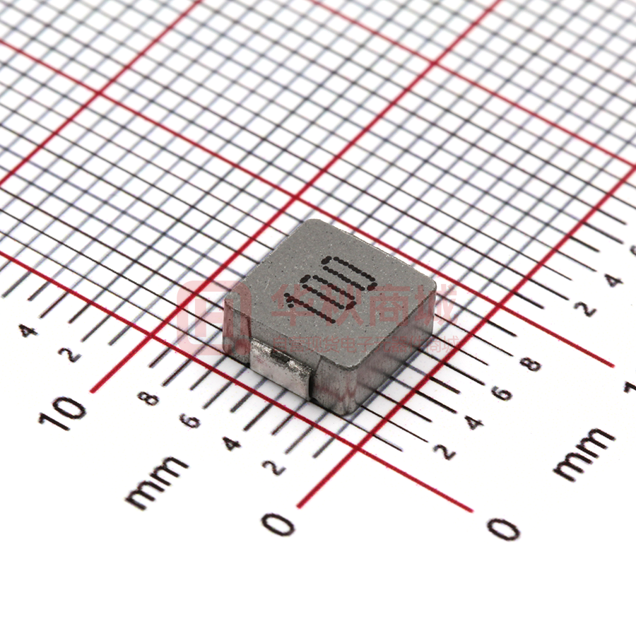

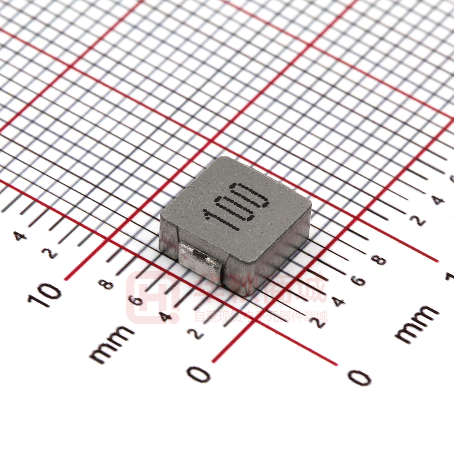

HIGH CURRENT MOLDING POWER CHOKE MCS0630 Series (SHIELDED) ■ Mechanical Dimensions (Unit: mm) 3 Max 7.4 7.4 7.4 3.7 3.7 3.7 3.7 3.5 1.5 ±0.5 7.4 3.5 3 Max 3.5 Max 3 Max 3 3 ±0.3 3 ±0.3 XXX xxx 1.5 ±0.5 1.5 ±0.5 7.3 Max 1.5 ±0.5 XXX xxx XXX xxx 7.3 Max XXX xxx 7.3 Max 7.3 Max 6.6 ±0.2 6.6 ±0.2 36.6 3 ±0.3 6.6 ±0.2 ±0.3±0.2 3.5 MCS0630 Recommended Patterns ■ Electrical Specification Part Number Marking Inductance (uH) Inductance Tolerance Test Freq. (KHz) MCS0630-R22MN2 MCS0630-R33MN2 MCS0630-R47MN2 MCS0630-R56MN2 MCS0630-R68MN2 MCS0630-R82MN2 MCS0630-1R0MN2 MCS0630-1R5MN2 MCS0630-2R2MN2 MCS0630-3R3MN2 MCS0630-4R7MN2 MCS0630-6R8MN2 MCS0630-8R2MN1 MCS0630-100MN1 R22 R33 R47 R56 R68 R82 1R0 1R5 2R2 3R3 4R7 6R8 8R2 100 0.22 0.33 0.47 0.56 0.68 0.82 1.00 1.50 2.20 3.30 4.70 6.80 8.20 10.00 M M M M M M M M M M M M M M 100 100 100 100 100 100 100 100 100 100 100 100 100 100 DCR (mΩ) Typ. 2.50 3.50 4.00 4.70 5.00 6.70 9.00 14.0 17.0 28.0 37.0 54.0 54.0 62.0 DCR (mΩ) Max. 2.80 3.90 4.20 5.00 5.50 8.00 10.0 15.0 20.0 30.0 40.0 60.0 60.0 68.0 Rated Current Typ. 23.0 20.0 17.5 16.5 15.5 13.0 11.0 9.00 8.00 6.00 5.50 4.50 4.50 4.00 I sat (A) Typ. 40.0 30.0 26.5 25.5 25.0 20.0 20.0 16.0 12.0 10.0 7.00 6.50 6.50 5.50 a. Tolerance: M=±20%,N=±30% b. All test data is referenced to 25°C ambient. c. Operating Temperature Range -55°C to +125°C . d. Rated current (A) that will cause an approximate ΔT of 40°C . e. Isat (A) that will cause Lo to drop approximately 20%. f. The part temperature (ambient +temp rise) should not exceed 125°C under worst case operating conditions. Circuit design, component placement, PWB trace size and thickness, airflow and other cooling provisions all affect the part temperature Part temperature should be verified in the end application. g. Test Instrument: Chroma16502、Chroma11300 ■ Characteristic Curve ‧MCS0630 Temperature Rise vs. DC Current Temperature Rise vs. DC Current Inductance vs.vs.DC Current Inductance DC Current 150 11 4R7M 10 3R3M 120 8 100M 7 8R2M 6 5 6R8M 4 1R5M R68M 1R0M R22M 0 5 R68M 100M 8R2M 60 30 2R2M 1 0 R22M R82M 6R8M 3R3M 2 R33M 1R0M R47M 90 4R7M 3 2R2M 1R5M ΔT (°C) ΔT (℃) Inductance (uH) Inductance (uH) 9 10 15 20 25 DC Current (A) DC Current (A) 30 35 40 0 45 0 5 10 15 20 25 30 35 40 45 DC Current DC Current (A) (A) 60 2013目錄.indd 60 2013/2/1 下午 03:02:49
