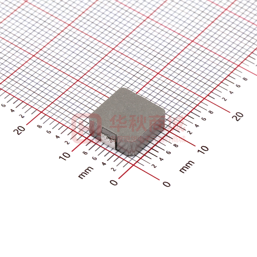

SLO1770H Series
SMD Molding Power Inductor
◆ Features
Pb
、Magnetically shielded construction, low DC resistance;
、The use of magnetic iron powder ensure capability
for large current;
3、Low audible core noise;
4、Ideal for DC-DC converter applications in hand held
personal computer and etc;
5、Frequency Range: up to 3.0MHz;
6、RoHS compliant。
