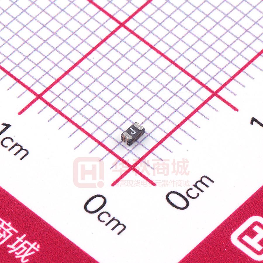

    PTC自恢复保险丝 FUSE0603 6V 0.5A
SMD0603P050TF 数据手册
SMD0603 HF Series Surface Mount PTC Devices SMD0603 HF Series Surface Mount PTC Devices Description The 0603 series provides miniature surface mount resettable overcurrent protection with holding current from 40mA to 500mA. This world’s smallest PTC is suitable for ultra portable applications where space is at a premium and the device current is low. Features y RoHS compliant and lead-free y Low profile y Halogen-free y Fast response to fault current y Compact design saves board space y Compatible with high temperature solders Applications y Mobile phones and PDAs y USB peripherals y Portable MP3 and media player y IC VCC protection y Mobile Internet Device (MID) Agency Approval and Environmental Compliance Agency File Number Regulation Standard E201431  2011/65/EU R50099121  IEC 61249-2-21:2003 Electrical Characteristics Maximum Time To Trip Current Time (A) (Sec.) Part Number Ihold (A) Itrip (A) Vmax (Vdc) Imax (A) Pd typ (W) SMD0603P004TF 0.04 0.12 24 20 0.5 0.20 SMD0603P010TF 0.10 0.30 15 40 0.5 SMD0603P020TF 0.20 0.50 9 40 SMD0603P025TF 0.25 0.55 9 SMD0603P035TF 0.35 0.75 SMD0603P050TF 0.50 1.00 Resistance Agency Approval Rmin () R1max () 1.00 4.000 40.000 3 3 0.50 1.00 0.900 6.000 3 3 0.5 1.00 0.60 0.550 3.500 3 3 40 0.5 8.00 0.08 0.500 3.000 3 3 6 40 0.5 8.00 0.10 0.200 1.000 3 3 6 40 0.5 8.00 0.10 0.100 0.680 3 3  㖗䫠ⷩ䦸⭟ⷌ㥔⛹⌧ⷌ㥔㝘⛂巖 24-1 噆 No. 24-1 Industry E. Rd. IV, Hsinchu Science Park, Hsinchu 300, Taiwan. TEL: +886-3-5643931 FAX: +886-3-5644624 http://www.pttc.com.tw Page: 2 of 10 2017/01/03 Revision: G SMD0603 HF Series Surface Mount PTC Devices Note on Electrical Characteristics „ Vocabulary Ihold = Hold current: maximum current device will pass without tripping in 23ºC still air. Itrip = Trip current: minimum current at which the device will trip in 23 ºC still air. Vmax = Maximum voltage device can withstand without damage at rated current (I max) Imax = Maximum fault current device can withstand without damage at rated voltage (Vmax) Pd typ = Typical power dissipated from device when in the tripped state at 23 ºC still air. Rmin = Minimum resistance of device in initial (un-soldered) state. R1max = Maximum resistance of device at 23 ºC measured one hour after tripping or reflow soldering of 260 ºC for 20 sec. „ Value specified is determined by using the PWB with 0.020”*1.5oz copper traces. „ Caution: Operation beyond the specified rating may result in damage and possible arcing and flame. „ Specifications are subject to change without notice. Polymeric PTC Selecting Guide „ Determine the following operating parameters for the circuits: y Normal operating current (Ihold) Ɂ Maximum interrupt current (Imax) y Maximum circuit voltage (Vmax) Ɂ Normal operating temperature surrounding device (minºC/maxºC) y Surface Mount Device (SMD) Ɂ Axial Leaded Device (ALD) y Radial Leaded Device (RLD) Ɂ DISC Device !! !! „ Select the device form factor and dimension suitable for the application: !! Ɂ Other Customized Form Factors !! !! „ Compare the maximum rating for Vmax and Imax of the PPTC device with the circuit in application and make sure the circuit’s requirement does not exceed the device rating. „ Check that PPTC device’s trip time (time-to-trip) will protect the circuit. „ Verify that the circuit operating temperature is within the PPTC device’s normal operating temperature range. „ Verify the performance and suitability of the chosen PPTC device in the application. „ Mechanical Stress y PPTC devices will undergo a thermal expansion during fault condition. If PPTC devices are installed or placed in an application where the space between PPTC devices and the surrounding materials (e.g., covering materials, packaging materials, encapsulate materials and the like) is insufficient, it will cause an inhibiting effect upon the thermal expansion. Pressing, twisting, bending and other kinds of mechanical stress will also adversely affect the performance of the PPTC devices, and shall not be used or applied. „ Chemical Pollutants y Silicone-based oils, oils, solvents, gels, electrolytes, fuels, acids, and the like will adversely affect the properties of PPTC devices, and shall not be used or applied. „ Electronic and Thermal Effect y PPTC devices are secondary protection devices and are used solely for sporadic, accidental over-current or over-temperature error condition, and shall NOT be used if or when constant or repeated fault conditions (such fault conditions may be caused by, among others, incorrect pin-connection of a connector) or over-extensive trip events may occur. y PTTC devices are different from fuses and, when a fault condition occurs, will go into high-resistance state and do not open circuit, in which case the voltage at such PPTC devices may reach a hazardous level. y Operation over the maximum rating or other forms of improper use may cause failure, arcing, flame and/or other damage to the PPTC devices. y Conductive material contamination, such as metal particle, may induce shortage, flame or arcing. y Due to the inductance, the operation circuits may generate a circuit voltage (Ldi/dt) above the rated voltage of PPTC devices, which shall not be used under such circumstances. „ General y Customers shall evaluate and test the properties of PPTC devices independently to verify and ensure that their individual applications will be met. y The performance of PPTC devices will be adversely affected if they are improperly used under electronic, thermal and/or mechanical procedures and/or conditions non-conformant to those recommended by manufacturer. y Customers shall be responsible for determining whether it is necessary to have back-up, failsafe and/or fool-proof protection to avoid or minimize damage that may result from extra-ordinary, irregular function or failure of PPTC devices. y Any and all responsibilities and liabilities are disclaimed if any item under this notice of warning is not complied with.  㖗䫠ⷩ䦸⭟ⷌ㥔⛹⌧ⷌ㥔㝘⛂巖 24-1 噆 No. 24-1 Industry E. Rd. IV, Hsinchu Science Park, Hsinchu 300, Taiwan. TEL: +886-3-5643931 FAX: +886-3-5644624 http://www.pttc.com.tw Page: 3 of 10 2017/01/03 Revision: G SMD0603 HF Series Surface Mount PTC Devices Thermal Derating Curve Percentage of Rated Current 200.00 150.00 100.00 50.00 0.00 -40.00 0.00 40.00 80.00 120.00 Device Ambient Temperature (ɗ ) Thermal Derating Chart Recommended Hold Current (A) at Ambient Temperature (ºC) Part Number Ambient Operation Temperature -40 ºC -20 ºC 0 ºC 23 ºC 40 ºC 50 ºC 60 ºC 70 ºC 85 ºC SMD0603P004TF 0.052 0.048 0.044 0.040 0.032 0.028 0.024 0.020 0.012 SMD0603P010TF 0.13 0.12 0.11 0.10 0.08 0.07 0.06 0.05 0.03 SMD0603P020TF 0.27 0.25 0.23 0.20 0.17 0.14 0.12 0.10 0.07 SMD0603P025TF 0.32 0.29 0.27 0.25 0.21 0.18 0.16 0.14 0.10 SMD0603P035TF 0.47 0.41 0.38 0.35 0.29 0.26 0.24 0.20 0.14 SMD0603P050TF 0.67 0.59 0.54 0.50 0.41 0.37 0.34 0.29 0.20  㖗䫠ⷩ䦸⭟ⷌ㥔⛹⌧ⷌ㥔㝘⛂巖 24-1 噆 No. 24-1 Industry E. Rd. IV, Hsinchu Science Park, Hsinchu 300, Taiwan. TEL: +886-3-5643931 FAX: +886-3-5644624 http://www.pttc.com.tw Page: 4 of 10 2017/01/03 Revision: G SMD0603 HF Series Surface Mount PTC Devices Average Time-Current Curve B 100.00 CD E F A炼SMD0603P004TF B炼SMD0603P010TF C炼SMD0603P020TF Time to Trip (Sec.) 10.00 D炼SMD0603P025TF E炼SMD0603P035TF F炼SMD0603P050TF 1.00 A 0.10 0.01 0.10 1.00 10.00 Fault Current (Amp.)  㖗䫠ⷩ䦸⭟ⷌ㥔⛹⌧ⷌ㥔㝘⛂巖 24-1 噆 No. 24-1 Industry E. Rd. IV, Hsinchu Science Park, Hsinchu 300, Taiwan. TEL: +886-3-5643931 FAX: +886-3-5644624 http://www.pttc.com.tw Page: 5 of 10 2017/01/03 Revision: G SMD0603 HF Series Surface Mount PTC Devices Soldering Parameters Profile Feature Average Ramp-Up Rate (Tsmax to TP) Preheat -Temperature Min (Tsmin) -Temperature Max (Tsmax) -Time (Tsmin to Tsmax) Time maintained above: -Temperature (TL) -Time (tL) Peak Temperature (TP) Time within 5ºC of actual Peak Temperature (tP) Ramp-Down Rate Time 25ºC to Peak Temperature Storage Condition Pb-Free Assembly 3ºC/second max. 150ºC 200ºC 60-180 seconds 217ºC 60-150 seconds 260ºC 20-40 seconds 6 ºC /second max. 8 minutes max. 0ºC ~35ºC, ʀ70%RH y Recommended reflow methods: IR, vapor phase oven, hot air oven, N2 environment for lead-free y Recommended maximum paste thickness is 0.25mm (0.010 inch) y Devices can be cleaned using standard industry methods and solvents. Note 1: All temperature refer to topside of the package, measured on the package body surface. Note 2: If reflow temperatures exceed the recommended profile, devices may not meet the performance requirements.  㖗䫠ⷩ䦸⭟ⷌ㥔⛹⌧ⷌ㥔㝘⛂巖 24-1 噆 No. 24-1 Industry E. Rd. IV, Hsinchu Science Park, Hsinchu 300, Taiwan. TEL: +886-3-5643931 FAX: +886-3-5644624 http://www.pttc.com.tw Page: 6 of 10 2017/01/03 Revision: G SMD0603 HF Series Surface Mount PTC Devices Physical Dimensions (mm.) Part identification Figure 1 Part Number A B C D E Min. Max. Min. Max. Min. Max. Min. Max. Min. Max. SMD0603P004TF 1.40 1.80 0.60 1.00 0.40 0.75 0.15 0.50 -- 0.40 SMD0603P010TF 1.40 1.80 0.60 1.00 0.40 0.75 0.15 0.50 -- 0.40 SMD0603P020TF 1.40 1.80 0.60 1.00 0.40 0.75 0.15 0.50 -- 0.40 SMD0603P025TF 1.40 1.80 0.60 1.00 0.40 0.75 0.15 0.50 -- 0.40 SMD0603P035TF 1.40 1.80 0.60 1.00 0.75 1.55 0.15 0.50 -- 0.40 SMD0603P050TF 1.40 1.80 0.60 1.00 0.75 1.55 0.15 0.50 -- 0.40 Environmental Specifications Operating Temperature -40ºC to +85 ºC Maximum Device Surface Temperature in Tripped State 125ºC Passive Aging +85ºC , 1000 hours ±5% typical resistance change Humidity Aging +85ºC , 85%R.H. 1000 hours ±5% typical resistance change Thermal Shock MIL-STD-202 Method 107G +85ºC /-40ºC 20 times -30% typical resistance change Solvent Resistance MIL-STD-202, Method 215 No change Vibration MIL-STD-883C, Method 2007.1, Condition A No change Moisture Sensitivity Level Level 1, J-STD-020C  㖗䫠ⷩ䦸⭟ⷌ㥔⛹⌧ⷌ㥔㝘⛂巖 24-1 噆 No. 24-1 Industry E. Rd. IV, Hsinchu Science Park, Hsinchu 300, Taiwan. TEL: +886-3-5643931 FAX: +886-3-5644624 http://www.pttc.com.tw Page: 7 of 10 2017/01/03 Revision: G SMD0603 HF Series Surface Mount PTC Devices Packaging Quantity and Marking Recommended Pad Layout (mm.) 0.80 1.00 1.00 Part Number SMD0603P004TF 1.00 Marking Quantity ʈ 4000 SMD0603P010TF C 4000 SMD0603P020TF H 4000 SMD0603P025TF I 4000 SMD0603P035TF F 4000 SMD0603P050TF J 4000 ˖ġ 8 mm tape on 7 inch reel per EIA-481 (equivalent to IEC286, part 3) Physical Specifications Terminal Material Solder-Plated Copper (Solder Material: Matte Tin (Sn)) Lead Solderability Meets EIA Specification RS186-9E, ANSI/J-STD-002 Category 3.  㖗䫠ⷩ䦸⭟ⷌ㥔⛹⌧ⷌ㥔㝘⛂巖 24-1 噆 No. 24-1 Industry E. Rd. IV, Hsinchu Science Park, Hsinchu 300, Taiwan. TEL: +886-3-5643931 FAX: +886-3-5644624 http://www.pttc.com.tw Page: 8 of 10 2017/01/03 Revision: G SMD0603 HF Series Surface Mount PTC Devices Tape Specifications: EIA-481 (mm.) P004TF P035TF P010TF P050TF P020TF P025TF W F E1 D0 D1 P0 P1 P2 A0 B0 T K0 8.00 ± 0.30 8.00 ± 0.30 3.50 ± 0.05 3.50 ± 0.05 1.75 ± 0.10 1.75 ± 0.10 1.55 ± 0.05 1.55 ± 0.05 0.50 ± 0.10 0.50 ± 0.10 4.00 ± 0.10 4.00 ± 0.10 4.00 ± 0.10 4.00 ± 0.10 2.00 ± 0.05 2.00 ± 0.05 1.10 ± 0.10 1.10 ± 0.10 1.92 ± 0.10 1.92 ± 0.10 0.20 ± 0.10 0.20 ± 0.10 0.72 ± 0.10 0.96 ± 0.10 Leader min. 390 390 Trailer min. 160 160 Reel Dimensions: EIA-481 (mm.) C D H W Ø178 ± 1.0 Ø60.2 ± 0.5 11.0 ± 0.5 9.0 ± 1.5  㖗䫠ⷩ䦸⭟ⷌ㥔⛹⌧ⷌ㥔㝘⛂巖 24-1 噆 No. 24-1 Industry E. Rd. IV, Hsinchu Science Park, Hsinchu 300, Taiwan. TEL: +886-3-5643931 FAX: +886-3-5644624 http://www.pttc.com.tw Page: 9 of 10 2017/01/03 Revision: G SMD0603 HF Series Surface Mount PTC Devices Part Number System SMD 0603 P  TF T / Special Voltage Rating (Optional) Thickness Version (Optional) Lead- Free Holding Current Rating Polytronics Symbol Device Dimensions: Length/Width (Unit: 1/100 inch) Surface Mount Device Cross Reference Polytronics / EVERFUSE® Cross Reference TE Connectivity / PolySwitch® Bourns / Multifuse® - SMD0603P004TF SMD0603P010TF FemtoSMD010F - SMD0603P020TF FemtoSMD020F MF-FSMF020X SMD0603P025TF - - SMD0603P035TF FemtoSMD035F MF-FSMF035X SMD0603P050TF - MF-FSMF050X “EVERFUSE” is a registered trademark of Polytronics Technology Corp. “Multifuse” is a registered trademark of Bourns, Inc. “PolySwitch” is a registered trademark of TE Connectivity Ltd.  㖗䫠ⷩ䦸⭟ⷌ㥔⛹⌧ⷌ㥔㝘⛂巖 24-1 噆 No. 24-1 Industry E. Rd. IV, Hsinchu Science Park, Hsinchu 300, Taiwan. TEL: +886-3-5643931 FAX: +886-3-5644624 http://www.pttc.com.tw Page: 10 of 10 2017/01/03 Revision: G
