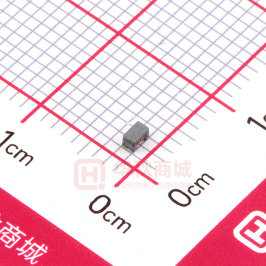

    共模滤波器 0805 90Ω@100MHz ±25% 400mA 300mΩ
SMW2012B900DTE 数据手册
SMW-B Series Wire-wound Common Mode Filter Pb ◆ Features 1 、Powerful component with composite co-fired material to solve EMI problem for high-speed differential signal transmission line as USB, IEEE1394 and LVDS, without distortion to high speed signal transmission 、High coupling constant : 0.99 3、Small size and low profile 4、Various common mode impedance items 2 of 67 to 220 ohm can be used, considering noise level and signal frequency 、 、 5 Small dimension enable higher density packaging 6 RoHS Compliant. ◆ Application 、 1 Common mode noise suppression of signal lines in high speed and high density digital equipment 、 ; 2 USB2.0/3.0 of PC, peripheral equipments, small digital AV equipments, etc 。 ◆ PRODUCT IDENTIFICATION SMW 2012 B 900 D T (1) (2) (3) (4) (5) (6) E (7) (1) Series Type (2) Chip Size mm :Length X Width ( ) ◆ Equivalent Circuit Diagram (3) Material type : With maganetic shield(B/D/H) (4) Nominal Impedance:900=90Ω ; 101=100Ω (5) Rated Curren :A=250mA; B=300mA;C=350mA; D=400mA; E=1000mA;F=1500mA G=3000mA (6) Company Code (7) Packaging: P – Embossed paper tape, 7" reel E – Embossed plastic tape, 7" reel T – Tape & reel ◆ Impedance : Measured by using Agilent E4991A RF Impedance Analyzer Rev.03 Page 1 of 9 www. sunltech.com SMW-B Series ◆ Dimensions Unit: mm 1 4 2 3 Series A(mm) B(mm) C(mm) D1(mm) D2(mm) E(mm) SMW1608 1.6 ± 0.1 0.8 ± 0.1 1.1 ± 0.1 0.33±0.1 0.25±0.1 0.12±0.1 SMW2012 2.0±0.2 1.2±0.2 1.2±0.2 0.55±0.1 0.46±0.1 0.15±0.1 SMW3216 3.2±0.2 1.6±0.2 1.9±0.2 0.6±0.1 0.6±0.1 0.17±0.1 SMW4532 4.5±0.2 3.2±0.2 2.8±0.2 1.2±0.1 1.0±0.1 0.19±0.1 ◆ Specifications Part Number SMW1608B Series SMW1608B670BTE SMW1608B900BTE SMW1608B121ATE SMW1608B161ATE SMW1608B221ATE SMW2012B Series SMW2012B300DTE SMW2012B670DTE SMW2012B750DTE SMW2012B900DTE SMW2012B121DTE SMW2012B161CTE SMW2012B181CTE SMW2012B201BTE SMW2012B221BTE SMW2012B261BTE SMW2012B361BTE SMW2012B371BTE Rev.03 Common mode Impedance Z( ) Ω ± 90±25% 120±25% 160±25% 220±25% 67 25% ± 67±25% 75±25% 90±25% 120±25% 160±25% 180±25% 200±25% 220±25% 260±25% 360±25% 370±25% 30 25% Test Frequency MHz DC Resistance ( ) max. Rated Current (mA) Rated Volt. (Vdc) Withstand Volt. (Vdc) 100 0.30 300 50 125 10M 100 0.30 300 50 125 10M 100 0.36 250 50 125 10M 100 0.40 250 50 125 10M 100 0.42 250 50 125 10M 100 0.20 450 50 125 10M 100 0.25 400 50 125 10M 100 0.25 400 50 125 10M 100 0.30 400 50 125 10M 100 0.30 400 50 125 10M 100 0.35 350 50 125 10M 100 0.35 350 50 125 10M 100 0.40 300 50 125 10M 100 0.40 300 50 125 10M 100 0.40 300 50 125 10M 100 0.45 300 50 125 10M 100 0.45 300 50 125 10M ( ) Page 2 of 9 Ω IR Ω) min. ( www. sunltech.com SMW-B Series ◆ Specifications Part Number Common mode Impedance Z( ) Ω Test Frequency MHz ( ) DC Resistance ( ) max. Rated Current (mA) Rated Volt. (Vdc) Withstand Volt. (Vdc) Ω IR Ω) min. ( SMW3216B Series SMW3216B900DTE 90±25% 100 0.30 450 50 125 20M SMW3216B121DTE 120±25% 100 0.35 400 50 125 10M SMW3216B161CTE 160±25% 100 0.40 350 50 125 10M SMW3216B201CTE 200±25% 100 0.45 350 50 125 10M SMW3216B221BTE 220±25% 100 0.45 300 50 125 10M SMW3216B261BTE 260±25% 100 0.50 300 50 125 10M SMW3216B361BTE 360±25% 100 0.60 300 50 125 10M SMW3216B601ATE 600±25% 100 0.80 250 50 125 10M SMW3216B102ATE 1000±25% 100 1.00 250 50 125 10M SMW3216B222ATE 2200±25% 100 1.20 250 50 125 10M SMW4532B800GTE 80±25% 100 0.07 3000 50 125 10M SMW4532B900GTE 90±25% 100 0.07 3000 50 125 10M SMW4532B121GTE 120±25% 100 0.07 3000 50 125 10M SMW4532B601FTE 600±25% 100 0.30 1500 50 125 10M SMW4532B102ETE 1000±25% 100 0.40 1000 50 125 10M SMW4532B142FTE 1400±25% 100 0.20 1500 50 125 10M SMW4532B Series ◆ General Technical Data Operating Temperature Range Storage Condition Rev.03 ℃ ~ +85℃ 20°C ~ 25°C and 65% RH (For Reference) -25 Page 3 of 9 www. sunltech.com SMW-B Series ◆ Recommended soldering conditions ◆ Characteristics SMW1608B670B_ Rev.03 SMW1608B900B_ Page 4 of 9 www. sunltech.com SMW-B Series SMW1608B161A_ SMW1608B121A_ SMW2012B670D_ SMW1608B221A_ ◆ Characteristics SMW2012B900D_ SMW2012B750D_ Rev.03 Page 5 of 9 www. sunltech.com SMW-B Series SMW2012B161C_ SMW2012B121D_ SMW2012B221C_ SMW2012B161C_ SMW2012B361C_ SMW2012B261C_ Rev.03 Page 6 of 9 www. sunltech.com SMW-B Series SMW2012B371C_ SMW3216B900D_ SMW3216B160C_ SMW3216B261B_ Rev.03 SMW3216B601B_ Page 7 of 9 www. sunltech.com SMW-B Series SMW3216B222A_ SMW3216B102A_ SMW4532B800G_ SMW4532B900G_ SMW4532B121G_ Rev.03 SMW4532B601G_ Page 8 of 9 www. sunltech.com SMW-B Series SMW4532B102E_ SMW4532B142F_ ◆ Package Rev.03 Size EIA (EIA) 1608 (0603) 2012 (0805) 3216 (1206) 4532 (1812) Standard Packing Quantity (pcs / reel) 2,000 2,000 2,000 2,000 Page 9 of 9 www. sunltech.com
