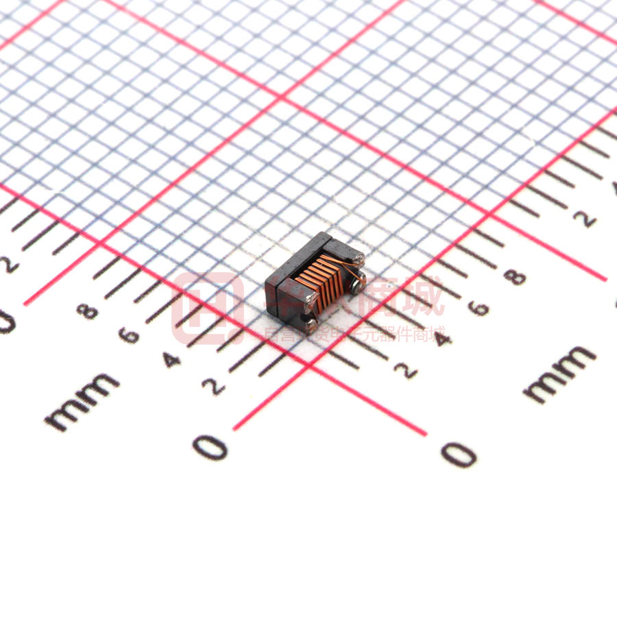

SMW-B Series
Wire-wound Common Mode Filter
Pb
◆ Features
1
、Powerful component with composite co-fired
material to solve EMI problem for high-speed
differential signal transmission line as USB,
IEEE1394 and LVDS, without distortion to
high speed signal transmission
、High coupling constant : 0.99
3、Small size and low profile
4、Various common mode impedance items
2
of 67 to 220 ohm can be used, considering
noise level and signal frequency
5 Small dimension enable higher density packaging
6 RoHS Compliant.

(1) Series Type
(2) Chip Size mm :Length X Width
◆ Equivalent Circuit Diagram
(3)
Material type : With maganetic shield(B/D/H)
(4)
Nominal Impedance:900=90Ω
101=100Ω
(5)
Rated Curren
:A=250mA; B=300mA;C=350mA;
D=400mA; E=1000mA;F=1500mA
G=3000mA
(6) Company Code
(7) Packaging: P – Embossed paper tape, 7" reel
E – Embossed plastic tape, 7" reel
T – Tape & reel
