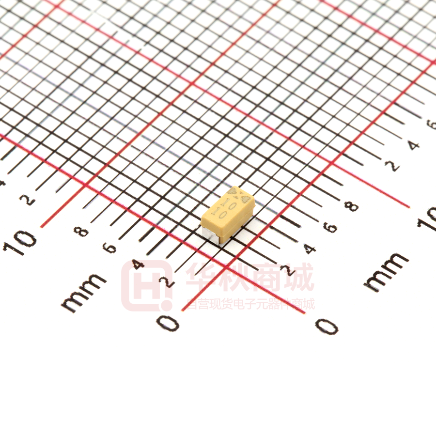

CA45B-A-10V-10μF-K
CA45B-A-10V-10μF-K
    CEC(振华)
    A3216-18
    钽电容 A3216-18 10µF ±10% 10V
CA45B-A-10V-10μF-K 数据手册
