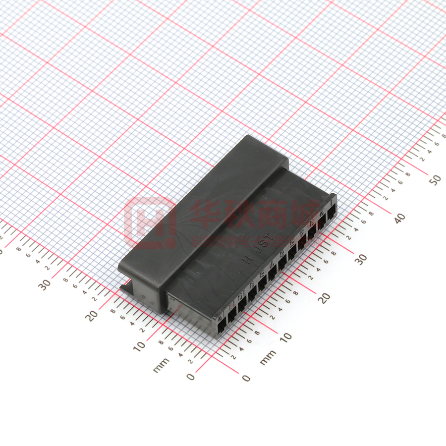

    胶壳 间距P=2.50mm 12Pin(1x12)
SMR-12V-B 数据手册
SM CONNECTOR 2.5 mm pitch/Disconnectable Crimp style wire-to-wire connectors Specifications SM CONNECTOR • Current rating: 3 A AC/DC max. • Voltage rating: 250 V AC/DC max. • Temperature range: -25℃ to +85℃ (including temperature rise in applying electrical current) • Contact resistance: Initial value/ 10 mΩ max. After environmental tests/ 20 mΩ max. • Insulation resistance: 500 MΩ min. • Withstanding voltage: 1,500 VAC/minute • Applicable wire: AWG #28 to #22 0.08 to 0.33 mm2 • Applicable panel thickness: 0.5 to 2.0 mm * In using the products,refer to "Handling Precautions for Terminals and Connectors" described on our website (Technical documents of Product information page). * RoHS2 compliance * Dimensional unit: mm * Contact JST for details. The SM series are 2.5 mm pitch, wire-to-wire connectors that perform reliably in high-density, small current applications. ● ● ● ● High contact pressure Highly reliable housing construction Mountable on a variety of panels Arm lock mechanism ® ® ® Standards ® ® Recognized E60389 R50120150 Panel Layout and Assembly layout 2~12 circuits:8.7   18 circuits:14.5 (22.9) +0.15 4.15 +0.15  0 1.6 4  0 +0.15 5.15   0 SMコネクター表2 A B 7 Model No. Plug housing 2 SMP-02V-B(N)C SMP-03V-B(N)C SMP-04V-B(N)C SMP-05V-B(N)C SMP-06V-B(N)C SMP-07V-B(N)C SMP-08V-B(N)C SMP-09V-B(N)C SMP-10V-B(N)C SMP-11V-B(N)C SMP-12V-B(N)C SMP-18V-B(N)C 3 4 +0.15 0 1.4 No. of circuits 5 6 +0.15 10.15 0 7.15 0 +0.15 7 8 9 10 11 A B 12 18 Note: 1 . Punch holes in the panel according to the sketch and table shown above. Burrs must be removed. 2. The strength of the panel must be considered when punching two or more holes. 3. The connector must be inserted from the same side as the hole is punched. Panel thickness (mm) 0.5~0.9 1.0~1.5 1.5~2.0 Panel hole dimensions (mm) General tolerance +0.15 0 B ±0.1 +0.15 0 B ±0.1 +0.15 0 B ±0.1 8.2 12.1 8.2 12.3 8.2 10.7 14.6 12.5 10.7 14.8 10.7 13.2 15.0 17.1 13.2 17.3 13.2 17.5 15.7 19.6 15.7 19.8 15.7 20.0 18.2 22.1 18.2 22.3 18.2 22.5 20.7 24.6 20.7 24.8 20.7 25.0 23.2 27.1 23.2 27.3 23.2 27.5 25.7 29.6 25.7 29.8 25.7 30.0 28.2 32.1 28.2 32.3 28.2 32.5 30.7 34.6 30.7 34.8 30.7 35.0 23.2 27.2 23.2 27.4 23.2 27.6 A 5.7 9.6 A 5.7 9.8 A 5.7 10.0 1 SM CONNECTOR Contact 1.95 1.1 Socket contact 1.1 Pin contact 9 15.8 SMコネクター表1 3.8 2 1.7 2.3 3 0.64 1.7 Applicable wire Model No. Pin contact Socket contact mm2 AWG # Insulation O.D. (mm) SYM-001T-P0.6 SHF-001T-0.8BS 0.08~0.33 28~22 1.2~1.8 Q’ty/reel Pin contact: 8,500 Socket contact: 5,000 Material and Finish Phosphor bronze, tin-plated (reflow treatment) RoHS2 compliance Note: 1  . Contact JST for special products. 2. Contact JST for brass products. Contact Crimping machine Crimp applicator SYM-001T-P0.6 MKS-L AP-K2N Applicator Crimp applicator with dies Dies MK/SYM-001-06 APLMK SYM001-06 Crimping machine Crimp applicator Contact SHF-001T-0.8BS MKS-L AP-K2N Applicator Crimp applicator with dies Dies MK/SHF-001-08S APLMK SHF001-08S Note: Contact JST for fully automatic crimping applicator. Note: Contact JST for fully automatic crimping applicator. Contact position location numbers Contact position numbers are stamped Receptacle housing Plug housing 10 15 18 JST 14 13 1 1 2 3 4 5 6 15 7 18 12 1 2 3 4 5 6 7 8 9 10 11 12 9 5 4 14 4 4 13 JST 3 1 2 3 4 5 6 7 8 9 11 3 12 2 10 11 12 13 14 15 16 17 18 12 1 10 1 2 1 2 3 4 5 6 7 8 9 10 11 12 Plug housing JST Receptacle housing 1 2 3 4 5 6 7 8 9 10 11 12 13 14 15 16 17 18 SM CONNECTOR P254 Housing Material: PA 6, UL94V-0 Current rating Receptacle housing (for pin contact) 5.5 3A 8 2 Q’ty/ bag 1,000 10.2 7.5 Q’ty/ bag 8 7.5 1,000 18.2 11.7 SMR-04V-B, black SMR-04V-N, white (natural) 10.5 Q’ty/ bag 13 3A SMP-03V-BC, black SMP-03V-NC, white (natural) 1,000 10.2 4 7.4 8 10.5 3A Q’ty/ bag Q’ty/ bag 1,000 11.7 18.2 SMR-03V-B, black SMR-03V-N, white (natural) 3 SMP-02V-BC, black SMP-02V-NC, white (natural) 5.5 SMR-02V-B, black SMR-02V-N, white (natural) Plug housing (for socket contact) 500 7.4 SMP-04V-BC, black SMP-04V-NC, white (natural) Q’ty/ bag 10.5 No. of circuits 1,000 10.2 18.2 11.7 13 3A 15.5 5 Q’ty/ bag 500 7.5 15.5 7.5 1,000 11.7 Q’ty/ bag 18 3A Q’ty/ bag 10.2 18.2 SMR-06V-B, black SMR-06V-N, white (natural) 6 SMP-05V-BC, black SMP-05V-NC, white (natural) 13 SMR-05V-B, black SMR-05V-N, white (natural) 7.4 500 7.4 SMP-06V-BC, black SMP-06V-NC, white (natural) Q’ty/ bag 15.5 7.5 500 10.2 18.2 11.7 7.4 RoHS2 compliance 3 SM CONNECTOR P255 Housing Receptacle housing (for pin contact) SMR-07V-B, black SMR-07V-N, white (natural) 18 3A 20.5 7 Plug housing (for socket contact) Q’ty/ bag 500 SMP-07V-BC, black SMP-07V-NC, white (natural) Q’ty/ bag 18 No. of circuits Material: PA 6, UL94V-0 Current rating 500 10.2 11.7 18.2 SMR-08V-B, black SMR-08V-N, white (natural) 20.5 3A 23 8 Q’ty/ bag 500 7.4 SMP-08V-BC, black SMP-08V-NC, white (natural) Q’ty/ bag 20.5 7.5 500 10.2 11.7 18.2 SMR-09V-B, black SMR-09V-N, white (natural) 23 3A 25.5 9 Q’ty/ bag 500 7.4 SMP-09V-BC, black SMP-09V-NC, white (natural) Q’ty/ bag 23 7.5 500 10.2 18.2 11.7 SMR-10V-B, black SMR-10V-N, white (natural) 25.5 3A 28 10 Q’ty/ bag 200 SMP-10V-BC, black SMP-10V-NC, white (natural) 10.2 28 3A Q’ty/ bag 30.5 11 500 11.7 18.2 SMR-11V-B, black SMR-11V-N, white (natural) 200 Q’ty/ bag 7.4 SMP-11V-BC, black SMP-11V-NC, white (natural) Q’ty/ bag 28 7.5 7.4 25.5 7.5 500 10.2 7.5 RoHS2 compliance 4 18.2 11.7 7.4 SM CONNECTOR P256 Housing Material: PA 6, UL94V-0 Current rating Receptacle housing (for pin contact) 30.5 3A 33 12 Q’ty/ bag 7.5 500 10.2 7.4 SMP-18V-BC, black SMP-18V-NC, white (natural) 23 25.5 2A Q’ty/ bag Q’ty/ bag 500 11.7 18.2 SMR-18V-B, black SMR-18V-N, white (natural) 18 SMP-12V-BC, black SMP-12V-NC, white (natural) 30.5 SMR-12V-B, black SMR-12V-N, white (natural) Plug housing (for socket contact) 200 Q’ty/ bag 23 No. of circuits 200 10 12.5 18.7 11.7 12.4 RoHS2 compliance Note: 1  . SM connectors with any number of circuits can be used either panel mounted or free hanging. 2. Contact JST for special products. 5
