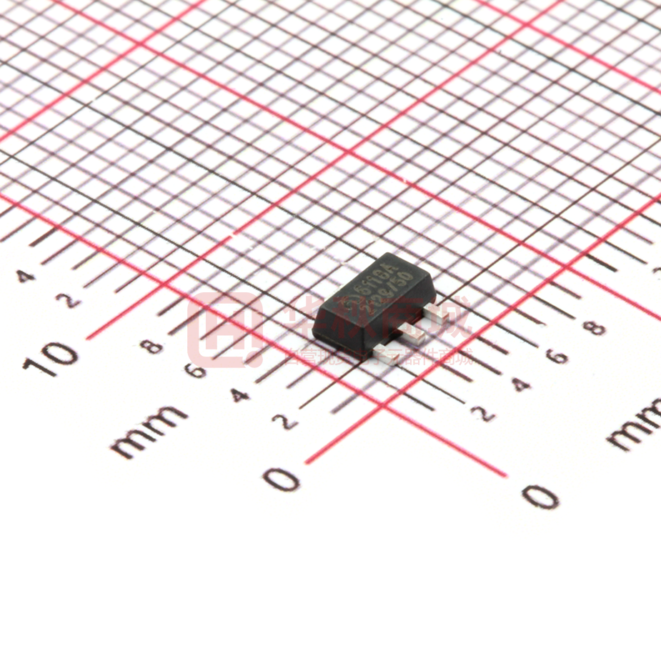

    低压差线性稳压器 VIN:18V Vout:5V ±2%
ME6118A50PG 数据手册
ME6118 1A High Speed LDO Regulators ME6118 Series General Description Features The ME6118 series are highly accurate, low noise,  Output Current in Excess of 1A LDO Voltage Regulators that are capable of providing  Dropout Voltage:80mV@ IOUT =100mA (ME6118A33) an output current that is in excess of 1A with a  maximum dropout voltage of 1.3V at 1A ( ME6118 Operating Voltage Range: A33).This series contains eight fixed output voltages of 2.5V ~ 18V (Vout≥1.2V) 0.75V, 1.2V, 1.8V, 2.5V, 3.3V, 3.6V, 4.3V and 5.0V that 2.5V ~ 8V (Vout=0.75V) have no minimum load requirement to maintain  Highly Accuracy: ±2% regulation. the  Standby Current: 52uA(TYP.) reference/output voltage to within ±2% accuracy.  High Ripple Rejection: 70dB@1KHz(ME6118A33) Internal protection features consist of output current  Line Regulation: 2mV(TYP.) limiting, safe operating area compensation, and thermal  Temperature Stability≤0.5% shutdown. The ME6118 series can operate with up to  Thermal Shutdown Protection:160℃ On chip trimming adjusts 18V input. Typical Application Package  Consumer and Industrial Equipment Point of  3-pin SOT223 ,SOT23-3,SOT89-3,TO252-2 Regulation  8-pin DFN3*3-8(P=0.65)  Switching Power Supply Post Regulation  Hard Drive Controllers  Battery Chargers Typical Application Circuit VIN CIN 10uF V16 VOUT ME6118 COUT 10uF RL VSS www.microne.com.cn Page 1 of 22 ME6118 Selection Guide ME 61 18 X XX XX G Environment mark Package B3:SOT223 M3:SOT23-3 P:SOT89-3 K3:TO252-2 N8A:DFN3*3-8(P=0.65) Output Voltage Different pin Product Type Product Series Microne product series product description ME6118A12B3G VOUT =1.2V; Package:SOT223 ME6118A18B3G VOUT =1.8V; Package:SOT223 ME6118A18N8AG VOUT =1.8V; Package:DFN3*3-8(P=0.65) ME6118A25B3G VOUT =2.5V; Package:SOT223 ME6118A33B3G VOUT =3.3V; Package:SOT223 ME6118A33PG VOUT =3.3V; Package:SOT89-3 ME6118A33M3G VOUT =3.3V; Package:SOT23-3 ME6118A33K3G VOUT =3.3V; Package:TO252-2 ME6118A36PG VOUT =3.6V; Package:SOT89-3 ME6118A43B3G VOUT =4.3V; Package:SOT223 ME6118A50B3G VOUT =5.0V; Package:SOT223 ME6118A50PG VOUT =5.0V; Package:SOT89-3 ME6118B075N8AG VOUT =0.75V;Package:DFN3*3-8(P=0.65) ;Different pin ME6118E25B3G VOUT =2.5V; Package:SOT223; Different pin ME6118E33B3G VOUT =3.3V; Package:SOT223; Different pin ME6118H33B3G VOUT =3.3V; Package:SOT223; Different pin ME6118H33PG VOUT =3.3V; Package:SOT89-3; Different pin ME6118L50K3G VOUT =5.0V; Package:TO252-2; Different pin NOTE: At present ,there are eight kinds of voltage value:0.75V、1.2V、1.8V、2.5V、3.3V、3.6V、 4.3V、5.0V。 If you need other voltage and package, please contact our sales staff。 V16 www.microne.com.cn Page 2 of 22 ME6118 Pin Configuration 3 1 2 3 1 1 2 1 SOT223 SOT23-3 2 2 3 3 SOT89-3 TO252-2 1 8 2 7 3 6 4 5 DFN3*3-8 Pin Assignment ME6118AXX Pin Number Pin Name Functions 7 GND Ground 2 3,4 VOUT Output 3 1,2 VIN Power Input 5,6,8 NC SOT223 SOT89-3 TO252-2 SOT23-3 DFN3*3-8 1 1 1 1 2 3 2 3 2 3 ME6118BXX Pin Number Pin Name Functions 4 GND Ground 1 VOUT Output 8 VIN Power Input 2,3,5,6,7 NC DFN3*3-8 ME6118EXX Pin Number Pin Name Functions 1 GND Ground 2 2 VIN Power Input 3 3 VOUT Output SOT223 TO252-2 1 ME6118HXX Pin Number Pin Name Functions 1 VOUT Output 2 2 GND Ground 3 3 VIN Power Input SOT223 TO252-2 SOT89-3 1 1 2 3 ME6118LXX Pin Number Pin Name Functions 1 VIN Power Input 2 2 GND Ground 3 3 VOUT Output SOT223 TO252-2 1 V16 www.microne.com.cn Page 3 of 22 ME6118 Block Diagram Absolute Maximum Ratings Parameter Symbol Ratings Units Input Voltage VIN 18 V Output Current IOUT 1.1 A Output Voltage VOUT Vss-0.3~VIN +0.3 V Thermal resistance Power Dissipation SOT223 70 SOT89-3 100 TO252-2 θja 55 SOT23-3 230 DFN3*3-8 70 SOT223 1.8 SOT89-3 1.25 TO252-2 PD 2.25 SOT23-3 0.54 DFN3*3-8 1.8 ºC /W W Operating Ambient Temperature Range TOPR -40 ~ +85 ºC Storage Temperature Range TSTG -55 ~ +150 ºC Junction temperature Range TJ -40 ~ +150 ºC Lead Temperature V16 260℃,4sec www.microne.com.cn Page 4 of 22 ME6118 Electrical Characteristics ME6118B075 (Package:DFN3*3-8) (VIN= VOUT+1.0V,CIN=CL=10uF,Ta=25OC, unless otherwise noted) Parameter Symbol Conditions Min. Typ. Max. Units Output Voltage VOUT(E) (Note 2) IOUT=10mA, VIN= VOUT+1.0V X 0.98 VOUT (T) (Note 1) X 1.02 V Maximum Output Current IOUTMAX VIN= VOUT+1.0V 400 mA Load Regulation ∆VOUT VIN= VOUT+1.0V , 1mA≤IOUT≤400mA 3 mV Dropout Voltage (Note 3) VDIF IOUT =400mA 1000 mV Quiescent Current Iss VIN= VOUT+1.3V 46 uA Line Regulation ∆VOUT IOUT =0mA VOUT+1.0V ≤VIN≤8V 1 mV Thermal Shutdown Protection Tsd IOUT=10mA, VIN= VOUT+1.3V 160 ℃ Over Current Protection Ilimit VIN=3V 1.1 A ME6118A12/E12/H12/L12 (Packages:SOT223 ,SOT89-3,TO252-2) (VIN= VOUT+1.3V,CIN=CL=10uF,Ta=25OC, unless otherwise noted) Parameter Symbol Conditions Min. Typ. Max. Units Output Voltage VOUT(E) (Note 2) IOUT=10mA, VIN= VOUT+1.3V X 0.98 VOUT (T) (Note 1) X 1.02 V Maximum Output Current IOUTMAX VIN= VOUT+1.3V 800 mA Load Regulation ∆VOUT VIN= VOUT+1.3V , 1mA≤IOUT≤800mA 3 mV VDIF1 IOUT =100mA 195 mV VDIF2 IOUT =400mA 665 mV VDIF3 IOUT =800mA 1250 mV VDIF4 IOUT =1000mA 1600 mV Quiescent Current Iss VIN= VOUT+1.3V 53 uA Line Regulation ∆VOUT IOUT =0mA VOUT+1.3V ≤VIN≤18V 2 mV Thermal Shutdown Protection Tsd IOUT=10mA, VIN= VOUT+1.3V 155 ℃ Over Current Protection Ilimit VIN=3V 1.1 A Dropout Voltage (Note 3) V16 www.microne.com.cn Page 5 of 22 ME6118 ME6118A18/E18/H18/L18 (Packages:SOT223 ,SOT89-3,TO252-2,DFN3*3-8) (VIN= VOUT+1.2V,CIN=CL=10uF,Ta=25OC, unless otherwise noted) Parameter Symbol Conditions Min. Typ. Max. Units Output Voltage VOUT(E) (Note 2) IOUT=10mA VIN= VOUT+1.2V X 0.98 VOUT (T) (Note 1) X 1.02 V Maximum Output Current IOUTMAX VIN= VOUT+1.2V 800 mA Load Regulation ∆VOUT VIN= VOUT+1.2V , 1mA≤IOUT≤800mA 5 mV VDIF1 IOUT =100mA 115 mV VDIF2 IOUT =400mA 450 mV VDIF3 IOUT =800mA 940 mV VDIF4 IOUT =1000mA 1600 mV Quiescent Current Iss VIN= VOUT+1.2V 52 uA Line Regulation ∆VOUT IOUT =0mA VOUT+1.2V ≤VIN≤18V 2 mV Thermal Shutdown Protection Tsd IOUT=10mA VIN= VOUT+1.2V 160 ℃ Over Current Protection Ilimit VIN=3.5V 1.1 A Dropout Voltage (Note 3) ME6118A25/E25/H25/L25 (Packages:SOT223 ,SOT89-3,TO252-2) (VIN= VOUT+1.2V,CIN=CL=10uF,Ta=25OC, unless otherwise noted) Parameter Symbol Conditions Min. Typ. Max. Units Output Voltage VOUT(E) (Note 2) IOUT=10mA, VIN= VOUT+1.2V X 0.98 VOUT (T) (Note 1) X 1.02 V Maximum Output Current IOUTMAX VIN= VOUT+1.2V 800 mA Load Regulation ∆VOUT VIN= VOUT+1.2V , 1mA≤IOUT≤800mA 5 mV VDIF1 IOUT =100mA 90 mV VDIF2 IOUT =500mA 450 mV VDIF3 IOUT =800mA 790 mV VDIF4 IOUT =1000mA 1300 mV Iss VIN= VOUT+1.2V 53 uA Line Regulation ∆VOUT IOUT =0mA VOUT+1.2V ≤VIN≤18V 2 mV Thermal Shutdown Protection Tsd IOUT=10mA, VIN= VOUT+1.2V 160 ℃ Over Current Protection Ilimit VIN=4.0V 1.1 A Dropout Voltage (Note 3) Quiescent Current V16 www.microne.com.cn Page 6 of 22 ME6118 ME6118A33/E33/H33/L33 (Packages:SOT223 ,SOT89-3,TO252-2) (VIN= VOUT+1.2V,CIN=CL=10uF,Ta=25OC, unless otherwise noted) Parameter Symbol Conditions Min. Typ. Max. Units Output Voltage VOUT(E) (Note 2) IOUT=10mA, VIN= VOUT+1.2V X 0.98 VOUT (T) (Note 1) X 1.02 V Maximum Output Current IOUTMAX VIN= VOUT+1.2V 800 mA Load Regulation ∆VOUT VIN= VOUT+1.2V , 1mA≤IOUT≤800mA 7 mV VDIF1 IOUT =100mA 80 mV VDIF2 IOUT =500mA 400 mV VDIF3 IOUT =800mA 680 mV VDIF4 IOUT =1000mA 1300 mV Quiescent Current Iss VIN= VOUT+1.2V 53 uA Line Regulation ∆VOUT IOUT =0mA VOUT+1.2V ≤VIN≤18V 2 mV Thermal Shutdown Protection Tsd IOUT=10mA, VIN= VOUT+1.2V 160 ℃ Over Current Protection Ilimit VIN=5.0V 1.1 A Dropout Voltage (Note 3) ME6118A33 (Package: SOT23-3) (VIN= VOUT+1.2V,CIN=CL=10uF,Ta=25OC, unless otherwise noted) Parameter Symbol Conditions Min. Typ. Max. Units Output Voltage VOUT(E) (Note 2) IOUT=10mA, VIN= VOUT+1.2V X 0.98 VOUT (T) (Note 1) X 1.02 V Maximum Output Current IOUTMAX VIN= VOUT+1.2V 500 mA Load Regulation ∆VOUT VIN= VOUT+1.2V , 1mA≤IOUT≤500mA 10 mV VDIF1 IOUT =100mA 70 mV Dropout Voltage (Note 3) VDIF2 IOUT =300mA 220 mV VDIF3 IOUT =500mA 385 mV Quiescent Current Iss VIN= VOUT+1.2V 53 uA Line Regulation ∆VOUT IOUT =0mA VOUT+1.2V ≤VIN≤18V 2 mV Thermal Shutdown Protection Tsd IOUT=10mA, VIN= VOUT+1.2V 160 ℃ Over Current Protection Ilimit VIN=5.0V 1.1 A V16 www.microne.com.cn Page 7 of 22 ME6118 ME6118A36 (Packages: SOT89-3) (VIN= VOUT+1.2V,CIN=CL=10uF,Ta=25OC, unless otherwise noted) Parameter Symbol Conditions Min. Typ. Max. Units Output Voltage VOUT(E) (Note 2) IOUT=10mA, VIN= VOUT+1.2V X 0.98 VOUT (T) (Note 1) X 1.02 V Maximum Output Current IOUTMAX VIN= VOUT+1.2V 800 mA Load Regulation ∆VOUT VIN= VOUT+1.2V , 1mA≤IOUT≤800mA 7 mV VDIF1 IOUT =100mA 80 mV VDIF2 IOUT =500mA 380 mV VDIF3 IOUT =800mA 660 mV VDIF4 IOUT =1000mA 900 mV Quiescent Current Iss VIN= VOUT+1.2V 53 uA Line Regulation ∆VOUT IOUT =0mA VOUT+1.2V ≤VIN≤18V 2 mV Thermal Shutdown Protection Tsd IOUT=10mA, VIN= VOUT+1.2V 160 ℃ Over Current Protection Ilimit VIN=5.0V 1.1 A Dropout Voltage (Note 3) ME6118A43 (Packages:SOT223 ,SOT89-3,TO252-2) (VIN= VOUT+1.2V,CIN=CL=10uF,Ta=25OC, unless otherwise noted) Parameter Symbol Conditions Min. Typ. Max. Units Output Voltage VOUT(E) (Note 2) IOUT=10mA, VIN= VOUT+1.2V X 0.98 VOUT (T) (Note 1) X 1.02 V Maximum Output Current IOUTMAX VIN= VOUT+1.2V 800 mA Load Regulation ∆VOUT VIN= VOUT+1.2V , 1mA≤IOUT≤800mA 7 mV VDIF1 IOUT =100mA 80 mV VDIF2 IOUT =500mA 350 mV VDIF3 IOUT =800mA 600 mV VDIF4 IOUT =1000mA 900 mV Quiescent Current Iss VIN= VOUT+1.2V 53 uA Line Regulation ∆VOUT IOUT =0mA VOUT+1.2V ≤VIN≤18V 2 mV Thermal Shutdown Protection Tsd IOUT=10mA, VIN= VOUT+1.2V 160 ℃ Over Current Protection Ilimit VIN=5.8V 1.1 A Dropout Voltage (Note 3) V16 www.microne.com.cn Page 8 of 22 ME6118 ME6118A50/E50/H50/L50 (Packages:SOT223 ,SOT89-3,TO252-2) (VIN= VOUT+1.2V,CIN=CL=10uF,Ta=25OC, unless otherwise noted) Parameter Symbol Conditions Min. Typ. Max. Units Output Voltage VOUT(E) (Note 2) IOUT=10mA, VIN= VOUT+1.2V X 0.98 VOUT (T) (Note 1) X 1.02 V Maximum Output Current IOUTMAX VIN= VOUT+1.2V 800 mA Load Regulation ∆VOUT VIN= VOUT+1.2V , 1mA≤IOUT≤800mA 8 mV VDIF1 IOUT =100mA 60 mV VDIF2 IOUT =500mA 300 mV VDIF3 IOUT =800mA 500 mV VDIF4 IOUT =1000mA 900 mV Quiescent Current Iss VIN= VOUT+1.2V 53 uA Line Regulation ∆VOUT IOUT =0mA VOUT+1.2V ≤VIN≤18V 2 mV Thermal Shutdown Protection Tsd IOUT=10mA, VIN= VOUT+1.2V 160 ℃ Over Current Protection Ilimit VIN=6.5V 1.1 A Dropout Voltage (Note 3) Note : 1. VOUT (T) :Specified Output Voltage 2.VOUT (E) :Effective Output Voltage ( ie. The output voltage when “VOUT (T)+1.2V”is provided at the Vin pin while maintaining a certain Iout value.) 3.VDIF:VIN1 –VOUT (E)’ VIN1 :The input voltage when VOUT(E)’ appears as input voltage is gradually decreased. VOUT (E)’=A voltage equal to 98% of the output voltage whenever an amply stabilized Iout and {VOUT (T)+1.2V} is input. V16 www.microne.com.cn Page 9 of 22 ME6118 Type Characteristics (1) Output Voltage VS. Output Current ME6118A12B3G(VIN=VOUT+1.3V) ME6118A18B3G(VIN=VOUT+1.2V) Output Voltage VS.Output Current 1.23 1.85 1.22 1.83 Output Voltage(V) Output Voltage(V) Output Voltage VS.Output Current 1.21 1.20 1.19 1.18 1.17 1.16 1.81 1.79 1.77 1.75 1.73 1.71 0 100 200 300 400 500 600 700 800 0 100 200 Output Current(mA) Output Voltage(V) Output Voltage(V) 300 400 600 700 800 Output Voltage VS.Output Current 2.53 2.52 2.51 2.50 2.49 2.48 2.47 2.46 200 500 ME6118A33B3G(VIN=VOUT+1.2V) Output Voltage VS.Output Current 100 400 Output Current(mA) ME6118A25B3G(VIN=VOUT+1.2V) 0 300 500 600 700 800 3.33 3.32 3.31 3.30 3.29 3.28 3.27 3.26 0 100 200 300 400 500 600 700 Output Current(mA) Output Current(mA) ME6118B075N8AG(VIN=VOUT+1.0V) Output Voltage VS. Output Current Output Voltage(V) 0.8 0.75 0.7 0.65 0.6 0 50 100 150 200 250 300 350 400 Output Current(mA) V16 www.microne.com.cn Page 10 of 22 800 ME6118 (2) Output Voltage VS. Temperature ME6118A12B3G(VIN=VOUT+1.3V , IOUT=10mA) ME6118A18B3G(VIN=VOUT+1.2V , IOUT=10mA) Output Voltage VS. Temperature 1.24 1.85 1.22 1.83 Output Voltage(V) Output Voltage(V) Output Voltage VS. Temperature 1.20 1.18 1.16 1.14 1.12 1.81 1.79 1.77 1.75 1.73 0 30 60 90 120 0 150 30 60 90 120 150 Temperature(℃) Temperature(℃) ME6118A25B3G(VIN=VOUT+1.2V , IOUT=10mA) ME6118A33B3G(VIN=VOUT+1.2V , IOUT=10mA) Output Voltage VS. Temperature 2.54 3.34 2.52 3.32 Output Voltage(V) Output Voltage(V) Output Voltage VS. Temperature 2.50 2.48 2.46 2.44 2.42 3.30 3.28 3.26 3.24 3.22 0 30 60 90 120 150 Temperature(℃) 0 30 60 90 120 Temperature(℃) ME6118B075N8AG(VIN=VOUT+1.0V, IOUT=10mA) Output Voltage VS. Temperature Output Voltage(V) 0.8 0.75 0.7 0.65 0.6 -40 -20 0 20 40 60 80 100 120 140 160 Temperature(℃) V16 www.microne.com.cn Page 11 of 22 150 ME6118 (3)Dropout Voltage VS. Output Current(Ta = 25 °C) ME6118A12B3G ME6118A18B3G Dropout Voltage VS.Output Current Dropout Voltage VS.Output Current 1000 Dropout Voltage(mV) Dropout Voltage(mV) 1400 1200 1000 800 600 400 200 800 600 400 200 0 0 0 100 200 300 400 500 600 700 800 0 100 200 Output Current(mA) Dropout Voltage(mV) Dropout Voltage(mV) 600 700 800 700 800 Dropout Voltage VS.Output Current 1000 800 600 400 200 0 200 300 400 500 600 700 800 Output Current(mA) V16 500 ME6118A33B3G Dropout Voltage VS.Output Current 100 400 Output Current(mA) ME6118A25B3G 0 300 700 600 500 400 300 200 100 0 0 100 200 300 400 500 600 Output Current(mA) www.microne.com.cn Page 12 of 22 ME6118 (4)Output Voltage VS. Input Voltage(Ta = 25 °C) ME6118A12B3G ME6118A18B3G Output Voltage VS.Input Voltage Output Voltage VS.Input Voltage 1.89 1.86 1.21 Output Voltage(V) Output Voltage(V) 1.22 1.20 1.19 1.18 1.17 1.16 1.83 1.80 1.77 1.74 1.15 2 4 6 8 10 12 14 16 1.71 18 2 4 6 8 Input Voltage(V) ME6118A25B3G 12 14 16 Output Voltage VS.Input Voltage 2.53 3.32 Output Voltage(V) 2.52 2.51 2.50 2.49 2.48 2.47 2.46 2 4 6 8 10 12 14 16 3.31 3.30 3.29 3.28 3.27 3.26 2 18 4 6 8 10 12 14 16 Input Voltage(V) Input Voltage(V) ME6118B075N8AG(VIN=VOUT+1.0V, IOUT=10mA) Output Voltage VS. Input Voltage 0.8 Output Voltage(V) 18 ME6118A33B3G Output Voltage VS.Input Voltage Output Voltage(V) 10 Input Voltage(V) 0.75 0.7 0.65 0.6 1 2 3 4 5 6 7 8 Input Voltage(V) V16 www.microne.com.cn Page 13 of 22 18 ME6118 (5)Quiescent Current VS. Input Voltage ME6118A12B3G ME6118A18B3G Quiescent Current VS. Input Voltage 60 Quiescent Current(uA) Quiescent Current(uA) Quiescent Current VS. Input Voltage 55 50 45 40 35 30 25 2 4 6 8 10 12 14 16 63 58 53 48 43 38 33 28 18 2 4 6 8 Input Voltage(V) 16 18 16 18 Quiescent Current VS. Input Voltage 65 Quiescent Current(uA) Quiescent Current(uA) 14 ME6118A33B3G Quiescent Current VS. Input Voltage 60 55 50 45 40 35 30 4 12 Input Voltage(V) ME6118A25B3G 2 10 6 8 10 12 14 16 18 70 65 60 55 50 45 40 35 2 4 6 8 10 12 14 Input Voltage(V) Input Voltage(V) ME6118B075N8AG Quiescent Current VS. Input Voltage Quiescent Current(uA) 80 60 40 20 0 1 2 3 4 5 6 7 8 Input Voltage(V) V16 www.microne.com.cn Page 14 of 22 ME6118 Applications Information 1. Input Bypass Capacitor An input capacitor is recommended. A 10uF tantalum on the input is a suitable input bypassing for almost all applications. 2. Output Capacitor The output capacitor is critical in maintaining regulator stability, and must meet the required conditions for both minimum amount of capacitance and ESR (Equivalent Series Resistance).The minimum output capacitance required by the ME6118 is 10µF,if a tantalum capacitor is used. Any increase of the output capacitance will merely improve the loop stability and transient response. The ESR of the output capacitor should be less than 0.5Ω . 3. Load Regulation The ME6118 regulates the voltage that appears between its output and ground pins. In some cases, line resistances can introduce errors to the voltage across the load. To obtain the best load regulation, a few precautions are needed. Figure1, shows a typical application using a fixed output regulator. The Rt1 and Rt2 are the line resistances. It is obvious that the VLOAD is less than the VOUT by the sum of the voltage drops along the line resistances. In this case, the load regulation seen at the R LOAD would be degraded from the datasheet specification. To improve this , the load should be tied directly to the output terminal on the positive side and directly tied to the ground terminal on the negative side. Rt1 VIN VIN IL VOUT GND VOUT VLOAD RLOAD Rt2 VLOAD=VOUT - IL(Rt1+Rt2) FIGURE 1. Typical Application using Fixed Output Regulator V16 www.microne.com.cn Page 15 of 22 ME6118 Application Circuit (1)Regulator with Reference (2)Adjusting Output of Fixed Voltage Regulators (3)Battery Backed−Up Power Supply (4)Low Dropout Negative Supply V16 www.microne.com.cn Page 16 of 22 ME6118 Packaging Information  SOT223 Millimeters DIM Inches Min Max Min Max A 1.48 1.8 0.0583 0.0709 A1 0 0.15 0.0000 0.0059 A2 0.6 0.95 0.0236 0.0374 A3 1.45 1.75 0.0571 0.0689 b 0.6 0.82 0.0236 0.0323 c 0.2 0.35 0.0079 0.0138 D 6.2 6.6 0.2441 0.2598 D1 2.9 3.1 0.1142 0.1220 E 6.7 7.3 0.2638 0.2784 E1 3.3 3.7 0.1299 0.1457 e 2.3(TYP) L 0.76 L1 0.0906(TYP) 1.16 0.0299 1.75(TYP) θ 0 c1 0.0689(TYP) 10° 0.25(TYP) V16 0.0457 www.microne.com.cn 0.0000 10° 0.0098(TYP) Page 17 of 22 ME6118  SOT23-3 Millimeters DIM Inches Min Max Min Max A 1.05 1.45 0.0413 0.0571 A1 0 0.15 0.0000 0.0059 A2 0.9 1.3 0.0354 0.0512 A3 0.6 0.7 0.0236 0.0276 b 0.25 0.5 0.0098 0.0197 c 0.1 0.25 0.0039 0.0098 D 2.8 3.1 0.1102 0.1220 E 2.6 3.1 0.1023 0.1220 E1 1.5 1.8 0.0591 0.0709 e 0.95(TYP) L 0.25 L1 0.0374(TYP) 0.6 0.0098 0.59(TYP) θ 0 c1 0.0232(TYP) 8° 0.2(TYP) V16 0.0236 www.microne.com.cn 0.0000 8° 0.0079(TYP) Page 18 of 22 ME6118  TO252-2 Millimeters DIM Inches Min Max Min Max A 2.2 2.4 0.0866 0.0945 A1 0 0.127 0 0.005 b 0.66 0.86 0.026 0.0339 c 0.46 0.58 0.0181 0.0228 c1 0.498 0.6 0.0196 0.0236 D 6.5 6.7 0.2559 0.2638 D1 5.33(TYP) 0.2098(TYP) D2 4.83(TYP) 0.1902(TYP) E 6 e 6.2 0.2362 2.286(TYP) L 9.8 L1 0.09(TYP) 10.4 0.3858 2.9(TYP) L2 1.4 L3 0.2441 0.4094 0.1142(TYP) 1.7 0.0551 1.8(TYP) 0.0669 0.07(TYP) L4 0.6 1 0.0236 0.0394 h 0 0.3 0 0.0118 Φ 1.1 1.3 0.0433 0.0512 V 5.3(TYP) θ 0 V16 0.2087(TYP) 8° www.microne.com.cn 0 8° Page 19 of 22 ME6118  SOT89-3 Millimeters DIM Inches Min Max Min Max A 1.4 1.6 0.0551 0.0630 b 0.32 0.52 0.0126 0.0205 b1 0.4 0.58 0.0157 0.0228 c 0.35 0.45 0.0138 0.0177 D 4.4 4.6 0.1732 0.1811 D1 1.55(TYP) 0.061(TYP) D2 1.75(TYP) 0.0689(TYP) e1 3.0(TYP) 0.1181(TYP) E 2.3 2.6 0.0906 0.1023 E1 3.94 4.4 0.1551 0.1732 E2 1.9(TYP) 0.0748(TYP) e 1.5(TYP) 0.0591(TYP) L 0.8 θ 1.2 45° V16 0.0315 0.0472 45° www.microne.com.cn Page 20 of 22 ME6118  DFN3*3-8(P=0.65) Millimeters DIM A Inches Min Max Min Max 0.7 0.8 0.0276 0.0315 A1 0.05 A3 0.002 0.203 (TYP) 0.008(TYP) b 0.2 0.3 0.0079 0.0118 D 2.924 3.076 0.1151 0.1211 E 2.924 3.076 0.1151 0.1211 D1 2.2 2.4 0.0866 0.0945 E1 1.4 1.6 0.0551 0.0630 k 0.2 e 0.0079 0.65(TYP) L 0.399 V16 0.0256(TYP) 0.551 www.microne.com.cn 0.0157 0.0217 Page 21 of 22 ME6118  The contents of this document will be updated with the product's improvement without prior notice. Please consult our sales staff before using this document to ensure that you are using  The application circuit examples described in this document are only used to indicate the  Please use this product within the limits stated in this document. We will not be responsible for any  The products described in this document are not allowed to be used in equipment or devices that affect the human body without the written permission of our company, including but not limited to: health equipment, medical equipment, disaster prevention equipment, fuel control equipment, automobile equipment, a  Although our company has always been committed to improving product quality and reliability, semiconductor products have a certain probability of malfunction or wrong work. To prevent personal injury or property damage caused by such accidents, please pay full attention to safety design, for example: Alternate design, fire protection design, and prevention of wrong action design.  When exporting this product or this document overseas, you should abide by applicable import  Copying or reprinting part or all of this document in any form without the permission of our company is strictly prohibited. V16 www.microne.com.cn Page 22 of 22
