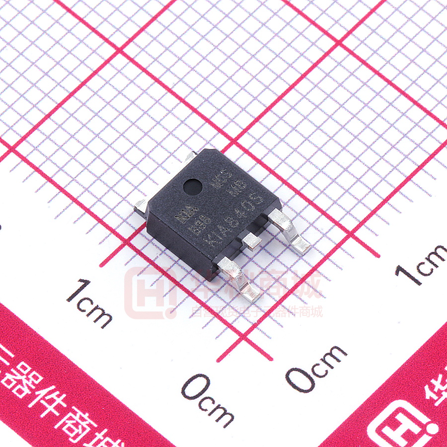

    8A,500V KIA N-沟道 MOSFET TO252-3
KIA840SD 数据手册
KIA 8A,500V N-CHANNEL MOSFET 840S SEMICONDUCTORS 1. Features n RDS(ON)=0.7Ω (typ) @VGS=10V n RoHS compliant n Low on resistance n Low gate charge n Peak current vs pulse width curve 2. Applications n Adaptor n TV main power n SMPS power supply n LCD panel power 3.Symbol 1 of 6 Pin Function 1 Gate 2 Drain 3 Source 4 Drain Rev 1.2 JAN 2016 KIA 8A,500V N-CHANNEL MOSFET 840S SEMICONDUCTORS 4. Absolute maximum ratings (TC=25°C,unless otherwise specified) Units Rating Parameter Symbol Drain-source voltage Continuous drain current Continuous drain current TC=100 ºC Pulsed drain current Power dissipation Derating factor above 25℃ Gate-source voltage Single pulse avalanche energy Avalanche energy, repetitive Avalanche current Peak diode recovery dv/dt Gate-source ESD(HBM-C=100pF,R=1.5KΩ) VDSS ID IDMa1 PD VGS EASa2 EARa1 IAR a1 dv/dt a3 VESD(G-S) Operating junction and storage temperature range Maximum temperature for soldering TO-220 TO-252, TO-263 500 8.0 5.5 28 160 100 1.28 0.8 +20 400 30 7.0 5.5 4000 V A A A W W/ ºC V mJ mJ A V/ns V TJ ,TSTG 150,-55 to150 ºC TL 300 ºC *Drain current limited by maximum junction temperature Caution:Stresses greater than those listed in the”Absolute maximum ratings”table may cause permanent Damage to the device 5. Thermal characteristics Parameter Symbol Rating Unit Junction-case RθJC 1.04 ºC/W Junction-ambient RθJA 100 ºC/W Test condition Drain lead soldered to water cooled heatsink,PD adjusted for a peak junction temperature of +150 ºC 1 cubic foot chamber,free air 2 of 6 Rev 1.2 JAN 2016 KIA 8A,500V N-CHANNEL MOSFET 840S SEMICONDUCTORS 6. Electrical characteristics Parameter Drain-source breakdown voltage Bvdss temperature coefficient Symbol BVDSS △BVDSS/△TJ (TC=25°C,unless otherwise specified) Test Conditions Min Typ Max Units VGS=0V,ID=250μA 500 V Reference 25℃ ID=250uA - 0.74 - - - 25 V/ºC Gate source breakdown voltage VGSO Gate-source forward leakage IGSS(F) VDS=500V, VGS=0V TA=25°C VDS=400V, VGS=0V TA=125°C IGS=+1mA (open drain) VGS=20V Gate-source reverse leakage IGSS(R) VGS=-20V - - -10 Drain-source on-resistance RDS(on) VGS=10V,ID=4A - 0.7 0.9 Ω Gate threshold voltage VGS(TH) VDS= VGS, ID=250uA 2 3 4 V Forward transconductance Input capacitance Output capacitance Reverse transfer capacitance Turn-on delay time Rise time Turn-off delay time Fall time Total gate charge Gate-source charge Gate-drain charge Continuous source current(body biode) gfs Ciss Coss Crss td(on) tr td(off) tf Qg Qgs Qgd IS VDS=15V, ID=3A - 8.5 960 110 10 11 17 46 22 24 4.0 10 - 8 S Maximum pulsed current(body biode) Diode forward voltage Reverse recovery time Reverse recovery charge Reverse recovery current Pulse width tp
