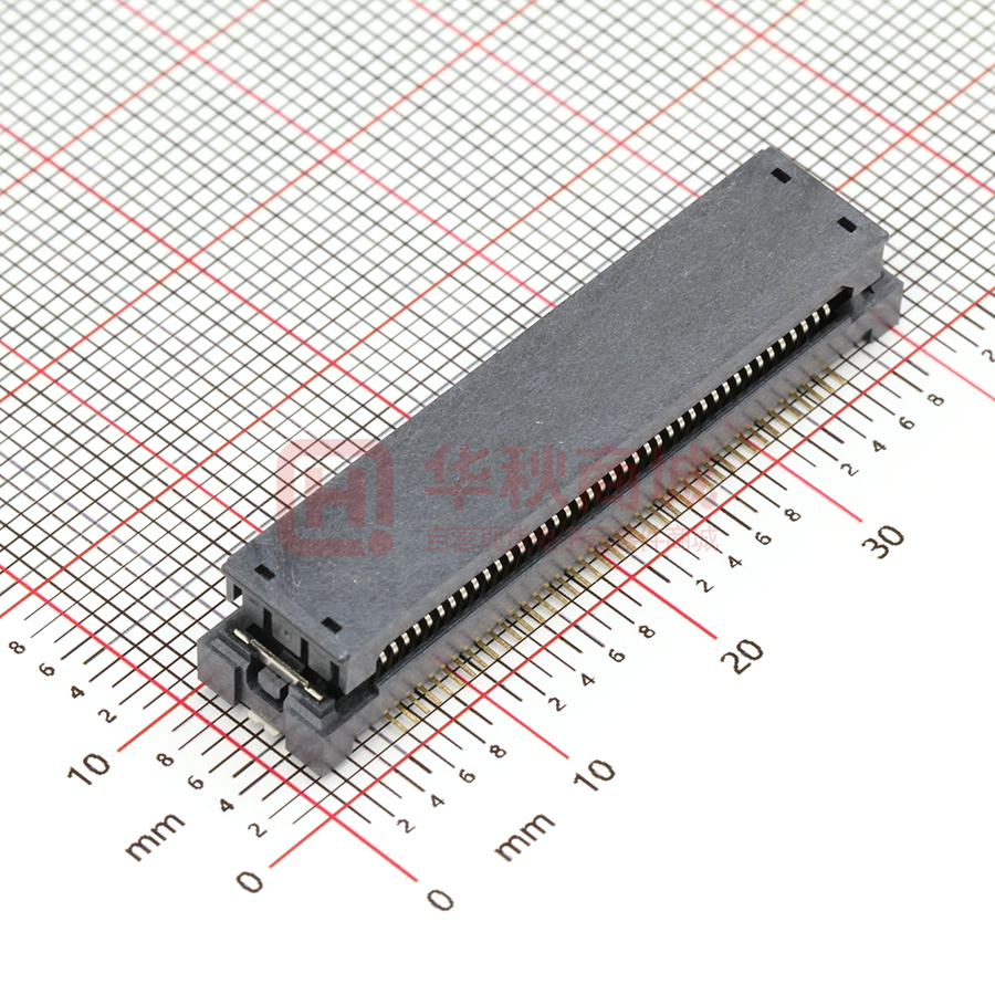

    板对板连接器 立贴 针脚数:80Pin 间距:0.8mm 排数:2
BB42-80AT-1B-CHR 数据手册
1 2 3 4 5 100PIN: BB42-AOAT-1B-XHR ECN Number 1 CS18030011 2 E20010009 3 E20100007 LGJ_2018.03.05 Smark Add new specifications A FQH_2020.10.13 图面整合(每个料号单独列出) NOTES: 1. HOUSING MATERIAL:HIGH TEMPERATURE PLASTICS BLACK,UL94V-0. 2. CONTACT MATERIAL:COPPER ALLOY. 3. RATING VOLTAGE: 50V AC/DC 4. CONTACT RESISTANCE: 80 m ohms MAX, INITIAL. 5. DIELECTRIC WITHSTANDING VOLTAGE: 500V AC rms./MINUTE. 6. INSULATION RESISTANCE: 100 M ohms MIN. 7. CURRENT RATING: 0.5 AMPERE. 8. DURABILITY: 30 CYCLES MIN. 9. INSERTION FORCE: 150g MAX. PER CONTACT. 10. WITHDRAW FORCE: 8.5g MIN. PER CONTACT. 11. OPERATING TEMPERATURE RANGE: -40°C~+105°C 12. STORAGE TEMPERATURE RANGE: -40°C~+105°C 13.All HARMFUL SUNSTANCES SHOULD BE COMPLIANT WITH THE ROHS2.0 REQUIREMENTS. 14. PRODUCT NUMBER MATRIX: 0.80 10.00 0.25 8.50 Drawn First issue 39.20 B 7.10 2.88 A 8 Description 49.00 A 7 6 REV. 1.15 B 7.75 0.10 A SECTION A-A SMT TYPE View with cap Gold plated flash B 3u" C 10u" E 15u" F 20u" G 25u" H 30u" J 6.40 D 0 0.50 0.80 E 2.30 0.8 2-∅ R D 3.00 6.30 11.00 3.15 3.15 1u" 5u" Colour :black Extended code 2.00 46.00 D packaging:REEL+PAD C Halogen-free high temperature material Electroplating code (11.00) 7.05 C 0.12 BB42-XXAT-1B-XHR Pitch:0.80mm Female PIN NO. Height flow code 3.30 E 39.20 46.00 RECOMMENDED PCB LAYOUT TOLERANCE:±0.05mm TOLERANCE UNLESS OTHERWISE SPECIFIED F ShenZhen ShenTai weixiang Electronics Co., Ltd. 1 X.X X.XX X.XXX ±0.30 ±0.20 2 X.° X.X° X.XX° ±3° ±2° ±1° 3 SCALE UNIT ORIGINAL DRAWN: Qinghua Fu CHECK: Guangyu Guo APPROVE: Ady Zhou 1:1 mm SIZE A4 4 DATE 2020.10.13 DATE 2020.10.13 DATE 2020.10.13 5 DWG.NO. REV. TITLE 600-0000-0228 3 CUSTOMER DRAWING PARTS NO.(INTENDED USE) SHEET 1/2 BB42-XXAT-1B-XHR 6 7 8 F 1 2 3 4 40PIN: BB42-4OAT-1B-XHR 7 6 8 60PIN: BB42-6OAT-1B-XHR 80PIN: BB42-8OAT-1B-XHR 25.00 33.00 41.00 15.20 23.20 31.20 0.80 0.80 0.25 0.80 10.00 10.00 0.25 8.50 10.00 0.25 8.50 A 8.50 A 5 B B A 7.05 A 7.05 7.05 A A C A A 30.00 C 3.15 3.15 3.15 3.15 38.00 3.15 3.15 22.00 D D 3.30 23.20 3.30 30.00 38.00 RECOMMENDED PCB LAYOUT TOLERANCE:±0.05mm RECOMMENDED PCB LAYOUT TOLERANCE:±0.05mm RECOMMENDED PCB LAYOUT TOLERANCE:±0.05mm ShenZhen ShenTai weixiang Electronics Co., Ltd. X.X X.XX X.XXX ±0.30 ±0.20 2 X.° X.X° X.XX° ±3° ±2° ±1° 3 SCALE UNIT ORIGINAL DRAWN: Qinghua Fu CHECK: Guangyu Guo APPROVE: Ady Zhou 1:1 mm SIZE A4 4 DATE 2020.10.13 DATE 2020.10.13 DATE 2020.10.13 5 E 31.20 22.00 TOLERANCE UNLESS OTHERWISE SPECIFIED (11.00) 6.40 0.50 0.80 2-∅ 2.30 0.8 0 6.30 3.00 (11.00) 6.40 15.20 F 1 0.50 0.80 2-∅ 2.30 0.8 0 6.30 3.00 6.40 3.30 (11.00) 6.30 3.00 0.8 0 0.50 0.80 2-∅ E 2.00 2.00 2.30 2.00 DWG.NO. REV. TITLE 600-0000-0228 3 CUSTOMER DRAWING PARTS NO.(INTENDED USE) SHEET 2/2 BB42-XXAT-1B-XHR 6 7 8 F
