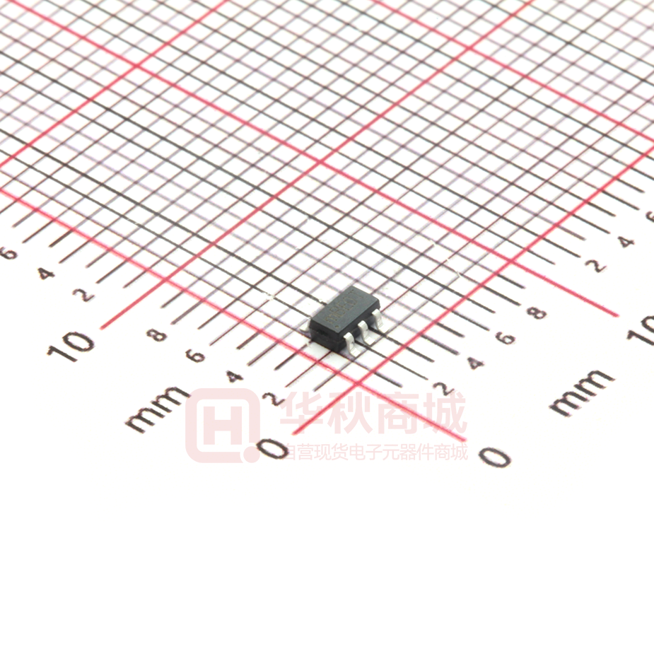

RY2334
30V High Side Over Voltage Protector
Features
30V standoff voltage
Fixed 6.0V protection voltage
Integrated OTP
Environment Temperature: -40℃~85℃
Maximum load Current 2A
Typical equivalent on-resistance 110mΩ
Input OVP with 0.1us reaction time
SOT-23-3, SOT23-6 package
Car Camera
Cellphone
Applications
All electronic devices with input DC power plug
E-Cigarette
General Description
RY2334 is a high voltage 30V over voltage protector (OVP) which has a low on resistance, by only change the
external connecting. It can be used as an OVP device or a high voltage switch. RY2334 consists of a charge pump,
a configurable power MOSFET, a voltage reference, a gate driver and some logics and protection modules. RY2334
can react to an input surge very fast and shut off the switch in less than 0.1us. RY2334 is available in SOT-23-3,
SOT23-6 package.
