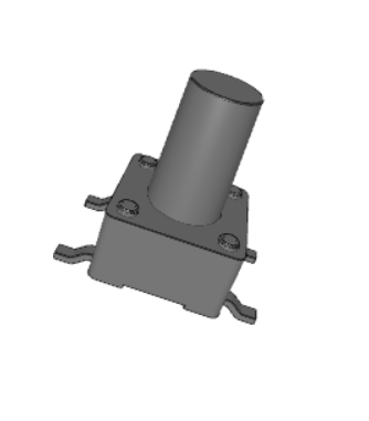

TS-1102SD-C-K-B
TS-1102SD-C-K-B
    XKB(中国星坤)
    SMD-4P,6x6mm
    轻触开关 6*6*9mm 立贴
TS-1102SD-C-K-B 数据手册
2 12.00[0.472] 4.00[0.157] 1.75[0.070] 1 1.50 3 t 0.40[0.016] 7.50[0.295] 16.00[0.630] 4.50[0.178] 4-0.70[0.028] 2.00[0.080] 5.20[0.205] 4 21.00[0.827] Code-x H Code-x H A 4.3 O 11.0 B 4.5 P 11.5 C 5.0 Q 12 D 5.5 R 12.5 E 6.0 S 13.0 F 6.5 T 13.5 G 7.0 U 14.0 H 7.5 V 15.0 I 8.0 W 15.5 X 16 J 8.5 K 9.0 Y 16.5 L 9.5 Z 17 M 10.0 18 18 N 10.5 19 19 H 3.30[0.130] t 0.30[0.012] 17.00[0.669] 9.20[0.362] SPECIFICATION Contact Rating Contact Resistance Insulation Resistance Dielectric Strength Travel Operating Temp Storage Temp 330.00[12.992] 50mA,12V DC 250V AC/1minute 0.25mm -20 ~+70 -40 ~+85 PACKING REEL TYPE PAPT NO CIRCUIT DIAGRAM P.C.B MOUNTING HOLES TS-1102SD-X-X-X Operating Force A:100gf B:160gf C:260gf Code-x Height B:Black BR:Brown R:Red O:Orange Y:Yellow BL:Blue W:White 3 2 4 5.90[0.232] 1 3.10[0.122] Color 5 4 3 2 1 ITEM 6.80[0.268] 12.00[0.472] units: mm tolerance: X X Terminal Contact Base Cover Keystake 4 1 1 1 1 PAPT NAMF TER NO QTY Brass 0.30t F.ag/Sus Pa46 Bass DATE DESCRIPTION REVISIONS www.xk-dg.cn www.helloxkb.com REVISED APPROVED UNSPECIFIED TOLERANCES www.helloxkb.cn Natural Plating Nickel Pa46 MATERIAL FINISHING DSND DATE SCALE: N/A MODEL TYPE: DWN DATE VIEW: CHKD DATE UNIT: mm/in APPD DATE SIZE: A4 REMARK TACT SWITCH PART NO.: DWG NO.: X MARK Plating silvering XKB INDUSTRIAL PRECISION CO.,LIMITED TS-1102SD-X-X-X WEIGHT 1.0g SHEET 1/1 REVISION A0
TS-1102SD-C-K-B
1. 物料型号:TS-1102SD-X-X-X 2. 器件简介:文档中没有提供详细的器件简介,但提到了“MODEL TYPE TACT SWITCH”,表明这可能是一个触摸开关模型。 3. 引脚分配:文档中没有明确提供引脚分配的详细信息。 4. 参数特性: - Operating Force(操作力):A: 100gf, B: 160gf, C: 260gf - Height(高度):根据Code-x有不同的值 - Calor(颜色):B: Black, BR: Brown, R: Red, O: Orange, Y: Yellow, BL: Blue, W: White - Travel(行程):0.25mm - Operating Temp(工作温度):-20~+70 - Storage Temp(存储温度):-40~+85 5. 功能详解:文档中没有提供详细的功能详解。 6. 应用信息:文档中没有提供应用信息。 7. 封装信息: - Terminal(端子):Brass (0.30t),Plating silvering - Contact(接触点):F.ag/Sus,Natural - Base(基座):Pa46 - Cover(盖子):Bass,Plating Nickel - Keystake(键脚):Pa46
