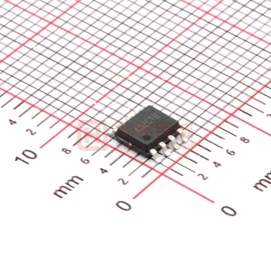

SY50282FAC
SY50282FAC
    SILERGY(矽力杰)
    SOIC-8
