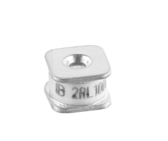

    GDT_6.2X4.2MM_SM
    陶瓷气体放电管,直流击穿电压:470V 精度:±20% 脉冲放电电流:5kA
2RL470M-6 数据手册
2R-6 SERIES Gas Discharge Tube (GDT) Data Sheet Features ■ Provide ultra-fast response to surge voltage from slow-rising ■ ■ ■ ■ surge of 100V/s to rapid-rising surge of 1KV/μs Stable breakdown voltage High insulation resistance Low capacitance (≤1pF) High holdover voltage ■ ■ ■ ■ ■ ■ Large absorbing transient current capability Micro-Gap Design Size: 6.2mm*4.2mm Storage and operating temperature: -40℃ ~ +85℃ Meets MSL level 1, per J-STD-020 Safety certification: E244458 & E327997 Applications ■ ■ ■ ■ Repeaters, Modems Telephone Interface, Line cards Data communication equipment Line test equipment Part Number Code 2 M R Electrical Characteristics K: 3KA L: 5KA Electrode Numbers 2R: 2 Electrodes 6 Lead Type M: SMD DC Spark-over Voltage Dimensions 6: 6.2mm×4.2mm Marking : BrightKing Logo 2RL090-6 : Device Marking Code YXXX : Date Code Revision: GDT-2R-6 SERIES-001(A2) 2/5 http://brightking.pulseelectronics.com 2R-6 SERIES Dimensions 3.5 D D d 1.3 T Dimension (mm) Symbol 7.0 B Recommended Pad Size Spec. Tolerance D 6.2 ±0.2 T 4.2 ±0.2 B 0.6 ±0.1 d 6.0 ±0.2 Electrical Characteristics DC Spark-over Voltage Maximum Impulse Spark-over Voltage Nominal Impulse Discharge Current Alternating Discharge Current Impulse Life 100V/s 1000V/μs 8/20μs 10times 50Hz,1sec 10/1000μs 100A Test Voltage (V) (V) (KA) (A) (times) DC(V) 2RL075M-6 75±20% 700 5 5 500 25 1 1.0 2RL075-6 2RL090M-6 90±20% 700 5 5 500 50 1 1.0 2RL090-6 2RL145M-6 145±20% 700 5 5 500 100 1 1.0 2RL145-6 2RL150M-6 150±20% 700 5 5 500 100 1 1.0 2RL150-6 2RL230M-6 230±20% 650 5 5 500 100 1 1.0 2RL230-6 2RL250M-6 250±20% 650 5 5 500 100 1 1.0 2RL250-6 2RL300M-6 300±20% 700 5 5 500 100 1 1.0 2RL300-6 2RL350M-6 350±20% 750 5 5 500 100 1 1.0 2RL350-6 2RL400M-6 400±20% 800 5 5 500 100 1 1.0 2RL400-6 2RL470M-6 470±20% 900 5 5 500 250 1 1.0 2RL470-6 2RL600M-6 600±20% 1000 5 5 500 250 1 1.0 2RL600-6 2RL800M-6 800±20% 1200 5 5 500 250 1 1.0 2RL800-6 2RK1000M-6 1000±20% 1600 3 3 300 500 1 1.0 2RK1000-6 2RK1200M-6 1200±20% 1800 3 3 300 500 1 1.0 2RK1200-6 2RK1800M-6 1800±20% 2600 3 3 300 500 1 1.0 2RK1800-6 Part Number Minimum Insulation Resistance Maximum Capacitance (GΩ) 1MHz Device Marking Code (pF) Electrical Ratings Items DC Spark-over Voltage Maximum Impulse Spark-over Voltage Test Condition/Description Requirement The voltage is measured with voltage ramp dv/dt=100V/s. The maximum impulse spark-over voltage is measured with voltage ramp dv/dt=1000V/μs. Revision: GDT-2R-6 SERIES-001(A2) 3/5 To meet the specified value http://brightking.pulseelectronics.com 2R-6 SERIES Maximum 8/20μs surge current that can be applied between two electrodes, 5 positive and 5 negative surges, with 3 minutes interval time, without causing the DC spark-over voltage to change more than 25% from its initial value. Crest value 100 90 Current (%) Impulse Discharge Current 50 20µs 10 0 8µs Time Impulse Width Alternating Discharge Current Rated RMS value of AC current at 50Hz, 1 sec. for 10 times with interval time 3 min. DC spark-over voltage shall not change more than ±25% from its initial value.IR>108 ohms (-20%, +30% for 70~90V). Insulation Resistance The resistance of gas tube shall be measured between two electrodes. Capacitance The capacitance of gas tube shall be measured between two electrodes. Test frequency: 1MHz Recommended Soldering Conditions Reflow Soldering Critical Zone TL to TP tP TP Ramp-up TL tL Temperature TS max TS min Ramp-down tS Preheat 25 t 25℃ to Peak Time Revision: GDT-2R-6 SERIES-001(A2) 4/5 http://brightking.pulseelectronics.com 2R-6 SERIES Recommended Conditions Profile Feature Pb-Free Assembly Average ramp-up rate (TL to TP) 3℃/second max. Preheat -Temperature Min (TS min) -Temperature Max (TS max) -Time (min to max) (ts) 150℃ 200℃ 60-180 seconds TS max to TL -Ramp-up Rate 3℃/second max. Time maintained above: -Temperature (TL) -Time (tL) 217℃ 60-150 seconds Peak Temperature (TP) 260℃ Time within 5℃ of actual Peak Temperature (tP) Ramp-down Rate 20-40 seconds 6℃/second max. Time 25℃ to Peak Temperature 8 minutes max. Packaging Tape Symbol Reel t D d Spec. Tolerance W 16.00 ±0.20 P0 4.00 ±0.10 P1 12.00 ±0.20 P2 2.00 ±0.10 D0 1.55 ±0.05 E 1.75 ±0.10 F 7.50 ±0.10 A0 4.44 ±0.10 K0 6.37 ±0.10 B0 6.48 ±0.10 t0 0.50 ±0.10 D 330.00 ±2.00 d 13.00 ±0.50 L 20.00 ±2.00 t 2.00 ±0.20 Quantity: 800pcs L Revision: GDT-2R-6 SERIES-001(A2) Dimension (mm) 5/5 http://brightking.pulseelectronics.com
