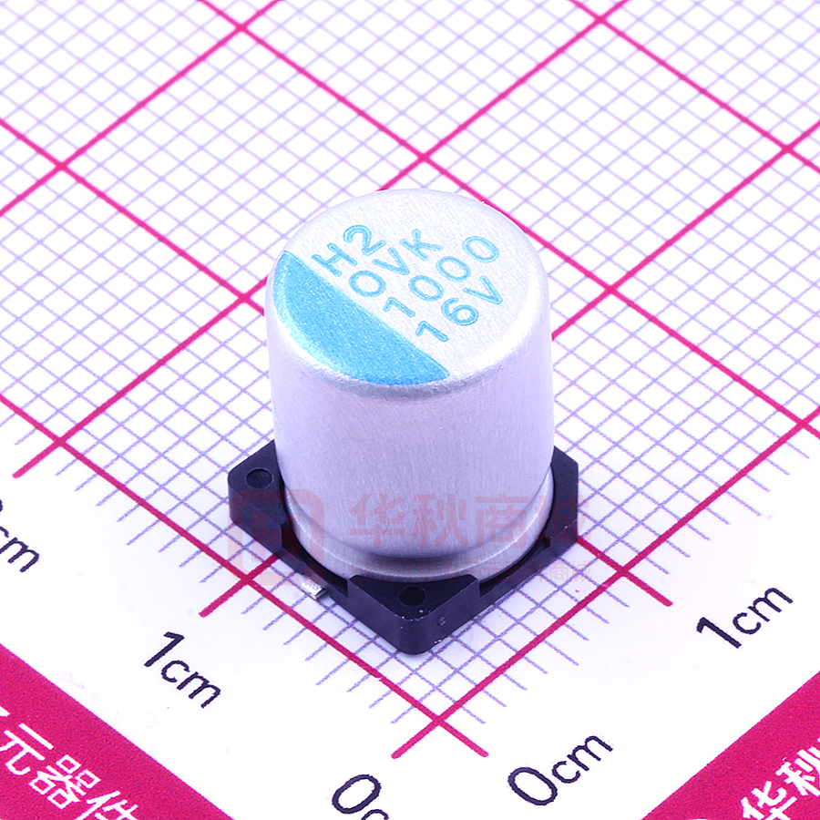

    贴片铝电解电容 AEC_D10X12.6MM_SM 1mF ±20% 16V Ф10.00 x 12.60mm 5000Hrs@105℃
OVK102M1CTR-1013 数据手册
Organic Conductive Polymer Capacitors OVK OVK Series Features ‧105℃, 5,000 hours assured ‧Ultra low ESR, solid capacitors of SMD type ‧RoHS Compliance Marking color: Blue Specifications Items Category Temperature Range Capacitance Tolerance Leakage Current (at 20℃)* Tanδ (at 120 Hz, 20℃) ESR (at 100k ~ 300k Hz, 20℃) Performance -55℃ ~ +105℃ ±20% (at 120 Hz, 20℃) Rated voltage applied, after 2 minutes at 20℃. See Standard Ratings See Standard Ratings See Standard Ratings Test Time 5,000 Hrs Capacitance Change Within ±20% of initial value Tanδ Less than 150% of specified value ESR Less than 150% of specified value Leakage Current Within specified value * The above specifications shall be satisfied when the capacitors are restored to 20℃ after the rated voltage applied for 5,000 hours at 105℃. Endurance Moisture Resistance Test Time 1,000 Hrs Capacitance Change Within ±20% of initial value Tanδ Less than 150% of specified value ESR Less than 150% of specified value Leakage Current Within specified value * The above specifications shall be satisfied when the capacitors are restored to 20℃ after subjecting them at 60℃, 90 ~ 95% RH for 1,000 hours. Leakage current should be tested after voltage treatment*. Capacitance Change Tanδ ESR Leakage Current Resistance to Soldering Heat * (Please refer to page 26 for reflow soldering conditions) Frequency (Hz) Multiplier Ripple Current and Frequency Multipliers Within ±10% of initial value Within specified value Within specified value Within specified value 120 ≦ f < 1k 1k ≦ f < 10k 10k ≦ f < 100k 100k ≦ f < 500k 0.05 0.3 0.7 1.0 * For any doubt about measured values, measure the leakage current again after the following voltage treatment. Voltage treatment: DC rated voltage is applied to the capacitors for 2 hours at 105 ℃. Diagram of Dimensions B±0.2 φD±0.5 Lead Spacing and Diameter φD W A±0.2 0.3 max. L 0.5 max.(*) P C±0.2 Marking φD = 5 ~ 6.3 Negative polarity A2 10 16K φD = 8 ~ 10 Date code Rated cap. Rated voltage & Series code Negative polarity A2 OVK 470 6.3V L Unit: mm A B C W P ± 0.2 5 5.7 ± 0.3 5.3 5.3 5.9 0.5 ~ 0.8 1.5 6.3 4.4 ± 0.2 6.6 6.6 7.2 0.5 ~ 0.8 2.0 6.3 5.9 +0.1/-0.3 6.6 6.6 7.2 0.5 ~ 0.8 2.0 6.3 7.7 ± 0.3 6.6 6.6 7.2 0.5 ~ 0.8 2.0 6.3 9.5 ± 0.5 6.6 6.6 7.2 0.5 ~ 0.8 2.0 8 6.7 ± 0.3 8.3 8.3 9.0 0.7 ~ 1.1 3.1 8 12.0 ± 0.5 8.3 8.3 9.0 0.7 ~ 1.1 3.1 10 7.7 ± 0.3 10.3 10.3 11.0 0.7 ~ 1.3 4.7 10 9.9 +0.1/-0.3 10.3 10.3 11.0 0.7 ~ 1.3 4.7 10 12.6 +0.1/-0.4 10.3 (*): For 5 ~ 6.3φ is 0.4 max. 10.3 11.0 0.7 ~ 1.3 4.7 Date code Series name Rated cap. Rated voltage All product specifications in the catalog are subject to change without notice. (CAT. 2021E2) 39 Organic Conductive Polymer Capacitors Dimension: φD×L(mm) Ripple Current: mA/rms at 100k Hz, 105℃ Standard Ratings Rated Volt. (V) 2.5V (0E) Surge Voltage (V) 2.9 Capacitance (µF) 4.6 6.3 × 4.4 220 6.3 × 5.9 120 40 1,670 110 25 2,500 280 23 3,100 340 12 4,770 1,000 10 × 7.7 0.12 500 19 4,240 1,200 10 × 9.9 0.18 750 13 5,200 1,500 10 × 12.6 0.18 750 10 5,500 300 30 1,970 0.18 68 5 × 5.7 100 6.3 × 4.4 160 40 1,670 5 × 5.7 120 25 2,200 6.3 × 5.9 120 22 2,570 176 25 3,020 216 22 3,220 6.3 × 5.9 264 20 2,800 8 × 6.7 264 22 3,220 390 6.3 × 7.7 312 14 3,470 470 10 × 7.7 375 20 4,130 8 × 6.7 448 18 3,600 448 12 4,770 220 8 × 6.7 270 8 × 6.7 330 8 × 12 0.12 0.18 680 10 × 7.7 0.12 544 20 4,130 820 10 × 9.9 0.18 656 13 5,200 10 × 12.6 0.18 960 10 5,500 300 30 1,970 100 5 × 5.7 6.3 × 4.4 207 40 1,670 6.3 × 5.9 103 27 2,400 5 × 5.7 126 35 1,380 6.3 × 5.9 126 22 2,800 151 22 2,800 189 25 3,020 6.3 × 5.9 277 20 2,800 8 × 6.7 277 22 3,220 120 6.3 × 5.9 150 8 × 6.7 220 270 330 390 0.12 6.3 × 7.7 340 14 3,470 6.3 × 7.7 416 14 3,470 10 × 7.7 416 20 4,130 8 × 6.7 491 22 3,220 4,770 8 × 12 0.15 592 12 10 × 7.7 0.12 592 20 4,130 560 10 × 9.9 0.15 706 16 4,700 820 10 × 12.6 0.15 1,033 10 5,500 1,300 470 33 56 68 120 5 × 5.7 100 40 6.3 × 4.4 224 40 1,670 6.3 × 5.9 112 27 2,300 5 × 5.7 6.3 × 5.9 6.3 × 5.9 0.12 136 30 2,100 136 27 2,300 240 6.3 × 7.7 150 8 × 6.7 10 × 7.7 40 Rated R. C. (mA/rms at 100k Hz, 105℃) 8 × 6.7 82 12.0 ESR (mΩ/at 100k ~ 300k Hz, 20℃ max.) 8 × 12 47 10V (1A) 0.12 LC (µA) 560 1,200 7.2 Tanδ (120 Hz, 20℃) 680 560 6.3V (0J) Size φD×L(mm) 120 150 4V (0G) OVK 300 27 2,300 21 2,880 30 2,760 30 3,020 All product specifications in the catalog are subject to change without notice. (CAT. 2021E2) Organic Conductive Polymer Capacitors Dimension: φD×L(mm) Ripple Current: mA/rms at 100k Hz, 105℃ Standard Ratings Rated Volt. (V) Surge Voltage (V) Capacitance (µF) 270 10V (1A) 12.0 330 18.0 Size φD×L(mm) Tanδ (120 Hz, 20℃) LC (µA) ESR (mΩ/at 100k ~ 300k Hz, 20℃ max.) 8 × 6.7 0.12 540 22 3,200 0.15 660 14 4,420 660 24 3,770 940 18 4,400 10 × 7.7 10 × 9.9 560 10 × 12.6 22 5 × 5.7 33 0.12 1,120 12 5,300 100 45 1,100 6.3 × 4.4 211 40 1,670 5 × 5.7 125 35 2,000 68 6.3 × 5.9 218 30 2,200 82 6.3 × 7.7 262 24 2,700 8 × 6.7 28 2,800 6.3 × 5.9 30 2,200 100 125 6.3 × 7.7 0.12 320 10 × 7.7 384 28 576 29 3,430 270 6.3 × 9.5 864 11 5,000 1,056 5,300 12 2,624 5,400 3,200 5,400 15 6.3 × 4.4 120 45 2,000 22 6.3 × 4.4 88 35 2,000 22 6.3 × 5.9 88 48 1,300 47 8 × 6.7 188 45 1,.890 48 1,300 56 224 68 272 82 6.3 × 5.9 0.12 328 400 120 40.0 5,300 1,504 10 x 12.6 100 35V(1V) 2,800 8 × 6.7 1,000 29.0 2,670 10 × 7.7 820 25V(1E) 2,700 35 180 470 23.0 24 120 330 20V(1D) Rated R. C. (mA/rms at 100k Hz, 105℃) 8 × 12 470 39 16V (1C) OVK 480 270 8 × 12 1,080 21 4,000 390 8 x 12 1,560 14 4,950 470 10 × 12.6 1,880 20 4,300 10 8 × 6.7 47 6.3 × 5.9 150 8 × 12 270 10 × 12.6 18 6.3 × 5.9 82 8 × 12 150 10 × 12.6 0.10 0.12 0.12 125 60 1,500 235 49 1,300 750 28 2,200 1,350 27 2,700 126 64 900 574 29 2,200 1,050 28 2,600 Note: The surface temperature of aluminum case top must not exceed 105℃. A rise in temperature due to self-heating by ripple current should be factored in. Part Numbering System 470µF OVK 471 M 0J TR - 1008 Capacitance Capacitance Tolerance Rated Voltage Package Type Terminal Type Case size Series Name ±20% 6.3V Carrier Tape OVK Series 10φ×7.7L Pb-free and PET coating case Lead Wire and Coating Type Note: For more details, please refer to “Part Numbering System (SMD Type)” on page 15. All product specifications in the catalog are subject to change without notice. (CAT. 2021E2) 41 Mouser Electronics Authorized Distributor Click to View Pricing, Inventory, Delivery & Lifecycle Information: Lelon: OVK101M0JTR-0606 OVK101M1CTR-1008 OVK121M0JTR-0606 OVK121M1ATR-0606 OVK121M1CTR-0807 OVK151M0GTR-0606 OVK151M1ATR-0807 OVK151M1ATR-1008 OVK181M1CTR-1008 OVK221M0JTR-0807 OVK271M0GTR-0807 OVK271M1ATR-0807 OVK331M0GTR-0606 OVK331M0GTR-0807 OVK331M1ATR-1008 OVK390M1CTR-0606 OVK391M0JTR-0807 OVK471M0JTR-1008 OVK560M1ATR-0606 OVK561M0GTR-0807 OVK680M1ATR-0606 OVK680M1CTR-0606 OVK681M0GTR-1008 OVK820M1CTR-0807 OVK271M1CTR-0807 OVK470M1ETR-0606 OVK102M1CTR-1013 OVK471M1DTR-1013 OVK561M1CTR-0812 OVK331M0JTR-0608 OVK331M0JTR-0606 OVK101M1VTR-0810 OVK221M1CTR-0807 OVK101M1ETR-0807 OVK121M1DTR-0606 OVK271M1CTR-0610
