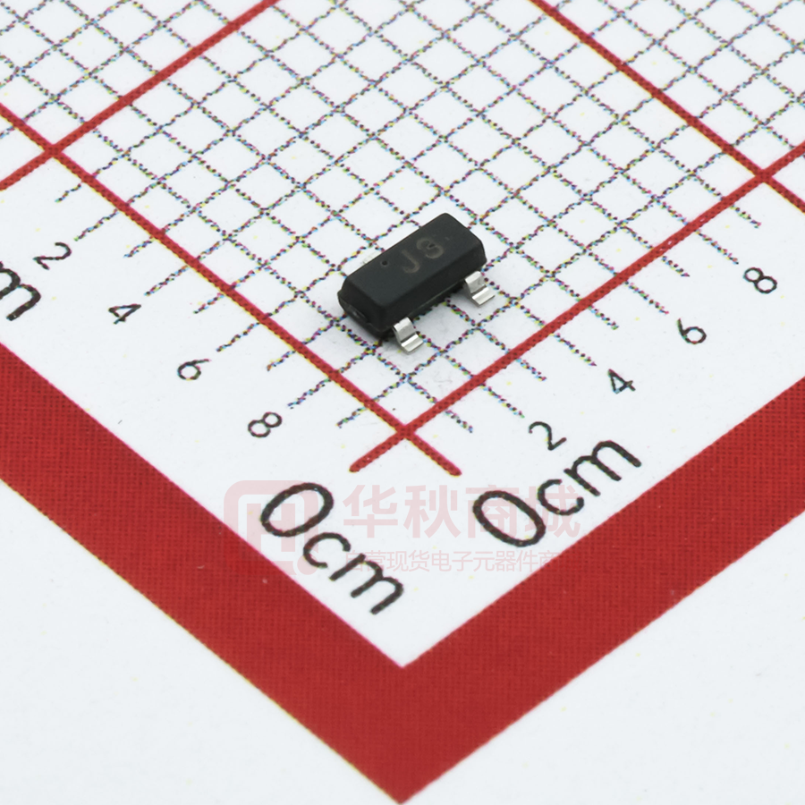

    SOT-23
    三极管 NPN Ic=500mA Vceo=25V hfe=120~400 P=300mW SOT23
S9013 数据手册
S9013 TRANSISTOR˄NPN˅ S9013 )($785(6 z +LJK&ROOHFWRU&XUUHQW  627 z&RPSOHPHQWDU\WR6 z([FHOOHQWK)(/LQHDULW\  1ˊBASE 2ˊEMITTER 3ˊCOLLECTOR 0$5.,1*- 0$;,0805$7,1*6 TA=25Я unless otherwise noted) Symbol Parameter Value Units VCBO Collector-Base Voltage 40 V VCEO Collector-Emitter Voltage 25 V VEBO Emitter-Base Voltage 5 V IC Collector Current -Continuous 500 mA PC Collector Power Dissipation 300 mW Tj Junction Temperature 150 Я Tstg Storage Temperature -55-150 Я (/(&75,&$/&+$5$&7(5,67,&6 7DPE Я XQOHVVRWKHUZLVHVSHFLILHG  Symbol 3DUDPHWHU Test conditions MIN TYP MAX UNIT &ROOHFWRUEDVHEUHDNGRZQYROWDJH V(BR)CBO IC= 100μA, IE=0 40 V &ROOHFWRUHPLWWHUEUHDNGRZQYROWDJH V(BR)CEO IC= 0.1mA, IB=0 25 V (PLWWHUEDVHEUHDNGRZQYROWDJH V(BR)EBO IE=100μA, IC=0 5 V &ROOHFWRUFXWRIIFXUUHQW ICBO VCB=40V, IE=0 0.1 μA &ROOHFWRUFXWRIIFXUUHQW ICEO VCE=20V, IB=0 0.1 μA (PLWWHUFXWRIIFXUUHQW IEBO VEB= 5V, IC=0 0.1 μA hFE(1) VCE=1V, IC= 50mA 120 hFE(2) VCE=1V, IC=500mA 40 '&FXUUHQWJDLQ 00 &ROOHFWRUHPLWWHUVDWXUDWLRQYROWDJH VCE(sat) IC=500mA, IB= 50mA 0.6 V %DVHHPLWWHUVDWXUDWLRQYROWDJH VBE(sat) IC=500mA, IB= 50mA 1.2 V fT 7UDQVLWLRQIUHTXHQF\ VCE=6V, IC= 20mA f=30MHz 150 MHz CLASSIFICATION OFK)(   RANK L H J RANGE    www.tw-gmc.com 1 S9013 7\SLFDO&KDUDFWHULVWLFV 6WDWLF&KDUDFWHULVWLF 80 hFE Ta=100ć 300uA 60 DC CURRENT GAIN COLLECTOR CURRENT COMMON EMITTER VCE=1V COMMON EMITTER Ta=25ć 350uA ,& K)(² ² 1000 400uA IC (mA) 100 250uA 200uA 40 150uA 100uA 20 Ta=25ć 100 IB=50uA 10 0 0 4 8 12 16 COLLECTOR-EMITTER VOLTAGE VCE 1 20 9&(VDW² ² ,& BASE-EMITTER SATURATION VOLTAGE VBEsat (V) 300 100 Ta=100ć Ta=25ć 500 100 IC (mA) ,& 9%(VDW²² 1.2 30 30 10 COLLECTOR CURRENT 500 COLLECTOR-EMITTER SATURATION VOLTAGE VCEsat (mV) 3 (V) Ta=25ć 0.8 Ta=100ć 0.4 ȕ=10 ȕ=10 10 0.0 1 10 3 500 100 30 COLLECTOR CURRENT IC 1 3 30 10 (mA) 100 COLLECTOR CURRENT ,&²² 9%( 100 &RE&LE² ² 100 IC 9&%9(% Cib 10 3 Ta=25ć 1 0.3 0.1 0.0 0.2 0.4 0.6 0.8 Cob 10 3 1 0.1 1.0 COLLECTOR POWER DISSIPATION PC (mW) (MHz) fT 300 100 10 V 20 (V) 3&² ²7D 400 VCE=6V Ta=25ć 10 3 REVERSE VOLTAGE I7² ² ,& 1000 1 0.3 BASE-EMMITER VOLTAGE VBE (V) TRANSITION FREQUENCY f=1MHz IE=0/ IC=0 Ta=25ć 30 Ta=100ć CAPACITANCE C (pF) COLLECTOR CURRENT IC (mA) COMMON EMITTER VCE=1V 30 500 (mA) 300 200 100 0 10 COLLECTOR CURRENT www.tw-gmc.com 100 30 IC 0 (mA) 25 50 75 AMBIENT TEMPERATURE 2 100 Ta 125 (ć ) 150 S9013 3$&.$*(287/,1( 3ODVWLFVXUIDFHPRXQWHGSDFNDJHOHDGV www.tw-gmc.com 627 3
S9013
- 物料型号:S9013 - 器件简介:S9013是一款NPN型晶体管,具有高集电极电流,与S9012互补,具有优秀的线性特性。 - 引脚分配:SOT-23封装,1号引脚为基极(B),2号引脚为发射极(E),3号引脚为集电极(C)。 - 参数特性: - 集电极-基极电压(VcBO):40V - 集电极-发射极电压(VCEO):25V - 发射极-基极电压(VEBO):5V - 集电极电流(Ic):500mA - 集电极功耗(Pc):300mW - 结温(Tj):150°C - 存储温度(Tstg):-55°C 至 150°C - 功能详解:文档提供了电气特性表,包括集电极-基极击穿电压、集电极-发射极击穿电压、发射极-基极击穿电压、集电极截止电流、发射极截止电流、直流电流增益(hFE)、集电极-发射极饱和电压(Vce(sat))、基极-发射极饱和电压(VBe(sat))和转换频率(fT)。 - 应用信息:文档中还包含了典型特性曲线图,如共发射极直流电流增益(hFE)与集电极电流(Ic)的关系,集电极-发射极饱和电压(VCEsat)与集电极电流(Ic)的关系等。 - 封装信息:SOT-23封装的详细尺寸信息。
