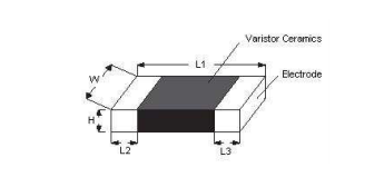

Package Dimensions
Varistor Ceramics
L1
W
Electrode
H
L2
EIA
L1
W
H
L2&L3
0603
1.60±0.15
0.80±0.15
1.0(Max)
0.35±0.15
L3
