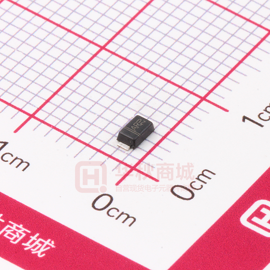

    TVS二极管 VRWM=8V VBR(Min)=8.89V VC=13.6V IPP=14.7A Ppp=200W SOD123FL
SMF8.0A 数据手册
SMF5.0A/CA THRU SMF220A/CA Surface mount transient voltage suppressor power 200 watts Stand-Off Voltage: 5.0V~220V PINNING PIN FEATURES • For surface mounted applications in order to DESCRIPTION 1 Cathode 2 Anode optimize board space. • Low profile package 1 2 • Glass passivated junction Unipolar • Low inductance • Plastic package has Underwriters Laboratory Flammability Bipolar Top View MECHANICAL DATA Simplified outline sSOD-123FL and symbol ▪ Case: SOD-123FL ▪ Terminals: Solderable per MIL-STD-750, Method 2026 ▪ Approx. Weight:15mg 0.00048oz Maximum Ratings and Electrical characteristics Ratings at 25 °C ambient temperature unless otherwise specified. Symbol Value Unit Peak Pulse Power Dissipation on TA=2 5°C (Note 1,2,5, Fig1) P PPM 200 W Peak Forward Surge Current (Note 3) I FSM 20 A Peak Pulse Current on 10/1000 us waveform (Note 1 ) Fig 2 I PPM see Table 1 A Steady State Power Dissipation (Note 4) P M(AV) 1 W Operating Junction and Storage Range T J,T STG -55 to +150 °C Parameter (UNI) RθJA Typical Thermal Resistance NOTES 1. Non-repetitive current pulse per Fig 3 and derated above T A=25°C per Fig 2 2. Mounted on 5mm 2 copper pads to each terminal 3. 8.3ms single half sinewave, or equivalent square wave duty cycle=4 pulses per minutes maximum 4. lead temperature at T L=75°C 5. Peak pulse powe. waveform is tp=10/1000us 6. A transient suppressor is selected according to the working peak reverse voltage(V RWM), Which Should be equal to or greater than the DC or continuous peak operating voltage level REV.08 1 of 4 180 °C Characteristics at Ta = 25°C Table 1 Test Current Breakdown Voltage Type Marking Reverse Leakage Max. Clamp Voltage Peak Pulse Current I R @ V RWM V C @ I PP I PP A V BR @ I T V RMW IT Min Max Bi Uni Bi V V V mA μA V SMF5.0A SMF5.0CA AE CAE 5 6.4 7 10 200 9.2 21.7 SMF6.0A SMF6.0CA AG CAG 6 6.67 7.37 10 100 10.3 19.4 SMF6.5A SMF6.5CA AK CAK 6.5 7.22 7.98 10 75 11.2 17.9 SMF7.0A SMF7.0CA AM CAM 7 7.78 8.6 10 50 12 16.7 SMF7.5A SMF7.5CA AP CAP 7.5 8.33 9.21 1 50 12.9 15.5 SMF8.0A SMF8.0CA AR CAR 8 8.89 9.83 1 25 13.6 14.7 13.9 Uni SMF8.5A SMF8.5CA AT CAT 8.5 9.44 10.4 1 10 14.4 SMF9.0A SMF9.0CA AV CAV 9 10 11.1 1 5 15.4 13 SMFl0A SMFl0CA AX CAX 10 11.1 12.3 1 2.5 17 11.8 S M F 11 A S M F 11 C A AZ CAZ 11 12.2 13.5 1 2.5 18.2 11 SMF12A SMF12CA BE CBE 12 13.3 14.7 1 2.5 19.9 10.1 SMF13A SMF13CA BG CBG 13 14.4 15.9 1 1 21.5 9.3 SMF14A SMF14CA BK CBK 14 15.6 17.2 1 1 23.2 8.6 SMF15A SMF15CA BM CBM 15 16.7 18.5 1 1 24.4 8.2 SMF16A SMF16CA BP CBP 16 17.8 19.7 1 1 26 7.7 SMF17A SMF17CA BR CBR 17 18.9 20.9 1 1 27.6 7.2 SMF18A SMF18CA BT CBT 18 20 22.1 1 1 29.2 6.8 SMF20A SMF20CA BV CBV 20 22.2 24.5 1 1 32.4 6.2 SMF22CA BX CBX 22 24.4 26.9 1 1 35.5 5.6 CBZ 24 26.7 29.5 1 1 38.9 5.1 SMF22A SMF24A SMF24CA BZ SMF26A SMF26CA CE CCE 26 28.9 31.9 1 1 42.1 4.8 SMF28A SMF28CA CG CCG 28 31.1 34.4 1 1 45.4 4.4 SMF30A SMF30CA CK CCK 30 33.3 36.8 1 1 48.4 4.1 SMF33A SMF33CA CM CCM 33 36.7 40.6 1 1 53.3 3.8 SMF36A SMF36CA CP CCP 36 40 44.2 1 1 58.1 3.4 SMF40A SMF40CA CR CCR 40 44.4 49.1 1 1 64.5 3.1 SMF43A SMF43CA CT CCT 43 47.8 52.8 1 1 69.4 2.9 SMF45A SMF45CA CV CCV 45 50 55.3 1 1 72.7 2.8 SMF48A SMF48CA CX CCX 48 53.3 58.9 1 1 77.4 2.6 SMF51A SMF51CA CZ CCZ 51 56.7 62.7 1 1 82.4 2.4 SMF54A SMF54CA DE CDE 54 60 66.3 1 1 87.1 2.3 SMF58A SMF58CA DG CDG 58 64.4 71.2 1 1 93.6 2.1 SMF60A SMF60CA DK CDK 60 66.7 73.7 1 1 96.8 1.8 SMF64A SMF64CA DM CDM 64 71.1 78.6 1 1 103 1.7 SMF70A SMF70CA DP CDP 70 77.8 86 1 1 113 1.5 CDR 75 83.3 92.1 1 1 121 1.4 SMF75A SMF75CA DR SMF78A SMF78CA DT CDT 78 86.7 95.8 1 1 126 1.4 SMF85A SMF85CA DV CDV 85 94.4 104 1 1 137 1.3 SMF90A SMF90CA DX CDX 90 100 111 1 1 146 1.2 SMFl00A SMFl00CA DZ CDZ 100 111 123 1 1 162 1.1 SMF110A SMF110CA EE CEE 110 122 135 1 1 177 1 SMF120A SMF120CA EG CEG 120 133 147 1 1 193 0.9 SMF130A SMF130CA EK CEK 130 144 159 1 1 209 0.8 SMF150A SMF150CA EM CEM 150 167 185 1 1 243 0.7 SMF160A SMF160CA EP CEP 160 178 197 1 1 259 0.7 SMF170A SMF170CA ER CER 170 189 209 1 1 275 0.6 SMF180A SMF180CA ET CET 180 201 222 1 1 292 0.5 SMF200A SMF200CA EX CEX 200 224 247 1 1 324 0.5 SMF220A SMF220CA E22 CE22 220 246 272 1 1 356 0.5 REV.08 2 of 4 SMF5.0A/CA THRU SMF220A/CA Fig.2 Forward Current Derating Curve PEAK PULSE POWER(PPP)OR CURRENT(Ipp) DERATINGIN PERCENTAGE% P PPM ,PEAK PULSE FORWARD ,kW Fig.1 Peak Pulse Power Rating Curve 100 Non-Repetive Pulse.Wavefom Shown in Figure.3 T A=25°C 10 1.0 0.1 0.1 10 1 100 1000 10000 100 80 60 40 20 0 25 I ppm ,Peak Pulse Current (%) I FSM ,PEAK FORWARD SURGE CURRENT, AMPERES T A =25°C 100 Peak Value Pulse Width (td) is Defined as the Point where the Peak. Current Decayst to 50% of Ipp I ppm 80 Half Value-I pp /2 60 10/1000usec Waveform as Defined bye R.E.A. 40 20 0 0 1.0 2.0 3.0 4.0 T,TIME,ms REV.08 100 125 150 175 Fig.4 Maximum Non-Repetitive Peak Forward Surge Current Fig.3 Pulse Waveform t f =10usec 75 T A ,AMBIENT TEMPERATURE,°C td,PULSE WIDTH ,us 120 50 30 25 20 15 10 05 T J =T J max 8.3ms Single Half Sinepwave JEDEC Method 0 1 10 Number of Cycles at 60Hz 3 of 4 100 SMF5.0A/CA THRU SMF220A/CA PACKAGE OUTLINE Plastic surface mounted package; 2 leads SOD-123FL ∠ALL ROUND C A ∠ALL ROUND VM D E A g g pad e E A pad HE Top View A C D E e g HE max 1.1 0.20 2.9 1.9 1.1 0.9 3.8 min 0.9 0.12 2.6 1.7 0.8 0.7 3.5 max 43 7.9 114 75 43 35 150 min 35 4.7 102 67 31 28 138 UNIT mm mil Bottom View 7° The recommended mounting pad size 2.0 (79) 1.2 (47) 1.2 (47) 1.2 (47) Unit: mm (mil) REV.08 ∠ 4 of 4
