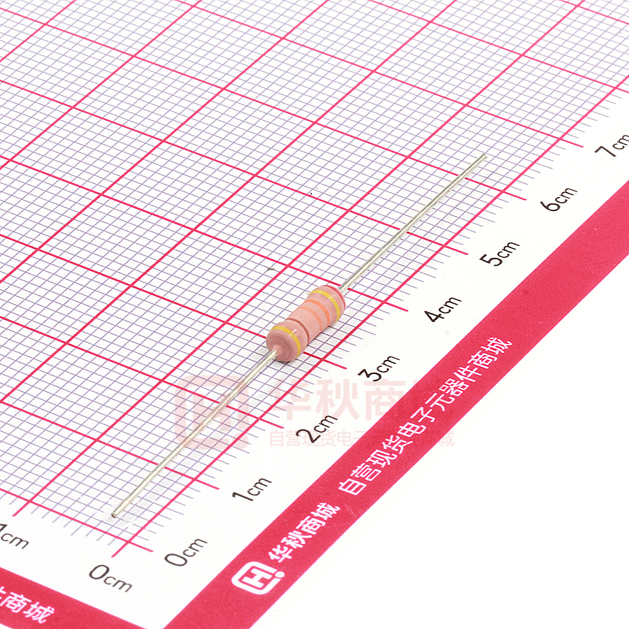

    插件电阻 AXIAL_D3.3X9MM_TM 243KΩ ±1% 1/2W ±200ppm/℃
HHV-50FT-52-243K 数据手册
無法顯示連結的圖像。檔案可能已移動、重新命名或刪除。請驗證連結指向正確的檔案及位置。 DATA SHEET METAL GLAZED FILM RESISTORS High Voltage, High Ohmic HHV Series ±1%, ±5% 1/4W to 3W Product specification – August 13, 2021 V.0 RoHS compliant & Halogen Free Through Hole Resistors Metal Glazed Film Product Specification ORDERING INFORMATION Part number of the high voltage, high ohmic metal glaze film resistor are identified by the series, power rating, tolerance, packing, temperature coefficient, forming and resistance value and suffix. PART NUMBER HHV 2WS (1) APPLICATIONS  Power applications (2) J T - 73- 100K Y (3) (4) (5) (6) (7) (8) (1) SERIES NAME HHV Series  Home appliance  Industry (2) POWER RATING FEATURES -25 = 1/4W 1WS = 1W 50S = 1/2W 2SS = 2W -50 = 1/2W 2WS = 2W 1SS = 1W 3SS = 3W  Metal glazed thick film  Max. resistance up to 68Mohm  Max. working voltage: 7KV  Max. overload capability: 14KV  Resistance to high temperature/humidity (3) TOLERANCE F = ±1% J = ±5% (4) PACKAGING TYPE R = Reel Pack B = Bulk T = Box Pack  UL1676, VDE certified  PPAP ready (HHV1WS)  Flameproof coating equivalent to UL-94V-0  RoHS compliant & halogen-free (5) TEMPERATURE COEFFICIENT OF RESISTANCE - = Based on spec. (6) FORMING 26- = 26mm FK = FK Type 52- = 52.4mm FFK = F-form Kink 73- = 73mm FKK = FKK Type M = M-Type Forming PN = PANAsert MB = M-form W/flat AV = AVIsert F = F Type (7) RESISTANCE VALUE E24 & E96 Series Example: 100K = 100,000Ω, 1M = 1,000,000Ω , 10M = 10,000,000Ω (8) Suffix Y = Epoxy coating Null = Silicone coating www.yageo.com Aug. 13, 2021 V.0 2 16 HHV Through Hole Resistors Product Specification Metal Glazed Film HHV DIMENSIONS Unit: mm Normal Miniature L ψD H ψd HHV-25 HHV50S 6.3 ± 0.5 2.4 ± 0.2 28 ± 2.0 0.55 ± 0.05 HHV-50 HHV1SS 9.0 ± 0.5 3.3 ± 0.3 26 ± 2.0 0.55 ± 0.05 HHV1WS HHV2SS 11.5 ± 1.0 4.5 ± 0.5 35 ± 2.0 0.8 ± 0.05 HHV2WS HHV3SS 15.5 ± 1.0 5.0 ± 0.5 33 ± 2.0 0.8 ± 0.05 DERATING CURVE Rated Power (%) 100 80 60 40 20 20 40 70 100 155 Ambient Temperature (°C) ELECTRICAL CHARACTERISTICS CHARACTERISTICS HHV-25 HHV50S HHV-50 HHV1SS HHV1WS HHV2SS HHV2WS HHV3SS Power Rating at 70 °C 1/4W 1/2W 1/2W 1W 1W 2W 2W 3W Maximum Working Voltage(DC) 1,600V 1,600V 3,500V 3,500V 5,000V 5,000V 7,000V 7,000V Maximum Overload Voltage(DC) 3,000V 3,000V 7,000V 7,000V 10,000V 10,000V 14,000V 14,000V Voltage Proof on Insulation (Silicone Type) 300V 300V 500V 500V 600V 600V 600V 600V Voltage Proof on Insulation (Epoxy Type) 500V 500V 500V 500V 700V 700V 700V 700V Resistance Range 100KΩ ~ 68MΩ for E24 & E96 series value Operating Temp. Range - 55°C to +155°C Temperature Coefficient ±200ppm/°C Note: For resistance value out of above range is by request. www.yageo.com Aug. 13, 2021 V.0 3 16 Through Hole Resistors Metal Glazed Film Product Specification HHV TEST AND REQUIRMENTS TEST TEST METHOD Short Time Overload IEC 60115-1 4.13 PROCEDURE APPRAISE 2.5 times RCWV for 5 sec.(Not more than ±2.0%+0.05Ω maximum overload voltage) Voltage Proof on IEC 60115-1 4.7 Insulation In V-Block for 60 sec. test voltage as No Breakdown above table Temperature Coefficient IEC 60115-1 4.8 Between -55°C to +155°C By Type Insulation Resistance IEC 60115-1 4.6 In V-Block for 60 sec. >10,000MΩ Solderability IEC 60115-1 4.17 245±5°C for 3±0.5 Sec. 95% Min. coverage Solvent Resistance of IEC 60115-1 4.30 IPA for 5±0.5 Min. with ultrasonic No deterioration of Marking coatings and markings Robustness of IEC 60115-1 4.16 Terminations Periodic-pulse Overload Direct load for 10 Sec. in the direction of ≥2.5Kg(24.5N) the terminal leads IEC 60115-1 4.39 4 times RCWV(or Umax., whichever less) ±1.0%+0.05Ω 10,000 cycles (1 Sec. on, 25 Sec.off) Damp Heat Steady State IEC 60115-1 4.24 40±2°C,90-95% RH for 56 days, loaded ±5.0%+0.05Ω with 0.1 times RCWV(or Umax., whichever less) Endurance at 70°C IEC 60115-1 4.25 70±2°C at RCWV(or Umax., whichever ±5.0%+0.05Ω less) for 1,000 Hr.(1.5 Hr.on,0.5 Hr. off) Temperature Cycling IEC 60115-1 4.19 -55°C  Room Temp.  +155°C ±1.0%+0.05Ω  Room Temp.(5 cycles) Resistance to Soldering IEC 60115-1 4.18 Heat 260±3°C for 10±1 Sec., immersed to a ±1.0%+0.05Ω point 3±0.5mm from the body Accidental Overload Test IEC 60115-1 4.26 (Only for silicone lacquer 4 times RCWV(or Umax., whichever less) No evidence of flaming for 1 Min. or arcing type) Note:. RCWV (Rated Continuous Working Voltage ): The DC or AC (rms) continuous working voltage corresponding to the rated power is determined by the following formula: V=√(P X R) or max. working voltage whichever is less Where V=Continuous rated DC or AC (rms) working voltage (V) P=Rated power (W) R=Resistance value (Ω) www.yageo.com Aug. 13, 2021 V.0 4 16 Through Hole Resistors Metal Glazed Film Product Specification HHV PULSE DIAGRAMS HHV50S Series: In accordance with IEC 60065- 14.1a; 50 discharges from a 1 nF capacitor charged to Umax; 12 discharges/min HHV-25 Series: In accordance with IEC 60065- 14.1a; 50 discharges from a 1 nF capacitor charged to Umax; 12 discharges/min www.yageo.com Aug. 13, 2021 V.0 5 16 Through Hole Resistors Metal Glazed Film Product Specification HHV HHV-50 Series: In accordance with IEC 60065- 14.1a; 50 discharges from a 1 nF capacitor charged to Umax; 12 discharges/min HHV1WS Series: In accordance with IEC 60065- 14.1a; 50 discharges from a 1 nF capacitor charged to Umax; 12 discharges/min www.yageo.com Aug. 13, 2021 V.0 6 16 Through Hole Resistors Metal Glazed Film Product Specification HHV AXIAL / REEL TAPE SPECIFICATION Unit: mm Normal Miniature a HHV-25 HHV50S 6 ± 0.5 HHV-50 HHV1WS HHV2WS HHV1SS HHV2SS HHV3SS 6 ± 0.5 A B1-B2 (Max.) S (spacing) 52.4 ± 1.5 1.2 T (max. deviation of spacing) 5 26.0 ± 1.5 1 52.4 ± 1.5 1.2 73.0 ± 1.5 1.5 52.4 ± 1.5 1.2 73.0 ± 1.5 1.5 52.4 ± 1.5 1.2 6 ± 0.5 5 1 mm per 10 spacing, 0.5 mm per 5 spacing 5 6 ± 0.5 10 www.yageo.com Aug. 13, 2021 V.0 7 16 Through Hole Resistors Metal Glazed Film Product Specification HHV TAPE ON REEL PACKING TYPE Unit: mm/piece Normal Miniature Across Flange(A) B Quantity Per Reel HHV-25 HHV50S 40 49 5,000 HHV-25 HHV50S 66.5 75.5 5,000 HHV-50 HHV1SS 66.5 75.5 2,500 HHV1WS HHV2SS 87 96 2,000 HHV2WS HHV3SS 87 96 1,000 www.yageo.com Aug. 13, 2021 V.0 8 16 Through Hole Resistors Metal Glazed Film Product Specification HHV TAPE ON BOX PACKING TYPE DIMENSIONS Unit: mm/piece Normal Miniature A B C Quantity Per Box HHV-25 HHV50S 48 102 255 5,000 HHV-25 HHV50S 81 104 260 5,000 HHV-50 HHV1SS 73 45 258 1,000 HHV1WS HHV2SS 81 91 260 1,000 HHV1WS HHV2SS 103 78 260 1,000 HHV2WS HHV3SS 81 91 260 1,000 HHV2WS HHV3SS 103 94 260 1,000 BULK PACKING Normal Miniature Piece/Per Inner Box Bag/Per Inner Box Piece Per Bag HHV-25 HHV50S 10,000 10 1,000 HHV-50 HHV1SS 5,000 5 1,000 HHV1WS HHV2SS 2,000 4 500 HHV2WS HHV3SS 1,000 2 500 www.yageo.com Aug. 13, 2021 V.0 9 16 Through Hole Resistors Metal Glazed Film Product Specification 16 HHV FORMING M TYPE TYPE DIMENSIONS Unit: mm Normal Miniature L ψD ψd P H HHV-25 HHV50S 6.3 ± 0.5 2.4 ± 0.2 0.55 ± 0.05 10.0 ± 1 10.0 ± 1 HHV-50 HHV1SS 9.0 ± 0.5 3.3± 0.3 0.55 ± 0.05 12.5 ± 1 10.0 ± 1 HHV1WS HHV2SS 11.5 ± 1.0 4.5 ± 0.5 0.8 ± 0.05 15.0 ± 1 12.5 ± 1 HHV2WS HHV3SS 15.5 ± 1.0 5.0 ± 0.5 0.8 ± 0.05 20.0 ± 1 15.0 ± 1 MB TYPE TYPE DIMENSIONS Unit: mm Normal Miniature L ψD ψd P H1 H2 t HHV-25 HHV50S 6.3 ± 0.5 2.4± 0.2 0.55 ± 0.05 10.0 ± 1 6.0 ± 1 5.0 ± 1 1.2 ± 0.2 HHV-50 - 9.0 ± 0.5 3.3± 0.3 0.55 ± 0.05 12.5 ± 1 6.0 ± 1 5.0 ± 1 1.2 ± 0.2 - HHV1SS 9.0 ± 0.5 3.3± 0.3 0.8 ± 0.05 12.5 ± 1 6.0 ± 1 5.0 ± 1 1.4 ± 0.2 HHV1WS HHV2SS 11.5 ± 1.0 4.5 ± 0.5 0.8 ± 0.05 15.0 ± 1 6.0 ± 1 5.0 ± 1 1.4 ± 0.2 HHV2WS HHV3SS 15.5 ± 1.0 5.0 ± 0.5 0.8 ± 0.05 20.0 ± 1 10.0 ± 1 5.0 ± 1 1.4 ± 0.2 www.yageo.com Aug. 13, 2021 V.0 10 Through Hole Resistors Product Specification Metal Glazed Film 11 16 HHV MHA TYPE TYPE Normal HHV-50 DIMENSIONS Miniature HHV1SS Unit: mm L ψD ψd B H0 HI P P0 9.0±0.5 3.3±0.3 0.55±0.05 17.5Max 19.0±1.0 4.0±1.0 30.0±1.0 15.0±0.3 P1 P2 F W W0 W1 ΨD0 7.5±1.0 3.75±0.5 7.5±0.5 18.0±0.5 5.0Min 9.0±0.5 4.0±0.2 www.yageo.com Aug. 13, 2021 V.0 Through Hole Resistors Product Specification Metal Glazed Film 16 HHV MHB TYPE TYPE Normal DIMENSIONS Miniature L HHV2WS HHV3SS Unit: mm ψD ψd B 15.5±1.0 5.0±0.5 0.8±0.05 P P0 30.0±1.0 15.0±0.3 H H0 HI H2 H3 21.0Max. 30Max. 18.0±1.0 5.5(Ref.) 8.0±1.5 16Max. PI P2 F W W0 W1 ΨD0 7.5±1.0 3.75±0.8 7.5±0.5 18.0±0.5 5.0Min. 9.0±0.5 4.0±0.3 MHC TYPE TYPE Normal HHV2WS DIMENSIONS Miniature L HHV3SS Unit: mm ψD ψd B H HI P P0 15.5±1.0 5.0±0.5 0.8±0.05 21.0Max. 19.0±1.0 5.25±1.0 30.0±1.0 15.0±0.3 F W W0 W1 ΨD0 10.0±0.5 18.0±0.5 5.0Min. 9.0±0.5 4.0±0.2 www.yageo.com Aug. 13, 2021 V.0 12 Through Hole Resistors Metal Glazed Film F TYPE Product Specification 16 HHV FK TYPE TYPE FFK TYPE FKK TYPE DIMENSIONS Unit: mm H HI E Max. Max. 5±1 18.5 3.5 3.5±1 24 5±1 20 3.5 3.5±1 28 5± 1 25 3.5 3.5±1 Normal Miniature L ψD ψd P h HHV-50 HHV1SS 9.0±0.5 3.3±0.3 0.55±0.05 6±1 8±1 22 HHV1WS HHV2SS 11.5±1 4.5±0.5 0.8±0.05 6±1 8±1 HHV2WS HHV3SS 15.5±1 5.0±0.5 0.8±0.05 8±1 8±1 Max. hl PN TYPE (Taping Pack) AV TYPE (Taping Pack) TYPE DIMENSIONS Unit: mm TYPE e DIMENSIONS Unit: mm Normal Miniature H1 Max. H2 Max. H3 Max. Normal Miniature H1 Max. H2 Max. H3 Max. HHV-25 HHV50S 13 21.5 8.5 HHV-25 HHV50S 11.5 20 8.5 HHV-50 HHV1SS 17 25.5 8.5 HHV-50 HHV1SS 14.5 23 8.5 HHV1WS HHV2SS 19 27.5 8.5 HHV1WS HHV2SS 17.5 26 8.5 www.yageo.com Aug. 13, 2021 V.0 13 Through Hole Resistors Metal Glazed Film Product Specification 16 HHV MARKING 5-BAND-CODE ±5% COLOR BLACK BROWN RED ORANGE YELLOW GREEN BLUE VIOLET GREY WHITE GOLD SILVER 1st BAND 0 1 2 3 4 5 6 7 8 9 2nd BAND 0 1 2 3 4 5 6 7 8 9 3rd BAND 0 1 2 3 4 5 6 7 8 9 MULTIPLIER 1Ω 10Ω 100Ω 1KΩ 10KΩ 100KΩ 1MΩ 10MΩ TOLERANCE 0.1Ω 0.01Ω ±5 % (J) ±1 % (F) HHV Series ±1% 6-BAND-CODE www.yageo.com Aug. 13, 2021 V.0 14 Through Hole Resistors Metal Glazed Film Product Specification 16 HHV REVISION HISTORY REVISION DATE CHANGE NOTIFICATION DESCRIPTION Version 0 Aug.2, 2021 - - First issue of this specification “ Yageo reserves all the rights for revising the content of this datasheet without further notification, as long as the products itse lf are unchanged. Any product change will be announced by PCN.” www.yageo.com Aug. 13, 2021 V.0 15 Through Hole Resistors Metal Glazed Film Product Specification 16 HHV LEGAL DISCLAIMER Yageo, its distributors and agents (collectively, “Yageo”), hereby disclaims any and all liabilities for any errors, inaccuracies or incompleteness contained in any product related information, including but not limited to product specifications, datasheets, pictures and/or graphics. Yageo may make changes, modifications and/or improvements to product related information at any time and without notice. Yageo makes no representation, warranty, and/or guarantee about the fitness of its products for any particular purpose or the continuing production of any of its products. To the maximum extent permitted by law, Yageo disclaims (i) any and all liability arising out of the application or use of any Yageo product, (ii) any and all liability, including without limitation special, consequential or incidental damages, and (iii) any and all implied warranties, including warranties of fitness for a particular purpose, non-infringement and merchantability. Yageo statements regarding the suitability of products for certain types of applications are based on Yageo’s knowledge of typical operating conditions for such types of applications in a generic nature. Such statements are neither binding statements of Yageo nor intended to constitute any warranty concerning the suitability for a specific customer application or use. They are intended for use only by customers with requisite knowledge and experience for determining whether Yageo products are the correct products for their application or use. In addition, unpredicatable and isolated cases of product failure may still occur, therefore, customer application or use of Yageo products which requires higher degree of reliability or safety, shall employ additional protective safeguard measures to ensure that product failure would not result in personal injury or property damage. Yageo products are not designed for application or use in medical, life-saving, or life-sustaining devices or for any other application or use in which the failure of Yageo products could result in personal injury or death. Customers using or selling Yageo products not expressly indicated for above-mentioned purposes shall do so at their own risk and agree to fully indemnify Yageo and hold Yageo harmless. Information provided here is intended to indicate product specifications only. Yageo reserves all the rights for revising this content without further notification, as long as products are unchanged. Any product change will be announced by PCN. www.yageo.com Aug. 13, 2021 V.0 16
HHV-50FT-52-243K
物料型号:YAGEO品牌的金属釉膜固定电阻器,型号包括HHV系列,功率等级包括1/4W、1/2W、1W、2W、3W。
器件简介:这些电阻器适用于高电压、高阻值的应用,如电力应用、家用电器和工业领域。它们具有金属釉膜厚膜技术,最大电阻值可达68Mohm,最大工作电压7KV,最大过载能力14KV。
引脚分配:文档中没有提供具体的引脚分配图,但通常固定电阻器的引脚分配是两端引出。
参数特性:电阻器的公差为±1%和±5%,符合RoHS标准且无卤素,具有UL1676和VDE认证,有防火涂层,符合UL-94V-0标准。
功能详解:电阻器设计用于承受高电压和高阻值,同时保持较小的尺寸和高可靠性。它们还具有温度系数为+200ppm/°C,工作温度范围为-55°C至+155°C。
应用信息:适用于电力应用、家用电器和工业领域。
封装信息:提供了多种尺寸和形状的封装,包括正常和迷你尺寸,以及不同的成型类型,如M型、MB型、MHA型、MHB型、MHC型、F型、FK型、FFK型和FKK型。每种封装类型都有详细的尺寸信息。
