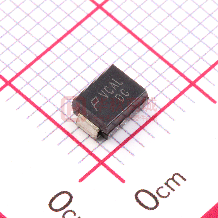

    TVS二极管 VRWM=58V VBR(Min)=64.4V VC=93.6V IPP=6.41A 双向 SMB
SMBJ58CA 数据手册
T VS Diode – SMBJ Series Features ⚫ ⚫ ⚫ ⚫ ⚫ ⚫ ⚫ ⚫ ⚫ Plastic package, excellent insulation strength. Glass passivated chip junction in SMB package. Excellent voltage clamping capability. Low Zener impedance. 600W peak pulse power capability on 10/1000s waveform. Typical leakage current less than 1A above 13V. Very fast response time, typically less than 1.0ps from 0 volt to VBR minimum. High temperature soldering guaranteed: 265°C/10 sec. MSL: JEDEC-J-STD-020, Level 1 Applications ⚫ ⚫ ⚫ ⚫ I/O interface, VCC bus Telecom Industrial and consumer electronic applications. Relay and electromagnetic valve surge absorption. Agency Approval ⚫ UL file no.: E474915 Mechanical and Physical Data ⚫ ⚫ Case: JEDEC SMB molded plastic. Surface mount device, solderable per MIL-STD-750, Method 2026 ⚫ Polarity: Color band denoted cathode except bidirectional. Maximum Ratings and Thermal Characteristics Parameter Symbol Value Unit PPPM Min 600 Watt Peak Pulse Current of 10/1000s waveform (Note 1, Fig.3). IPPM See Table Amp Steady State Power Dissipation at TL = 75°C, Lead lengths 0.375”, (9.5mm) (Fig.5). PM(AV) 5.0 Watt IFSM 100 Amp TJ, TSTG -55~150 °C Peak Pulse Power Dissipation on 10/1000s waveform (Note 1, Fig.1). Peak Forward Surge Current, 8.3 ms Single Half Sine Wave Superimposed on Rated Load (Note 2, Fig.6). Operating Junction and Storage Temperature Range. Note: 1. Non-repetitive current pulse, per Fig.3 and derated above TA = 25°C per Fig.2. 2. 8.3ms single half sine wave, or equivalent square wave, Duty cycle = 4 pulses per minutes maximum. Part Number Code SMBJ □□□ C A - □□□ Packaging Code (T13: Tape with 13” Reel; T7: Tape with 7”) VBR Voltage tolerance (A: 5%; Blank: 10%) C: Bi-directional; Blank: Uni-directional Reverse Stand-Off Voltage or Typical Breakdown Voltage SMBJ Series (600W) 新竹市科學工業園區工業東四路 24-1 號 No. 24-1 Industry E. Rd. IV, Hsinchu Science Park, Hsinchu 300, Taiwan. TEL: +886-3-5643931 FAX: +886-3-5644624 http://www.pttc.com.tw Page: 1 of 6 2019/04/25 Rev: D T VS Diode – SMBJ Series I-V Curve Characteristics PPPM Peak Pulse Power Dissipation – Maximum power dissipation VR Stand-off Voltage – Maximum voltage that can be applied to the TVS without operation VBR Breakdown Voltage – Maximum voltage that flows through the TVS at a specified test current (IT) VC Clamping Voltage – Peak voltage measured across the TVS at a specified IPPM (Peak Impulse Current) IR Reverse Leakage Current – Current measured at VR VF Forward Voltage Drop for Uni-directional Electrical Characteristics Uni Bi Uni Bi Reverse Stand Off Voltage VR (V) Min. Max. Test Current IT (mA) SMBJ5.0A SMBJ5.0CA KE AE 5.0 6.40 7.00 10 9.2 65.22 800 SMBJ6.0A SMBJ6.0CA KG AG 6.0 6.67 7.37 10 10.3 58.25 800 SMBJ6.5A SMBJ6.5CA KK AK 6.5 7.22 7.98 10 11.2 53.57 500 SMBJ7.0A SMBJ7.0CA KM AM 7.0 7.78 8.60 10 12.0 50.00 200 SMBJ7.5A SMBJ7.5CA KP AP 7.5 8.33 9.21 1 12.9 46.51 100 SMBJ8.0A SMBJ8.0CA KR AR 8.0 8.89 9.83 1 13.6 44.12 50 SMBJ8.5A SMBJ8.5CA KT AT 8.5 9.44 10.4 1 14.4 41.67 20 SMBJ9.0A SMBJ9.0CA KV AV 9.0 10.0 11.1 1 15.4 38.96 10 SMBJ10A SMBJ10CA KX AX 10.0 11.1 12.3 1 17.0 35.29 5 SMBJ11A SMBJ11CA KZ AZ 11.0 12.2 13.5 1 18.2 32.97 1 SMBJ12A SMBJ12CA LE BE 12.0 13.3 14.7 1 19.9 30.15 1 SMBJ13A SMBJ13CA LG BG 13.0 14.4 15.9 1 21.5 27.91 1 SMBJ14A SMBJ14CA LK BK 14.0 15.6 17.2 1 23.2 25.86 1 SMBJ15A SMBJ15CA LM BM 15.0 16.7 18.5 1 24.4 24.59 1 SMBJ16A SMBJ16CA LP BP 16.0 17.8 19.7 1 26.0 23.08 1 SMBJ17A SMBJ17CA LR BR 17.0 18.9 20.9 1 27.6 21.74 1 SMBJ18A SMBJ18CA LT BT 18.0 20.0 22.1 1 29.2 20.55 1 Part Number Marking Breakdown Voltage VBR (V) @ IT Maximum Clamping Voltage VC (V) @ IPP Maximum Peak Pulse Current IPP (A) Maximum Reverse Leakage IR (A) @ VR 新竹市科學工業園區工業東四路 24-1 號 No. 24-1 Industry E. Rd. IV, Hsinchu Science Park, Hsinchu 300, Taiwan. TEL: +886-3-5643931 FAX: +886-3-5644624 http://www.pttc.com.tw Page: 2 of 6 2019/04/25 Rev: D T VS Diode – SMBJ Series Uni Bi Uni Bi Reverse Stand Off Voltage VR (V) Max. Test Current IT (mA) SMBJ20A SMBJ20CA LV BV 20.0 22.2 24.5 1 32.4 18.52 1 SMBJ22A SMBJ22CA LX BX 22.0 24.4 26.9 1 35.5 16.90 1 SMBJ24A SMBJ24CA LZ BZ 24.0 26.7 29.5 1 38.9 15.42 1 SMBJ26A SMBJ26CA ME CE 26.0 28.9 31.9 1 42.1 14.25 1 SMBJ28A SMBJ28CA MG CG 28.0 31.1 34.4 1 45.4 13.22 1 SMBJ30A SMBJ30CA MK CK 30.0 33.3 36.8 1 48.4 12.40 1 SMBJ33A SMBJ33CA MM CM 33.0 36.7 40.6 1 53.3 11.26 1 SMBJ36A SMBJ36CA MP CP 36.0 40.0 44.2 1 58.1 10.33 1 SMBJ40A SMBJ40CA MR CR 40.0 44.4 49.1 1 64.5 9.30 1 SMBJ43A SMBJ43CA MT CT 43.0 47.8 52.8 1 69.4 8.65 1 SMBJ45A SMBJ45CA MV CV 45.0 50.0 55.3 1 72.7 8.25 1 SMBJ48A SMBJ48CA MX CX 48.0 53.3 58.9 1 77.4 7.75 1 SMBJ51A SMBJ51CA MZ CZ 51.0 56.7 62.7 1 82.4 7.28 1 SMBJ54A SMBJ54CA NE DE 54.0 60.0 66.3 1 87.1 6.89 1 SMBJ58A SMBJ58CA NG DG 58.0 64.4 71.2 1 93.6 6.41 1 SMBJ60A SMBJ60CA NK DK 60.0 66.7 73.7 1 96.8 6.20 1 SMBJ64A SMBJ64CA NM DM 64.0 71.1 78.6 1 103.0 5.83 1 SMBJ70A SMBJ70CA NP DP 70.0 77.8 86.0 1 113.0 5.31 1 SMBJ75A SMBJ75CA NR DR 75.0 83.3 92.1 1 121.0 4.96 1 SMBJ78A SMBJ78CA NT DT 78.0 86.7 95.8 1 126.0 4.76 1 SMBJ85A SMBJ85CA NV DV 85.0 94.4 104.0 1 137.0 4.38 1 SMBJ90A SMBJ90CA NX DX 90.0 100.0 111.0 1 146.0 4.11 1 SMBJ100A SMBJ100CA NZ DZ 100.0 111.0 123.0 1 162.0 3.70 1 SMBJ110A SMBJ110CA PE EE 110.0 122.0 135.0 1 177.0 3.39 1 SMBJ120A SMBJ120CA PG EG 120.0 133.0 147.0 1 193.0 3.11 1 SMBJ130A SMBJ130CA PK EK 130.0 144.0 159.0 1 209.0 2.87 1 SMBJ150A SMBJ150CA PM EM 150.0 167.0 185.0 1 243.0 2.47 1 SMBJ160A SMBJ160CA PP EP 160.0 178.0 197.0 1 259.0 2.32 1 SMBJ170A SMBJ170CA PR ER 170.0 189.0 209.0 1 275.0 2.18 1 SMBJ180A SMBJ180CA PT ET 180.0 201.0 222.0 1 292.0 2.06 1 SMBJ190A SMBJ190CA PA EC 190.0 209.0 243.0 1 308.0 1.95 1 SMBJ200A SMBJ200CA PV EV 200.0 224.0 247.0 1 324.0 1.85 1 SMBJ220A SMBJ220CA PX EX 220.0 246.0 272.0 1 356.0 1.69 1 SMBJ250A SMBJ250CA PZ EZ 250.0 279.0 309.0 1 405.0 1.48 1 SMBJ300A SMBJ300CA QE FE 300.0 335.0 371.0 1 486.0 1.23 1 SMBJ350A SMBJ350CA QG FG 350.0 391.0 432.0 1 567.0 1.06 1 SMBJ400A SMBJ400CA QK FK 400.0 447.0 494.0 1 648.0 0.93 1 SMBJ440A SMBJ440CA QM FM 440.0 492.0 543.0 1 713.0 0.84 1 Part Number Marking Breakdown Voltage VBR (V) @ IT Min. Maximum Clamping Voltage VC (V) @ IPP Maximum Peak Pulse Current IPP (A) Maximum Reverse Leakage IR (A) @ VR Note: 1. For bi-directional type having VR of 10 volts and less, the IR limit is double. 新竹市科學工業園區工業東四路 24-1 號 No. 24-1 Industry E. Rd. IV, Hsinchu Science Park, Hsinchu 300, Taiwan. TEL: +886-3-5643931 FAX: +886-3-5644624 http://www.pttc.com.tw Page: 3 of 6 2019/04/25 Rev: D T VS Diode – SMBJ Series Ratings and Characteristic Curves Fig 1 - Peak Pulse Power Rating Curve Fig 2 - Pulse Derating Curve Fig 3 - Pulse Waveform Fig 4 – Typical Junction Capacitance Fig 5 – Steady State Power Dissipation Derating Curve Fig 6 – Maximum Non-Repetitive Forward Surge Current (Uni-directional Only) 新竹市科學工業園區工業東四路 24-1 號 No. 24-1 Industry E. Rd. IV, Hsinchu Science Park, Hsinchu 300, Taiwan. TEL: +886-3-5643931 FAX: +886-3-5644624 http://www.pttc.com.tw Page: 4 of 6 2019/04/25 Rev: D T VS Diode – SMBJ Series Marking Definitions PolyTrans Trade mark Lot No Marking Code Cathode Band (For Uni-directional product only) Physical Dimensions Dimension A B C D E F G H I J K L Millimeters Inches Min Max Min Max 1.90 4.06 3.30 1.95 0.76 5.21 0.15 2.26 2.16 2.16 2.20 4.85 3.94 2.44 1.52 0.20 5.59 0.31 2.74 - 0.077 0.160 0.130 0.084 0.030 0.205 0.006 0.089 0.085 0.085 0.086 0.191 0.155 0.096 0.060 0.008 0.220 0.012 0.107 - Lead Free Reflow Soldering Recommendations Preheat - Temperature Min (Ts_min) - Temperature Max (Ts_max) - Time (Ts_min to Ts_max) - Average Ramp-Up Rate 150ºC 200ºC 60-180 seconds 1~3ºC/second Peak Temperature 260ºC max. Time within 5ºC of actual Peak Temperature (tp) 40 seconds max. Ramp-Down Rate 6 ºC /second max. Note: If the soldering temperatures exceed the recommended profile, devices may not meet the performance requirements. 新竹市科學工業園區工業東四路 24-1 號 No. 24-1 Industry E. Rd. IV, Hsinchu Science Park, Hsinchu 300, Taiwan. TEL: +886-3-5643931 FAX: +886-3-5644624 http://www.pttc.com.tw Page: 5 of 6 2019/04/25 Rev: D T VS Diode – SMBJ Series Packaging Information Part Number Packaging Code Component Package Quantity SMBJ Series SMBJ Series T13 T7 DO-214AA DO-214AA 3000 500 Packaging Option Tape & Reel – 12mm tape/13” reel Tape & Reel – 12mm tape/7” reel Packaging Specification EIA STD RS-481 EIA STD RS-481 Tape and Reel Specifications 0.315 (8.0) 新竹市科學工業園區工業東四路 24-1 號 No. 24-1 Industry E. Rd. IV, Hsinchu Science Park, Hsinchu 300, Taiwan. TEL: +886-3-5643931 FAX: +886-3-5644624 http://www.pttc.com.tw Page: 6 of 6 2019/04/25 Rev: D
