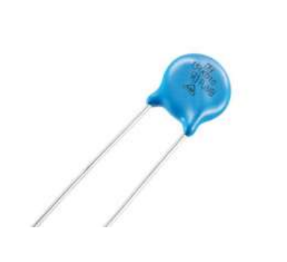

    压敏电阻 VAR_D10X4.45MM_TM 360V 2.5KA
361KD10-OTB 数据手册
10Φ SERIES Metal Oxide Varistors (MOV) Data Sheet Features ■ ■ ■ ■ ■ Wide operating voltage (V1mA) range from 18V to 1100V Fast responding to transient over-voltage Large absorbing transient energy capability Low clamping ratio and no follow-on current Meets MSL level 1, per J-STD-020 ■ Operating Temperature:-40℃ ~ +105℃ ■ Storage Temperature:-40℃ ~ +125℃ ■ Safety certification: UL: E327997 CSA: 246579 VDE: 40027827 Applications ■ ■ ■ ■ ■ Transistor, diode, IC, thyristor or triac semiconductor protection Surge protection in consumer electronics Surge protection in industrial electronics Surge protection in electronic home appliances, gas and petroleum appliances Relay and electromagnetic valve surge absorption Part Number Code Packing No suffix: Bulk TB: Tape & Box TR: Tape & Reel Tolerance K: ±10% Type D: Disk Varistor Voltage 180: 18V 101: 100V 102: 1000V Revision: MOV-10Φ SERIES-001(A4) Surge Series No suffix: Standard type J: High Surge type Lead Shape No suffix: Straight leads O: Outside crimped leads F: Y Kinked leads Element Diameter 05~53 2 / 13 http://brightking.pulseelectronics.com 10Φ SERIES Dimensions D D T H1 K≤3.0 F e d L1 d1 L1 L K≤3.0 d T H1 H D d F O Type F Type Table 1 Table 2 Unit: mm Unit: mm Symbol Dimension Model T e Model T e H 10.5~16.0 180K 2.0~4.6 1.5 301K 2.7~5.5 2.5 H1 13.0~17.5 220K 2.1~4.7 1.6 331K 2.7~5.8 2.5 L(min.) 20.0 270K 2.1~4.8 1.8 361K 2.9~6.0 2.7 L1(min.) 15.0 330K 2.2~5.0 1.7 391K 3.0~6.2 2.8 D 10.0~12.5 390K 2.1~5.3 1.8 431K 3.2~6.5 3.0 F(±0.8) 7.5 470K 2.2~5.4 1.9 471K 3.3~6.7 3.2 T Table 2 560K 2.3~5.5 2.1 511K 3.4~6.8 3.4 e(±0.8) Table 2 680K 2.4~5.6 2.4 561K 3.6~7.0 3.6 d(±0.05) 0.8 820K 2.1~4.7 1.8 621K 3.8~7.3 3.9 d1(±0.4) 1.4 101K 2.4~4.9 2.0 681K 4.0~7.6 4.2 121K 2.4~5.1 2.2 751K 4.3~8.0 4.3 151K 2.2~5.4 1.8 781K 4.4~8.1 4.4 181K 2.3~4.8 1.9 821K 4.6~8.3 4.6 201K 2.4~5.0 2.0 911K 4.8~8.8 5.0 221K 2.5~5.1 2.1 102K 5.4~9.3 5.0 241K 2.6~5.2 2.2 112K 5.8~9.9 5.4 271K 2.6~5.4 2.4 Revision: MOV-10Φ SERIES-001(A4) 3 / 13 http://brightking.pulseelectronics.com 10Φ SERIES Electrical Characteristics Part Number Maximum Allowable Voltage Varistor Voltage Maximum Clamping Voltage Withstanding Surge Current Maximum Energy (10/1000μs) Rated Power Typical Capacitance (Reference) Standard High Surge VAC(V) VDC(V) V1mA(V) IP(A) VC(V) I (A) Standard I (A) High Surge (J) Standard (J) High Surge (W) @1KHz (pf) 180KD10 180KD10J 11 14 18(15~21.6) 5 36 500 1000 2.1 3.0 0.05 5600 220KD10 220KD10J 14 18 22(19.5~26) 5 43 500 1000 2.5 5.0 0.05 4500 270KD10 270KD10J 17 22 27(25~31) 5 53 500 1000 3.0 6.0 0.05 3700 330KD10 330KD10J 20 26 33(29.5~36.5) 5 65 500 1000 4.0 7.0 0.05 3000 390KD10 390KD10J 25 31 39(35~43) 5 77 500 1000 4.6 9.0 0.05 2400 470KD10 470KD10J 30 38 47(42~52) 5 93 500 1000 5.5 11.0 0.05 2100 560KD10 560KD10J 35 45 56(50~62) 5 110 500 1000 7.0 13.0 0.05 1800 680KD10 680KD10J 40 56 68(61~75) 5 135 500 1000 8.2 15.0 0.05 1500 820KD10 820KD10J 50 65 82(74~90) 25 135 2500 3500 12.0 17.0 0.4 1200 101KD10 101KD10J 60 85 100(90~110) 25 165 2500 3500 15.0 18.0 0.4 1000 121KD10 121KD10J 75 100 120(108~132) 25 200 2500 3500 18.0 21.0 0.4 830 151KD10 151KD10J 95 125 150(135~165) 25 250 2500 3500 22.0 25.0 0.4 670 181KD10 181KD10J 115 150 180(162~198) 25 300 2500 3500 27.0 30.0 0.4 560 201KD10 201KD10J 130 170 200(180~220) 25 340 2500 3500 30.0 35.0 0.4 500 221KD10 221KD10J 140 180 220(198~242) 25 360 2500 3500 32.0 39.0 0.4 450 241KD10 241KD10J 150 200 240(216~264) 25 395 2500 3500 35.0 42.0 0.4 420 271KD10 271KD10J 175 225 270(243~297) 25 455 2500 3500 37.0 49.0 0.4 370 301KD10 301KD10J 190 250 300(270~330) 25 500 2500 3500 40.0 54.0 0.4 330 331KD10 331KD10J 210 275 330(297~363) 25 550 2500 3500 43.0 58.0 0.4 300 361KD10 361KD10J 230 300 360(324~396) 25 595 2500 3500 47.0 65.0 0.4 280 391KD10 391KD10J 250 320 390(351~429) 25 650 2500 3500 60.0 70.0 0.4 260 431KD10 431KD10J 275 350 430(387~473) 25 710 2500 3500 65.0 80.0 0.4 230 471KD10 471KD10J 300 385 470(423~517) 25 775 2500 3500 67.0 85.0 0.4 210 511KD10 511KD10J 320 415 510(459~561) 25 845 2500 3500 69.0 90.0 0.4 200 561KD10 561KD10J 350 460 560(504~616) 25 925 2500 3500 70.0 92.0 0.4 180 621KD10 621KD10J 385 505 620(558~682) 25 1025 2500 3500 72.0 95.0 0.4 160 681KD10 681KD10J 420 560 680(612~748) 25 1120 2500 3500 75.0 98.0 0.4 150 751KD10 751KD10J 460 615 750(675~825) 25 1240 2500 3500 77.0 100.0 0.4 130 781KD10 781KD10J 485 640 780(702~858) 25 1290 2500 3500 80.0 105.0 0.4 125 821KD10 821KD10J 510 670 820(738~902) 25 1355 2500 3500 85.0 110.0 0.4 120 911KD10 911KD10J 550 745 910(819~1001) 25 1500 2500 3500 93.0 130.0 0.4 110 102KD10 102KD10J 625 825 1000(900~1100) 25 1650 2500 3500 102.0 140.0 0.4 100 112KD10 112KD10J 680 895 1100(990~1210) 25 1815 2500 3500 115.0 155.0 0.4 90 Notes: 1. The tolerance of varistor voltage between 18V and 27V is more than 10%. 2. Leakage Current (@83% of V1mA):IR≤50μA (180K~680K) Revision: MOV-10Φ SERIES-001(A4) IR≤25μA (820K~112K) 4 / 13 http://brightking.pulseelectronics.com 10Φ SERIES Electrical Ratings Items Varistor Voltage Maximum Allowable Voltage Test Condition/Description Requirement The voltage between the two terminals with the specified measuring current 1mA.DC applied is called Vb. The recommended maximum sine wave voltage (RMS) or the Maximum DC voltage can be applied continuously. The maximum voltage between the two terminals with the specification standard impulse current. Applied waveform: 8/20μs Crest value 100 90 Current (%) Maximum Clamping Voltage To meet the 50 Specified value 20µs 10 0 8µs Time Impulse Width Rated Wattage Energy Withstanding Surge Current The maximum average power that can be applied within the specified ambient temperature. The maximum energy within the varistor voltage change of ±10% when one impulse of 10/1000μs or 2ms is applied. The maximum current within the varistor voltage change of ±10% with the standard impulse current (8/20μs) applied one time. V1mA@105℃-V1mA@25℃ V1mA@25℃ Varistor Voltage × 1 × 100%(%/℃) 80 ≤0.05%/℃ Temp. Coefficient V1mA@-40℃-V1mA@25℃ V1mA@25℃ × 1 × 100%(%/℃) 65 The change of Vb shall be measured after the impulse listed below which is applied 10,000 times continuously with the interval of ten seconds at room temperature. Surge Life 180K to 680K 50A (8/20μs) 820K to 112K 100A (8/20μs) 10Φ series Revision: MOV-10Φ SERIES-001(A4) 5 / 13 http://brightking.pulseelectronics.com 10Φ SERIES Soldering Recommendation Lead-free Wave Soldering Recommendation 300 Preheating Maximum Wave 265℃ Soldering Cooling Temperature (℃) 250 200 150 100 50 0 0 0.5 1 1.5 2 2.5 3 3.5 4 Time (minutes) Item Conditions Peak Temperature 265℃ Dipping Time 10 seconds (max.) Soldering 1 time Recommendation Reworking Conditions with Soldering Iron Item Conditions Temperature of Soldering Iron-tip 360℃ (max.) Soldering Time 3 seconds (max.) Distance from Varistor 2mm (min.) Revision: MOV-10Φ SERIES-001(A4) 6 / 13 http://brightking.pulseelectronics.com 10Φ SERIES Mechanical Characteristics Items Test conditions / Methods Specifications Gradually applying the force specified and keeping the unit fixed for 10±1 sec. Tensile Strength of Terminals Bending Strength of Terminals Vibration Terminal diameter (mm) 0.5<d≤0.8 0.8<d≤1.25 1.25<d Force (kg) 1.0 2.0 4.0 Hold specimen and apply the force specified below to each lead. Bend the specimen to 90°, then return to the original position. Repeat the procedure in the opposite direction. Terminal diameter (mm) 0.5<d≤0.8 0.8<d≤1.25 1.25<d Force (kg) 0.5 1.0 2.0 Frequency range: 10~55 Hz 2 Amplitude: 0.75mm or 98m/s Direction: 3 mutually perpendicular directions, 2hrs each. No visible damage | V1mA/V1mA |≤5% No visible damage | V1mA/V1mA |≤5% No visible damage | V1mA/V1mA |≤5% Solder ability Solder Temp: 245±5℃ Dipping Time: 2±0.5 sec At least 95% of terminal electrode is covered by new solder Resistance to Soldering Heat Solder Temp: 260±5℃ Dipping Time: 10±1 sec No visible damage | V1mA/V1mA |≤10% Reliability Items Test conditions / Methods Specifications High Temperature Storage Ambient Temp: 125±2℃ Duration: 1000hrs | V1mA/V1mA |≤5% Low Temperature Storage Ambient Temp: -40±2℃ Duration: 1000hrs | V1mA/V1mA |≤5% Ambient Temp: 40±2℃, 90~95% R.H. Duration: 1000hrs | V1mA/V1mA |≤5% Humidity The conditions shown below shall be repeated 5 cycles Temperature Cycle Step Temperature (℃) Period (minutes) 1 -40±3 30±3 2 Room temperature 15±3 3 125±3 30±3 4 Room temperature 15±3 No visible damage | V1mA/V1mA |≤5% High Temperature Load Ambient Temp: 105±2℃ Duration: 1000hrs Load: Max. Allowable Voltage In AC eara. | V1mA/V1mA|≤10% Damp Heat Load Ambient Temp: 40±2℃, 90~95% R.H. Duration: 1000hrs Load: Max. Allowable Voltage No visible damage | V1mA/V1mA |≤10% Metal balls method, 2500Vac 1 min. No visible damage Voltage Proof Revision: MOV-10Φ SERIES-001(A4) 7 / 13 http://brightking.pulseelectronics.com 10Φ SERIES Maximum Surge Current Derating Curve 820KD10 to 112KD10 10000 1000 1000 100 1 2 10 1 Max. Surge Current (A) Max. Surge Current (A) 180KD10 to 680KD10 10000 2 102 103 104 105 106 10 10 1 100 102 1034 10 105 106 10 1 0.1 10 100 1000 0.1 10 10000 100 Td (μs) 10000 10000 1000 1 Max. Surge Current (A) Max. Surge Current (A) 1 2 2 100 10 10000 820KD10J to 112KD10J 180KD10J to 680KD10J 1000 1000 Td (μs) 10 102 103 1045 10 106 100 10 102 103 1045 106 10 10 1 1 0.1 10 0.1 10 100 1000 10000 100 1000 10000 Td (μs) Td (μs) Revision: MOV-10Φ SERIES-001(A4) 8 / 13 http://brightking.pulseelectronics.com 10Φ SERIES Maximum Leakage Current and Maximum Clamping Voltage Curve Revision: MOV-10Φ SERIES-001(A4) 9 / 13 http://brightking.pulseelectronics.com 10Φ SERIES Maximum Leakage Current and Maximum Clamping Voltage Curve Revision: MOV-10Φ SERIES-001(A4) 10 / 13 http://brightking.pulseelectronics.com 10Φ SERIES Maximum Leakage Current and Maximum Clamping Voltage Curve Revision: MOV-10Φ SERIES-001(A4) 11 / 13 http://brightking.pulseelectronics.com 10Φ SERIES Marking Code ① Brightking Logo ② Varistor Voltage ③ UL Accreditation Logo ① XXXKDXXX ③ XXX Y ④ ④ VDE Accreditation Logo ⑤ ⑥ ② ⑤“J”is High Surge Code, no“J”is Standard Surge ⑦ ⑥ Disk Size VDE ⑦ Internal control code Taping Dimensions P2 P h B W2 W0 W H D0 I P1 P0 F Dimension (mm) P 25.4±1.0 P0 12.7±1.0 P1 8.95±0.7 P2 12.7±1.3 F 7.5±0.8 h 0±2 W 18.0±1.0 W0 12.0±1.0 W1 9.0±0.5 W2 3.0max H 20.0±2.0 I 1.0max D0 4.0±0.2 t 0.6±0.3 B 36max W1 t Revision: MOV-10Φ SERIES-001(A4) Symbol 12 / 13 http://brightking.pulseelectronics.com 10Φ SERIES Quantity Packaging Dimensions (Unit: mm) Quantity In bulk for Terminals Untrimmed Products 500pcs/bag 4bags/box (180K~621K) 5M ax . 400pcs/bag 4bags/box (681K~112K) 16 130 Max. 250 Max. In bulk for Terminals Trimmed Products ax . 500pcs/bag 4bags/box (180K~621K) 0M 400pcs/bag 4bags/box (681K~112K) 16 66 Max. 252 Max. Tape & Box 750pcs/box (180K~391K) 0M ax . 500pcs/box (431K~621K) 300pcs/box (681K~751K) 25 60 Max. 340 Max. Tape & Reel 1000pcs/reel 5M ax . (180K~391K) 36 60 Max. 750pcs/reel (431K~621K) 365 Max. 55 Max. 500pcs/reel 30±1 Φ365 Max. (681K~751K) Revision: MOV-10Φ SERIES-001(A4) 13 / 13 http://brightking.pulseelectronics.com
