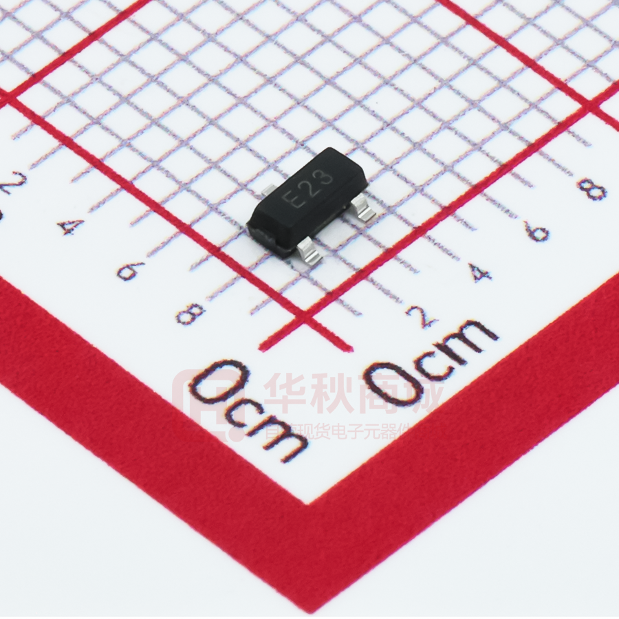

    带预偏置三极管 NPN SOT23 Ic=100mA Pd=200mW
DTC143ZCA 数据手册
DTC143ZCA Digital Transistor DTC(R1≠R2 SERIES)CA FEATURES z Epitaxial planar die construction. z Complementary PNP types available(DTA). z Built-in biasing resistors,R1≠R2. z Also available in lead free version. APPLICATIONS z The NPN style digital transistor. SOT-23 MAXIMUM RATING @ Ta=25℃ unless otherwise specified Symbol Parameter Value Units VCC Supply Voltage 50 V DTC113ZCA DTC114WCA DTC114YCA DTC123JCA DTC123YCA DTC143XCA DTC143ZCA -5 to+10 -10 to+30 -6 to +40 -5 to+12 -5 to+12 -7 to+20 -5 to+30 V DTC113ZCA DTC114WCA DTC114YCA DTC123JCA DTC123YCA DTC143XCA DTC143ZCA 100 100 70 100 100 100 100 mA 100 mA 200 mW Input Voltage VIN Output Current IO IC(Max.) Output current PD Power Dissipation www.slkormicro.com ALL 1 DTC143ZCA Symbol Parameter Value Units RθJA Thermal Resistance, Junction to Ambient Air 625 ℃/W Tj,Tstg Operating and Storage and Temperature Range -55 to +150 ℃ ELECTRICAL CHARACTERISTICS @ Ta=25℃ unless otherwise specified Parameter Input Voltage Input Voltage Output Voltage Input Current Symbol DTC113ZCA DTC114WCA DTC114YCA DTC123JCA DTC123YCA DTC143XCA DTC143ZCA DTC113ZCA DTC114WCA DTC114YCA DTC123JCA DTC123YCA DTC143XCA DTC143ZCA DTC123JCA DTC143ZCA DTC114YCA ALL Others DTC113ZCA DTC114WCA DTC114YCA DTC123JCA DTC123YCA DTC143XCA DTC143ZCA Output Current DC Current Gain www.slkormicro.com DTC113ZCA DTC114WCA DTC114YCA DTC123JCA DTC123YCA DTC143XCA DTC143ZCA Test conditions MIN TYP MAX UNIT VI(off) VCC=5V,IO=100μA 0.3 0.8 0.3 0.5 0.3 0.3 0.5 - - VI(on) VO=0.3V,IO=20mA VO=0.3V,IO=2mA VO=0.3V,IO=1mA VO=0.3V,IO=5mA VO=0.3V,IO=20mA VO=0.3V,IO=20mA VO=0.3V,IO=5mA - - 3.0 3.0 1.4 1.1 3.0 2.5 1.3 - 0.1 0.3 V mA μA V Io/II=5mA/0.25mA VO(on) Io/II=10mA/0.5mA II VI=5V - - 7.2 0.88 0.88 3.6 3.8 1.8 1.8 IO(off) VCC=50V,VI=0V - - 0.5 VO=5V,IO=10mA 33 24 68 80 33 30 80 - - GI 2 DTC143ZCA Parameter Input Resistor Symbol DTC113ZCA DTC114WCA DTC114YCA DTC123JCA DTC123YCA DTC143XCA DTC143ZCA Test conditions R1(R2) MIN TYP MAX UNIT 0.7 7 7 1.54 1.54 3.29 3.29 1(10) 10(4.7) 10(47) 2.2(47) 2.2(10) 4.7(10) 4.7(47) 1.3 13 13 2.86 2.86 6.11 6.11 kΩ Input Resistor (R1) Tolerance ΔR1 - -30 +30 % Resistance Ratio Tolerance ΔR2/R1 - -20 +20 % Gain-Bandwidth Product fT VCE=10V,IE=5mA, f=100MHz - - MHz 250 TYPICAL CHARACTERISTICS @ Ta=25℃ unless otherwise specified www.slkormicro.com 3 DTC143ZCA www.slkormicro.com 4
