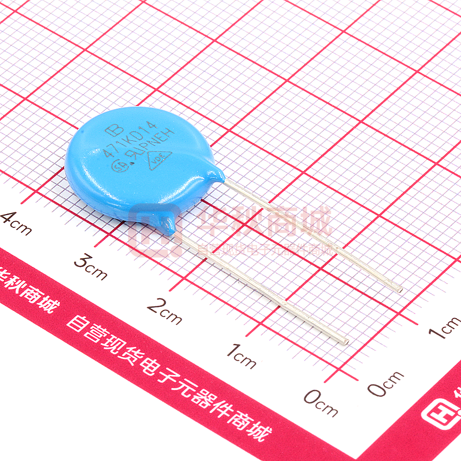

    压敏电阻 VAR=423~517V VC=775V
471KD14-TB 数据手册
14Φ SERIES Metal Oxide Varistor (MOV) Data Sheet Features ■ ■ ■ ■ Wide operating voltage (V1mA) range from 18V to 1800V Fast responding to transient over-voltage Large absorbing transient energy capability Low clamping ratio and no follow-on current ■ Meets MSL level 1, per J-STD-020 ■ Operating Temperature:-40℃ ~ +105℃ ■ Storage Temperature:-40℃ ~ +125℃ ■ Safety certification: UL: E327997 CSA: 246579 VDE: 40027827 Applications ■ ■ ■ ■ ■ Transistor, diode, IC, thyristor or triac semiconductor protection Surge protection in consumer electronics Surge protection in industrial electronics Surge protection in electronic home appliances, gas and petroleum appliances Relay and electromagnetic valve surge absorption Part Number Code Packing No suffix: Bulk TB: Tape & Box TR: Tape & Reel Tolerance K: ±10% Type D: Disk Varistor Voltage 180: 18V 101: 100V 102: 1000V Revision: MOV-14Φ SERIES-001(A5) Surge Series No suffix: Standard type J: High Surge type Element Diameter 05~53 Pitch No suffix:7.5mm P10:10mm Lead Shape No suffix: Straight leads O: Outside crimped leads F: Y Kinked leads 2 / 13 http://brightking.pulseelectronics.com 14Φ SERIES Dimensions D D T H1 K≤3.0 F e d L1 d1 L1 L K≤3.0 d T H1 H D d F O Type F Type Notes: Varistor voltage≥1200V, structure diagram is F type. Table 1 Table 2 Unit: mm Unit: mm Symbol Dimension Model T e Model T e H 14.5~20.0 180K 2.0~3.9 1.5 361K 2.9~5.2 2.7 H1 17.0~21.0 220K 2.1~4.0 1.6 391K 3.0~5.4 2.8 L(min.) 20.0 270K 2.1~4.1 1.8 431K 3.2~5.6 3.0 L1(min.) 15.0 330K 2.2~4.3 1.7 471K 3.3~5.8 3.2 D 14.0~16.5 390K 2.1~4.1 1.8 511K 3.4~6.1 3.4 F(±0.8) 7.5 470K 2.2~4.3 1.9 561K 3.6~6.4 3.6 T Table 2 560K 2.3~4.6 2.1 621K 3.8~6.8 3.9 e(±0.8) Table 2 680K 2.4~4.8 2.4 681K 4.0~7.1 4.2 d(±0.05) 0.8 820K 2.1~4.1 1.8 751K 4.3~7.2 4.3 d1(±0.4) 1.4 101K 2.4~4.2 2.0 781K 4.4~7.3 4.4 121K 2.4~4.4 2.2 821K 4.6~7.5 4.6 151K 2.2~4.1 1.8 911K 4.8~7.5 5.0 181K 2.3~4.2 1.9 102K 5.4~8.0 5.0 201K 2.4~4.3 2.0 112K 5.8~8.5 5.4 221K 2.5~4.4 2.1 122K 5.9~9.0 5.8 241K 2.6~4.5 2.2 142K 6.9~10.5 6.6 271K 2.6~4.6 2.4 162K 7.4~11.0 7.4 301K 2.7~4.6 2.5 182K 7.6~12.0 8.2 331K 2.7~5.0 2.5 Revision: MOV-14Φ SERIES-001(A5) 3 / 13 http://brightking.pulseelectronics.com 14Φ SERIES Electrical Characteristics Part Number Maximum Allowable Voltage Varistor Voltage Maximum Clamping Voltage Withstanding Surge Current Maximum Energy (10/1000μs) Rated Power Typical Capacitance (Reference) Standard High Surge VAC(V) VDC(V) V1mA(V) IP(A) VC(V) I (A) Standard I (A) High Surge (J) Standard (J) High Surge (W) @1KHz (pf) 180KD14 180KD14J 11 14 18(15~21.6) 10 36 1000 2000 4.0 7.0 0.1 11100 220KD14 220KD14J 14 18 22(19.5~26) 10 43 1000 2000 5.0 8.0 0.1 9100 270KD14 270KD14J 17 22 27(24~31) 10 53 1000 2000 6.0 10.0 0.1 7400 330KD14 330KD14J 20 26 33(29.5~36.5) 10 65 1000 2000 7.5 12.0 0.1 6100 390KD14 390KD14J 25 31 39(35~43) 10 77 1000 2000 8.6 13.0 0.1 5100 470KD14 470KD14J 30 38 47(42~52) 10 93 1000 2000 10.0 17.0 0.1 4300 560KD14 560KD14J 35 45 56(50~62) 10 110 1000 2000 11.0 20.0 0.1 3600 680KD14 680KD14J 40 56 68(61~75) 10 135 1000 2000 14.0 24.0 0.1 2900 820KD14 820KD14J 50 65 82(74~90) 50 135 4500 6000 22.0 27.0 0.6 2400 101KD14 101KD14J 60 85 100(90~110) 50 165 4500 6000 28.0 33.0 0.6 2000 121KD14 121KD14J 75 100 120(108~132) 50 200 4500 6000 32.0 40.0 0.6 1700 151KD14 151KD14J 95 125 150(135~165) 50 250 4500 6000 40.0 53.0 0.6 1300 181KD14 181KD14J 115 150 180(162~198) 50 300 4500 6000 50.0 60.0 0.6 1100 201KD14 201KD14J 130 170 200(180~220) 50 340 4500 6000 57.0 70.0 0.6 1000 221KD14 221KD14J 140 180 220(198~242) 50 360 4500 6000 60.0 78.0 0.6 900 241KD14 241KD14J 150 200 240(216~264) 50 395 4500 6000 63.0 84.0 0.6 830 271KD14 271KD14J 175 225 270(243~297) 50 455 4500 6000 70.0 99.0 0.6 740 301KD14 301KD14J 190 250 300(270~330) 50 500 4500 6000 77.0 108 0.6 670 331KD14 331KD14J 210 275 330(297~363) 50 550 4500 6000 85.0 115 0.6 610 361KD14 361KD14J 230 300 360(324~396) 50 595 4500 6000 93.0 130 0.6 560 391KD14 391KD14J 250 320 390(351~429) 50 650 4500 6000 100 140 0.6 510 431KD14 431KD14J 275 350 430(387~473) 50 710 4500 6000 115 155 0.6 460 471KD14 471KD14J 300 385 470(423~517) 50 775 4500 6000 118 175 0.6 430 511KD14 511KD14J 320 415 510(459~561) 50 845 4500 6000 121 180 0.6 390 561KD14 561KD14J 350 460 560(504~616) 50 925 4500 6000 125 185 0.6 360 621KD14 621KD14J 385 505 620(558~682) 50 1025 4500 6000 128 190 0.6 320 681KD14 681KD14J 420 560 680(612~748) 50 1120 4500 6000 130 200 0.6 290 751KD14 751KD14J 460 615 750(675~825) 50 1240 4500 6000 143 210 0.6 270 781KD14 781KD14J 485 640 780(702~858) 50 1290 4500 6000 148 220 0.6 260 821KD14 821KD14J 510 670 820(738~902) 50 1355 4500 6000 157 235 0.6 240 911KD14 911KD14J 550 745 910(819~1001) 50 1500 4500 6000 175 255 0.6 220 102KD14 102KD14J 625 825 1000(900~1100) 50 1650 4500 6000 190 280 0.6 200 112KD14 112KD14J 680 895 1100(990~1210) 50 1815 4500 6000 213 310 0.6 180 122KD14 122KD14J 750 990 1200(1080~1320) 50 1980 4500 6000 232 324 0.6 160 142KD14 142KD14J 880 1140 1400(1260~1540) 50 2310 4500 6000 238 327 0.6 150 Revision: MOV-14Φ SERIES-001(A5) 4 / 13 http://brightking.pulseelectronics.com 14Φ SERIES Maximum Allowable Voltage Part Number Maximum Clamping Voltage Varistor Voltage Withstanding Surge Current Maximum Energy (10/1000μs) Rated Power Typical Capacitance (Reference) Standard High Surge VAC(V) VDC(V) V1mA(V) IP(A) VC(V) I (A) Standard I (A) High Surge (J) Standard (J) High Surge (W) @1KHz (pf) 162KD14 162KD14J 1000 1280 1600(1440~1760) 50 2640 4500 6000 243 331 0.6 140 182KD14 182KD14J 1100 1465 1800(1620~1980) 50 2970 4500 5000 250 335 0.6 130 Notes: 1. The tolerance of varistor voltage between 18V and 27V is more than 10%; 2. Varistor voltage≥1200V, structure diagram is F type; 3. Leakage Current (@83% of V1mA):IR≤50μA (180K~680K) ; IR≤25μA (820K~182K). Electrical Ratings Items Varistor Voltage Maximum Allowable Voltage Test Condition/Description Requirement The voltage between the two terminals with the specified measuring current 1mA.DC applied is called Vb. The recommended maximum sine wave voltage (RMS) or the Maximum DC voltage can be applied continuously. The maximum voltage between the two terminals with the specification standard impulse current. Applied waveform: 8/20μs Crest value Maximum Clamping Current (%) 100 90 Voltage To meet the 50 Specified value 20µs 10 0 8µs Time Impulse Width Rated Wattage Energy Withstanding Surge Current The maximum average power that can be applied within the specified ambient temperature. The maximum energy within the varistor voltage change of ±10% when one impulse of 10/1000μs or 2ms is applied. The maximum current within the varistor voltage change of ±10% with the standard impulse current (8/20μs) applied one time. V1mA@105℃-V1mA@25℃ V1mA@25℃ Varistor Voltage × 1 × 100%(%/℃) 80 ≤0.05%/℃ Temp. Coefficient V1mA@-40℃-V1mA@25℃ V1mA@25℃ × 1 × 100%(%/℃) 65 The change of Vb shall be measured after the impulse listed below which is applied 10,000 times continuously with the interval of ten Surge Life seconds at room temperature. 14Φ series Revision: MOV-14Φ SERIES-001(A5) 180K to 680K 75A (8/20μs) 820K to 182K 150A (8/20μs) 5 / 13 http://brightking.pulseelectronics.com 14Φ SERIES Soldering Recommendation Lead-free Wave Soldering Recommendation 300 Preheating Maximum Wave 265℃ Soldering Cooling Temperature (℃) 250 200 150 100 50 0 0 0.5 1 1.5 2 2.5 3 3.5 4 Time (minutes) Item Conditions Peak Temperature 265℃ Dipping Time 10 seconds (max.) Soldering 1 time Recommendation Reworking Conditions with Soldering Iron Item Conditions Temperature of Soldering Iron-tip 360℃ (max.) Soldering Time 3 seconds (max.) Distance from Varistor 2mm (min.) Revision: MOV-14Φ SERIES-001(A5) 6 / 13 http://brightking.pulseelectronics.com 14Φ SERIES Mechanical Characteristics Items Test conditions / Methods Specifications Gradually applying the force specified and keeping the unit fixed for 10±1 sec. Tensile Strength of Terminals Bending Strength of Terminals Vibration Terminal diameter (mm) 0.5<d≤0.8 0.8<d≤1.25 1.25<d Force (kg) 1.0 2.0 4.0 Hold specimen and apply the force specified below to each lead. Bend the specimen to 90°, then return to the original position. Repeat the procedure in the opposite direction. Terminal diameter (mm) 0.5<d≤0.8 0.8<d≤1.25 1.25<d Force (kg) 0.5 1.0 2.0 Frequency range: 10~55 Hz 2 Amplitude: 0.75mm or 98m/s Direction: 3 mutually perpendicular directions, 2hrs each. No visible damage | V1mA/V1mA |≤5% No visible damage | V1mA/V1mA |≤5% No visible damage | V1mA/V1mA |≤5% Solder ability Solder Temp: 245±5℃ Dipping Time: 2±0.5 sec At least 95% of terminal electrode is covered by new solder Resistance to Soldering Heat Solder Temp: 260±5℃ Dipping Time: 10±1 sec No visible damage | V1mA/V1mA |≤10% Reliability Items Test conditions / Methods Specifications High Temperature Storage Ambient Temp: 125±2℃ Duration: 1000hrs | V1mA/V1mA |≤5% Low Temperature Storage Ambient Temp: -40±2℃ Duration: 1000hrs | V1mA/V1mA |≤5% Ambient Temp: 40±2℃, 90~95% R.H. Duration: 1000hrs | V1mA/V1mA |≤5% Humidity The conditions shown below shall be repeated 5 cycles Temperature Cycle Step Temperature (℃) Period (minutes) 1 -40±3 30±3 2 Room temperature 15±3 3 125±3 30±3 4 Room temperature 15±3 No visible damage | V1mA/V1mA |≤5% High Temperature Load Ambient Temp: 105±2℃ Duration: 1000hrs Load: Max. Allowable Voltage In AC eara. | V1mA/V1mA|≤10% Damp Heat Load Ambient Temp: 40±2℃, 90~95% R.H. Duration: 1000hrs Load: Max. Allowable Voltage No visible damage | V1mA/V1mA |≤10% Metal balls method, 2500Vac 1 min. No visible damage Voltage Proof Revision: MOV-14Φ SERIES-001(A5) 7 / 13 http://brightking.pulseelectronics.com 14Φ SERIES Maximum Surge Current Derating Curve 820KD14 to 182KD14 180KD14 to 680KD14 10000 10000 1 2 100 1000 1 2 10 1023 104 10 105 106 Max. Surge Current (A) Max. Surge Current (A) 1000 10 1 100 10 102 103 104 105 106 10 1 0.1 10 100 1000 0.1 10 10000 Td (μs) 100 180KD14J to 680KD14J 10000 1 2 1 2 1000 10 102 103 104 105 106 Max. Surge Current (A) Max. Surge Current (A) 100 10 1 0.1 10 10000 820KD14J to 182KD14J 10000 1000 1000 Td (μs) 100 10 102 103 104 105 106 10 1 100 1000 10000 0.1 10 Td (μs) Revision: MOV-14Φ SERIES-001(A5) 100 1000 10000 Td (μs) 8 / 13 http://brightking.pulseelectronics.com 14Φ SERIES Maximum Leakage Current and Maximum Clamping Voltage Curve Revision: MOV-14Φ SERIES-001(A5) 9 / 13 http://brightking.pulseelectronics.com 14Φ SERIES Maximum Leakage Current and Maximum Clamping Voltage Curve Revision: MOV-14Φ SERIES-001(A5) 10 / 13 http://brightking.pulseelectronics.com 14Φ SERIES Maximum Leakage Current and Maximum Clamping Voltage Curve Revision: MOV-14Φ SERIES-001(A5) 11 / 13 http://brightking.pulseelectronics.com 14Φ SERIES Marking Code ① ① Brightking Logo ② Varistor Voltage ③ CSA Accreditation Logo XXXKDXXX ② ③ ④ ⑤ XXX Y VDE ⑥ ⑦ ④ UL Accreditation Logo ⑤ VDE Accreditation Logo ⑧ ⑥“J”is High Surge Code, no“J”is Standard Surge ⑦ Disk Size ⑧ Internal control code Taping Dimensions P2 P Symbol Dimensions (mm) P 25.4±1.0 P0 12.7±1.0 P1 8.95±0.7 P2 12.7±1.3 F 7.5±0.8 h 0±4 W 18.0±1.0 W0 12.0±1.0 W1 9.0±0.5 W2 3.0max H 20.0±2.0 D0 4.0±0.2 t 0.6±0.3 B 40max h B W2 W0 W H D0 P1 P0 F W1 t Revision: MOV-14Φ SERIES-001(A5) 12 / 13 http://brightking.pulseelectronics.com 14Φ SERIES Quantity Packaging Dimensions (Unit: mm) In bulk for Terminals Untrimmed Products Quantity 400pcs/bag 4bags/box (180K~331K) 300pcs/bag 4bags/box ax . (361K~621K) 5M 250pcs/bag 16 130 Max. 4bags/box 250 Max. (681K~112K) 150pcs/bag 4bags/box (122K~182K) In bulk for Terminals Trimmed Products 400pcs/bag 4bags/box (180K~331K) 300pcs/bag ax . 4bags/box 0M (361K~621K) 16 66 Max. 250pcs/bag 252 Max. 4bags/box (681K~112K) 150pcs/bag 4bags/box (122K~182K) Tape & Box 750pcs/box (180K~331K) 500pcs/box 0M ax . (361K~621K) 25 60 Max. 400pcs/box 340 Max. (681K~751K) Tape & Reel 1000pcs/reel 750pcs/reel 5M ax . (180K~331K) 36 60 Max. (361K~621K) 365 Max. 500pcs/reel 55 Max. 30±1 Φ365 Max. Revision: MOV-14Φ SERIES-001(A5) (681K~751K) 13 / 13 http://brightking.pulseelectronics.com
471KD14-TB
物料型号:文档中提到的物料型号为14Φ系列,具体型号包括180KD14、220KD14、270KD14等,以此类推,直到182KD14。
器件简介:14Φ系列是金属氧化物压敏电阻(MOV),由BrightKing AYAGEO公司生产。这些压敏电阻具备快速响应瞬态过电压、大能量吸收能力、低钳位比和无后续电流等特点。
引脚分配:文档中提供了两种类型的结构图,F型和O型,但没有具体说明每种型号的引脚分配。通常,压敏电阻有两端引脚,分别连接电路的两端。
参数特性:包括工作电压范围(V1mA)从18V到1800V,符合J-STD-020标准的MSL等级1,工作温度范围为-40℃至+105℃,存储温度范围为-40℃至+125℃。安全认证包括UL、CSA和VDE。
功能详解:14Φ系列压敏电阻主要用于半导体器件如晶体管、二极管、集成电路、双向可控硅或三端双向可控硅的保护,以及消费电子、工业电子、家用电器、燃气和石油设备的浪涌保护,以及继电器和电磁阀的浪涌吸收。
应用信息:文档中提到了压敏电阻的应用场景,包括半导体保护、消费电子、工业电子、家用电器、燃气和石油设备以及继电器和电磁阀的浪涌吸收。
封装信息:文档提供了压敏电阻的尺寸信息,包括直径、高度等,以及不同型号的特定尺寸。还提供了不同封装类型的代码,如散装(无后缀)、带卷盘装(TB)、胶带和卷轴(TR)等。
