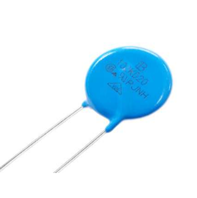

20Φ SERIES
Metal Oxide Varistor (MOV) Data Sheet
Features
Wide operating voltage (V1mA) range from 18V to 1800V
Fast responding to transient over-voltage
Large absorbing transient energy capability
Low clamping ratio and no follow-on current
Meets MSL level 1, per J-STD-020
■ Operating Temperature:-40℃ ~ +105℃
■ Storage Temperature:-40℃ ~ +125℃
■ Safety certification: UL: E327997
CSA: 246579
VDE: 40050493/40005858
Applications
Transistor, diode, IC, thyristor or triac semiconductor protection
Surge protection in consumer electronics
Surge protection in industrial electronics
Surge protection in electronic home appliances, gas and petroleum appliances
Relay and electromagnetic valve surge absorption
