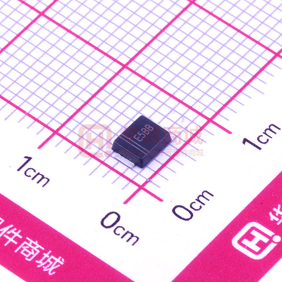

    SMBF
    二极管配置:独立式 直流反向耐压(Vr):100V 平均整流电流(Io):5A 正向压降(Vf):1V@5A 反向电流(Ir):10μA@100V 反向恢复时间(trr):35ns 工作温度:-55℃...
ES5BBF 数据手册
山东晶导微电子股份有限公司 ES5ABF THRU ES5JBF Jingdao Microelectronics co.LTD Surface Mount Superfast Recovery Rectifier Reverse Voltage – 50 to 600 V PINNING Forward Current – 5 A PIN FEATURES • For surface mounted applications • Low profile package • Glass Passivated Chip Junction • Superfast reverse recovery time • Lead free in comply with EU RoHS 2011/65/EU directives DESCRIPTION 1 Cathode 2 Anode 1 2 Simplified outline SMBF and symbol MECHANICAL DATA • Case: SMBF • Terminals: Solderable per MIL-STD-750, Method 2026 • A pprox. Weight: 57mg / 0.002oz Absolute Maximum Ratings and Characteristics Ratings at 25 °C ambient temperature unless otherwise specified. Single phase, half wave, 60 Hz, resistive or inductive load. For capacitive load, derate current by 20%. Symbols ES5ABF ES5BBF ES5CBF ES5DBF ES5EBF ES5GBF ES5JBF Units Maximum Repetitive Peak Reverse Voltage V RRM 50 100 150 200 300 400 600 V Maximum RMS voltage V RMS 35 70 105 140 210 280 420 V Maximum DC Blocking Voltage V DC 50 100 150 200 300 400 600 V Maximum Average Forward Rectified Current at T c = 115 °C I F(AV) 5 A Peak Forward Surge Current 8.3 ms Single Half Sine Wave Superimposed on Rated Load I FSM 150 A Maximum Forward Voltage at 5A VF Parameter Maximum DC Reverse Current T a = 25 °C at Rated DC Blocking Voltage T a =125 °C Typical Junction Capacitance at V R =4V, f=1MHz Maximum Reverse Recovery Time (1) Typical Thermal Resistance 2) Operating and Storage Temperature Range 1.25 1.0 1.7 V IR 10 100 μA Cj 50 pF t rr 35 ns RθJA RθJC 40 12 °C/W T j , T stg -55 ~ +150 °C (1)Measured with I F = 0.5 A, I R = 1 A, I rr = 0.25 A . (2)P.C.B. mounted with 2.0" X 2.0" (5 X 5 cm) copper pad areas. 2016.01 SMBF-E-ES5ABF~ES5JBF-5A600V Page 1 of 3 山东晶导微电子股份有限公司 ES5ABF THRU ES5JBF Jingdao Microelectronics co.LTD Fig.1 Reverse Recovery Time Characteristic And Test Circuit Diagram 50 ohm Noninductive t rr 10 ohm Noninductive +0.5 D.U.T + PULSE GENERATOR Note 2 25Vdc approx 0 - -0.25 1 ohm NonInductive OSCILLOSCOPE Note 1 -1.0 Note:1.Rise Time = 7ns, max. Input Impedance = 1megohm,22pF. 2. Ries Time =10ns, max. Source Impedance = 50 ohms. 10ns/div Set time Base for 10ns/div Fig.3 Typical Reverse Characteristics 300 6 5 I R - Reverse Current ( μ A) Average Forward Current (A) Fig.2 Maximum Average Forward Current Rating 4 3 2 1 Single phase half-wave 60 Hz resistive or inductive load 100 T J =125°C 10 T J =75°C 1.0 T J =25°C 0.1 0 25 50 75 100 125 150 175 20 0 40 Case Temperature (°C) Junction Capacitance ( pF) Instaneous Forward Current (A) T J =25°C 1.0 ES5ABF~ES5DBF ES5EBF/WS5GBF 0.1 80 100 Fig.5 Typical Junction Capacitance Fig.4 Typical Forward Characteristics 10 60 % of PIV.VOLTS ES5JBF 0.01 T J =25°C 100 10 T J=25°C f = 1.0MHz V sig = 50mV p-p 1 0.001 0 0.5 1.0 1.5 2.0 2.5 Instaneous Forward Voltage (V) 0.1 1.0 10 100 Reverse Voltage (V) Peak Forward Surage Current (A) Fig.6 Maximum Non-Repetitive Peak Forward Surage Current 175 150 125 100 75 50 25 8.3 ms Single Half Sine Wave (JEDEC Method) 00 1 10 100 Number of Cycles 2016.01 www.sdjingdao.com Page 2 of 3 山东晶导微电子股份有限公司 ES5ABF THRU ES5JBF Jingdao Microelectronics co.LTD PACKAGE OUTLINE Plastic surface mounted package; 2 leads SMBF ∠ALL ROUND C A ∠ALL ROUND D E A V M g Top View mil Bottom View A C D E HE e max 1.3 0.26 4.4 3.7 5.5 2.2 min 1.1 0.18 4.2 3.5 5.1 1.9 max 51 10 173 146 216 86 min 43 7 165 138 200 75 UNIT mm ∠ 9° Type number Marking code 1.8(71) 2.54(100) 3.0(118) 40 Marking Unit:mm(mil) 2016.01 g 1.0 The recommended mounting pad size 1.8(71) g pad e E A pad HE JD512269B5 ES5ABF E5AB ES5BBF E5BB ES5CBF E5CB ES5DBF E5DB ES5EBF E5EB ES5GBF E5GB ES5JBF E5JB Page 3 of 3
