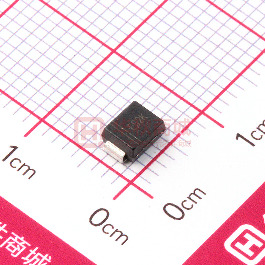

    二极管配置:独立式 直流反向耐压(Vr):800V 平均整流电流(Io):2A 正向压降(Vf):1.7V@2A 反向电流(Ir):5μA@800V 反向恢复时间(trr):35ns 工作温度:-55...
ES2KB 数据手册
山东晶导微电子股份有限公司 ES2KB Jingdao Microelectronics co.LTD Surface Mount Superfast Recovery Rectifier Reverse Voltage –800 V Forward Current –2 A PINNING PIN DESCRIPTION FEATURES • For surface mounted applications • Low profile package • Glass Passivated Chip Junction • Superfast reverse recovery time • Lead free in comply with EU RoHS 2011/65/EU directives 1 Cathode 2 Anode MECHANICAL DATA • Case : SMB • Terminals: Solderable per MIL-STD-750, Method 2026 • A pprox. Weight : 0.1g / 0.003oz Top View Marking Code: ES2K 2 1 Simplified outline SMB and symbol Absolute Maximum Ratings and Characteristics Ratings at 25 °C ambient temperature unless otherwise specified. Single phase, half wave, 60 Hz, resistive or inductive load. For capacitive load, derate current by 20%. Symbols ES2KB Units Maximum Repetitive Peak Reverse Voltage V RRM 800 V Maximum RMS voltage V RMS 560 V Maximum DC Blocking Voltage V DC 800 V Maximum Average Forward Rectified Current at T c = 125 °C I F(AV) 2 A Peak Forward Surge Current 8.3 ms Single Half Sine Wave Superimposed on Rated Load I FSM 60 A Maximum Forward Voltage at 2 A VF 1.70 V IR 5 100 μA Cj 40 pF t rr 35 ns RθJA RθJC 60 20 °C/W T j , T stg -55 ~ +150 °C Parameter Maximum DC Reverse Current T a = 25 °C at Rated DC Blocking Voltage T a =125 °C Typical Junction Capacitance at V R =4V, f=1MHz Maximum Reverse Recovery Time (1) Typical Thermal Resistance (2) Operating and Storage Temperature Range (1)Measured with I F = 0.5 A, I R = 1 A, I rr = 0.25 A . (2)P.C.B. mounted with 2.0" X 2.0" (5 X 5 cm) copper pad areas. 2018.07 SMB-E-ES2AKB-2A800V Page 1 of 3 山东晶导微电子股份有限公司 ES2KB Jingdao Microelectronics co.LTD Fig.1 Reverse Recovery Time Characteristic And Test Circuit Diagram 50 ohm Noninductive t rr 10 ohm Noninductive +0.5 D.U.T + PULSE GENERATOR Note 2 25Vdc approx 0 - -0.25 1 ohm NonInductive OSCILLOSCOPE Note 1 -1.0 Note:1.Rise Time = 7ns, max. Input Impedance = 1megohm,22pF. 2. Ries Time =10ns, max. Source Impedance = 50 ohms. 10ns/div Set time Base for 10ns/div Fig.3 Typical Reverse Characteristics 3.5 300 3.0 100 I R - Reverse Current ( μ A) Average Forward Current (A) Fig.2 Maximum Average Forward Current Rating 2.5 2.0 1.5 1.0 0.5 Single phase half-wave 60 Hz resistive or inductive load T J =125°C 10 T J =75°C 1.0 T J =25°C 0.1 0.0 25 50 75 100 125 150 0 175 20 40 Case Temperature (°C) Junction Capacitance ( pF) Instaneous Forward Current (A) T J =25°C 1.0 0.1 0.01 T J =25°C 100 0.001 1.0 1.5 100 Fig.5 Typical Junction Capacitance 10 0.5 80 % of PIV.VOLTS Fig.4 Typical Forward Characteristics 0 60 2.0 2.5 Instaneous Forward Voltage (V) 10 T J=25°C f = 1.0MHz V sig = 50mV p-p 1 0.1 1.0 10 100 Reverse Voltage (V) Peak Forward Surage Current (A) Fig.6 Maximum Non-Repetitive Peak Forward Surage Current 80 70 60 50 40 30 20 10 8.3 ms Single Half Sine Wave (JEDEC Method) 00 1 10 100 Number of Cycles 2018.07 www.sdjingdao.com Page 2 of 3 山东晶导微电子股份有限公司 ES2KB Jingdao Microelectronics co.LTD PACKAGE OUTLINE SMB Plastic surface mounted package; 2 leads L A A1 C A b D E E1 VM A SMB mechanical data UNIT mm mil A1 L C b 5.59 0.20 1.5 0.305 2.2 3.3 5.08 0.05 0.8 0.152 1.9 155 220 7.9 59 12 87 200 2.0 32 6 75 A E D max 2.44 4.70 3.94 min 2.13 4.06 max 96 185 min 84 130 160 E1 The recommended mounting pad size Marking Type number 2.2 (86) 2.4 (94) ES2KB Marking code ES2K 2.8 (110) 2.4 (94) mm Unit : (mil) 2018.07 JD80730 Page 3 of 3
