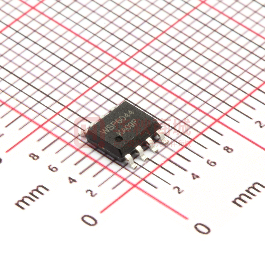

    N沟道 漏源电压(Vdss):60V 连续漏极电流(Id):10A 功率(Pd):3.5W
WSP6044 数据手册
WSP6044 N-Ch MOSFET General Description Product Summery The WSP6044 is the highest performance trench BVDSS RDSON ID N-ch MOSFETs with extreme high cell density , 60V 18mΩ 10A which provide excellent RDSON and gate Applications charge for most of the synchronous buck SMPS Synchronous Rectification. converter applications . DC-DC Conversion. Features Load Switch. Reliable and Rugged SOP-8 Pin Configuration Lead Free and Green Devices Available (RoHS Compliant) Absolute Maximum Ratings (T= 25℃ Unless Otherwise Noted) Parameter Symbol Rating VDSS Drain-Source Voltage 60 VGSS Gate-Source Voltage ±20 Maximum Junction Temperature 150 Unit V TJ °C TSTG Storage Temperature Range IS Diode Continuous Forward Current ID Continuous Drain Current IDM a PD RJAc -55 to 150 TA=25°C 5 TA=25°C 10 TA=70°C 8 TA=25°C 38 TA=25°C 3.5 TA=70°C 2.2 t ≤10s 35 Steady-State 70 A Pulsed Drain Current Maximum Power Dissipation W Thermal Resistance-Junction to Ambient °C/W IASb Avalanche Current, Single pulse L=0.1mH 27 A EASb Avalanche Energy, Single pulse L=0.1mH 36 mJ Note a:Pulse width limited by max. junction temperature. Note b:UIS tested and pulse width limited by maximum junction temperature 150℃ (initial temperature Tj=25℃). Note c:Surface Mounted on 1in2 pad area. www.winsok.tw Page 1 Rev1.0 Jan.2021 WSP6044 N-Ch MOSFET Electrical Characteristics (T= 25℃ unless otherwise noted) Test Conditions Symbol Parameter BVDSS Drain-Source Breakdown Voltage IDSS Zero Gate Voltage Drain Current VGS( th) IGSS VGS=0V, IDS=250 A VDS =48V, VGS=0V TJ=85°C Min. Typ. Max. Unit 60 - - V - - 1 - - 30 1.4 - 2.4 V nA Gate Threshold Voltage VDS =VGS, IDS=250 A Gate Leakage Current VGS=±20V, VDS=0V - - ±100 VGS=10V, IDS=10A - 18 25 VGS=4.5V, IDS=7A - 20 30 RDS(ON)d Drain-Source On-state Resistance  A mΩ VSDd Diode Forward Voltage ISD=10A, VGS=0V - 0.8 1.3 V trr Reverse Recovery Time - 21 - ns Qrr Reverse Recovery Charge ISD=10A, dlSD/dt=100A/us - 22 - nC RG Gate Resistance VGS=0V,VDS=0V,f=1MHz - 2.5 - Ω Ciss Input Capacitance - 2370 2780 Coss Output Capacitance - 135 - Crss Reverse Transfer Capacitance - 60 - td(ON) Turn-on Delay Time - 14 26 tr Turn-on Rise Time - 8 15 td(OFF) Turn-off Delay Time - 38 69 - 12 22 - 12 - - 26 37 - 5 - - 5 - tf Turn-off Fall Time Qg Total Gate Charge Qg Total Gate Charge Qgs Gate-Source Charge Qgd Gate-Drain Charge VGS=0V, VDS =30V, F=1.0MHz VDD =30V, RL=30, IDS=1A, VGEN=10V, RG=6R  VDS =30V, VGS=4.5V, IDS=10A. VDS =30V, VGS=10V, IDS=10A. pF ns nC Note d:Pulse test ; pulse width 300us, duty cycle≤2%. Note e:Guaranteed by design, not subject to production testing. www.winsok.tw Page 2 Rev1.0 Jan.2021 WSP6044 N-Ch MOSFET Typical Operating Characteristics Power Dissipation Drain Current 12 4.0 3.5 10 ID - Drain Current (A) Ptot - Power (W) 3.0 2.5 2.0 1.5 8 6 4 1.0 2 0.5 o 0.0 o TA=25 C 0 20 40 60 0 80 100 120 140 160 TA=25 C,VG=10V 0 20 o 40 60 80 100 120 140 160 o Tj - Junction Temperature ( C) Tj - Junction Temperature ( C) Safe Operation Area Thermal Transient Impedance 100 2 Duty = 0.5 300ms 1ms 1 10ms 100ms 0.1 1s DC Normalized Effective Transient )L 10 Rd s(o n ID - Drain Current (A) im it 1 0.2 0.1 0.05 0.1 0.02 0.01 0.01 Single Pulse 2 Mounted on 1in pad o RqJA :35 C/W o TA=25 C 0.01 0.01 0.1 1 10 100 300 1E-3 1E-4 VDS - Drain-Source Voltage (V) www.winsok.tw 1E-3 0.01 0.1 1 10 30 Square Wave Pulse Duration (sec) Page 3 Rev1.0 Jan.2021 WSP6044 N-Ch MOSFET Typical Operating Characteristics (Cont.) Output Characteristics Drain-Source On Resistance 40 34 VGS=4,5,6,7,8,9,10V 32 RDS(ON) - On Resistance (mW) ID - Drain Current (A) 35 30 25 20 3V 15 10 5 30 VGS=4.5V 28 26 VGS=10V 24 22 20 0 0.0 2.5V 0.5 1.0 1.5 2.0 2.5 18 3.0 0 8 16 24 VDS - Drain-Source Voltage (V) ID - Drain Current (A) Gate-Source On Resistance Gate Threshold Voltage 40 1.6 1.4 Normalized Threshold Voltage 35 RDS(ON) - On Resistance (mW) 40 IDS =250mA IDS=10A 30 25 20 15 10 32 2 3 4 5 6 7 8 9 1.0 0.8 0.6 0.4 0.2 -50 -25 10 0 25 50 75 100 125 150 o VGS - Gate-Source Voltage (V) www.winsok.tw 1.2 Tj - Junction Temperature ( C) Page 4 Rev1.0 Jan.2021 WSP6044 N-Ch MOSFET Typical Operating Characteristics (Cont.) Drain-Source On Resistance Source-Drain Diode Forward 2.00 40 VGS = 10V IDS = 10A 10 1.50 IS - Source Current (A) Normalized On Resistance 1.75 1.25 1.00 0.75 o Tj=150 C o Tj=25 C 1 0.50 o RON@Tj=25 C: 17mW 0.25 -50 -25 0 25 50 75 0.1 0.0 100 125 150 o 0.8 1.0 Capacitance Gate Charge 10 Frequency=1MHz 9 1600 8 VGS - Gate-Source Voltage (V) C - Capacitance (pF) 0.6 VSD - Source-Drain Voltage (V) 1800 Ciss 1400 1200 1000 800 600 400 0 0.4 Tj - Junction Temperature ( C) 2000 200 0.2 Coss Crss 0 8 16 VDS=30V IDS=10A 7 6 5 4 3 2 1 24 32 0 40 VDS - Drain-Source Voltage (V) www.winsok.tw 1.2 0 4 8 12 16 20 24 28 QG - Gate Charge (nC) Page 5 Rev1.0 Jan.2021 Attention 1,AnyandallWinsokpowerproductsdescribedorcontainedhereindonothavespecificationsthatcanhandle applicationsthatrequireextremelyhighlevelsofreliability,suchaslifeͲsupportsystems,aircraft'scontrolsystems,or otherapplicationswhosefailurecanbereasonablyexpectedtoresultinseriousphysicaland/ormaterialdamage.  ConsultwithyourWinsokpowerrepresentativenearestyoubeforeusinganyWinsokpowerproductsdescribedor containedhereininsuchapplications. 2,Winsokpowerassumesnoresponsibilityforequipmentfailuresthatresultfromusingproductsatvaluesthatexceed,  evenmomentarily,ratedvalues(suchasmaximumratings,operatingconditionranges,orotherparameters)listedin productsspecificationsofanyandallWinsokpowerproductsdescribedorcontainedherein. 3,SpecificationsofanyandallWinsokpowerproductsdescribedorcontainedhereinstipulatetheperformance, characteristics,andfunctionsofthedescribedproductsintheindependentstate,andarenotguaranteesofthe performance,characteristics,andfunctionsofthedescribedproductsasmountedinthecustomer’sproductsor equipment.Toverifysymptomsandstatesthatcannotbeevaluatedinanindependentdevice,thecustomershouldalways evaluateandtestdevicesmountedinthecustomer’sproductsorequipment. 4,WinsokpowerSemiconductorCO.,LTD.strivestosupplyhighͲqualityhighͲreliabilityproducts.However,anyandall semiconductorproductsfailwithsomeprobability.Itispossiblethattheseprobabilisticfailurescouldgiverisetoaccidents oreventsthatcouldendangerhumanlivesthatcouldgiverisetosmokeorfire,orthatcouldcausedamagetoother property.Whendesigningequipment,adoptsafetymeasuressothatthesekindsofaccidentsoreventscannotoccur.Such measuresincludebutarenotlimitedtoprotectivecircuitsanderrorpreventioncircuitsforsafedesign,redundantdesign, andstructuraldesign. 5,IntheeventthatanyorallWinsokpowerproducts(includingtechnicaldata,services)describedorcontainedhereinare controlledunderanyofapplicablelocalexportcontrollawsandregulations,suchproductsmustnotbeexportedwithout obtainingtheexportlicensefromtheauthoritiesconcernedinaccordancewiththeabovelaw. 6,Nopartofthispublicationmaybereproducedortransmittedinanyformorbyanymeans,electronicormechanical, includingphotocopyingandrecording,oranyinformationstorageorretrievalsystem,orotherwise,withouttheprior writtenpermissionofWinsokpowerSemiconductorCO.,LTD. 7,Information(includingcircuitdiagramsandcircuitparameters)hereinisforexampleonly;itisnotguaranteedfor volumeproduction. Winsokpowerbelievesinformationhereinisaccurateandreliable,butnoguaranteesaremadeor impliedregardingitsuseoranyinfringementsofintellectualpropertyrightsorotherrightsofthirdparties. 8,Anyandallinformationdescribedorcontainedhereinaresubjecttochangewithoutnoticeduetoproduct/technology improvement,etc.Whendesigningequipment,refertothe"DeliverySpecification"fortheWinsokpowerproductthatyou  Intendtouse. 9,thiscatalogprovidesinformationasofSep.2014. Specificationsandinformationhereinaresubjecttochangewithout notice.
