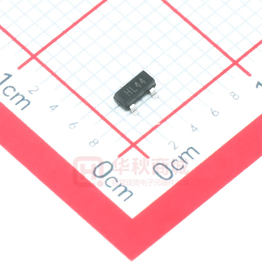

    肖特基二极管 Single VR=30V IF=200mA IR=2μA CT=10pF SOT23
BAT54S 数据手册
BAT54/A/C/S Rev.F Mar.-2016 描述 / DATA SHEET Descriptions SOT-23塑封封装 肖特基二极管。Schottky diodes in a SOT-23 Plastic Package.  特征 / Features 肖特基二极管。 Schottkydiodes. 用途 / Applications 正向电压低,反向恢复时间小。 Low forward and reverse recovery times. 内部等效电路 引脚排列 / Equivalent Circuit / Pinning 3 1 2 PIN: See Equivalent Circuit. 放大及印章代码 / hFE Classifications & Marking Model BAT54 BAT54A BAT54C BAT54S Marking HL4P HL42 HL43 HL44 http://www.fsbrec.com 1/6 BAT54/A/C/S Rev.F Mar.-2016 极限参数 / DATA SHEET Absolute Maximum Ratings(Ta=25℃) 参数 Parameter Repetitive Reverse Voltage 符号 Symbol VRRM 数值 Rating 30 单位 Unit V Average Rectified Forward Current IF(AV) 200 mA Non-repetitive Peak Forward Surge Current IFSM 600 mA Power Dissipation PD 290 mW RθJA 430 ℃/W Tj 150 ℃ Tstg -55~150 ℃ Thermal Resistance, Junction to Ambient Junction Temperature Storage Temperature Range 电性能参数 / Electrical Characteristics(Ta=25℃) 参数 Parameter Breakdown Voltage Forward Voltage 符号 Symbol VR VF 测试条件 Test Conditions IR=10μA 最小值 典型值 最大值 单位 Min Typ Max Unit 30 V IF=0.1mA 240 mV IF=1.0mA 320 mV IF=10mA 400 mV IF=30mA 500 mV IF=100mA 0.8 V Instantaneous Reverse Current IR VR=25V 2.0 μA Total Capacitance CT 10 pF Reverse Recovery Time trr VR=1.0V f=1.0MHz IF=1R=10mA IRR=1.0mA RL=100Ω 5.0 ns http://www.fsbrec.com 2/6 BAT54/A/C/S Rev.F Mar.-2016 电参数曲线图 DATA SHEET / Electrical Characteristic Curve http://www.fsbrec.com 3/6 BAT54/A/C/S Rev.F Mar.-2016 外形尺寸图 DATA SHEET / Package Dimensions http://www.fsbrec.com 4/6 BAT54/A/C/S Rev.F Mar.-2016 印章说明 / DATA SHEET Marking Instructions HL4P 说明: H:  为公司代码 L4P: 为型号代码 Note: H: Company Code. L4P: Product Type Code. http://www.fsbrec.com 5/6 BAT54/A/C/S Rev.F Mar.-2016 DATA SHEET 回流焊温度曲线图(无铅) / Temperature Profile for IR Reflow Soldering(Pb-Free) 说明: Note: 1、预热温度 25~150℃,时间 60~90sec; 1.Preheating:25~150℃, Time:60~90sec. 2、峰值温度 245±5℃,时间持续为 5±0.5sec; 2.Peak Temp.:245±5℃, Duration:5±0.5sec. 3、焊接制程冷却速度为 2~10℃/sec. 3. Cooling Speed: 2~10℃/sec. 耐焊接热试验条件 / Resistance to Soldering Heat Test Conditions 温度:260±5℃ 包装规格 Time:10±1 sec / REEL Package Type 封装形式 使用说明 Temp.:260±5℃ / Packaging SPEC. 卷盘包装 SOT-23 时间:10±1 sec. Units 包装数量 Dimension 包装尺寸 3 (unit:mm ) Units/Reel 只/卷盘 Reels/Inner Box 卷盘/盒 Units/Inner Box 只/盒 Inner Boxes/Outer Box 盒/箱 Units/Outer Box 只/箱 Reel Inner Box 盒 Outer Box 箱 3,000 10 30,000 8 240,000 7〞×8 180×120×180 385×257×392 / Notices http://www.fsbrec.com 6/6
