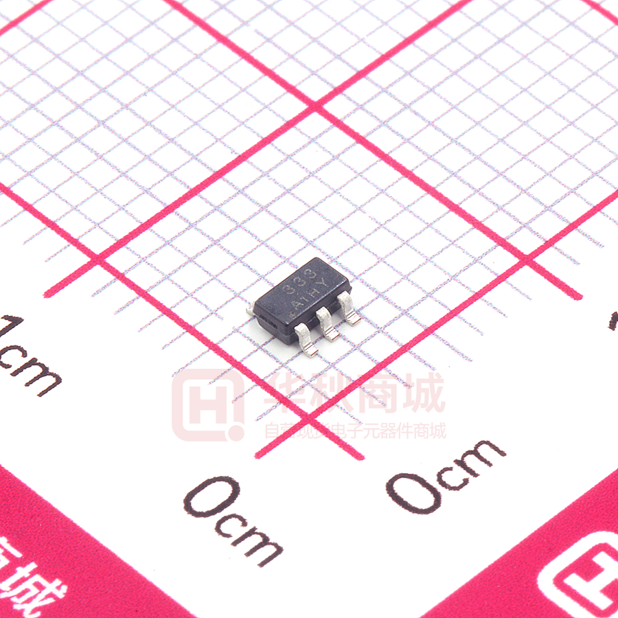

LTP3333NXT5
LTP3333NXT5
    LINEARIN(先积)
    SOT23-5
    300mA,通用射频线性稳压器
LTP3333NXT5 数据手册
LTP33xx P-1 DESCRIPTION The LTP33xx family of low-dropout (LDO), low-power linear regulators offers very high power supply rejection ratio (PSRR) while maintaining very low 40 μA ground current, suitable for RF applications. The family uses an advanced CMOS process and a P-MOSFET pass device to achieve fast start-up, very low noise, excellent transient response, and excellent PSRR performance. The LTP33xx is stable with a 1.0 μF ceramic output capacitor, and uses a precision voltage reference and feedback loop to achieve a worst-case accuracy of 2% over all load, line, process, and temperature variations. It is fully specified from TJ=–40°C to +125°C, and is offered in a tiny DFN1×14L/UTDFN1.0×1.0-4L and SOT23-5L/SC70-5L, and SOT23-3L/SOT-89 packages, which are ideal for small form factor portable equipments such as wireless handsets and wearables. The LTP33xx is available in standard fixed output voltages of 1.1V, 1.2V, 1.5V, 1.8V, 2.5V, 2.8V, 3.0V, 3.3V,3.6V and custom voltage options (50mV step options between 0.8V and 5.0V are available upon request). FEATURES  Wide Input Voltage Range: 2.5 V to 6.0 V Up to 300 mA Load Current Standard Fixed Output Voltage Options: 1.1 V, 1.2 V, 1.5 V, 1.8 V, 2.5 V, 2.8 V, 3.0 V, 3.3 V and 3.6 V More Output Voltage Options Available on Request Ultra Low Dropout: 190 mV at 300 mA Load Ultra Low Noise: 45 μVRMS at 1.2 V output Ultra-Fast Start-Up Time: 25 µs Excellent Load and Line Transient Response Line Regulation: 0.03% Typically With Auto Discharge Shutdown Version Available in DFN1×1-4L, UTDFN1.0×1.0-4L, SOT23-5L and SC70-5L Packages  Normal Version Available in SOT23-3L and SOT-89 Packages           APPLICATIONS      Smart Phones and Cellular Phones Modems Security and Surveillance Portable Devices Battery-Powered Equipments CAUTION: These devices are sensitive to electrostatic discharge; follow proper IC Handling Procedures. Linearin and designs are registered trademarks of Linearin Technology Corporation. © Copyright Linearin Technology Corporation. All Rights Reserved. All other trademarks mentioned are the property of their respective owners. FN1620-2C.1 — Data Sheet 300mA, General Purpose, RF Linear Regulators LTP33xx P-2 ORDER INFORMATION Model Note1 LTP33xx Package Ordering Number Note1 Packing Option DFN1×1-4L LTP33xxNXF4 Tape and Reel, 10000 SOT23-5L LTP33xxNXT5 Tape and Reel, 3000 SC70-5L LTP33xxNXC5 Tape and Reel, 3000 UTDFN1.0×1.0-4L LTP33xxNXFU4 Tape and Reel, 10000 SOT23-3L LTP33xxXT3 Tape and Reel, 3000 SOT-89 LTP33xxXT4 Tape and Reel ,1000 Note1: xx stands for output voltage, e.g. if xx = 18, the output voltage is 1.8V; if xx = 30, the output voltage is 3.0V. The device with suffix "N" is shutdown version with enable control input. PIN CONFIGURATION Shutdown Version With Enable (Top View) IN 1 GND 2 EN 3 IN EN 5 OUT 4 3 4 NC 1 2 OUT GND SOT23-5L / SC70-5L DFN1×1-4L / UTDFN1.0×1.0-4L Normal Version Without Enable (Top View) IN 3 1 2 GND OUT SOT23-3L CAUTION: These devices are sensitive to electrostatic discharge; follow proper IC Handling Procedures. Linearin and designs are registered trademarks of Linearin Technology Corporation. © Copyright Linearin Technology Corporation. All Rights Reserved. All other trademarks mentioned are the property of their respective owners. 1 2 3 GND IN OUT SOT-89 FN1620-2C.1 — Data Sheet 300mA, General Purpose, RF Linear Regulators LTP33xx P-3 PIN FUNCTION Pin Number SOT23-5L SC70-5L DFN1×1-4L UTDFN1.0×1.0-4L SOT23-3L Pin Name SOT-89 1 4 3 2 IN 2 2 1 1 GND 3 3 4 5 1 2 3 Function Supply input pin. Must be closely decoupled to GND with a 1μF or greater ceramic capacitor. Ground. EN Enable control input, active high. Do not leave EN floating. NC No connection. OUT Output pin. Bypass a 1μF ceramic capacitor from this pin to ground. BLOCK DIAGRAM IN EN OUT Gate Driver Current Limit and Thermal Shutdown + - 0.8V GND CAUTION: These devices are sensitive to electrostatic discharge; follow proper IC Handling Procedures. Linearin and designs are registered trademarks of Linearin Technology Corporation. © Copyright Linearin Technology Corporation. All Rights Reserved. All other trademarks mentioned are the property of their respective owners. FN1620-2C.1 — Data Sheet 300mA, General Purpose, RF Linear Regulators P-4 LTP33xx FUNCTIONAL DESCRIPTION Input Capacitor A 1 μF ceramic capacitor is recommended to connect between IN and GND pins to decouple input power supply glitch and noise. The amount of the capacitance may be increased without limit. This input capacitor must be located as close as possible to the device to assure input stability and less noise. For PCB layout, a wide copper trace is required for both IN and GND. Output Capacitor An output capacitor is required for the stability of the LDO. The recommended output capacitance is from 1 μF to 2.2 μF, Equivalent Series Resistance (ESR) is from 5 mΩ to 100 mΩ, and temperature characteristics is X7R or X5R. Higher capacitance values help to improve load/line transient response. The output capacitance may be increased to keep low undershoot/overshoot. Place output capacitor as close as possible to OUT and GND pins. ON/OFF Input Operation The LTP33xx is turned on by setting the EN pin high, and is turned off by pulling it low. If this feature is not used, the EN pin should be tied to IN pin to keep the regulator output on at all time. High PSRR and Low Noise RF circuits such as LNA (low-noise amplifier), up/down-converter, mixer, PLL, VCO, and IF stage, require low noise and high PSRR LDOs. The temperature-compensated crystal oscillator circuit requires very high PSRR at RF power amplifier burst frequency. For instance, minimum 65 dB PSRR at 217 Hz is recommended for the GSM handsets. In order to provide good audio quality, the audio power supply for hand-free, game, MP3, and multimedia applications in cellular phones, require low-noise and high PSRR at audio frequency range (20 Hz to 20 kHz). The LTP33xx, with PSRR of 70 dB at 1 kHz, is suitable for most of these applications that require high PSRR and low noise. Ultra Fast Start-up After enabled, the LTP33xx is able to provide full power in as little as tens of microseconds, typically 25 μs. This feature will help load circuitry move in and out of standby mode in real time, eventually extend battery life for mobile phones and other portable devices. Fast Transient Response Fast transient response LDOs can also extend battery life. TDMA-based cell phone protocols such as Global System for Mobile Communications (GSM) have a transmit/receive duty factor of only 12.5 percent, enabling power savings by putting much of the baseband circuitry into standby mode in between transmit cycles. In baseband circuits, the load often transitions virtually instantaneously from 100 μA to 100 mA. To meet this load requirement, the LDO must react very quickly without a large voltage drop or overshoot — a requirement that cannot be met with conventional, general-purpose LDOs. The LTP33xx’s fast transient response from 0 to 300 mA provides stable voltage supply for fast DSP and GSM chipset with fast changing load. CAUTION: These devices are sensitive to electrostatic discharge; follow proper IC Handling Procedures. Linearin and designs are registered trademarks of Linearin Technology Corporation. © Copyright Linearin Technology Corporation. All Rights Reserved. All other trademarks mentioned are the property of their respective owners. FN1620-2C.1 — Data Sheet 300mA, General Purpose, RF Linear Regulators P-5 LTP33xx Low Quiescent Current Cellular phone baseband internal digital circuits typically operate all the time. That requires LDO stays on at all times. However, in the standby mode, the microprocessor consumes only around 100 ~ 300 μA. Since the phone stays in standby for the longest percentage of time, using a 40 μA quiescent current LDO, instead of 100 μA, saves 60 μA and can substantially extends the battery standby time. The LTP33xx, consuming only around 40 μA for all input range and output loading, provides great power saving in portable and low power applications. Current Limit Protection When output current at the OUT pin is higher than current limit threshold or the OUT pin, the current limit protection will be triggered and clamp the output current to approximately 500 mA to prevent over-current and to protect the regulator from damage due to overheating. Thermal Shutdown Protection Thermal protection disables the output when the junction temperature rises to approximately +155°C, allowing the device to cool down. When the junction temperature reduces to approximately +130°C the output circuitry is enabled again. Depending on power dissipation, thermal resistance, and ambient temperature, the thermal protection circuit may cycle on and off. This cycling limits the heat dissipation of the regulator, protecting it from damage due to overheating. FUNCTIONAL DESCRIPTION Parameter Rating Unit IN Voltage –0.3 to 6.5 V –0.3 to VIN + 0.3 V Maximum Load Current 500 mA Junction to Ambient Thermal Resistance (θJA ), SOT23-5 220 ℃/W Operating Junction Temperature –40 to 125 ℃ Storage Temperature –65 to 150 ℃ 300 ℃ Other Pin Voltage Lead Temperature (Soldering, 10 sec) NOTE:Stresses beyond those listed under “Absolute Maximum Ratings” may cause permanent damage to the device. These are stress ratings only, and functional operation of the device at these or any other conditions beyond those indicated in the operational sections of the specifications is not implied. Exposure to absolute maximum rating conditions for extended periods may affect device reliability. CAUTION: This integrated circuit can be damaged by ESD if you don’t pay attention to ESD protection. LINEARIN recommends that all integrated circuits be handled with appropriate precautions. Failure to observe proper handling and installation procedures can cause damage. ESD damage can range from subtle performance degradation to complete device failure. Precision integrated circuits may be more susceptible to damage because very small parametric changes could cause the device not to meet its published specifications. LINEARIN reserves the right to make any change in circuit design, specification or other related things if necessary without notice at any time. Please contact LINEARIN sales office to get the latestdatasheet. CAUTION: These devices are sensitive to electrostatic discharge; follow proper IC Handling Procedures. Linearin and designs are registered trademarks of Linearin Technology Corporation. © Copyright Linearin Technology Corporation. All Rights Reserved. All other trademarks mentioned are the property of their respective owners. FN1620-2C.1 — Data Sheet 300mA, General Purpose, RF Linear Regulators LTP33xx P-6 ELECTRICAL CHARACTERISTICS (VIN = VEN = 3.6 V, TA = 25 °C unless otherwise noted) Parameter Symbol Test Conditions Input Voltage Operation Range VIN Dropout Voltage VDROP VOUT ≥ 2.8 V, IOUT = 300 mA DC Supply Quiescent Current IQ_ON DC Supply Shutdown Current Regulated Output Voltage Min. Typ. Max. Unit 6.0 V 190 280 mV Active mode: VEN = VIN 40 70 µA IQ_OFF VEN = 0V 0.01 1 µA VOUT IOUT = 1 mA, –40℃ ≤ TA ≤ 85℃ 2 % 0.03 0.2 % 0.4 % 2.5 –2 Output Voltage Line Regulation VIN = VOUT + 1 V to 5.5 V, IOUT = 10 mA Output Voltage Load Regulation IOUT from 0 mA to 300 mA 0.1 Soft-start Time from Enable to Power On 25 Current Limit RLOAD = 1 Ω f = 1 kHz, COUT = 1 μF, IOUT = 20 mA f = 10 kHz, COUT = 1 μF, IOUT = 30 mA Power Supply Rejection Ratio PSRR Output Noise 300 mA 70 dB 52 10 Hz to100 kHz, IOUT = 200 mA, VOUT = 2.8 V,COUT = 1 μF 70 10 Hz to 100 kHz, IOUT = 200 mA, VOUT = 1.2 V,COUT = 1 μF 45 µVRMS EN Low Threshold 0.4 EN High Threshold EN Pin Input Current µs 1.4 IEN V V 0 0.1 µA Over-temperature Shutdown Threshold 155 ℃ Over-temperature Shutdown Hysteresis 20 ℃ Note: Production test at + 25℃. Specifications over the temperature range are guaranteed by design and characterization. CAUTION: These devices are sensitive to electrostatic discharge; follow proper IC Handling Procedures. Linearin and designs are registered trademarks of Linearin Technology Corporation. © Copyright Linearin Technology Corporation. All Rights Reserved. All other trademarks mentioned are the property of their respective owners. FN1620-2C.1 — Data Sheet 300mA, General Purpose, RF Linear Regulators LTP33xx P-7 TYPICAL PERFORMANCE CURVES Line Regulation VOUT vs. VIN COUT = CIN = 1 μF, IOUT = 10 mA 3.4 Vout (-40℃) 3.38 Vout (25℃) 3.36 Vout (85℃) Vout (125℃) Vout (-40℃) 3.38 Vout (25℃) 3.36 3.34 3.34 3.32 3.32 Vout (V) Vout (V) 3.4 Line Regulation VOUT vs.VIN COUT = CIN = 1 μF, IOUT = 30 mA 3.3 3.28 Vout (85℃) Vout (125℃) 3.3 3.28 3.26 3.26 3.24 3.24 3.22 3.22 3.2 3.2 4 3.5 3.5 4.5 4 Line Regulation VOUT vs. VIN COUT = CIN = 1 μF, IOUT = 200 mA Vout (85℃) 3.36 3.34 3.34 3.32 3.32 Vout (V) Vout (V) Vout (-40℃) Vout (25℃) 3.38 Vout (25℃) Vout (85℃) Vout (125℃) 3.36 Line Regulation VOUT vs. VIN COUT = CIN = 1 μF, VIN = 4.3 V 3.4 Vout (-40℃) 3.38 3.3 3.28 5 Vin (V) Vin (V) 3.4 4.5 Vout (125℃) 3.3 3.28 3.26 3.26 3.24 3.24 3.22 3.22 3.2 3.2 3.5 4 Vin (V) 4.5 0 5 50 100 150 200 250 300 Iout (mA) Ripple Rejection vs. Frequency IOUT = 30 mA, COUT = 1 μF DropoutVoltage vs. Load Current 90 250 3.0V 200 RippleRejection (dB) DropoutVoltage (mV) 80 150 100 50 1.2V 70 60 50 40 30 20 10 0 0 0 100 200 300 400 Load Current (mA) CAUTION: These devices are sensitive to electrostatic discharge; follow proper IC Handling Procedures. Linearin and designs are registered trademarks of Linearin Technology Corporation. © Copyright Linearin Technology Corporation. All Rights Reserved. All other trademarks mentioned are the property of their respective owners. 0.1 1 10 Frequency (kHz) 100 1000 FN1620-2C.1 — Data Sheet 300mA, General Purpose, RF Linear Regulators LTP33xx P-8 TYPICAL PERFORMANCE CHARACTERISTICS Load Transient Response Load Transient Response VIN = 4.2 V, VOUT = 3.3 V, CIN = COUT = 1 μF, IOUT = 10 mA to 310 mA to 10 mA VIN = 4.2 V, VOUT = 3.3 V, CIN = COUT = 1 μF, IOUT = 10 mA to 160 mA to 10 mA (Rise/Fall time = 500 ns) (Rise/Fall time = 500 ns) CH1: VOUT, 50 mV/Div, DC Offset = 3.3 V CH1: VOUT, 50 mV/Div, DC Offset = 3.3V CH2: IOUT, 100 mA/Div DC CH2: IOUT, 50 mA/Div DC TIME: 10 ms/Div TIME: 20 ms/Div Load Transient Response VIN = 4.2 V, VOUT = 3.3 V, CIN = COUT = 1 μF, IOUT = 10 mA to 80 mA to 10 mA Line Transient Response VIN = 3.8 V to 4.8 V to 3.8 V (Rise/Fall time = 500 ns) (Rise/Fall time = 500 ns) VOUT = 3.3 V, CIN = COUT = 1 μF, IOUT = 100 mA CH1: VOUT, 100 mV/Div, DC Offset = 3.3 V CH2: VOUT, 20 mV/Div, DC Offset = 3.3 V CH2: IOUT, 25 mA/Div DC CH1: VIN, 2V/Div DC Offset = 3.8 V TIME: 10ms/Di TIME: 20 ms/Div Line Transient Response Line Transient Response VIN = 3.8 V to 4.8 V to 3.8 V VIN = 3.8 V to 4.8 V to 3.8 V (Rise/Fall time = 500 ns) VOUT = 3.3 V, CIN = COUT = 1 μF, IOUT = 50 mA (Rise/Fall time = 500 ns) VOUT = 3.3 V, CIN = COUT = 1 μF, IOUT = 10 mA CH2: VOUT, 20 mV/Div, DC Offset = 3.3 V CH2: VOUT, 20 mV/Div, DC Offset = 3.3 V CH1: VIN, 2 V/Div DC Offset = 3.8 V CH1: VIN, 2 V/Div DC Offset = 3.8 V TIME: 20 ms/Div TIME: 20 ms/Div CAUTION: These devices are sensitive to electrostatic discharge; follow proper IC Handling Procedures. Linearin and designs are registered trademarks of Linearin Technology Corporation. © Copyright Linearin Technology Corporation. All Rights Reserved. All other trademarks mentioned are the property of their respective owners. FN1620-2C.1 — Data Sheet 300mA, General Purpose, RF Linear Regulators LTP33xx P-9 Exiting Shutdown Entering Shutdown VIN = 4.2 V, VOUT = 3.3 V, CIN = COUT = 1 μF, VIN = 4.2 V, VOUT = 3.3 V, CIN = COUT = 1 μF, IOUT = 10 mA IOUT = 10 mA CH1: EN, 5 V/Die, DC CH2: CH1: EN, 5 V/Die, DC CH2: VOUT, 1 V/Die DC VOUT, 1 V/Die DC TIME: 40 μs/Div TIME: 40 μs/Div APPLICATION CIRCUITS VIN VOUT OUT IN 1μF 1μF LTP33xx Enable EN GND CAUTION: These devices are sensitive to electrostatic discharge; follow proper IC Handling Procedures. Linearin and designs are registered trademarks of Linearin Technology Corporation. © Copyright Linearin Technology Corporation. All Rights Reserved. All other trademarks mentioned are the property of their respective owners. FN1620-2C.1 — Data Sheet 300mA, General Purpose, RF Linear Regulators LTP33xx P-10 PACKAGE DIMENSION UTDFN1.0×1.0-4L D A2 L A E e A1 b PIN1 Unit: mm MIN Dimensions In Millimeters MOD A 0.340 0.370 0.400 A1 0.000 0.020 0.050 Symbol A2 MAX 0.100REF D 0.950 1.000 1.050 D1 0.430 0.480 0.530 E 0.950 1.000 1.050 E1 0.430 0.480 0.530 b 0.170 0.220 0.270 e 0.650BSC f 0.190 0.195 0.200 L 0.200 0.250 0.300 CAUTION: These devices are sensitive to electrostatic discharge; follow proper IC Handling Procedures. Linearin and designs are registered trademarks of Linearin Technology Corporation. © Copyright Linearin Technology Corporation. All Rights Reserved. All other trademarks mentioned are the property of their respective owners. FN1620-2C.1 — Data Sheet 300mA, General Purpose, RF Linear Regulators LTP33xx P-11 PACKAGE DIMENSION DFN1.0×1.0-4L D A2 L A E e A1 b PIN1 Unit: mm MIN Dimensions In Millimeters MOD A 0.450 0.500 0.550 A1 0.000 0.025 0.050 Symbol A2 MAX 0.125REF D 0.950 1.000 1.050 D1 0.380 0.480 0.580 E 0.950 1.000 1.050 E1 0.380 0.480 0.580 b 0.150 0.200 0.250 e 0.650BSC f 0.190 0.195 0.200 L 0.150 0.250 0.350 CAUTION: These devices are sensitive to electrostatic discharge; follow proper IC Handling Procedures. Linearin and designs are registered trademarks of Linearin Technology Corporation. © Copyright Linearin Technology Corporation. All Rights Reserved. All other trademarks mentioned are the property of their respective owners. FN1620-2C.1 — Data Sheet 300mA, General Purpose, RF Linear Regulators LTP33xx P-12 PACKAGE DIMENSION SC70-5L L1 D L E E1 b c e A A1 A2 e1 Symbol A A1 A2 b c D E E1 e e1 L L1 θ Dimensions In Millimeters MAX 1.100 0.100 1.000 0.350 0.150 2.200 2.450 1.350 0.650BSC 1.200 1.400 0.525REF 0.260 0.460 0° 8° MIN 0.900 0.000 0.900 0.150 0.080 2.000 2.150 1.150 CAUTION: These devices are sensitive to electrostatic discharge; follow proper IC Handling Procedures. Linearin and designs are registered trademarks of Linearin Technology Corporation. © Copyright Linearin Technology Corporation. All Rights Reserved. All other trademarks mentioned are the property of their respective owners. Unit: mm FN1620-2C.1 — Data Sheet 300mA, General Purpose, RF Linear Regulators LTP33xx P-13 PACKAGE DIMENSION SOT23-3L D E E1 L b c e A A2 A1 e1 Unit: mm Symbol A A1 A2 b c D E E1 e e1 L θ MIN 1.050 0.000 1.000 0.300 0.100 2.820 2.650 1.500 1.800 0.300 0° Dimensions In Millimeters MAX 1.250 0.100 1.150 0.400 0.200 3.020 2.950 1.700 0.950BSC 2.000 0.600 8° CAUTION: These devices are sensitive to electrostatic discharge; follow proper IC Handling Procedures. Linearin and designs are registered trademarks of Linearin Technology Corporation. © Copyright Linearin Technology Corporation. All Rights Reserved. All other trademarks mentioned are the property of their respective owners. FN1620-2C.1 — Data Sheet 300mA, General Purpose, RF Linear Regulators LTP33xx P-14 PACKAGE DIMENSION SOT23-5L D E E1 L b c e Symbol A A1 A2 b c D E E1 e E1 L Θ MIN 0.700 0.000 1.050 0.350 0.080 2.820 2.650 1.600 1.800 0.300 0° A A2 A1 e1 Unit: mm Dimensions In Millimeters MAX 1.250 0.100 1.150 0.500 0.200 3.020 2.950 1.700 0.950BSC 2.000 0.600 8° CAUTION: These devices are sensitive to electrostatic discharge; follow proper IC Handling Procedures. Linearin and designs are registered trademarks of Linearin Technology Corporation. © Copyright Linearin Technology Corporation. All Rights Reserved. All other trademarks mentioned are the property of their respective owners. FN1620-2C.1 — Data Sheet 300mA, General Purpose, RF Linear Regulators LTP33xx P-15 PACKAGE DIMENSION SOT-89 D A L E E1 D1 e c b e1 Unit: mm Symbol A b c D D1 E E1 e e1 L MIN 1.400 0.320 0.350 4.400 3.940 2.300 0.900 Dimensions In Millimeters MAX 1.600 0.520 0.440 4.600 1.55REF 4.250 2.600 1.500BSC 3.000BSC 1.200 CAUTION: These devices are sensitive to electrostatic discharge; follow proper IC Handling Procedures. Linearin and designs are registered trademarks of Linearin Technology Corporation. © Copyright Linearin Technology Corporation. All Rights Reserved. All other trademarks mentioned are the property of their respective owners. FN1620-2C.1 — Data Sheet 300mA, General Purpose, RF Linear Regulators
