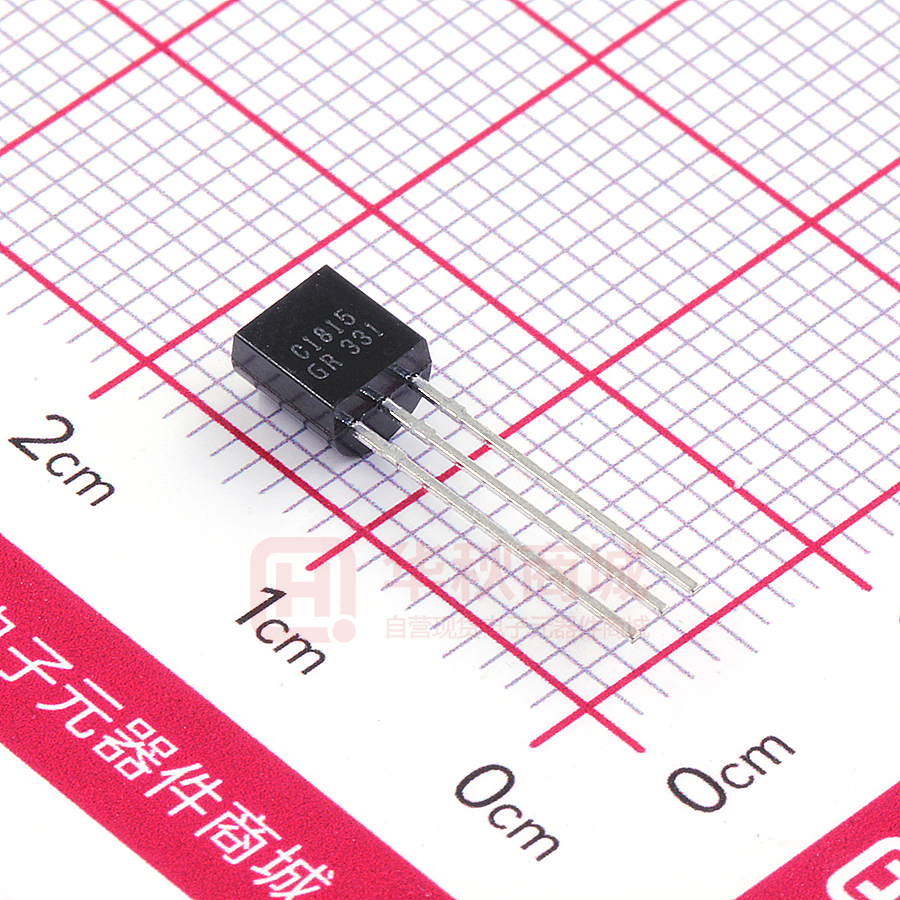

2SC1815
2SC1815
    SLKOR(萨科微)
    TO92-3
    晶体管类型:NPN 集射极击穿电压(Vceo):50V 集电极电流(Ic):150mA 功率(Pd):400mW 集电极截止电流(Icbo):100nA
2SC1815 数据手册
2SC1815  (     $)"# * $   (0,77(5  &2//(&725 +;  %$6( Equivalent Circuit +,++  -.' !" $/"#)" $"*0 #2""#  123$ 4 5 Collector-Base Voltage 60 V 4  Collector-Emitter Voltage 50 V 4!" 4 5 Emitter-Base Voltage 5 V  Collector Current -Continuous 0.15 A  Collector Power Dissipation 400 mW Thermal Resistance f rom Junction to Ambient 312  /W -55 ~+ 150     TJ,7 www.slkormicro.com Operation Junction and Storage Temperature Range 1 2SC1815 Ta =25  unless otherwise specified Parameter Symbol Test conditions Min Typ Max Unit Collector-base breakdown voltage V(BR)CBO IC= = 100uA, IE 0 60 V Collector-emitter breakdown voltage V(BR)CEO IC== 0. 1mA, IB 0 50 V Emitter-base breakdown voltage V(BR)EBO IE= = 100uA, IC 0 5 V = VCB= 60V,IE 0 Collector cut-off current ICBO Emitter cut-off current VEB=5V,IC 0 IEBO = DC current gain hFE VCE= 6 V, IC= 2mA 70 0.1 uA 0.1 uA 700 Collector-emitter saturation voltage VCE(sat) IC=100mA, = IB 10mA 0.25 V Base-emitter saturation voltage VBE(sat) IC=100mA, = IB 10mA 1 V fT Transition frequency Collector Output Capacitance Cob Noise Figure NF CLASSIFICATION OF Rank Range www.slkormicro.com VCE=10 V, IC= 1mA f=30MHz VCB=10V,IE=0 f=1MHz VCE=6V,IC=0.1mA f =1KHz,RG=10K 80 MHz 3.5 pF 10 dB hFE O Y GR BL 70-140 120-240 200-400 350-700 2 2SC1815  /#"# 0.012 0.010  COMMON EMITTER VCE=6V 54uA (A) Ta=100ć hFE 48uA 0.008 42uA DC CURRENT GAIN IC COLLECTOR CURRENT COMMON EMITTER Ta=25ć 60uA /( FF 1000 36uA 0.006 30uA 24uA 0.004 18uA Ta=25ć 100 12uA 0.002 IB=6uA 0.000 0 2 4 6 8 10 COLLECTOR-EMITTER VOLTAGE 1 100 150 10 COLLECTOR CURRENT (V) 4  FF  1 IC 45  FF 2 =10 (mA)  =10 1 0.3 BASE-EMITTER SATURATION VOLTAGE VBEsat (V) COLLECTOR-EMITTER SATURATION VOLTAGE VCEsat (V) VCE 10 0.2 12 0.1 Ta=100ć Ta=25ć 0.03 0.01 0.1 1 COLLECTOR CURRENT IC 1 100 150 10 COLLECTOR CURRENT (mA)  FF 45 150 Ta=100ć 0.1 0.1 100 150 10 Ta=25ć IC (mA) $3G 3 FF 4 5G 4 5 20 f=1MHz IE=0/ IC=0 Ta=25ć 10 (pF) C T= a 25 ć 1 0.1 0.0 COMMON EMITTER VCE=6V 0.2 0.4 0.6 0.8 BASE-EMITTER VOLTAGE B FF 1000 Cib CAPACITANCE 10 T= a 10 0ć COLLECTOR CURRENT IC (mA) 100 VBE 1.0 Cob 1 0.2 1.2 1 (V) 10 REVERSE VOLTAGE  V 20 (V)  FF  500 COMMON EMITTER VCE=10V COLLECTOR POWER DISSIPATION PC (mW) TRANSITION FREQUENCY fT (MHz) Ta=25ć 100 10 0.4 3 1 COLLECTOR CURRENT www.slkormicro.com 10 30 IC 400 300 200 100 0 100 0 25 50 75 AMBIENT TEMPERATURE (mA) 3 100 Ta 125 (ć ) 150 2SC1815 www.slkormicro.com 4
