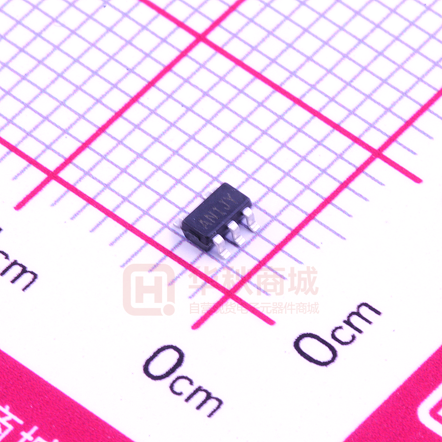

LTC8811YT5/R6
LTC8811YT5/R6
    LINEARIN(先积)
    SOT23-5
    600nA,成本优化系统的RRIO运算放大器
LTC8811YT5/R6 数据手册
LTC8811, LTC8812, LTC8814 P-1 General Description The LTC881x family of single-, dual-, and quad- channel amplifiers features a maximized ratio of gain bandwidth (GBW) to supply current and is ideal for battery-powered applications such as portable instrumentations, portable medical equipments, wearable fitness devices, and wireless remote sensors. Featuring rail-to-rail input and output swings, 15-kHz bandwidth of combined with ultra-low supply current (typical 600 nA at 5.0 V per amplifier) and low noise (6.3 μVP-P at 0.1 to 10 Hz) , the LTC881x family is an excellent choice for precision, cost-optimized, “Always ON” sensing applications. The robust design of the LTC881x amplifiers provides ease-of-use to the circuit designer: integrated RF/EMI rejection filter, no phase reversal in overdrive conditions, and high electro-static discharge (ESD) protection (5-kV HBM). The LTC881x amplifiers are optimized for operation at voltages as low as +1.7 V (±0.85 V) and up to +5.5 V (±2.75 V) over the extended temperature range of −40 ℃ to +85 ℃. The LTC8811 (single) is available in both SOT23-5L and SC70-5L packages. The LTC8812 (dual) is offered in DFN-8L, SOIC-8L and MSOP-8L packages. The quad-channel LTC8814 is offered in QFN-16L, SOIC-14L and TSSOP-14L packages. Features and Benefits  Ultra-Low Power Preserves Battery Life – 600 nA Supply Current (Typically at 5 V) Per Amplifier  Single 1.7 V to 5.5 V Supply Voltage Range – Can be Powered From the Same 1.8V/2.5V/3.3V/5V System Rails  15 kHz GBW  Precision Specifications for Buffer/Filter/Gain Stages – Low Input Offset Voltage: 0.6 mV – Low Noise: 6.3 μVP-P at 0.1 to 10 Hz – 1 pA Input Bias Current – Rail-to-Rail Input and Output  Extended Temperature Range: −40℃ to +85℃ Applications  Battery-Powered Instruments: – Consumer, Industrial, Medical, Notebooks  Wearable Fitness Devices  Sensor Signal Conditioning: – Sensor Interfaces, Loop-Powered, Active Filters  Wireless Sensors: – Home Security, Remote Sensing, Wireless Metering Pin Configurations (Top View) CAUTION: These devices are sensitive to electrostatic discharge; follow proper IC Handling Procedures. Linearin and designs are registered trademarks of Linearin Technology Corporation. © Copyright Linearin Technology Corporation. All Rights Reserved. All other trademarks mentioned are the property of their respective owners. FN1617-36.2 — Data Sheet 600nA, RRIO Op-amps for Cost-Optimized Systems LTC8811, LTC8812, LTC8814 P-2 Pin Description Symbol Description –IN Inverting input of the amplifier. +IN Non-inverting input of the amplifier. +VS Positive (highest) power supply. –VS Negative (lowest) power supply. OUT Amplifier output. Ordering Information Type Number Package Name Package Quantity Marking Code LTC8811YT5/R6 SOT23-5L Tape and Reel, 3 000 AN1 LTC8811YC5/R6 SC70-5L Tape and Reel, 3 000 AN1 LTC8812YF8/R6 DFN2x2-8L Tape and Reel, 3 000 AN2 LTC8812YS8/R8 SOIC-8L Tape and Reel, 4 000 AN2 Y LTC8812YV8/R6 MSOP-8L Tape and Reel, 3 000 AN2Y LTC8813YT5/R6 SOT23-5L Tape and Reel, 3 000 AN3 LTC8813YC5/R6 SC70-5L Tape and Reel, 3 000 AN3 LTC8814YS14/R5 SOIC-14L Tape and Reel, 2 500 AN4 Y LTC8814XF16/R6 QFN3x3-16L Tape and Reel, 3 000 AN4 Y LTC8814YT14/R6 TSSOP-14L Tape and Reel, 3 000 AN4 Y Limiting Value In accordance with the Absolute Maximum Rating System (IEC 60134). Parameter Absolute Maximum Rating Supply Voltage, VS+ to VS– 10.0 V Signal Input Terminals: Voltage, Current VS– – 0.5 V to VS+ + 0.5 V, ±10 mA Output Short-Circuit Continuous Storage Temperature Range, Tstg –65 ℃ to +150 ℃ Junction Temperature, TJ 150 ℃ Lead Temperature Range (Soldering 10 sec) 260 ℃ ESD Rating Parameter Electrostatic Discharge Voltage Item Value Human body model (HBM), per MIL-STD-883J / Method 3015.9 (1) ±5 000 Charged device model (CDM), per ESDA/JEDEC JS-002-2014 (2) ±2 000 Machine model (MM), per JESD22-A115C ±250 (1) JEDEC document JEP155 states that 500-V HBM allows safe manufacturing with a standard ESD control process. (2) JEDEC document JEP157 states that 250-V CDM allows safe manufacturing with a standard ESD control process. CAUTION: These devices are sensitive to electrostatic discharge; follow proper IC Handling Procedures. Linearin and designs are registered trademarks of Linearin Technology Corporation. © Copyright Linearin Technology Corporation. All Rights Reserved. All other trademarks mentioned are the property of their respective owners. Unit V FN1617-36.2 — Data Sheet 600nA, RRIO Op-amps for Cost-Optimized Systems LTC8811, LTC8812, LTC8814 P-3 Electrical Characteristics VS = 5.0V, TA = +25℃, VCM = VS /2, VO = VS /2, and RL = 10kΩ connected to VS /2, unless otherwise noted. Boldface limits apply over the specified temperature range, TA = −40 to +85 ℃. Symbol Parameter Conditions Min. Typ. Max. Unit ±0.6 ±3.0 mV ±1 ±3 μV/℃ OFFSET VOLTAGE VOS Input offset voltage VOS TC Offset voltage drift TA = −40 to +85 ℃ PSRR Power supply rejection ratio VS = 1.7 to 5.5 V, VCM < VS+ − 2V 76 TA = −40 to +85 ℃ 72 92 dB INPUT BIAS CURRENT IB Input bias current IOS Input offset current 1 TA = +85 ℃ pA 150 5 pA μVP-P NOISE Vn Input voltage noise f = 0.1 to 10 Hz 6.3 en Input voltage noise density f = 1 kHz 177 f = 100 Hz 184 In Input current noise density f = 1 kHz 10 nV/√Hz fA/√Hz INPUT VOLTAGE VCM CMRR Common-mode voltage range Common-mode rejection ratio VS––0.1 VS++0.1 TA = −40 to +85 ℃ VS– VS+–0.1 VS = 5.5 V, VCM = −0.1 to 5.5 V 67 VCM = 0 to 5.3 V, TA = −40 to +85 ℃ 64 VS = 1.8 V, VCM = −0.1 to 1.8 V 65 VCM = 0 to 1.6 V, TA = −40 to +85 ℃ 62 V 84 dB 79 INPUT IMPEDANCE RIN Input resistance CIN Input capacitance 100 GΩ Differential 2.0 Common mode 3.5 pF OPEN-LOOP GAIN AVOL Open-loop voltage gain RL = 50 kΩ, VO = 0.05 to 3.5 V 80 TA = −40 to +85 ℃ 75 RL = 5 kΩ, VO = 0.15 to 3.5 V 68 TA = −40 to +85 ℃ 64 97 dB 82 FREQUENCY RESPONSE GBW SR Gain bandwidth product Slew rate G = +1, CL = 50 pF, VO = 1.5 to 3.5 V 15 kHz 6 V/ms OUTPUT VOH High output voltage swing RL = 50 kΩ VS+–7 VS+–4 RL = 5 kΩ VS+–65 VS+–40 VOL Low output voltage swing RL = 50 kΩ VS–+3 VS–+5 RL = 5 kΩ VS–+27 VS–+42 CAUTION: These devices are sensitive to electrostatic discharge; follow proper IC Handling Procedures. Linearin and designs are registered trademarks of Linearin Technology Corporation. © Copyright Linearin Technology Corporation. All Rights Reserved. All other trademarks mentioned are the property of their respective owners. mV mV FN1617-36.2 — Data Sheet 600nA, RRIO Op-amps for Cost-Optimized Systems LTC8811, LTC8812, LTC8814 P-4 Electrical Characteristics (continued) VS = 5.0V, TA = +25℃, VCM = VS /2, VO = VS /2, and RL = 10kΩ connected to VS /2, unless otherwise noted. Boldface limits apply over the specified temperature range, TA = −40 to +85 ℃. Symbol ISC Parameter Short-circuit current Conditions Source current through 10Ω Min. Typ. 20 27 Sink current through 10Ω –33 Max. –25 Unit mA POWER SUPPLY VS Operating supply voltage TA = −40 to +85 ℃ IQ Quiescent current (per amplifier) VS = 1.8V, TA = +25℃ 450 650 VS = 5.0V, TA = +25℃ 600 880 1.7 5.5 V nA THERMAL CHARACTERISTICS TA θJA Operating temperature range Package Thermal Resistance -40 +85 SC70-5L 333 SOT23-5L 190 DFN2x2-8L 80 MSOP-8L 216 SOIC-8L 125 QFN3x3-16L 65 TSSOP-14L 112 SOIC-14L 115 CAUTION: These devices are sensitive to electrostatic discharge; follow proper IC Handling Procedures. Linearin and designs are registered trademarks of Linearin Technology Corporation. © Copyright Linearin Technology Corporation. All Rights Reserved. All other trademarks mentioned are the property of their respective owners. ℃ ℃/W FN1617-36.2 — Data Sheet 600nA, RRIO Op-amps for Cost-Optimized Systems LTC8811, LTC8812, LTC8814 P-5 Typical Performance Characteristics At TA = +25℃, VCM = VS /2, and RL = 10kΩ connected to VS /2, unless otherwise noted. 1,000 +125℃ +85℃ 800 Quiescent Current (nA) Quiescent Current (nA) 1000 600 400 +25℃ –40℃ 200 VS = 5V 800 600 400 200 0 0 0 1 2 3 4 5 -40 6 -20 Supply Voltage (V) Quiescent Current as a function of Supply Voltage. 900 40 60 80 100 VCM = –VS 800 VS = 5V Distribution (Units) Quiescent Current (nA) 20 Quiescent Current as a function of Temperature. 1000 800 0 Temperature (℃) 600 400 200 700 600 500 400 300 200 100 0 0 0 1 2 3 4 5 6 Offset Voltage (mV) Common-Mode Voltage (V) Quiescent Current as a function of Input CommonMode Voltage. Offset Voltage Production Distribution 120 100 80 80 PSRR (dB) CMRR (dB) 100 60 40 60 40 20 20 0 0 1 10 100 1k 10k 100k 1 Frequency (Hz) Common-mode Rejection Ratio as a function of Frequency. 10 100 1k 10k 100k Frequency (Hz) Power Supply Rejection Ratio as a function of Frequency. CAUTION: These devices are sensitive to electrostatic discharge; follow proper IC Handling Procedures. Linearin and designs are registered trademarks of Linearin Technology Corporation. © Copyright Linearin Technology Corporation. All Rights Reserved. All other trademarks mentioned are the property of their respective owners. FN1617-36.2 — Data Sheet 600nA, RRIO Op-amps for Cost-Optimized Systems LTC8811, LTC8812, LTC8814 P-6 Typical Performance Characteristics (continued) 120 60 90 40 60 20 30 0 0 -20 1000 Voltage Noise (nV/√Hz) 80 Phase (deg) AOL (dB) At TA = +25℃, VCM = VS /2, and RL = 10kΩ connected to VS /2, unless otherwise noted. 100 -30 10 100 1k 1 10k Frequency (Hz) CL = 100pF AV = +1 CL = 100pF AV = +1 0.5 ms/div Small Signal Step Response (200mV Step). 12.5 mV/div 25 mV/div Large Signal Step Response (2V Step). CL = 100pF AV = +1 0.5 ms/div Small Signal Step Response (100mV Step). 1k Input Voltage Noise Spectral Density as a function of Frequency. 0.5 ms/div CL = 100pF AV = +1 100 Frequency (Hz) 50 mV/div 0.5 V/div Open-loop Gain and Phase as a function of Frequency. 10 0.5 ms/div Small Signal Step Response (50mV Step). CAUTION: These devices are sensitive to electrostatic discharge; follow proper IC Handling Procedures. Linearin and designs are registered trademarks of Linearin Technology Corporation. © Copyright Linearin Technology Corporation. All Rights Reserved. All other trademarks mentioned are the property of their respective owners. FN1617-36.2 — Data Sheet 600nA, RRIO Op-amps for Cost-Optimized Systems LTC8811, LTC8812, LTC8814 P-7 Typical Performance Characteristics (continued) At TA = +25℃, VCM = VS /2, and RL = 10kΩ connected to VS /2, unless otherwise noted. 50 5 Short-circuit Current (mA) Output Voltage (V) Sourcing Current 4 –40℃ 3 +85℃ +25℃ 2 1 Sinking Current 0 40 30 Sinking 20 Sourcin g 10 0 0 10 20 30 40 1.5 Output Voltage Swing as a function of Output Current. 2 2.5 3 3.5 4 4.5 5 Supply Voltage (V) Output Current (mA) Short-circuit Current as a function of Supply Voltage. CAUTION: These devices are sensitive to electrostatic discharge; follow proper IC Handling Procedures. Linearin and designs are registered trademarks of Linearin Technology Corporation. © Copyright Linearin Technology Corporation. All Rights Reserved. All other trademarks mentioned are the property of their respective owners. 5.5 FN1617-36.2 — Data Sheet 600nA, RRIO Op-amps for Cost-Optimized Systems P-8 LTC8811, LTC8812, LTC8814 Application Notes Featuring a maximized ratio of GBW-to-supply current, low operating supply voltage, low input bias current, and rail-to-rail inputs and outputs, the LTC881x family is an excellent choice for precision or general-purpose, low-current, low-voltage, batterypowered applications. These CMOS operational amplifiers consume an ultra-low 600-nA (typically at 5-V supply voltage) supply current per amplifier. The LTC881x family is unity-gain stable with a 15-kHz GBW product, driving capacitive loads up to 250-pF. OPERATING VOLTAGE The LTC881x family is fully specified and ensured for operation at voltages as low as +1.7 V (±0.85 V) and up to +5.5 V (±2.75 V). In addition, many specifications apply from –40 ℃ to +85 ℃. Parameters that vary significantly with operating voltages or temperature are illustrated in the Typical Characteristics graphs. Figure 1 shows the input EMI filter and clamp circuit. The LTC881x op-amps have internal ESD protection diodes (D1, D2, D3, and D4) that are connected between the inputs and each supply rail. These diodes protect the input transistors in the event of electrostatic discharge and are reverse biased during normal operation. This protection scheme allows voltages as high as approximately 500-mV beyond the rails to be applied at the input of either terminal without causing permanent damage. These ESD protection current-steering diodes also provide in-circuit, input overdrive protection, as long as the current is limited to 10-mA as stated in the Absolute Maximum Ratings. VS+ D1 IN+ RAIL-TO-RAIL INPUT The input common-mode voltage range of the LTC881x series extends 100-mV beyond the negative and positive supply rails. This performance is achieved with a complementary input stage: an Nchannel input differential pair in parallel with a Pchannel differential pair. The N-channel pair is active for input voltages close to the positive rail, typically VS+–1.4 V to the positive supply, whereas the Pchannel pair is active for inputs from 100-mV below the negative supply to approximately VS+–1.4 V. There is a small transition region, typically VS+–1.2 V to VS+–1 V, in which both pairs are on. This 200-mV transition region can vary up to 200-mV with process variation. Thus, the transition region (both stages on) can range from VS+–1.4 V to VS+–1.2 V on the low end, up to VS+–1 V to VS+–0.8 V on the high end. Within this transition region, PSRR, CMRR, offset voltage, offset drift, and THD can be degraded compared to device operation outside this region. The typical input bias current of the LTC881x during normal operation is approximately 1-pA. In overdriven conditions, the bias current can increase significantly. The most common cause of an overdriven condition occurs when the operational amplifier is outside of the linear range of operation. When the output of the operational amplifier is driven to one of the supply rails, the feedback loop requirements cannot be satisfied and a differential input voltage develops across the input pins. This differential input voltage results in activation of parasitic diodes inside the front-end input chopping switches that combine with electromagnetic interference (EMI) filter resistors to create the equivalent circuit. Notice that the input bias current remains within specification in the linear region. INPUT EMI FILTER AND CLAMP CIRCUIT RS1 5kΩ D2 D3 CCM1 RS2 CDM 5kΩ IN– D4 CCM2 VS– Figure 1. Input EMI Filter and Clamp Circuit Operational amplifiers vary in susceptibility to EMI. If conducted EMI enters the operational amplifier, the dc offset at the amplifier output can shift from its nominal value when EMI is present. This shift is a result of signal rectification associated with the internal semiconductor junctions. Although all operational amplifier pin functions can be affected by EMI, the input pins are likely to be the most susceptible. The EMI filter of the LTC881x family is composed of two 5-kΩ input series resistors (RS1 and RS2), two common-mode capacitors (CCM1 and CCM2), and a differential capacitor (CDM). These RC networks set the −3 dB low-pass cutoff frequencies at 35-MHz for common-mode signals, and at 22-MHz for differential signals. RAIL-TO-RAIL OUTPUT Designed as a micro-power, low-noise operational amplifier, the LTC881x delivers a robust output drive capability. A class AB output stage with commonsource transistors is used to achieve full rail-to-rail output swing capability. For resistive loads up to 50kΩ, the output swings typically to within 4 mV of either supply rail regardless of the power-supply voltage applied. Different load conditions change the ability of the amplifier to swing close to the rails. For resistive loads up to 2-kΩ, the output swings typically to within 40-mV of the positive supply rail and within 27-mV of the negative supply rail. CAUTION: These devices are sensitive to electrostatic discharge; follow proper IC Handling Procedures. Linearin and designs are registered trademarks of Linearin Technology Corporation. © Copyright Linearin Technology Corporation. All Rights Reserved. All other trademarks mentioned are the property of their respective owners. FN1617-36.2 — Data Sheet 600nA, RRIO Op-amps for Cost-Optimized Systems LTC8811, LTC8812, LTC8814 P-9 Application Notes (continued) CAPACITIVE LOAD AND STABILITY feedback loop. The LTC881x family of operational amplifiers can safely drive capacitive loads of up to 250-pF in any configuration. As with most amplifiers, driving larger capacitive loads than specified may cause excessive overshoot and ringing, or even oscillation. A heavy capacitive load reduces the phase margin and causes the amplifier frequency response to peak. Peaking corresponds to overshooting or ringing in the time domain. Therefore, it is recommended that external compensation be used if the LTC881x family requires greater capacitive-drive capability. This compensation is particularly important in the unitygain configuration, which is the worst case for stability. For no-buffer configuration, there are two others ways to increase the phase margin: (a) by increasing the amplifier’s gain, or (b) by placing a capacitor in parallel with the feedback resistor to counteract the parasitic capacitance associated with inverting node. A quick and easy way to stabilize the op-amp for capacitive load drive is by adding a series resistor, RISO, between the amplifier output terminal and the load capacitance, as shown in Figure 2. RISO isolates the amplifier output and feedback network from the capacitive load. The bigger the RISO resistor value, the more stable VOUT will be. Note that this method results in a loss of gain accuracy because RISO forms a voltage divider with the RL. In unity gain applications with relatively small RL (approximately 5-kΩ), the capacitive load can be increased up to 100pF. RISO VOUT LTC881x EMI REJECTION RATIO Circuit performance is often adversely affected by high frequency EMI. When the signal strength is low and transmission lines are long, an op-amp must accurately amplify the input signals. However, all opamp pins — the non-inverting input, inverting input, positive supply, negative supply, and output pins — are susceptible to EMI signals. These high frequency signals are coupled into an op-amp by various means, such as conduction, near field radiation, or far field radiation. For example, wires and printed circuit board (PCB) traces can act as antennas and pick up high frequency EMI signals. Amplifiers do not amplify EMI or RF signals due to their relatively low bandwidth. However, due to the nonlinearities of the input devices, op-amps can rectify these out of band signals. When these high frequency signals are rectified, they appear as a dc offset at the output. The LTC881x op-amps have integrated EMI filters at their input stage. A mathematical method of measuring EMIRR is defined as follows: EMIRR = 20 log (VIN_PEAK / ΔVOS) INPUT-TO-OUTPUT COUPLING VIN RL CL Figure 2. Indirectly Driving Heavy Capacitive Load An improvement circuit is shown in Figure 3. It provides DC accuracy as well as AC stability. The RF provides the DC accuracy by connecting the inverting signal with the output. CF RF RISO VOUT LTC881x VIN CL RL Figure 3. Indirectly Driving Heavy Capacitive Load with DC Accuracy The CF and RISO serve to counteract the loss of phase margin by feeding the high frequency component of the output signal back to the amplifier’s inverting input, thereby preserving phase margin in the overall To minimize capacitive coupling, the input and output signal traces should not be parallel. This helps reduce unwanted positive feedback. MAXIMIZING PERFORMANCE THROUGH PROPER LAYOUT To achieve the maximum performance of the extremely high input impedance and low offset voltage of the LTC881x op-amps, care is needed in laying out the circuit board. The PCB surface must remain clean and free of moisture to avoid leakage currents between adjacent traces. Surface coating of the circuit board reduces surface moisture and provides a humidity barrier, reducing parasitic resistance on the board. The use of guard rings around the amplifier inputs further reduces leakage currents. Figure 4 shows proper guard ring configuration and the top view of a surface-mount layout. The guard ring does not need to be a specific width, but it should form a continuous loop around both inputs. By setting the guard ring voltage equal to the voltage at the non-inverting input, parasitic capacitance is minimized as well. For further reduction of leakage currents, components can be mounted to the PCB using Teflon standoff insulators. CAUTION: These devices are sensitive to electrostatic discharge; follow proper IC Handling Procedures. Linearin and designs are registered trademarks of Linearin Technology Corporation. © Copyright Linearin Technology Corporation. All Rights Reserved. All other trademarks mentioned are the property of their respective owners. FN1617-36.2 — Data Sheet 600nA, RRIO Op-amps for Cost-Optimized Systems LTC8811, LTC8812, LTC8814 P-10 Application Notes (continued) Guard Ring +IN –IN +VS Figure 4. Use a guard ring around sensitive pins Other potential sources of offset error are thermoelectric voltages on the circuit board. This voltage, also called Seebeck voltage, occurs at the junction of two dissimilar metals and is proportional to the temperature of the junction. The most common metallic junctions on a circuit board are solder-toboard trace and solder-to-component lead. If the temperature of the PCB at one end of the component is different from the temperature at the other end, the resulting Seebeck voltages are not equal, resulting in a thermal voltage error. This thermocouple error can be reduced by using dummy components to match the thermoelectric error source. Placing the dummy component as close as possible to its partner ensures both Seebeck voltages are equal, thus canceling the thermocouple error. Maintaining a constant ambient temperature on the circuit board further reduces this error. The use of a ground plane helps distribute heat throughout the board and reduces EMI noise pickup. CAUTION: These devices are sensitive to electrostatic discharge; follow proper IC Handling Procedures. Linearin and designs are registered trademarks of Linearin Technology Corporation. © Copyright Linearin Technology Corporation. All Rights Reserved. All other trademarks mentioned are the property of their respective owners. FN1617-36.2 — Data Sheet 600nA, RRIO Op-amps for Cost-Optimized Systems LTC8811, LTC8812, LTC8814 P-11 Typical Application Circuits DIFFERENTIAL AMPLIFIER monitoring applications, 50-mV is adequate. 3. Calculate R1 as follows: R1 = RF×(VHYST÷VBATT) ≈ 10MΩ×(50mV÷2.4V) = 210kΩ R2 R1 Vn LTC881x 4. Select a threshold voltage for VIN rising (VTS) = 2.0V. VOUT Vp 5. Calculate R2 as follows: R2 = 1÷[VTS÷(VREF×R1)-1÷R1-1÷RF] = 1÷[2V÷(1.2V×210kΩ)-1÷210kΩ-1÷10MΩ] = 325kΩ R3 R4 VREF Figure 5. Differential Amplifier The circuit shown in Figure 5 performs the difference function. If the resistors ratios are equal R4/R3 = R2/R1, then: 6. Calculate RBIAS: The minimum supply voltage for this circuit is 1.8V. Providing 5μA of supply current assures proper operation. Therefore: RBIAS = (VBATTMIN-VREF)÷IBIAS = (1.8V-1.2V)÷ 5μA = 120kΩ VOUT = (Vp – Vn) × R2/R1 + VREF INSTRUMENTATION AMPLIFIER RF R1 RG IN+ + VREF R1 R2 R2 R1 IBIAS VBATT RBIAS LTC881x LTC881x VSTATUS LTC881x IN– R2 VOUT V1 VREF V2 VOUT =(V1  V2 )(1  R1 2 R1  )  VREF R2 RG Figure 7. Battery Monitor Figure 6. Instrumentation Amplifier The LTC881x family is well suited for conditioning sensor signals in battery-powered applications. Figure 6 shows a two op-amp instrumentation amplifier, using the LTC881x op-amps. The circuit works well for applications requiring rejection of common-mode noise at higher gains. The reference voltage (VREF) is supplied by a low-impedance source. In single voltage supply applications, the VREF is typically VS/2. PORTABLE GAS METER VS ½ LTC8812 C S REF RF W RB BATTERY MONITORING The low operating voltage and quiescent current of the LTC881x family make it an excellent choice for battery monitoring applications, as shown in Figure 7. In this circuit, VSTATUS is high as long as the battery voltage remains above 2-V (VREF = 1.2V). A low-power reference is used to set the trip point. Resistor values are selected as follows: C2 C1 RL VS ½ LTC8812 R1 R1 Figure 8. Portable Gas Meter Application 1. RF Selecting: Select RF such that the current through RF is approximately 1000x larger than the maximum bias current over temperature: RF = VREF÷(1000×IBMAX) = 1.2V÷(1000×100pA) = 12MΩ ≈ 10MΩ 2. Choose the hysteresis voltage, VHYST. For battery CAUTION: These devices are sensitive to electrostatic discharge; follow proper IC Handling Procedures. Linearin and designs are registered trademarks of Linearin Technology Corporation. © Copyright Linearin Technology Corporation. All Rights Reserved. All other trademarks mentioned are the property of their respective owners. VOUT FN1617-36.2 — Data Sheet 600nA, RRIO Op-amps for Cost-Optimized Systems LTC8811, LTC8812, LTC8814 P-12 Tape and Reel Information REEL DIMENSIONS TAPE DIMENSIONS K0 P1 B0 W Reel Diameter A0 Cavity A0 B0 K0 W P1 Reel Width (W1) Dimension designed to accommodate the component width Dimension designed to accommodate the component length Dimension designed to accommodate the component thickness Overall width of the carrier tape Pitch between successive cavity centers QUADRANT ASSIGNMENTS FOR PIN 1 ORIETATION IN TAPE Sprocket Holes Q1 Q2 Q1 Q2 Q3 Q4 Q3 Q4 User Direction of Feed Pocket Quadrants * All dimensions are nominal Device LTC8811XT5/R6 Package Pins Type SOT23 5 SPQ 3 000 Reel Reel Diameter Width W1 (mm) (mm) 178 9.0 A0 (mm) B0 (mm) K0 (mm) P1 (mm) W (mm) Pin 1 Quadrant 3.3 3.2 1.5 4.0 8.0 Q3 CAUTION: These devices are sensitive to electrostatic discharge; follow proper IC Handling Procedures. Linearin and designs are registered trademarks of Linearin Technology Corporation. © Copyright Linearin Technology Corporation. All Rights Reserved. All other trademarks mentioned are the property of their respective owners. FN1617-36.2 — Data Sheet 600nA, RRIO Op-amps for Cost-Optimized Systems LTC8811, LTC8812, LTC8814 P-13 Package Outlines DIMENSIONS, SOT23-5L A2 A A1 D e1 Symbol A A1 A2 b c D E1 E e e1 L L1 θ θ L E E1 L1 e b Dimensions In Millimeters Min Max 1.25 0.04 0.10 1.00 1.20 0.33 0.41 0.15 0.19 2.820 3.02 1.50 1.70 2.60 3.00 0.95 BSC 1.90 BSC 0.60 REF 0.30 0.60 0° 8° Dimensions In Inches Min Max 0.049 0.002 0.004 0.039 0.047 0.013 0.016 0.006 0.007 0.111 0.119 0.059 0.067 0.102 0.118 0.037 BSC 0.075 BSC 0.024 REF 0.012 0.024 0° 8° c RECOMMENDED SOLDERING FOOTPRINT, SOT23-5L 1.0 0.039 0.95 0.037 0.95 0.037 0.7 0.028 2.4 0.094 CAUTION: These devices are sensitive to electrostatic discharge; follow proper IC Handling Procedures. Linearin and designs are registered trademarks of Linearin Technology Corporation. © Copyright Linearin Technology Corporation. All Rights Reserved. All other trademarks mentioned are the property of their respective owners. mm ( inches ) FN1617-36.2 — Data Sheet 600nA, RRIO Op-amps for Cost-Optimized Systems LTC8811, LTC8812, LTC8814 P-14 Package Outlines (continued) DIMENSIONS, SC70-5L (SOT353) A2 A Symbol A1 D e1 A A1 A2 b C D E E1 e e1 L L1 θ θ e L E1 E L1 b Dimensions In Millimeters Min Max 0.90 1.10 0.00 0.10 0.90 1.00 0.15 0.35 0.08 0.15 2.00 2.20 1.15 1.35 2.15 2.45 0.65 typ. 1.20 1.40 0.525 ref. 0.26 0.46 0° 8° C RECOMMENDED SOLDERING FOOTPRINT, SC70-5L (SOT353) 0.50 0.0197 0.65 0.0256 0.65 0.0256 0.40 0.0157 1.9 0.0748 CAUTION: These devices are sensitive to electrostatic discharge; follow proper IC Handling Procedures. Linearin and designs are registered trademarks of Linearin Technology Corporation. © Copyright Linearin Technology Corporation. All Rights Reserved. All other trademarks mentioned are the property of their respective owners. mm ( inches ) Dimensions In Inches Min Max 0.035 0.043 0.000 0.004 0.035 0.039 0.006 0.014 0.003 0.006 0.079 0.087 0.045 0.053 0.085 0.096 0.026 typ. 0.047 0.055 0.021 ref. 0.010 0.018 0° 8° FN1617-36.2 — Data Sheet 600nA, RRIO Op-amps for Cost-Optimized Systems LTC8811, LTC8812, LTC8814 P-15 Package Outlines (continued) DIMENSIONS, SOIC-8L A2 A A1 D b Symbol e A A1 A2 b C D E E1 e L θ L E E1 θ Dimensions In Millimeters Min Max 1.370 1.670 0.070 0.170 1.300 1.500 0.306 0.506 0.203 TYP. 4.700 5.100 3.820 4.020 5.800 6.200 1.270 TYP. 0.450 0.750 0° 8° Dimensions In Inches Min Max 0.054 0.066 0.003 0.007 0.051 0.059 0.012 0.020 0.008 TYP. 0.185 0.201 0.150 0.158 0.228 0.244 0.050 TYP. 0.018 0.030 0° 8° C RECOMMENDED SOLDERING FOOTPRINT, SOIC-8L 8X 5.40 0.213 (1.55) MAX (0.061) (3.90) MIN (0.154) 1 (0.60) MAX 8X (0.024) PITCH 1.270 0.050 CAUTION: These devices are sensitive to electrostatic discharge; follow proper IC Handling Procedures. Linearin and designs are registered trademarks of Linearin Technology Corporation. © Copyright Linearin Technology Corporation. All Rights Reserved. All other trademarks mentioned are the property of their respective owners. mm ( inches ) FN1617-36.2 — Data Sheet 600nA, RRIO Op-amps for Cost-Optimized Systems LTC8811, LTC8812, LTC8814 P-16 Package Outlines (continued) DIMENSIONS, MSOP-8L A2 A A1 D b Symbol e A A1 A2 b C D E E1 e L θ L E1 E Dimensions In Millimeters Min Max 0.800 1.100 Dimensions In Inches Min Max 0.031 0.043 0.050 0.150 0.750 0.950 0.290 0.380 0.150 0.200 2.900 3.100 2.900 3.100 4.700 5.100 0.650 TYP. 0.400 0.700 0° 8° 0.002 0.006 0.030 0.037 0.011 0.015 0.006 0.008 0.114 0.122 0.114 0.122 0.185 0.201 0.026 TYP. 0.016 0.028 0° 8° θ C RECOMMENDED SOLDERING FOOTPRINT, MSOP-8L 8X (0.45) MAX (0.018) (1.45) MAX (0.057) 8X 4.40 (5.85) MAX 0.173 (0.230) (2.95) MIN (0.116) 0.65 PITCH 0.026 CAUTION: These devices are sensitive to electrostatic discharge; follow proper IC Handling Procedures. Linearin and designs are registered trademarks of Linearin Technology Corporation. © Copyright Linearin Technology Corporation. All Rights Reserved. All other trademarks mentioned are the property of their respective owners. mm ( inches ) FN1617-36.2 — Data Sheet 600nA, RRIO Op-amps for Cost-Optimized Systems LTC8811, LTC8812, LTC8814 P-17 Package Outlines (continued) DIMENSIONS, DFN2x2-8L E A c A1 1 Nd D1 2 D b1 Exposed Thermal Pad Zone L h E1 h 2 e Symbol Min. 0.70 A A1 b b1 c D D1 Nd E E1 e L h 0.20 0.18 1.90 1.10 1.90 0.60 0.30 0.15 Millimeters Nom. 0.75 0.02 0.25 0.18 REF 0.20 2.00 1.20 1.50BSC 2.00 0.70 0.50BSC 0.35 0.20 1 b BOTTOM VIEW RECOMMENDED SOLDERING FOOTPRINT, DFN2x2-8L 1.60 0.0630 PACKAGE OUTLINE 8X 0.50 0.0197 1.00 0.0394 2.30 0.0906 1 0.50 PITCH 0.0197 CAUTION: These devices are sensitive to electrostatic discharge; follow proper IC Handling Procedures. Linearin and designs are registered trademarks of Linearin Technology Corporation. © Copyright Linearin Technology Corporation. All Rights Reserved. All other trademarks mentioned are the property of their respective owners. 0.30 8X 0.0118 mm ( inches ) Max. 0.80 0.05 0.30 0.25 2.10 1.30 2.10 0.80 0.40 0.25 FN1617-36.2 — Data Sheet 600nA, RRIO Op-amps for Cost-Optimized Systems LTC8811, LTC8812, LTC8814 P-18 Package Outlines (continued) DIMENSIONS, SOIC-14L A3 A2 A A1 D b C e L1 L E Symbol E1 A A1 A2 A3 b C D E E1 e L1 L θ Dimensions In Millimeters Min Max 1.450 1.850 0.100 0.300 1.350 1.550 0.550 0.750 0.406 TYP. 0.203 TYP. 8.630 8.830 5.840 6.240 3.850 4.050 1.270 TYP. 1.040 REF. 0.350 0.750 2° 8° Dimensions In Inches Min Max 0.057 0.073 0.004 0.012 0.053 0.061 0.022 0.030 0.016 TYP. 0.008 TYP. 0.340 0.348 0.230 0.246 0.152 0.159 0.050 TYP. 0.041 REF. 0.014 0.030 2° 8° θ RECOMMENDED SOLDERING FOOTPRINT, SO-14 14X 5.40 0.213 (1.50) MAX (0.059) (3.90) MIN (0.154) 1 (0.60) MAX 14X (0.024) PITCH 1.270 0.050 CAUTION: These devices are sensitive to electrostatic discharge; follow proper IC Handling Procedures. Linearin and designs are registered trademarks of Linearin Technology Corporation. © Copyright Linearin Technology Corporation. All Rights Reserved. All other trademarks mentioned are the property of their respective owners. mm ( inches ) FN1617-36.2 — Data Sheet 600nA, RRIO Op-amps for Cost-Optimized Systems LTC8811, LTC8812, LTC8814 P-19 Package Outlines (continued) DIMENSIONS, QFN3x3-16L SIDE VIEW A TOP VIEW Symbol A3 D A A3 b D D1 E E1 e h K L BOTTOM VIEW K 9 L 12 8 E 13 E1 e D1 h 5 16 PIN#1 4 Min. 0.70 0.20 2.90 1.60 2.90 1.60 0.20 0.225 0.35 Millimeters Nom. 0.75 0.210 REF. 0.25 3.00 1.65 3.00 1.65 0.50 BSC. 0.25 0.275 0.40 1 b RECOMMENDED SOLDERING FOOTPRINT, QFN3x3-16L 0.65 0.20 3.50 1.70 1.70 1.80 0.30 0.25 0.50 CAUTION: These devices are sensitive to electrostatic discharge; follow proper IC Handling Procedures. Linearin and designs are registered trademarks of Linearin Technology Corporation. © Copyright Linearin Technology Corporation. All Rights Reserved. All other trademarks mentioned are the property of their respective owners. Max. 0.80 0.30 3.10 1.70 3.10 1.70 0.30 0.325 0.45 FN1617-36.2 — Data Sheet 600nA, RRIO Op-amps for Cost-Optimized Systems LTC8811, LTC8812, LTC8814 P-20 Package Outlines (continued) DIMENSIONS, TSSOP-14L A3 A2 A Symbol A1 D b e C L1 L E E1 A A1 A2 A3 b C D E E1 e L1 L θ Dimensions In Millimeters Min Max 1.200 0.050 0.150 0.900 1.050 0.390 0.490 0.200 0.290 0.130 0.180 4.860 5.060 6.200 6.600 4.300 4.500 0.650 TYP. 1.000 REF. 0.450 0.750 0° 8° Dimensions In Inches Min Max 0.047 0.002 0.006 0.035 0.041 0.015 0.019 0.008 0.011 0.005 0.007 0.191 0.199 0.244 0.260 0.169 0.177 0.026 TYP. 0.039 REF. 0.018 0.030 0° 8° θ RECOMMENDED SOLDERING FOOTPRINT, TSSOP-14L 14X (1.45) MAX (0.057) (4.40) MIN (0.173) PITCH 0.65 0.026 1 5.90 0.232 CAUTION: These devices are sensitive to electrostatic discharge; follow proper IC Handling Procedures. Linearin and designs are registered trademarks of Linearin Technology Corporation. © Copyright Linearin Technology Corporation. All Rights Reserved. All other trademarks mentioned are the property of their respective owners. 14X (0.45) MAX (0.018) mm ( inches ) FN1617-36.2 — Data Sheet 600nA, RRIO Op-amps for Cost-Optimized Systems P-21 LTC8811, LTC8812, LTC8814 IMPORTANT NOTICE Linearin is a global fabless semiconductor company specializing in advanced high-performance highquality analog/mixed-signal IC products and sensor solutions. The company is devoted to the innovation of high performance, analog-intensive sensor front-end products and modular sensor solutions, applied in multi-market of medical & wearable devices, smart home, sensing of IoT, and intelligent industrial & smart factory (industrie 4.0). Linearin’s product families include widely-used standard catalog products, solution-based application specific standard products (ASSPs) and sensor modules that help customers achieve faster time-to-market products. Go to http://www.linearin.com for a complete list of Linearin product families. For additional product information, or full datasheet, please contact with the Linearin’s Sales Department or Representatives. CAUTION: These devices are sensitive to electrostatic discharge; follow proper IC Handling Procedures. Linearin and designs are registered trademarks of Linearin Technology Corporation. © Copyright Linearin Technology Corporation. All Rights Reserved. All other trademarks mentioned are the property of their respective owners. FN1617-36.2 — Data Sheet 600nA, RRIO Op-amps for Cost-Optimized Systems
