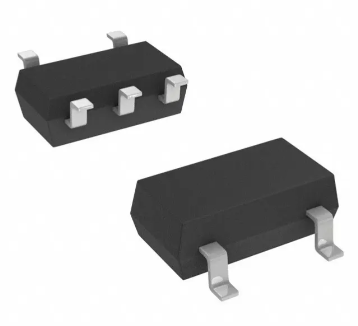

    微功耗1.5MHz,轨至轨运算放大器
LTC6001UXC5/R6 数据手册
LTC6001U P-1 General Description The LTC6001U of single-channel operational amplifiers is specifically designed for general-purpose cost-sensitive systems and applications. Featuring rail-to-rail input and output (RRIO) swings, and low quiescent current (typical 75 µA) combined with a wide bandwidth (1.5 MHz) and very low noise (25 nV/√Hz at 1 kHz) makes this family very attractive for a variety of battery-powered applications that require a good balance between cost and performance, such as audio outputs, consumer electronics, smoke detectors, portable medical devices and white goods. The low input bias current supports these amplifiers to be used in applications with mega-ohm source impedances. The robust design of the LTC6001U amplifiers provides ease-of-use to the circuit designer: unity-gain stability with capacitive loads of up to 500 pF, integrated RF/EMI rejection filter, no phase reversal in overdrive conditions, and high electro-static discharge (ESD) protection (5-kV HBM). The LTC6001 amplifiers are optimized for operation at voltages as low as +1.8 V (±0.9 V) and up to +5.5 V (±2.75 V) at the temperature range of 0 ℃ to 70 ℃, and operation at voltages from +2.0 V (±1.0 V) to +5.5 V (±2.75 V) over the extended temperature range of −40 ℃ to +125 ℃. The LTC6001U (single) is available in both SOT23-5L and SC70-5L packages. Features and Benefits          Precision Amplifiers for Cost-Sensitive Systems Low Noise: 25 nV/√Hz at 1 kHz Low Input Offset Voltage: 0.5 mV 1.5 MHz GBW for Unity-Gain Stable Micro-Power: 75 μA Supply Current Per Amplifier Single 1.8 V to 5.5 V Supply Voltage Range at 0 ℃ to 70 ℃ Rail-to-Rail Input and Output Internal RF/EMI Filter Extended Temperature Range: −40℃ to +125℃ Applications  Battery-Powered Instruments: – Consumer, Industrial, Medical, Notebooks  Audio Outputs  Wireless Sensors: – Home Security, Remote Sensing, Wireless Metering  Sensor Signal Conditioning: – Sensor Interfaces, Loop-Powered, Active Filters Pin Configurations (Top View) LTC6001U SOT23-5L / SC70-5L +IN 1 –VS 2 –IN 3 5 +VS 4 OUT CAUTION: These devices are sensitive to electrostatic discharge; follow proper IC Handling Procedures. Linearin and designs are registered trademarks of Linearin Technology Corporation. © Copyright Linearin Technology Corporation. All Rights Reserved. All other trademarks mentioned are the property of their respective owners. FN1617-33U.1 — Data Sheet Micro-Power 1.5MHz, Low-Noise, RRIO, 1.8V CMOS Amplifiers LTC6001U P-2 Pin Description Symbol Description –IN Inverting input of the amplifier. The voltage range is from (VS– – 0.1V) to (VS+ + 0.1V). +IN Non-inverting input of the amplifier. This pin has the same voltage range as –IN. +VS Positive power supply. –VS Negative power supply. OUT Amplifier output. Ordering Information Type Number Package Name Package Quantity Marking Code (1) LTC6001UXT5/R6 SOT23-5L Tape and Reel, 3 000 AG3xx, 321, 321I LTC6001UXC5/R6 SC70-5L Tape and Reel, 3 000 AG3xx, 321 (1) There may be multiple device markings, a varied marking character of “x” , or additional marking, which relates to the logo, the lot trace code information, or the environmental category on the device. Limiting Value In accordance with the Absolute Maximum Rating System (IEC 60134). Parameter Absolute Maximum Rating Supply Voltage, VS+ to VS– 10.0 V Signal Input Terminals: Voltage, Current VS– – 0.5 V to VS+ + 0.5 V, ±20 mA Output Short-Circuit Continuous Storage Temperature Range, Tstg –65 ℃ to +150 ℃ Junction Temperature, TJ 150 ℃ Lead Temperature Range (Soldering 10 sec) 260 ℃ ESD Rating Parameter Electrostatic Discharge Voltage Item Value Human body model (HBM), per MIL-STD-883J / Method 3015.9 (1) ±5 000 Charged device model (CDM), per ESDA/JEDEC JS-002-2014 ±2 000 Machine model (MM), per JESD22-A115C (2) Unit V ±250 (1) JEDEC document JEP155 states that 500-V HBM allows safe manufacturing with a standard ESD control process. Manufacturing with less than 500-V HBM is possible if necessary precautions are taken. (2) JEDEC document JEP157 states that 250-V CDM allows safe manufacturing with a standard ESD control process. Manufacturing with less than 250-V CDM is possible if necessary precautions are taken. CAUTION: These devices are sensitive to electrostatic discharge; follow proper IC Handling Procedures. Linearin and designs are registered trademarks of Linearin Technology Corporation. © Copyright Linearin Technology Corporation. All Rights Reserved. All other trademarks mentioned are the property of their respective owners. FN1617-33U.1 — Data Sheet Micro-Power 1.5MHz, Low-Noise, RRIO, 1.8V CMOS Amplifiers LTC6001U P-3 Electrical Characteristics VS = 5.0V, TA = +25℃, VCM = VS /2, VO = VS /2, and RL = 10kΩ connected to VS /2, unless otherwise noted. Boldface limits apply over the specified temperature range, TA = −40 to +125 ℃. Symbol Parameter Conditions Min. Typ. Max. Unit OFFSET VOLTAGE ±0.5 VOS Input offset voltage VOS TC Offset voltage drift TA = −40 to +125 ℃ Power supply rejection ratio VS = 2.0 to 5.5 V, VCM < VS+ − 2V 80 TA = −40 to +125 ℃ 75 PSRR TA = −40 to +125 ℃ ±2.5 ±2.8 ±1 3 110 mV μV/℃ dB INPUT BIAS CURRENT 1 IB Input bias current IOS Input offset current TA = +85 ℃ 150 TA = +125 ℃ 500 pA 1 pA μVP-P NOISE Vn Input voltage noise f = 0.1 to 10 Hz 5.6 en Input voltage noise density f = 10 kHz 22 f = 1 kHz 25 In Input current noise density f = 1 kHz 5 nV/√Hz fA/√Hz INPUT VOLTAGE VCM CMRR Common-mode voltage range Common-mode rejection ratio VS––0.1 VS = 5.5 V, VCM = −0.1 to 5.6 V 70 VCM = 0 to 5.3 V, TA = −40 to +125 ℃ 65 VS = 2.0 V, VCM = −0.1 to 2.1 V 65 VCM = 0 to 1.8 V, TA = −40 to +125 ℃ 60 VS++0.1 V 83 77 dB INPUT IMPEDANCE CIN Input capacitance Differential 2.0 Common mode 3.5 pF OPEN-LOOP GAIN AVOL Open-loop voltage gain RL = 25 kΩ, VO = 0.05 to 3.5 V 90 TA = −40 to +125 ℃ 85 RL = 2 kΩ, VO = 0.15 to 3.5 V 85 TA = −40 to +125 ℃ 80 105 100 dB FREQUENCY RESPONSE GBW Gain bandwidth product SR Slew rate G = +1, CL = 100 pF, VO = 1.5 to 3.5 V THD+N Total harmonic distortion + noise G = +1, f = 1 kHz, VO = 1 VRMS tS Settling time tOR Overload recovery time 1.5 MHz 1.2 V/μs 0.002 % To 0.1%, G = +1, 1V step 1.2 To 0.01%, G = +1, 1V step 1.5 To 0.1%, VIN * Gain > VS 2 CAUTION: These devices are sensitive to electrostatic discharge; follow proper IC Handling Procedures. Linearin and designs are registered trademarks of Linearin Technology Corporation. © Copyright Linearin Technology Corporation. All Rights Reserved. All other trademarks mentioned are the property of their respective owners. μs μs FN1617-33U.1 — Data Sheet Micro-Power 1.5MHz, Low-Noise, RRIO, 1.8V CMOS Amplifiers LTC6001U P-4 Electrical Characteristics (continued) VS = 5.0V, TA = +25℃, VCM = VS /2, VO = VS /2, and RL = 10kΩ connected to VS /2, unless otherwise noted. Boldface limits apply over the specified temperature range, TA = −40 to +125 ℃. Symbol Parameter Conditions Min. Typ. Max. Unit OUTPUT VOH High output voltage swing RL = 25 kΩ VS+–9 VS+–5 RL = 2 kΩ VS+–95 VS+–63 VOL Low output voltage swing RL = 25 kΩ VS–+3.5 VS–+6 RL = 2 kΩ VS–+43 VS–+65 ISC Short-circuit current Source current through 10Ω 45 Sink current through 10Ω 55 mV mV mA POWER SUPPLY VS Operating supply voltage IQ Quiescent current (per amplifier) TA = 0 to +70 ℃ 1.8 5.5 TA = −40 to +125 ℃ 2.0 5.5 75 TA = −40 to +125 ℃ 125 160 V μA THERMAL CHARACTERISTICS TA Operating temperature range θJA Package Thermal Resistance –40 +125 SC70-5L 333 SOT23-5L 190 CAUTION: These devices are sensitive to electrostatic discharge; follow proper IC Handling Procedures. Linearin and designs are registered trademarks of Linearin Technology Corporation. © Copyright Linearin Technology Corporation. All Rights Reserved. All other trademarks mentioned are the property of their respective owners. ℃ ℃/W FN1617-33U.1 — Data Sheet Micro-Power 1.5MHz, Low-Noise, RRIO, 1.8V CMOS Amplifiers LTC6001U P-5 Typical Performance Characteristics At TA = +25℃, VCM = VS /2, and RL = 10kΩ connected to VS /2, unless otherwise noted. Distribution (Units) 900 800 1,000 VCM = –VS 5,000 Samples Voltage Noise (nV/√Hz) 1000 700 100 600 500 400 300 200 100 0 10 1 1 100 Offset Voltage (mV) 60 40 20 0 -20 -40 10 100 1k 10k 100k 1M 140 120 100 CMRR (dB) AOL (dB) 80 140 120 100 80 60 40 20 0 -20 -40 -60 -80 10M Phase (deg) 100 80 60 40 20 0 1 100 Frequency (Hz) 10k 1M Frequency (Hz) Open-loop Gain and Phase as a function of Frequency. Common-mode Rejection Ratio as a function of Frequency. 125 140 Quiescent Current (μA) 120 100 PSRR (dB) 1M Input Voltage Noise Spectral Density as a function of Frequency. Offset Voltage Production Distribution 120 10k Frequency (Hz) 80 60 40 20 100 75 50 25 0 0 1 100 10k 1M 1.5 2.5 3 3.5 4 4.5 5 5.5 Supply Voltage (V) Frequency (Hz) Power Supply Rejection Ratio as a function of Frequency. 2 Quiescent Current as a function of Supply Voltage. CAUTION: These devices are sensitive to electrostatic discharge; follow proper IC Handling Procedures. Linearin and designs are registered trademarks of Linearin Technology Corporation. © Copyright Linearin Technology Corporation. All Rights Reserved. All other trademarks mentioned are the property of their respective owners. FN1617-33U.1 — Data Sheet Micro-Power 1.5MHz, Low-Noise, RRIO, 1.8V CMOS Amplifiers LTC6001U P-6 Typical Performance Characteristics (continued) At TA = +25℃, VCM = VS /2, and RL = 10kΩ connected to VS /2, unless otherwise noted. 5 Sourcing Current 4 100 Output Voltage (V) Quiescent Current (μA) 120 80 60 40 –40℃ 3 +125℃ +25℃ 2 1 Sinking Current 0 -50 -25 0 25 50 75 100 125 0 10 Temperature (℃) 30 40 50 60 70 Output Current (mA) Output Voltage Swing as a function of Output Current. Quiescent Current as a function of Temperature. 80 60 Short-circuit Current (mA) Short-circuit Current (mA) 20 60 –ISC 40 20 +ISC 0 –ISC 50 40 +ISC 30 20 2 2.5 3 3.5 4 4.5 5 5.5 -50 0 25 50 75 100 125 Temperature (℃) Supply Voltage (V) Short-circuit Current as a function of Supply Voltage. -25 Short-circuit Current as a function of Temperature. CL=100pF 1V/div 25mV/div CL=100pF 5μs/div Large Signal Step Response. CAUTION: These devices are sensitive to electrostatic discharge; follow proper IC Handling Procedures. Linearin and designs are registered trademarks of Linearin Technology Corporation. © Copyright Linearin Technology Corporation. All Rights Reserved. All other trademarks mentioned are the property of their respective owners. 2μs/div Small Signal Step Response. FN1617-33U.1 — Data Sheet Micro-Power 1.5MHz, Low-Noise, RRIO, 1.8V CMOS Amplifiers P-7 LTC6001U Application Notes The LTC6001U is a family of low-power, rail-to-rail input and output operational amplifiers specifically designed for portable applications. These devices operate from 1.8 V to 5.5 V at the temperature range of 0 ℃ to 70 ℃, are unity-gain stable, and suitable for a wide range of general-purpose applications. The class AB output stage is capable of driving ≤ 10kΩ loads connected to any point between VS+ and ground. The input common-mode voltage range includes both rails, and allows the LTC6001U family to be used in virtually any single-supply application. Rail-to-rail input and output swing significantly increases dynamic range, especially in low-supply applications, and makes them ideal for driving sampling analog-to-digital converters (ADCs). The LTC6001U features 1.5-MHz bandwidth and 1.2V/μs slew rate with only 75-μA supply current per amplifier, providing good ac performance at very low power consumption. DC applications are also well served with a low input noise voltage of 25-nV/√Hz at 1-kHz, low input bias current, and an input offset voltage of 0.5-mV typically. The typical offset voltage drift is 1-μV/℃, over the full temperature range the input offset voltage changes only 100-μV (0.5-mV to 0.6-mV). OPERATING VOLTAGE The LTC6001U family is optimized for operation at voltages as low as +1.8 V (±0.9 V) and up to +5.5 V (±2.75 V) at the temperature range of 0 ℃ to 70 ℃, and fully specified and ensured for operation from 2.0 V to 5.5 V (±1.0 V to ±2.75 V). In addition, many specifications apply from –40 ℃ to +125 ℃. Parameters that vary significantly with operating voltages or temperature are illustrated in the Typical Characteristics graphs. NOTE: Supply voltages (VS+ to VS–) higher than +10 V can permanently damage the device. RAIL-TO-RAIL INPUT The input common-mode voltage range of the LTC6001U series extends 100-mV beyond the negative and positive supply rails. This performance is achieved with a complementary input stage: an Nchannel input differential pair in parallel with a Pchannel differential pair. The N-channel pair is active for input voltages close to the positive rail, typically VS+–1.4 V to the positive supply, whereas the Pchannel pair is active for inputs from 100-mV below the negative supply to approximately VS+–1.4 V. There is a small transition region, typically VS+–1.2 V to VS+–1 V, in which both pairs are on. This 200-mV transition region can vary up to 200-mV with process variation. Thus, the transition region (both stages on) can range from VS+–1.4 V to VS+–1.2 V on the low end, up to VS+–1 V to VS+–0.8 V on the high end. Within this transition region, PSRR, CMRR, offset voltage, offset drift, and THD can be degraded compared to device operation outside this region. The typical input bias current of the LTC6001U during normal operation is approximately 1-pA. In overdriven conditions, the bias current can increase significantly. The most common cause of an overdriven condition occurs when the operational amplifier is outside of the linear range of operation. When the output of the operational amplifier is driven to one of the supply rails, the feedback loop requirements cannot be satisfied and a differential input voltage develops across the input pins. This differential input voltage results in activation of parasitic diodes inside the front-end input chopping switches that combine with electromagnetic interference (EMI) filter resistors to create the equivalent circuit. Notice that the input bias current remains within specification in the linear region. INPUT EMI FILTER AND CLAMP CIRCUIT Figure 1 shows the input EMI filter and clamp circuit. The LTC6001U op-amps have internal ESD protection diodes (D1, D2, D3, and D4) that are connected between the inputs and each supply rail. These diodes protect the input transistors in the event of electrostatic discharge and are reverse biased during normal operation. This protection scheme allows voltages as high as approximately 500-mV beyond the rails to be applied at the input of either terminal without causing permanent damage. These ESD protection current-steering diodes also provide in-circuit, input overdrive protection, as long as the current is limited to 20-mA as stated in the Absolute Maximum Ratings. VS+ D1 RS1 5kΩ IN+ D2 D3 CCM1 RS2 CDM 5kΩ IN– D4 CCM2 VS– Figure 1. Input EMI Filter and Clamp Circuit Operational amplifiers vary in susceptibility to EMI. If conducted EMI enters the operational amplifier, the dc offset at the amplifier output can shift from its nominal value when EMI is present. This shift is a result of signal rectification associated with the internal semiconductor junctions. Although all operational amplifier pin functions can be affected by EMI, the input pins are likely to be the most susceptible. The EMI filter of the LTC6001 family is CAUTION: These devices are sensitive to electrostatic discharge; follow proper IC Handling Procedures. Linearin and designs are registered trademarks of Linearin Technology Corporation. © Copyright Linearin Technology Corporation. All Rights Reserved. All other trademarks mentioned are the property of their respective owners. FN1617-33U.1 — Data Sheet Micro-Power 1.5MHz, Low-Noise, RRIO, 1.8V CMOS Amplifiers LTC6001U P-8 Application Notes (continued) composed of two 5-kΩ input series resistors (RS1 and RS2), two common-mode capacitors (CCM1 and CCM2), and a differential capacitor (CDM). These RC networks set the −3 dB low-pass cutoff frequencies at 35-MHz for common-mode signals, and at 22-MHz for differential signals. RAIL-TO-RAIL OUTPUT Designed as a micro-power, low-noise operational amplifier, the LTC6001U delivers a robust output drive capability. A class AB output stage with common-source transistors is used to achieve full rail-to-rail output swing capability. For resistive loads up to 25-kΩ, the output swings typically to within 5-mV of either supply rail regardless of the power-supply voltage applied. Different load conditions change the ability of the amplifier to swing close to the rails. For resistive loads up to 2-kΩ, the output swings typically to within 63-mV of the positive supply rail and within 43-mV of the negative supply rail. provides the DC accuracy by connecting the inverting signal with the output. The CF and RISO serve to counteract the loss of phase margin by feeding the high frequency component of the output signal back to the amplifier’s inverting input, thereby preserving phase margin in the overall feedback loop. For no-buffer configuration, there are two others ways to increase the phase margin: (a) by increasing the amplifier’s gain, or (b) by placing a capacitor in parallel with the feedback resistor to counteract the parasitic capacitance associated with inverting node. CF RISO VIN CL The LTC6001U family can safely drive capacitive loads of up to 500-pF in any configuration. As with most amplifiers, driving larger capacitive loads than specified may cause excessive overshoot and ringing, or even oscillation. A heavy capacitive load reduces the phase margin and causes the amplifier frequency response to peak. Peaking corresponds to overshooting or ringing in the time domain. Therefore, it is recommended that external compensation be used if the LTC6001U op-amps must drive a load exceeding 500-pF. This compensation is particularly important in the unity-gain configuration, which is the worst case for stability. A quick and easy way to stabilize the op-amp for capacitive load drive is by adding a series resistor, RISO, between the amplifier output terminal and the load capacitance, as shown in Figure 2. RISO isolates the amplifier output and feedback network from the capacitive load. The bigger the RISO resistor value, the more stable VOUT will be. Note that this method results in a loss of gain accuracy because RISO forms a voltage divider with the RL. RISO VOUT LTC6001 CAPACITIVE LOAD AND STABILITY LTC6001 RF VOUT VIN CL Figure 2. Indirectly Driving Heavy Capacitive Load An improvement circuit is shown in Figure 3. It provides DC accuracy as well as AC stability. The RF RL Figure 3. Indirectly Driving Heavy Capacitive Load with DC Accuracy OVERLOAD RECOVERY Overload recovery is defined as the time required for the operational amplifier output to recover from a saturated state to a linear state. The output devices of the operational amplifier enter a saturation region when the output voltage exceeds the rated operating voltage, either because of the high input voltage or the high gain. After the device enters the saturation region, the charge carriers in the output devices require time to return back to the linear state. After the charge carriers return back to the linear state, the device begins to slew at the specified slew rate. Thus, the propagation delay in case of an overload condition is the sum of the overload recovery time and the slew time. The overload recovery time for the LTC6001U family is approximately 2-μs. EMI REJECTION RATIO Circuit performance is often adversely affected by high frequency EMI. When the signal strength is low and transmission lines are long, an op-amp must accurately amplify the input signals. However, all opamp pins — the non-inverting input, inverting input, positive supply, negative supply, and output pins — are susceptible to EMI signals. These high frequency signals are coupled into an op-amp by various means, such as conduction, near field radiation, or far field radiation. For example, wires and printed circuit board (PCB) traces can act as antennas and pick up high frequency EMI signals. CAUTION: These devices are sensitive to electrostatic discharge; follow proper IC Handling Procedures. Linearin and designs are registered trademarks of Linearin Technology Corporation. © Copyright Linearin Technology Corporation. All Rights Reserved. All other trademarks mentioned are the property of their respective owners. FN1617-33U.1 — Data Sheet Micro-Power 1.5MHz, Low-Noise, RRIO, 1.8V CMOS Amplifiers LTC6001U P-9 Application Notes (continued) Amplifiers do not amplify EMI or RF signals due to their relatively low bandwidth. However, due to the nonlinearities of the input devices, op-amps can rectify these out of band signals. When these high frequency signals are rectified, they appear as a dc offset at the output. The LTC6001U op-amps have integrated EMI filters at their input stage. A mathematical method of measuring EMIRR is defined as follows: EMIRR = 20 log (VIN_PEAK / ΔVOS) resulting in a thermal voltage error. This thermocouple error can be reduced by using dummy components to match the thermoelectric error source. Placing the dummy component as close as possible to its partner ensures both Seebeck voltages are equal, thus canceling the thermocouple error. Maintaining a constant ambient temperature on the circuit board further reduces this error. The use of a ground plane helps distribute heat throughout the board and reduces EMI noise pickup. INPUT-TO-OUTPUT COUPLING To minimize capacitive coupling, the input and output signal traces should not be parallel. This helps reduce unwanted positive feedback. MAXIMIZING PERFORMANCE THROUGH PROPER LAYOUT To achieve the maximum performance of the extremely high input impedance and low offset voltage of the LTC6001U op-amps, care is needed in laying out the circuit board. The PCB surface must remain clean and free of moisture to avoid leakage currents between adjacent traces. Surface coating of the circuit board reduces surface moisture and provides a humidity barrier, reducing parasitic resistance on the board. The use of guard rings around the amplifier inputs further reduces leakage currents. Figure 4 shows proper guard ring configuration and the top view of a surface-mount layout. The guard ring does not need to be a specific width, but it should form a continuous loop around both inputs. By setting the guard ring voltage equal to the voltage at the non-inverting input, parasitic capacitance is minimized as well. For further reduction of leakage currents, components can be mounted to the PCB using Teflon standoff insulators. Guard Ring +IN –IN +VS Figure 4. Use a guard ring around sensitive pins Other potential sources of offset error are thermoelectric voltages on the circuit board. This voltage, also called Seebeck voltage, occurs at the junction of two dissimilar metals and is proportional to the temperature of the junction. The most common metallic junctions on a circuit board are solder-toboard trace and solder-to-component lead. If the temperature of the PCB at one end of the component is different from the temperature at the other end, the resulting Seebeck voltages are not equal, CAUTION: These devices are sensitive to electrostatic discharge; follow proper IC Handling Procedures. Linearin and designs are registered trademarks of Linearin Technology Corporation. © Copyright Linearin Technology Corporation. All Rights Reserved. All other trademarks mentioned are the property of their respective owners. FN1617-33U.1 — Data Sheet Micro-Power 1.5MHz, Low-Noise, RRIO, 1.8V CMOS Amplifiers LTC6001U P-10 Typical Application Circuits DIFFERENTIAL AMPLIFIER eliminates expansive low-leakage cables that that is required to connect a pH probe (general purpose combination pH probes, e.g Corning 476540) to metering ICs such as ADC, AFE and/or MCU. A LTC6001U op-amp and a lithium battery are housed in the probe assembly. A conventional low-cost coaxial cable can be used to carry the op-amp’s output signal to subsequent ICs for pH reading. R2 R1 Vn LTC6001 VOUT Vp R3 MOTOR PHASE CURRENT SENSING AMPLIFIER R4 VREF Figure 5. Differential Amplifier The circuit shown in Figure 5 performs the difference function. If the resistors ratios are equal R4/R3 = R2/R1, then: VOUT = (Vp – Vn) × R2/R1 + VREF INSTRUMENTATION AMPLIFIER RG VREF R1 R2 R2 R1 LTC6001 LTC6001 VOUT V1 V2 VOUT =(V1  V2 )(1  R1 2 R1  )  VREF R2 RG The current sensing amplification shown in Figure 8 has a slew rate of 2πfVPP for the output of sine wave signal, and has a slew rate of 2fVPP for the output of triangular wave signal. In most of motor control systems, the PWM frequency is at 10 kHz to 20 kHz, and one cycle time is 100 μs for a 10 kHz of PWM frequency. In current shunt monitoring for a motor phase, the phase current is converted to a phase voltage signal for ADC sampling. This sampling voltage signal must be settled before entering the ADC. As the Figure 8 shown, the total settling time of a current shunt monitor circuit includes: the rising edge delay time (tSR) due to the op-amp’s slew rate, and the measurement settling time (tSET). For a 3-shunt solution in motor phase current sensing, if the smaller duty cycle of the PWM is defined at 45% (In fact, the phase with minimum PWM duty cycle, such as 5%, is not detected current directly, and it can be calculated from the other two phase currents), and the tSR is required at 20% of a total time window for a phase current monitoring, in case of a 3.3 V motor control system (3.3 V MCU with 12-bit ADC), the op-amp’s slew rate should be more than: 3.3V / (100μs× 45% × 20%) = 0.37 V/μs At the same time, the op-amp’s bandwidth should be much greater than the PWM frequency, like 10 time at least. Figure 6. Instrumentation Amplifier The LTC6001U family is well suited for conditioning sensor signals in battery-powered applications. Figure 6 shows a two op-amp instrumentation amplifier, using the LTC6001 op-amps. The circuit works well for applications requiring rejection of common-mode noise at higher gains. The reference voltage (VREF) is supplied by a low-impedance source. In single voltage supply applications, the VREF is typically VS/2. tSR VBUS tSET High side switch tSR – Time delay due to op-amp slew rate tSET – Measurement settling time tSMP – Sampling time window To Motor Phase VM Low side switch BUFFERED CHEMICAL SENSORS tSMP R2 R1 RSHUNT Coax LTC6001 R3 R4 LTC6001 R1 10MΩ 3V C1 To ADC, AFE or MCU R5 C2 Filter pH PROBE Offset Amplification Figure 8. Current Shunt Monitor Circuit R2 10MΩ All components contained within the pH probe Figure 7. Buffered pH Probe The LTC6001U family has input bias current in the pA range. This is ideal in buffering high impedance chemical sensors, such as pH probes. As an example, the circuit in Figure 7 CAUTION: These devices are sensitive to electrostatic discharge; follow proper IC Handling Procedures. Linearin and designs are registered trademarks of Linearin Technology Corporation. © Copyright Linearin Technology Corporation. All Rights Reserved. All other trademarks mentioned are the property of their respective owners. To MCU ADC pin FN1617-33U.1 — Data Sheet Micro-Power 1.5MHz, Low-Noise, RRIO, 1.8V CMOS Amplifiers LTC6001U P-11 Tape and Reel Information REEL DIMENSIONS TAPE DIMENSIONS K0 P1 B0 W Reel Diameter A0 Cavity A0 B0 K0 W P1 Reel Width (W1) Dimension designed to accommodate the component width Dimension designed to accommodate the component length Dimension designed to accommodate the component thickness Overall width of the carrier tape Pitch between successive cavity centers QUADRANT ASSIGNMENTS FOR PIN 1 ORIETATION IN TAPE Sprocket Holes Q1 Q2 Q1 Q2 Q3 Q4 Q3 Q4 User Direction of Feed Pocket Quadrants * All dimensions are nominal Device LTC6001UXT5/R6 Package Pins Type SOT23 5 SPQ 3 000 Reel Reel Diameter Width W1 (mm) (mm) 178 9.0 A0 (mm) B0 (mm) K0 (mm) P1 (mm) W (mm) Pin 1 Quadrant 3.3 3.2 1.5 4.0 8.0 Q3 CAUTION: These devices are sensitive to electrostatic discharge; follow proper IC Handling Procedures. Linearin and designs are registered trademarks of Linearin Technology Corporation. © Copyright Linearin Technology Corporation. All Rights Reserved. All other trademarks mentioned are the property of their respective owners. FN1617-33U.1 — Data Sheet Micro-Power 1.5MHz, Low-Noise, RRIO, 1.8V CMOS Amplifiers LTC6001U P-12 Package Outlines DIMENSIONS, SOT23-5L A2 A A1 D e1 Symbol A A1 A2 b c D E1 E e e1 L L1 θ θ L E E1 L1 e b Dimensions In Millimeters Min Max 1.25 0.04 0.10 1.00 1.20 0.33 0.41 0.15 0.19 2.820 3.02 1.50 1.70 2.60 3.00 0.95 BSC 1.90 BSC 0.60 REF 0.30 0.60 0° 8° Dimensions In Inches Min Max 0.049 0.002 0.004 0.039 0.047 0.013 0.016 0.006 0.007 0.111 0.119 0.059 0.067 0.102 0.118 0.037 BSC 0.075 BSC 0.024 REF 0.012 0.024 0° 8° c RECOMMENDED SOLDERING FOOTPRINT, SOT23-5L 1.0 0.039 0.95 0.037 0.95 0.037 0.7 0.028 2.4 0.094 CAUTION: These devices are sensitive to electrostatic discharge; follow proper IC Handling Procedures. Linearin and designs are registered trademarks of Linearin Technology Corporation. © Copyright Linearin Technology Corporation. All Rights Reserved. All other trademarks mentioned are the property of their respective owners. mm ( inches ) FN1617-33U.1 — Data Sheet Micro-Power 1.5MHz, Low-Noise, RRIO, 1.8V CMOS Amplifiers LTC6001U P-13 Package Outlines (continued) DIMENSIONS, SC70-5L (SOT353) A2 A Symbol A1 D e1 A A1 A2 b C D E E1 e e1 L L1 θ θ e L E1 E L1 b Dimensions In Millimeters Min Max 0.90 1.10 0.00 0.10 0.90 1.00 0.15 0.35 0.08 0.15 2.00 2.20 1.15 1.35 2.15 2.45 0.65 typ. 1.20 1.40 0.525 ref. 0.26 0.46 0° 8° C RECOMMENDED SOLDERING FOOTPRINT, SC70-5L (SOT353) 0.50 0.0197 0.65 0.0256 0.65 0.0256 0.40 0.0157 1.9 0.0748 CAUTION: These devices are sensitive to electrostatic discharge; follow proper IC Handling Procedures. Linearin and designs are registered trademarks of Linearin Technology Corporation. © Copyright Linearin Technology Corporation. All Rights Reserved. All other trademarks mentioned are the property of their respective owners. mm ( inches ) Dimensions In Inches Min Max 0.035 0.043 0.000 0.004 0.035 0.039 0.006 0.014 0.003 0.006 0.079 0.087 0.045 0.053 0.085 0.096 0.026 typ. 0.047 0.055 0.021 ref. 0.010 0.018 0° 8° FN1617-33U.1 — Data Sheet Micro-Power 1.5MHz, Low-Noise, RRIO, 1.8V CMOS Amplifiers P-14 LTC6001U IMPORTANT NOTICE Linearin is a global fabless semiconductor company specializing in advanced high-performance highquality analog/mixed-signal IC products and sensor solutions. The company is devoted to the innovation of high performance, analog-intensive sensor front-end products and modular sensing solutions, applied in multi-market of medical & wearable devices, smart home, sensing of IoT, and intelligent industrial & smart factory (industrie 4.0). Linearin’s product families include widely-used standard catalog products, solution-based application specific standard products (ASSPs) and sensing solutions that help customers achieve faster time-to-market products. Go to http://www.linearin.com for a complete list of Linearin product families. For additional product information, or full datasheet, please contact with the Linearin’s Sales Department or Representatives. CAUTION: These devices are sensitive to electrostatic discharge; follow proper IC Handling Procedures. Linearin and designs are registered trademarks of Linearin Technology Corporation. © Copyright Linearin Technology Corporation. All Rights Reserved. All other trademarks mentioned are the property of their respective owners. FN1617-33U.1 — Data Sheet Micro-Power 1.5MHz, Low-Noise, RRIO, 1.8V CMOS Amplifiers
